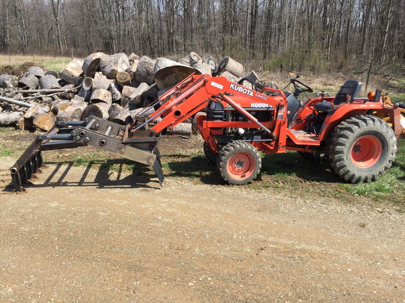

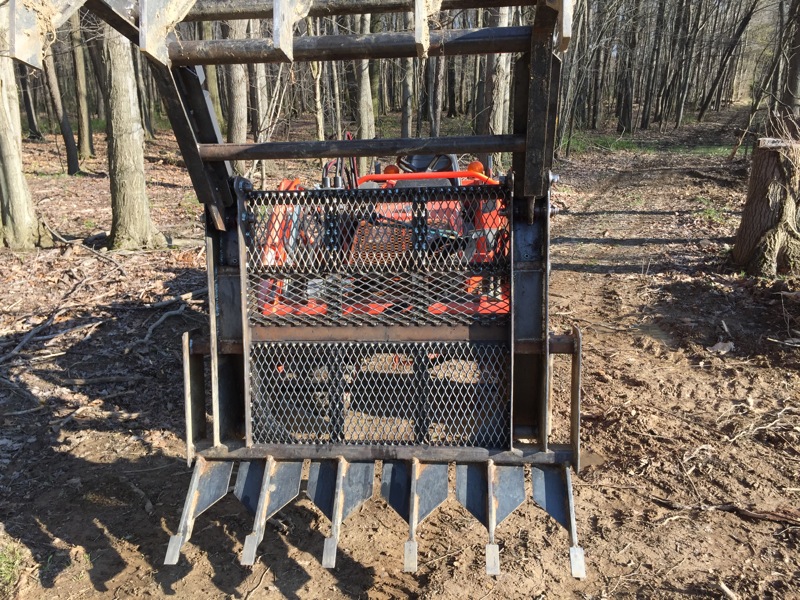

After observing things "in action" over the last couple of days, I think I'm going to add some expanded metal across the back of the lower frame.
Had a couple of close calls with logs/branches protruding in ... the hoses from the front outlets on the crosstube to the grapple and the arms that lock the QA in are both vulnerable, along with a few other things ... like the quick-connects ...

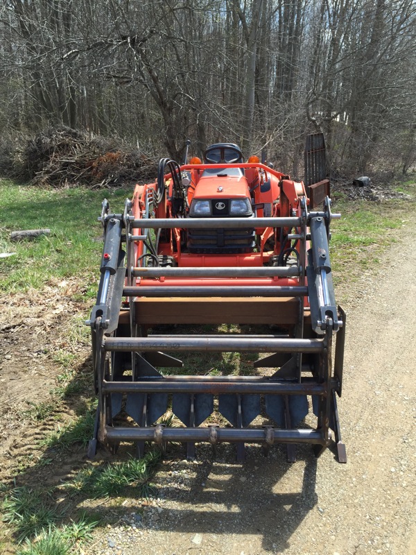

Got the expanded metal backstop cut, fitted, and welded on:

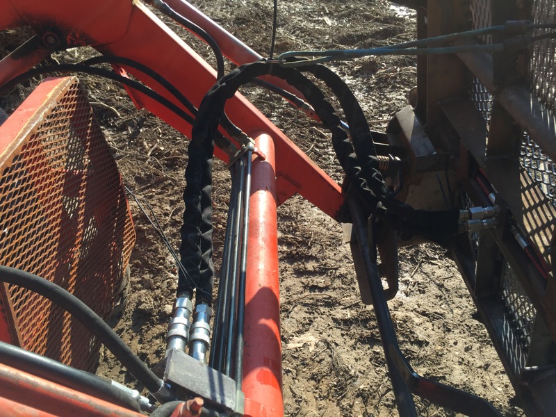

Also think I may have fixed the leak on the hose from the front outlets @ the FPT ---> FJIC adapter where it attaches to the grapple. Used some No. 1 Permatex of the hardening type. Also installed nylon sleeving over the hoses and switched the hoses around: pull back on joystick with button for diverter pressed and it opens, push forward and it closes:
While doing that I managed to pooch the teflon ring that the o-ring sits in on one of the male flush face couplers ... swapped it out for another male coupler and that one had a similar problem. Ran down to the hardware just before they closed and picked up several o-ring to attempt a fix ... used two o-rings instead of one o-ring and teflon ring and it worked !
Also trimmed the bracket on the loader crosstube, so it wasn't rubbing on the outer jacket of the hose ... even managed not to cut the (new) hose ... :rolleyes:
Was pretty late by then ... but I still managed to clear 75' to 100' of fence line before it got too dark to work ... :thumbsup:

Leak was not fixed. After futzing around with it several times I came to the conclusion that it wasn't the threads on the fitting on the hose end but actually the crimp ... so had The Woman pick up a hose at TSC the other day while she was out. Replaced that and it appears we now have no leaks.

I've noticed that if the jaw is open all the way and I have the grapple curled all the way back, the sleeving that is on the grapple cylinder hoses is contacting the rod end fittings on the bucket cylinders and is starting to look a little ragged. Will probably get some of that plastic spiral wrap to protect them a little better.
