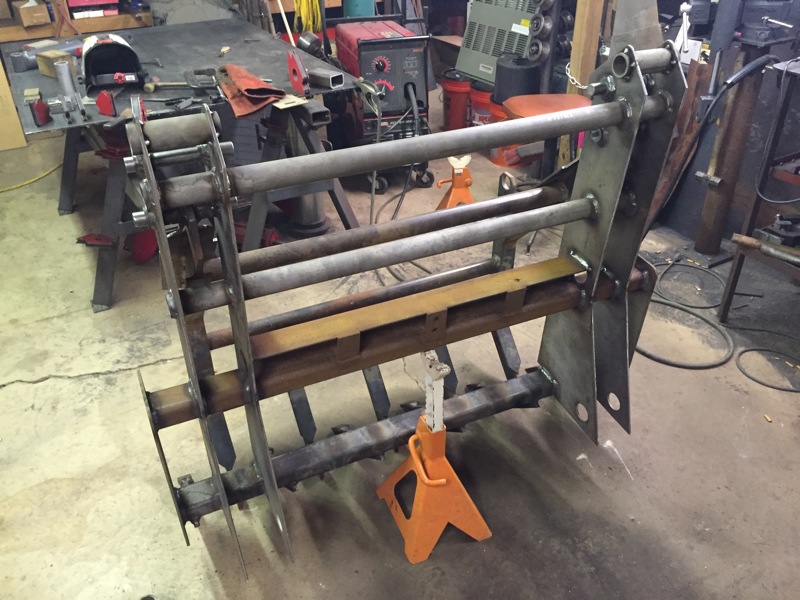

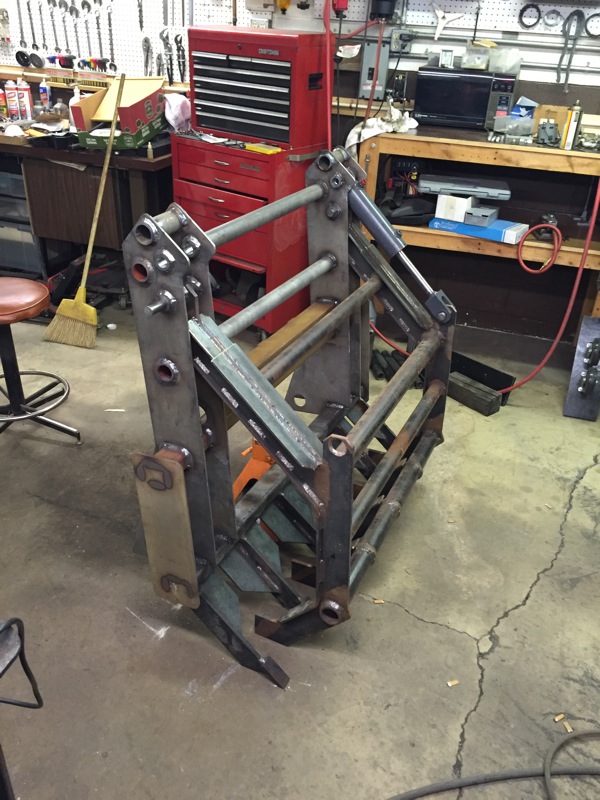

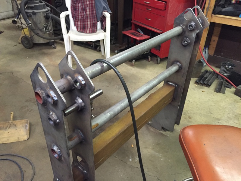

Maximum jaw opening with cylinders lengthened is 55 1/4 inches, tip to tip.
/ Root Rake/Grapple For Kubota B2910
#126
Height with jaws closed is 46", width is 50".
Can't wait to see it in action. :thumbsup:

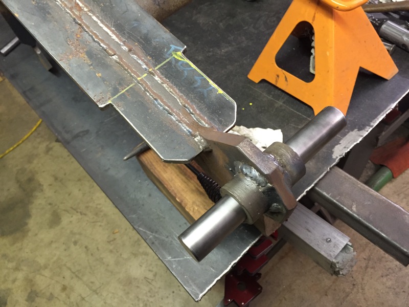

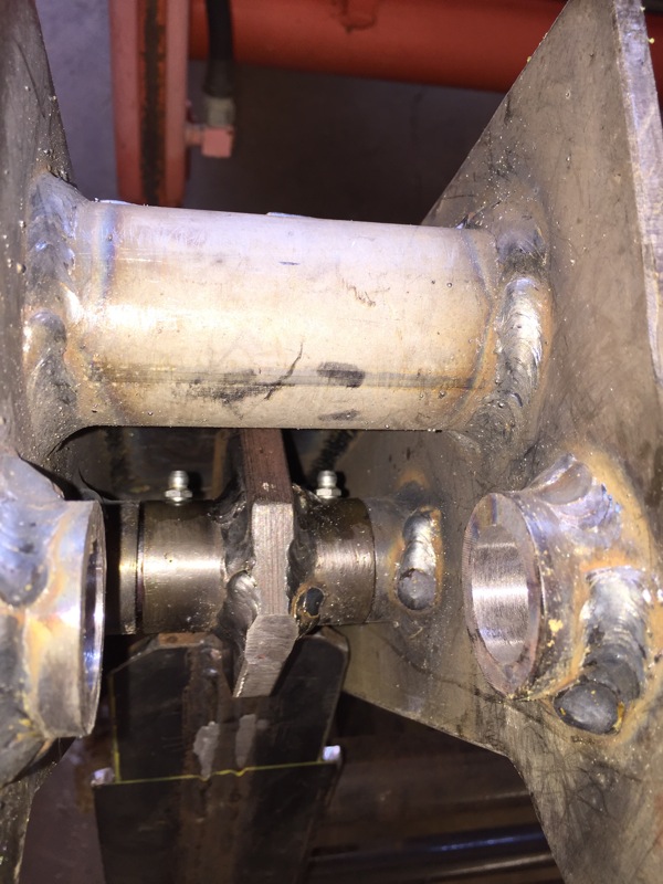

Six holes drilled and tapped, grease fittings installed:
