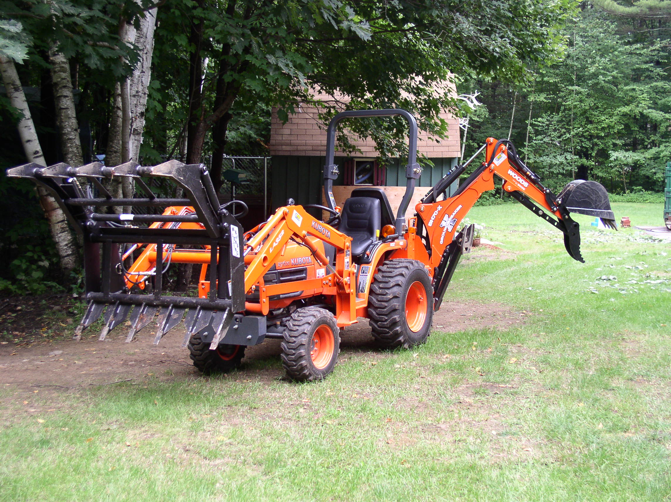

The style of grapple I am building is a root rake "clamshell" type. I haven't totally finalized all aspects of the plans yet, but it's modeled after WR Long's RGB2-48 grapple ... with a couple design changes and modifications. Two of the primary ones being cylinder sizing and placement.
The picture below is of TBN member NHBotanut's RGB2-48 mounted on his B7610 (which is the next size smaller tractor than mine), and who has helpfully provided me with some basic dimensional info on his unit:

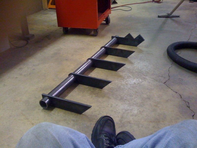

After that was all said and done I grabbed the 2" Schedule 80 pipe (along with some additional triangular "teeth" :D) that ended up as a "just-the-right-length" drop from an 11' stick of pipe and this was what we had (it's actually upside down in the picture from the way it will normally be oriented):

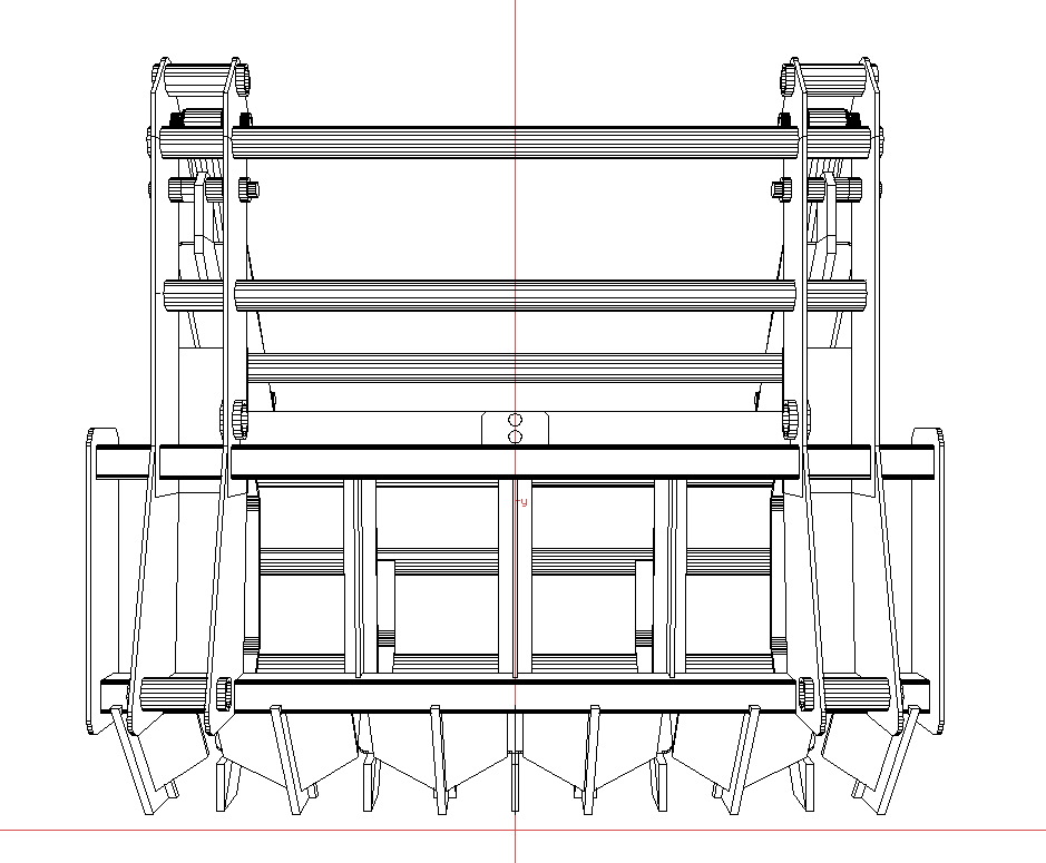

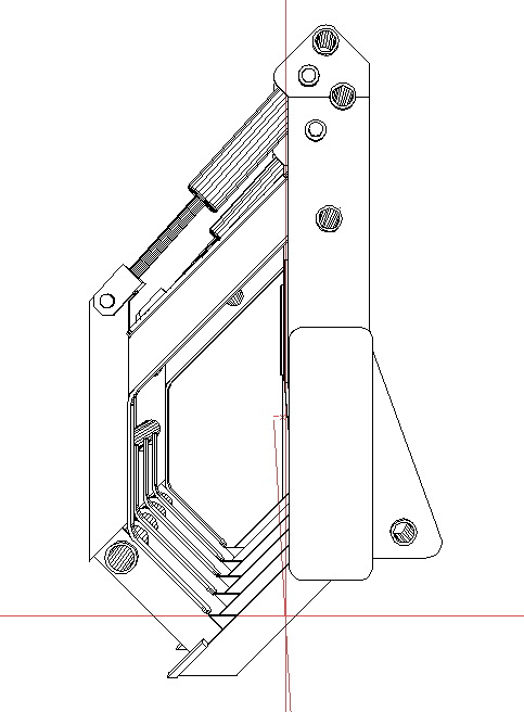

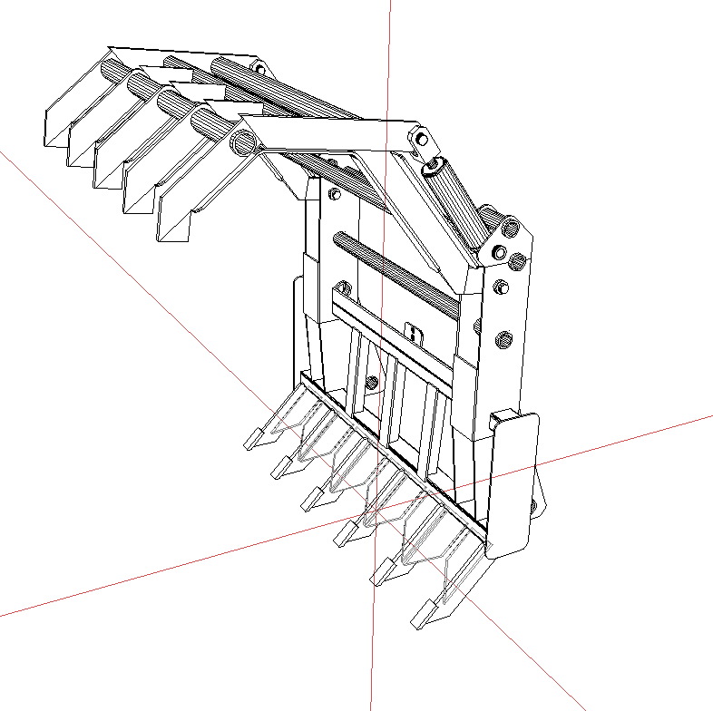

Design specifications mostly finalized ... got it modeled in 3D so I'll be working up a cut list and start slicing and dicing later today.
Had to make some compromises on size, mostly due to me ripping off steel to use on other stuff. Width of the bottom rake is around 50" or 52", stands about 48" tall closed, with a jaw opening of around 55".
A few renderings ...
Front, upper jaw down:
Rear:
Left side:
Rear Perspective:
(It's actually designed so that the upper jaw will close another 5 degrees further than what is depicted in the renderings above.)

Fabricating the "teeth" for the upper jaw:
