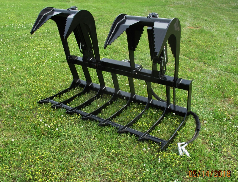

Ok, I'm 100% sure I need a grapple. Lots of things that I know I will need to do clearing brush, etc.
I am confused about the multiple types of grapples, and if I am overthinking this (likely am). I know for certain that a lot of the clearing that I need to do is brush, roots, etc. I also have a lot of large rocks (think 6-8" rocks) that I need to clear from parts of the property. I had considered buying a rock bucket to slide along and grab these, but they are not cheap.
That led me to looking at a grapple with a bottom that is closely spaced tines, like the rock grapple below.
However, it seems most people (particularly purchasing the EA grapples) seem to gravitate to the root grapple, where the tines are spaced out more. This seems great for saving weight, but won't accomplish some of what I was hoping to do with this grapple.
I guess this is a long winded way of saying: Is there really a reason (outside of extra weight) that the root grapple is better than the rock grapple bottom? If I get the rock type, would those closer tines have any issues tearing out roots? Seems like they would do the same thing the others do, just likely a little more load by being further together?
I have a Mahindra 2555 tractor, with 3122 lifting capacity to full height per tractordata. Haven't used it enough to test that, but that makes me think a little extra weight on the grapple itself isn't going to be a huge factor for me. 3rd function is already installed.
Any other thoughts? Really want to buy one this week and have it here soon, wife and I took advantage of the 50 degree day today to walk the property, and we are both excited to get going on this, and see why a grapple will make much shorter work of a lot of our initial clean up.

I've had a few grapples so here is my .02.
Get the grapple that fits your tractor - BY WEIGHT. If you get a grapple too heavy then you can't lift a good size load. I bought a grapple based on durability and when I got it it was so heavy for my tractor I could hardly lift anything with it. I got gid of the tractor and went with a track loader and that solved that problem.
The next grapple I got was based on weight to my tractor and that now has caused a different set of problems. Because it's "light" it is bending out of shape in many ways. The tines are bending, the claw is bent etc. and I'm only lifting the brush. Very dissatisfies with this lightweight grapple.
Next advice I would give, get the tines as close as possible min 2" apart this way you can capture rocks to 2" and above along with any type of logs brush etc - but there again this will add weight sooooooo you need to decide what's more important to you. Lifting capacity or capture capacity or durability. Sadly they don't make a lightweight bulletproof close tine grapple.
Yes a root grapple will tear out roots as this is performed by the points on the grapple once they dig in you lift.

I looked a both - rock & root. There is no way on God's green earth that ANY type/size grapple will rip out the roots I have. All I have on the 80 acres is ancient Ponderosa pines. Besides - I have no desire to remove/eliminate any of them.
I use my grapple to move VERY large rocks and chunks of Ponderosa pine( die from bark beetle). I choose a very heavy duty rock grapple. It's the Land Price SGC 1560. It weighs 820#. No matter what I lift - it never gets more than 6" off the ground. This gives me around 3200# MAX lift capacity.
I don't think Land Pride makes this exact grapple any more.
Look at the load lift charts in your FEL OP manual. How high do you plan on lifting and how much weight. What is listed for your FEL under the general spec is, more or less, at an industry accepted height. The load lift charts will give you much more specific capacities. I will lift to greater heights but only with limbs collected from downed pines.
My rock grapple collects, grabs, lifts & transports limbs just fine. Not as good as a root grapple would but a root grapple would wither trying to dig & lift out large( size of an office desk) rocks. I occasionally use the grapple to rip out brush.
A caution here - no matter what you end up purchasing - modify your grill guard. Stobs, sticks, roots, etc will damage your grill, radiator and battery without added protection.

Have a W.R. Long grapple that has longer straight lower base with two clamshells. That thing is great for grabbing debris and hauling building materials or things you want to stack up on the jaws. When doing my food plot I had a ton of rocks. I was able to get out the large rocks no issues but the "smaller" stuff fell through. I didn't realize at the time and my dealer never told me they had an option to provide twice the set of lower jaws. I think that would grab anything in the 4-6" range which my tiller would have appreciated. I was also trying to seperate my rocks out of the mix by shaking the grapple.
I may weld something up myself but that seemed like a nice option.
/ Root Grapple vs Rock Grapple Help #11
In my opinion a root rake would have the short curved tines. Not either of the flat bottom designs you pictured. If you want to rip roots get a 3pt root rake. Tractor loaders are not made for the stresses required for root ripping.
I have the MTL RK5 rock/root grapple. Like any other implement it has a learning curve and pluses and minuses. I like the solid back design. It protects the grill of the tractor without adding anything to the grill guard and is also useful for some grading. I think it is the second picture you posted.
It is built very strong and weighs about 550 lbs for the 60" version. I don't think you would bend or break it with your tractor.
The close together tines will hold smaller debris and rocks but they also capture loose wet dirt. If the ground is wet it isn't that easy to shake the dirt out. I have to raise it up and roll it back and forth to try and leave the dirt behind. It doesn't always clear.
Like was mentioned above to pick up logs or piles it works best to roll it forward and come down from the top before clamping.

Soil type in your area would weigh in on my decision of tine spacing also. In sandy or loose soil that sifted more readily, narrower tines would catch more rock and debris, while still separating the soil easily. In clay or hard-packed soil, I'd rather have wider spacing myself. Scoop up a load of wet clay and rocks with narrow tines, and you can shake your machine to pieces for several minutes and still have a bunch of dirt with the rocks in the grapple/bucket. (Obviously soil moisture content of the work site makes a huge difference.) I would speak with other owner/operators in your geographic area, and see what they think works best for most conditions. Doing my research and learning from other peoples' mistakes has saved me a lot of $$$ over the years. Getting what you need the first time is usually cheaper in the long run than buying/selling/swapping your way into the correct implement. Best of luck!
/ Root Grapple vs Rock Grapple Help #18
Good advice - WoodDuck. My grapple has 6" tine spacing. I move soil - fully open jaws - straight down on the ground - apply down force and close grapple. I come up with a VERY large wad of soil and take it wherever needed. I seldom lose anything - ie, fallout thru the tines. I always have to hose out the soil between the tines when I've completed the job. My soil has a high organic content.
