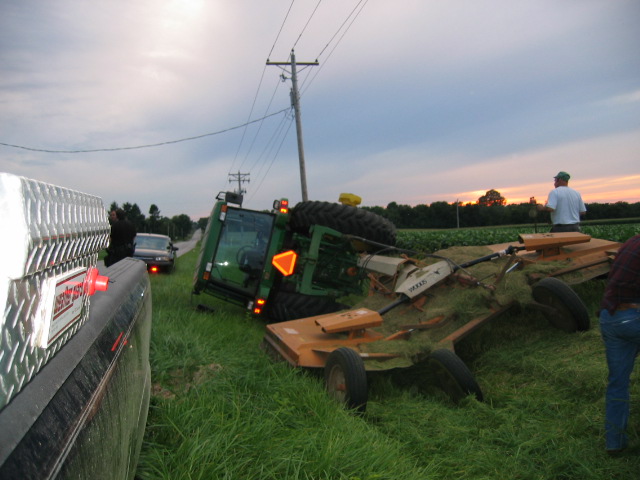

The county guys mow this ditch all the time but we couldn't. No damage just fell over.
Dan

Hi folks, I'm a new tractor owner (JD 3720/300CX FEL/Frontier RC2060 cutter) and have been curious about one thing in particular. Does anyone know the maximum slope allowed before the JD3720 will roll over? I see TractorByNet sells a tiltmeter, but without knowing the critical angle that the tractor will start to roll, it doesn't do me much good.
I figure you folks have a library of knowledge, so I am asking the experts.
Thanks,
Scott
15 max
But you can turn any tractor over on any surface if the lower wheel drops into a low spot or an upper wheel goes over a high spot.

DanD78 -- Good Pic. I always thought that one of those wide bush hogs added stability but I guess not. That ditch does not look that bad but pics never do justice. That Tractor does look tall...
Looks to me as if the batwing is towed rather than 3ph, which means it provides little if any rollover restraint ...in roll it is decoupled from the tractor.
If the weight were roll-coupled (via 3ph) then lots of weight low down helps lots ...if wide enough then there might be a bit of "outrigger" help, but remember that the 3ph "floats".
Note that we are discussing side-hill stability here ...if you were going down (the "fall line") with the mower down then the mower doesn't keep the rears from "unweighting" (at least until you have reached the bottom of the 3ph float, which really too low to be of help, here) ...this problem is not so noticeable/serious in 4wd as you still have engine braking on the fronts, but in 2wd if the rears begin to unweight you have no braking ...and, while it seems counter-intuitive in the heat of the moment, raising the 3ph is the right move ...that is, taking the weight off the ground and coupling it to the tractor. (of course, coming up the hill, if the tractor wants to nose up, then lowering the 3 ph to set its load on the ground is the right move ...always pays to plan ahead, cause it's hard to work out physics problems under pucker)
