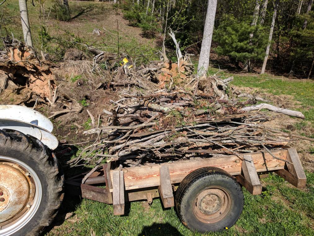

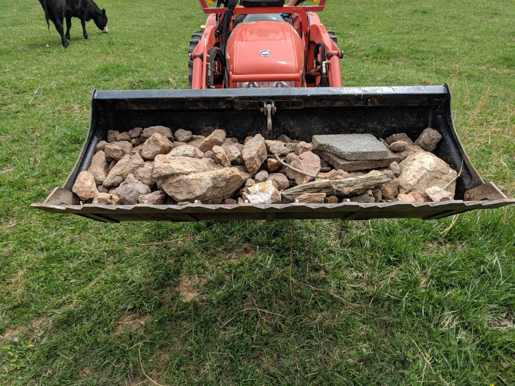

Last month I spent 2 weekends (only half days - I'm fat & lazy) picking up rocks & sticks so I can bush hog it this year. My rule was anything big enough I wouldn't want to kick it, then pick it up.
I moved 4 loader buckets like this one in the first shot (note the blue ribbon prize winner in the front left) all picked up by hand.
And 3 trailer loads of limbs. sticks, roots, and branches like the second shot.
3/4 was hand loaded (the rest I did manage to get with the grapple) and all hand unloaded. (Which reminds me, I REALLY want a dump trailer)

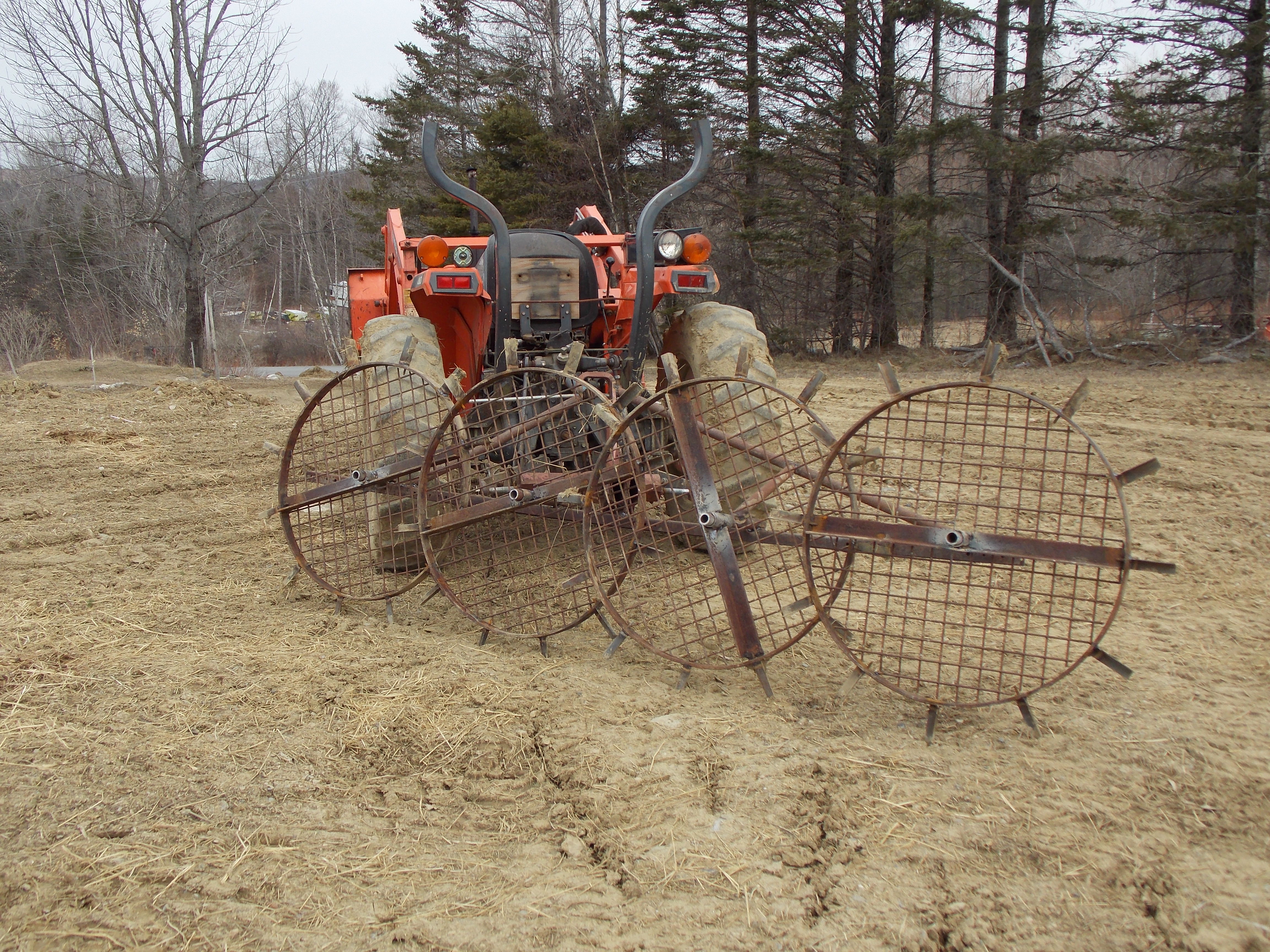

I clear a lot of land, so I built a rock and root rake to help window rocks and sticks. I just built it, and so far my only test has been removing sticks from an existing hay field that logging messed up with scattered limbs everywhere. It worked well for that, but I see no reason why it would not work well for plowed ground and rocks too.
