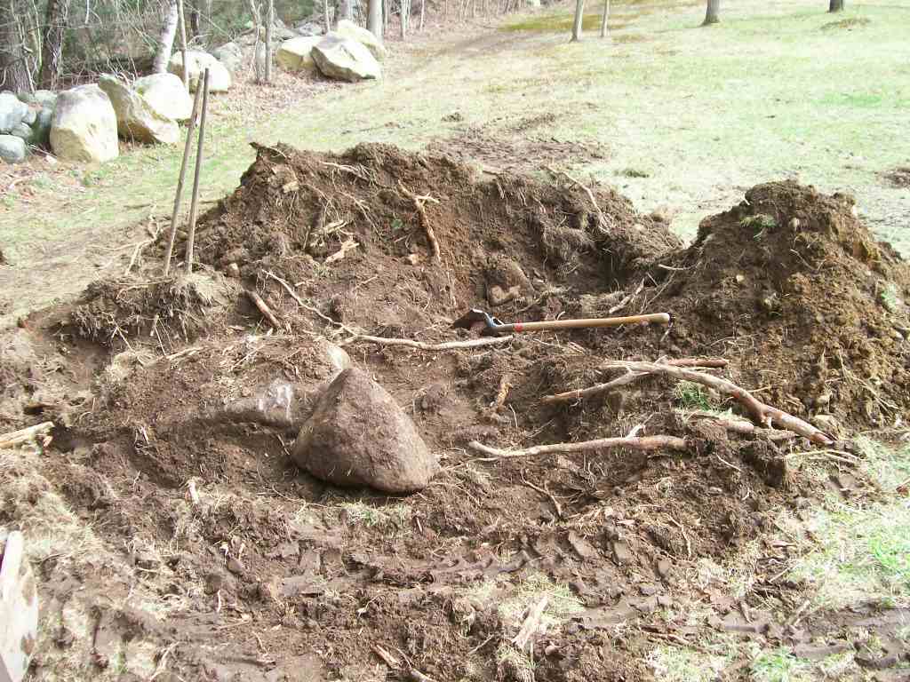

I found many rocks that I couldn't push, or lift with my BX. Usually though I could get the lip of the bucket under them, throw a chain around them, and back to my bucket hook, and curl the bucket just enough to keep some tension on the chain. Driving backwards, I pulled some pretty fair rocks that way since the bucket acted like a sled. Did less damage to the yard that way too. Here are a few I moved that way. The ones I am talking about are the ones rolled against the stone wall in the background. The shovel in the picture will give you some idea about the size, but they are perhaps 4' across.

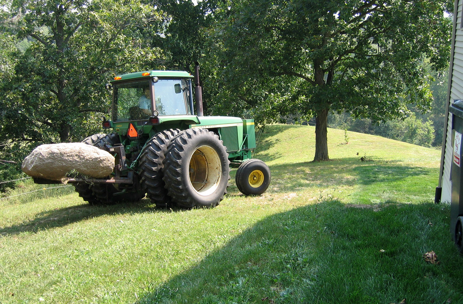

I think moving rocks is all relative in size.... This one kept pulling the front end up, so the entire move was in reverse...

Ok, back from vaca. It seems I left 2 minutes ago. The stone boat seems the way to go. Its reduction in frictional forces seems to make the difference in moving a rock or not. Many good methods here. I Like the chain and curl metod Chuck uses. Seeing Andy in Iowa who's rock lifted his behomoth tractor didn't make me feel so bad as my rock seems only a bit smaller. I heard about the fire and burn method and wonder of it is also functional on rocks partially sticking out of the ground. probably not a I'm thinking the ground acts like a heat sink. Just trying to avoid digging a hole around such stones. I loved everyone's pictures . Just something about manipulating something that looks impossible to manipulate.
