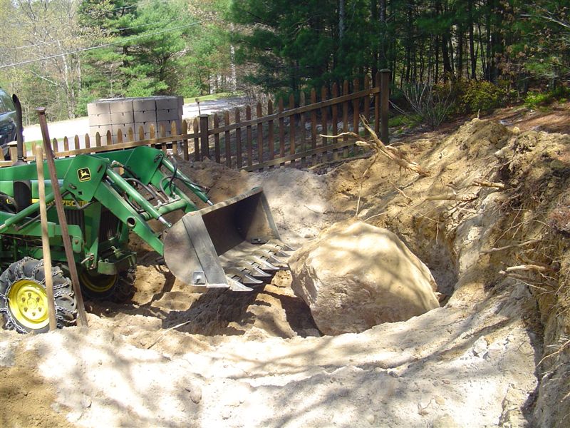

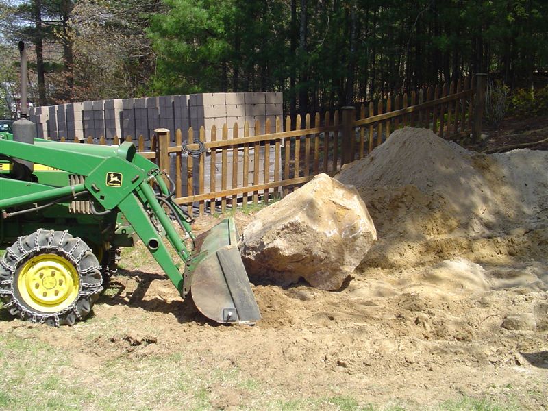

This is a job at my daughter's house that was going well until I hit this rock which was just a little bitty thing when a tooth scraped into it. I had to dig around the rock to budge it. No matter how I tried, the bucket would not even curl this thing. I am doubting if anyone makes a tractor in the 25-32 hp range that would of picked up his stone. If granite weighs 200# per cu. ft. I estimate this stone at 1400-1600 Ibs. If I didn't roll it , it was going no where.

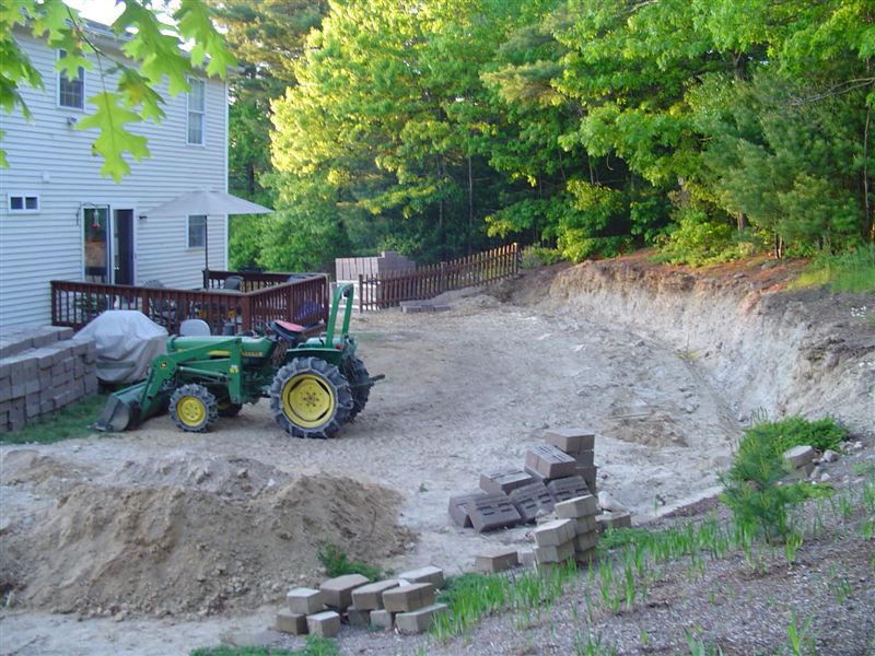

The last picture shows the completed job that without teeth, wasn't happening.

I guess the other option would have been to dig next to it & try to bury it.

My toy tractor would have been able to dig around it but there it would have stayed. There is one just like it in the access road to the play farm. I got it dug out but that was all and had to bury it again. It's now about 2 inches out of the ground and does not present a problem.
My other option would have been the impact hammer drill followed by feathers and wedges.

Next time try whipping together a rock boat to drag the stone instead of rolling it. This would likely incur less damage on the lawn. An old piece of metal roofing works great.

you could use some forks on th 3pt that would probably get it out of there....
/ Rock is too big #9
Rock boats are great - and you can move very large rocks. I use an old car hood.
/ Rock is too big
This rock was so heavy, unless the sledge or boat had wheels, this thing prevented my tractor from going anywhere unless I rolled it. When I got a bite on it and attempted to push it, I'd go 3 ft and stop, wheels spinning. Forks on the 3 pt seems like an interesting notion. I do wonder if even this method would of worked. I have to look up the capacity of this tractors 3 pt. This job had an interesting strata of clay, gravel and then sand with about 1000 other rocks ranging from bushel size to softball size. I wish I had the 5400 for even 15 minutes. I'm sure it would of made this job alot easier. The teeth worked great for picking out all of these stones. If I didn't reinforce the cheap JD materials bucket, this job would of ripped the bucket to pieces

No wheels needed. Before I had the 3320 I moved many boulders with my 1980 JD 110 garden tractor. If that setup can drag an 800 lb. rock (flat ground mind you) you could certainly pull much larger boulders with your tractor. Where I used an 8' oak plank to lever the rocks around, you could roll it onto the boat with the loader. I have also seen the old car hood used with great success as another poster mentioned.

Winch it up on a trailer. That is a gorgeous rock for landscaping.

I just read an interesting technique in a reference training manual CurleyDave recommended. It says you can dig around and below the rock (or stump) that's too big to lift out, partially refill with the loose dirt, then roll the boulder back and forth. Keep replacing more dirt and rocking the boulder and it will be slowly raised to the point where you can roll it out of the hole. Anyone tried this method?

Red Dirt that's exactly how I got the rock out of the hole. I had to do this about 4 times before the rock was leveraged out of the whole using the rock and fill method. Good size rock there 3RRL. I did not try dragging. I had to roll the rock with the fel to get it out of there after I dug around it by hand. Being a case of too much weight for my size tractor, it made me wish I had a larger tractor even though the tractor has performed fine for my use 60 gazillion other times. It held up the job for half the day using hand tools. Fortunately it was a one off and no other rocks that size were confronted.

According to my wife, it still didn't reach the size of the ones in my head that she has to shove around and she has no tractor for that. I told her I could git her one which went over like the size of the rock I took out.
Love that picture 3RRL. Looks like I could of used the grunt your machine puts out. My rock was just too big for my bucket which looks like you're in the same situation. I couldn't push mine either as my wheels would just start spinning as the rock got a bite onto the ground. 3 ft then stop. All my logging chains were at home and thought that if I couldn't push it I couldn't drag it either but that may have not been the case looking at your pic.
