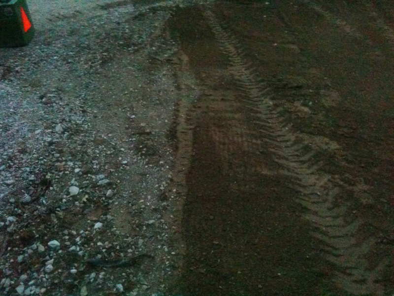

Dan, I'm firmly on the 'team' with Steve when he says using a rock bucket is really hard on hydraulics and the loader. The rock bucket you are considering is going to work only for softball/grapefruit sized rocks that can be picked up in loose soil. Even then, the solid cutting edge at the front of the tines is going to be a hindrance to picking up stones. It will collect and push a solid ridge of dirt that will tumble the rocks forward in front of the bucket until you have a mound of material big enough so that the blade undercuts the mound. Any kind of irregular surface will compound the difficulty. Unless you have a flat plowed field with dry sandy loam soil and baseball sized rocks on the surface, I'd look for another rock bucket. You just cannot use a rock bucket like a regular loader bucket. You HAVE to think of the rock bucket in terms of one or two rocks at a time that get collected in a basket.
Rock buckets like the Bradco have pointed tines for digging under imbedded rocks. They also have a "basket" behind the tines so that you can keep rocks from rolling out of the bucket while you tilt the tines downward enough to undercut more rocks. Unless I have a pile of rocks, I almost never get my rock bucket anymore than 1/4 full before transporting and dumping its contents. The size of the bucket just allows you to repeatedly curl the bucket and have the rocks roll around and shed dirt. Think of it like putting a shovel full of gravel and sand into a sieve and then shaking the sieve to let the sand drop through. It's completely different from handling dirt with a loader bucket. Because of that, I have rock bucket that's 60" wide and I'd be plenty happy if it were actually 48" wide or less. The extra depth of the buckets is also a big advantage. You can easily see the tips of your tines for the best placement under rocks to pry them up. The only advantage to a larger/wider rock bucket is to be able to handle boulders.
Its your decision, but based on my experience, I would not recommend the bucket you are thinking about. I believe you'll be frustrated with it as a rock bucket. With an added grapple, it would make a great brush/cleanup bucket, but I don't see it being a good rock bucket except for the most limited conditions.
EDIT: Don't be fooled by photos like my attachments. It looks like the rock bucket is a great tool in those photos, but the truth is that I loaded 1/3 of the bucket with the tractor and the rest of them I hand loaded. If someone shows you pictures like this and says they loaded the rock bucket using only the tractor, ask them what turnip truck they think you fell off of.:D

Thank you very much, this is the kind of information that I have been searching for! What tractor is pictured here and what is its horsepower and weight? I was going with the 72" bucket simply because I wanted to use the QA on my Kubota MX5100. Kubota uses a skid steer type QA on this series and I can use a smaller bucket if it will allow enough space to utilize the QA. I assume Bradco or anyone else for that matter can accommodate this setup. I am off to check out their website now.

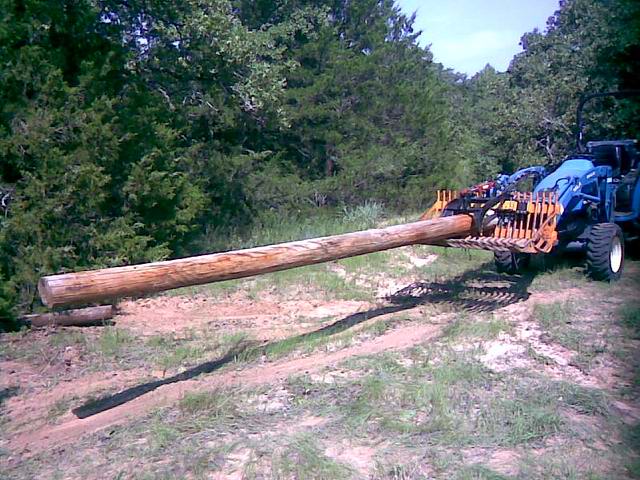

Dan, my tractor is a 45 hp New Holland with HST transmission. I don't think Bradco makes a 60" rock bucket like mine. My bucket with QA adapter and grapple weighs about 700 lb. I can lift about a half-ton of rocks or less. The grapple thumb is especially useful for large rocks where I can clamp down on them with the thumb and curl up to transport. Many large flat rocks are so big that they don't fit well in my bucket.

Yes, I've done tons of brush grappling. The sides of the bucket are somewhat limiting, but I can move a bunch of brush in a short time. I also use the bucket and grapple to hold trees while I buck them to size with my chainsaw. The uses are just as many as my creativity. I love it! You do have to be careful that you don't push a 3"-4" limb between the tines. You can bend them fairly easy. I keep a 3' section of 2" pipe handy. I slip it over the bent tine and use a tree to push the tine back in place.:thumbsup:

The tines on the rock bucket stick out far enough that I can roll a log onto the bucket and hold it with the grapple so that the sides don't limit me too much. Sometimes cleaning up building debris/lumber, the material would fit better with no sides, but the grapple just holds stuff in place. I was hauling some poles for a neighbor and ran into a problem. His trail went between trees that were too narrow for me to haul the poles side-to-side, so I had to get creative. The photo below shows my solution that worked perfectly.
