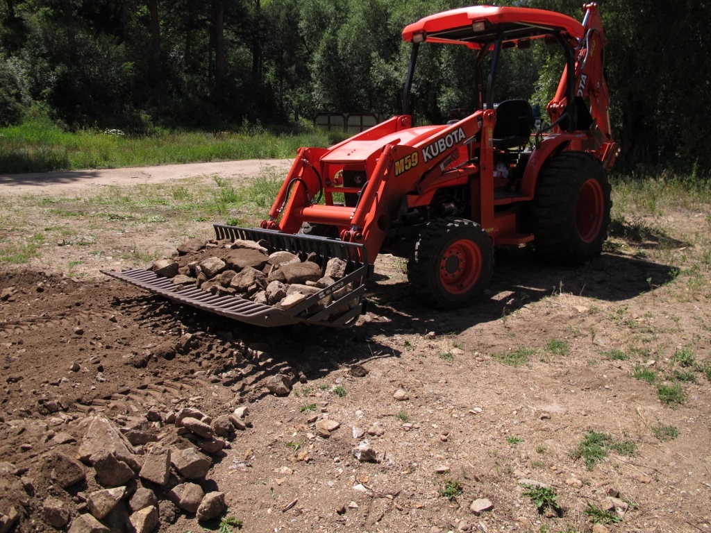

I'm back to searching for the perfect rock bucket for my use. My use > I use a slanted landscape rake to windrow rocks until I have a pretty good row of 2-4 inch rock ( mostly).
Then I want to use a rock bucket to scoop up the rock, shake them separate from the dirt and ditch em someplace. Usually in a rut where the water's been running off.
A long story shortened. I bought a Titan Toothed rock bucket that was not right for my use. Then I modded it and modded it some more and finally it was still just not right :cautious:- so I sold it to somebody who had a different use in mind.
I believe I need a smooth edge skeleton bucket about 72" wide.
Does anybody have a favorite manufacture that makes a bucket that fits my needs?

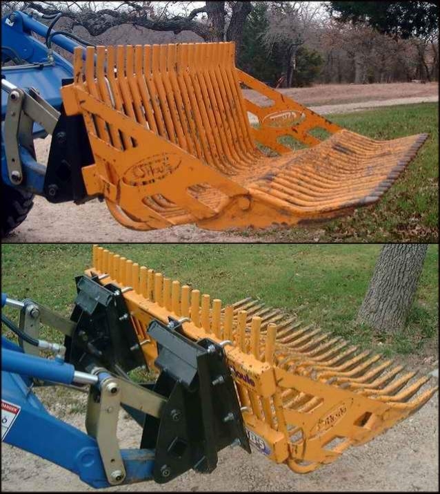

This one with the round tines from Bradco is my recommendation:
Good picture. That is my recommendation too. I am now on my third rock bucket, and the bradco round time is far and away the best. Rock buckets look very similar. If you don't have a lot of rock work to use, the flat bar beats a regular bucket. But the round time is noticibly better. It is also slightly longer tines, holds rocks better, and the spacing is better.
Houle makes one very similar.
I'll include a flat time just to compare.
Normally I see flat time types for about $1000. The round time type can cost twice that.
I never have used a flip screen. Love to try one sometime.
Bucket & rocks_Round Tine.JPGHoule brand rockbucket.jpgA flat tine Rock Bucket.JPG

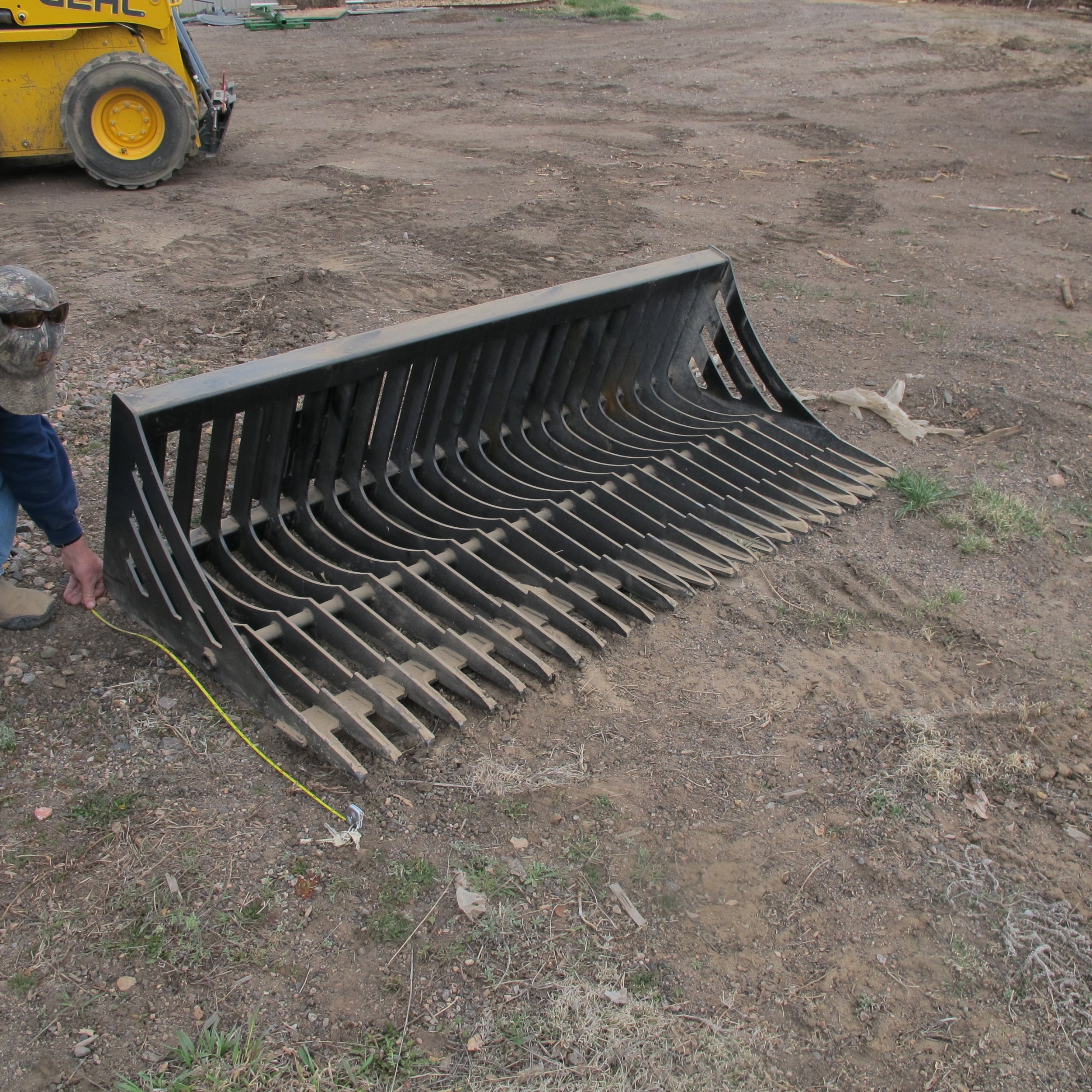

I pulled the trigger on a Spartan rock bucket with smooth front edge. My application is grooming flat hard ground or picking up piles of small stones after raking a paddock area. No digging out rocks. So the smooth edge will suit my use and offer the ability to back drag and smooth the area after the debris are picked up.
Now the waiting... :rolleyes:

The new bucket arrived. It's just 66" so I can use it on both the tractor (72") and the bobcat (60")
It is well made. Last you a lifetime. 2" spacing instead of the more common 3". Tines welded to the big smooth cutting edge out front. No chance of bending tines. This Spartan stuff is built right.
I can't wait to work it.

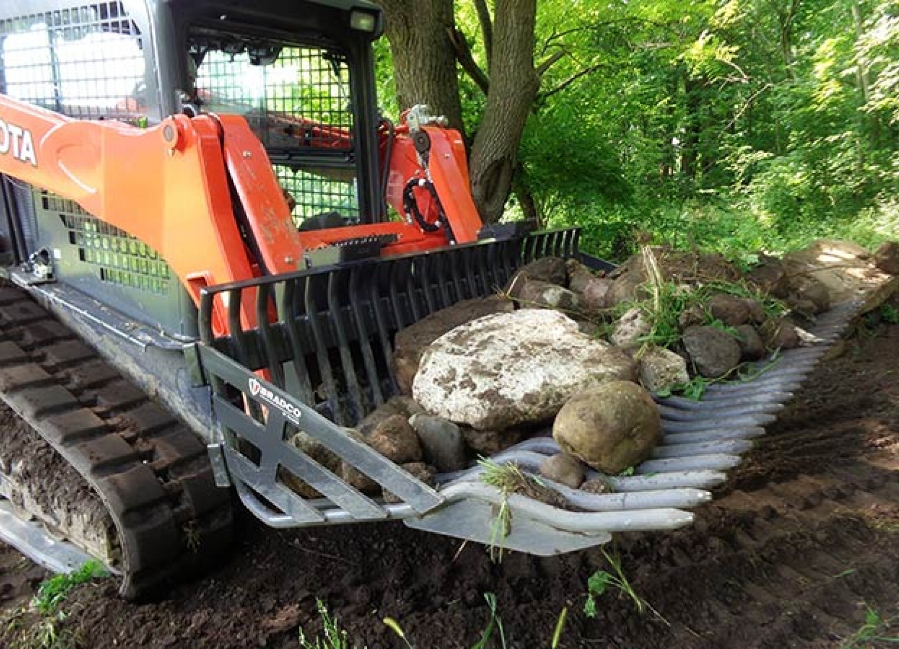

I run a 66 inch bradco, identical to xfaxman's in his picture.
Use the snot out of mine for rocks, sticks, limbs and trees. I use it like a salad fork to pick up and move trees.
Some of the rounds tines bend a little on the end, unlike the type with a toothed cut'n edge design. I favor the rounds tine design for raking, back raking and building piles of materials.
