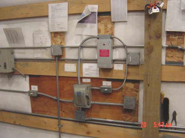

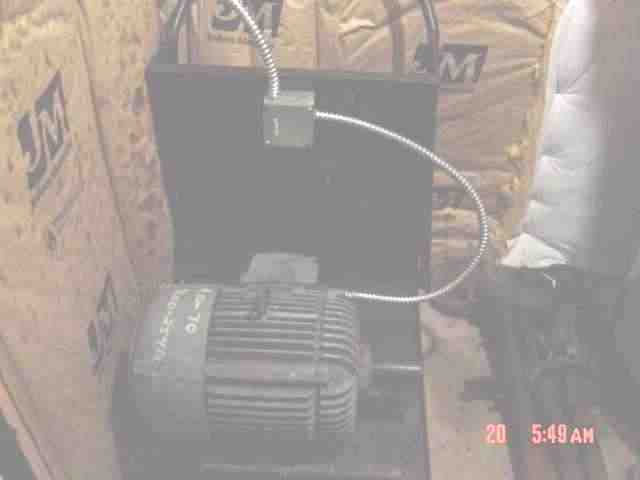

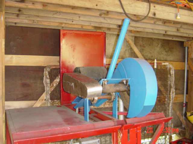

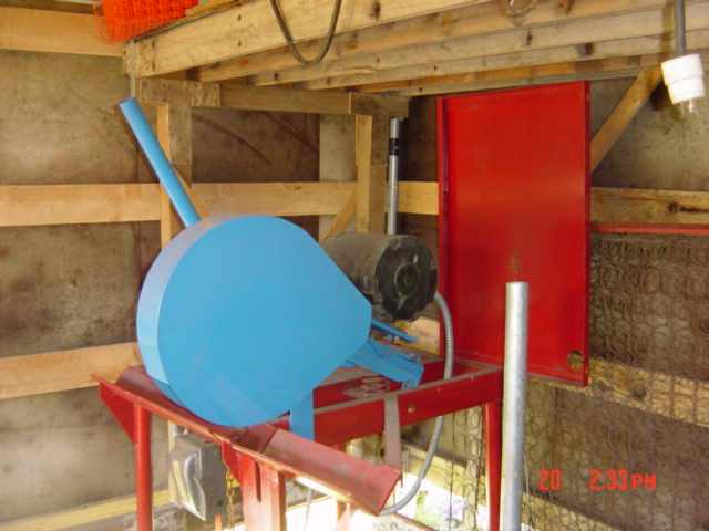

I assembled a phase converter about 30-years ago. I ran a 1-ton chain hoist, and a 18-inch chop saw I built. Mine has such a high pitch scream, it will drive you crazy in no time at all. :confused2:
