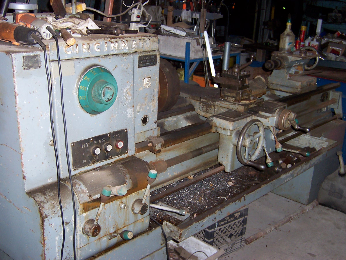

I'm running this 15' X 54" Cincinnati Hydrashift lathe (5hp) and 2 Scotchman Ironworkers (3&5hp) on a static converter that I built for $45.
3 Phase machines will use single phase for smaller electrical use items. For single phase they just use 2 legs or 1 leg and neutral for 120V.
My lathe uses 120V single for the relays that control the motor. When I first hooked it up I had the phantom leg in the wrong place and it would not work. All I had to do was shift the connections.
