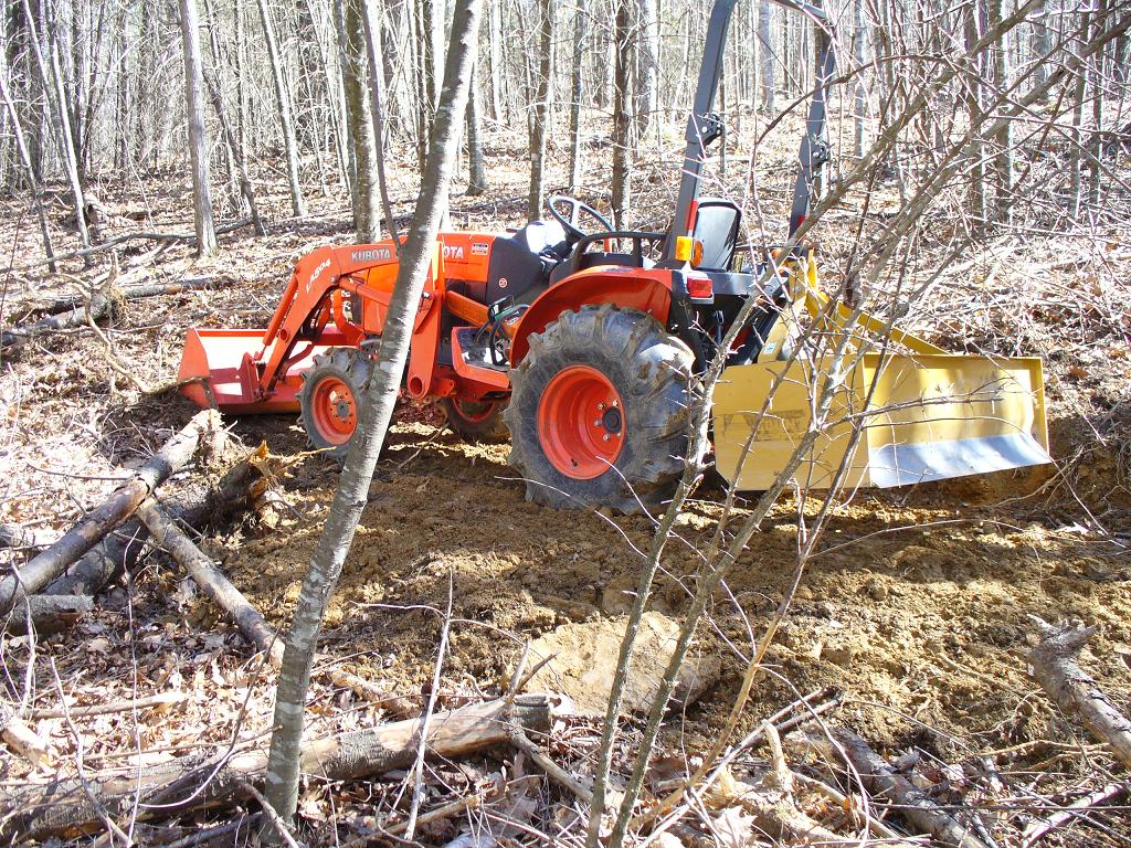

I often see a lot of questions on this forum about building small roads, trails, etc with a CUT so I thought I'd share my methods and pics. This first road is a connector from our main trail to another trail that goes around the top of the mountain. The original trail was steep and off-camber and wasn't suitable for anything but ATV's and tractors.
This is the site where the new road will go up and curve around to the right. The original trail is out of the picture, but off in the distance straight ahead:
attachment.php

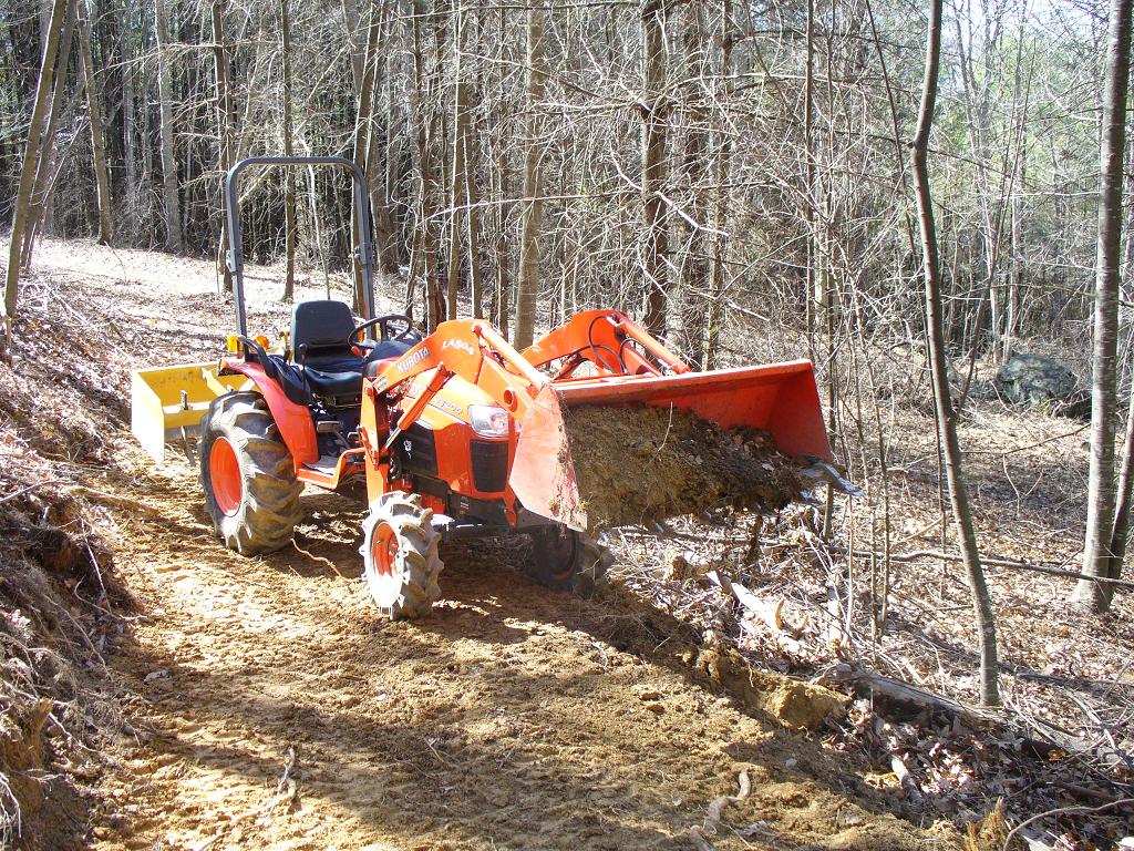

Starting to dig into the bank. I always start at a level spot and work my way forward, generally working up hill if possible. Cut a bit out of the uphill side, drop it in the lower side, compact as you go:

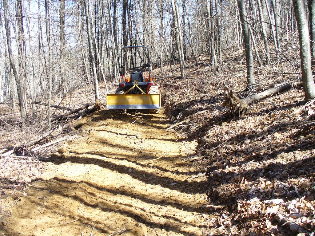

Road starting to come along:

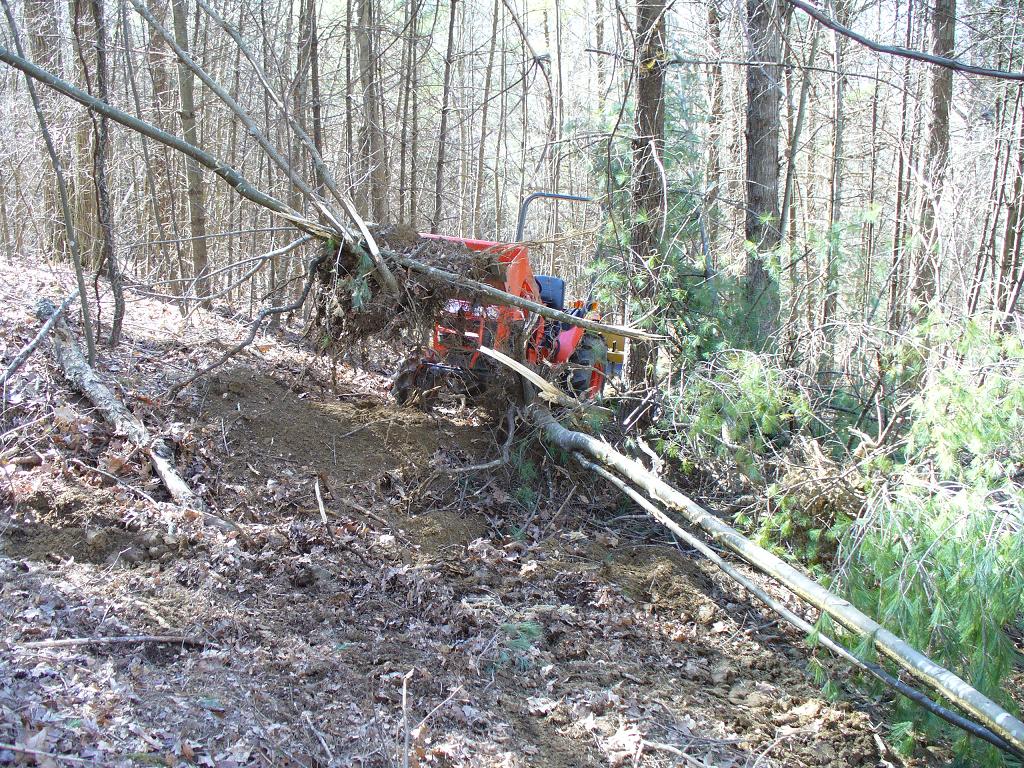

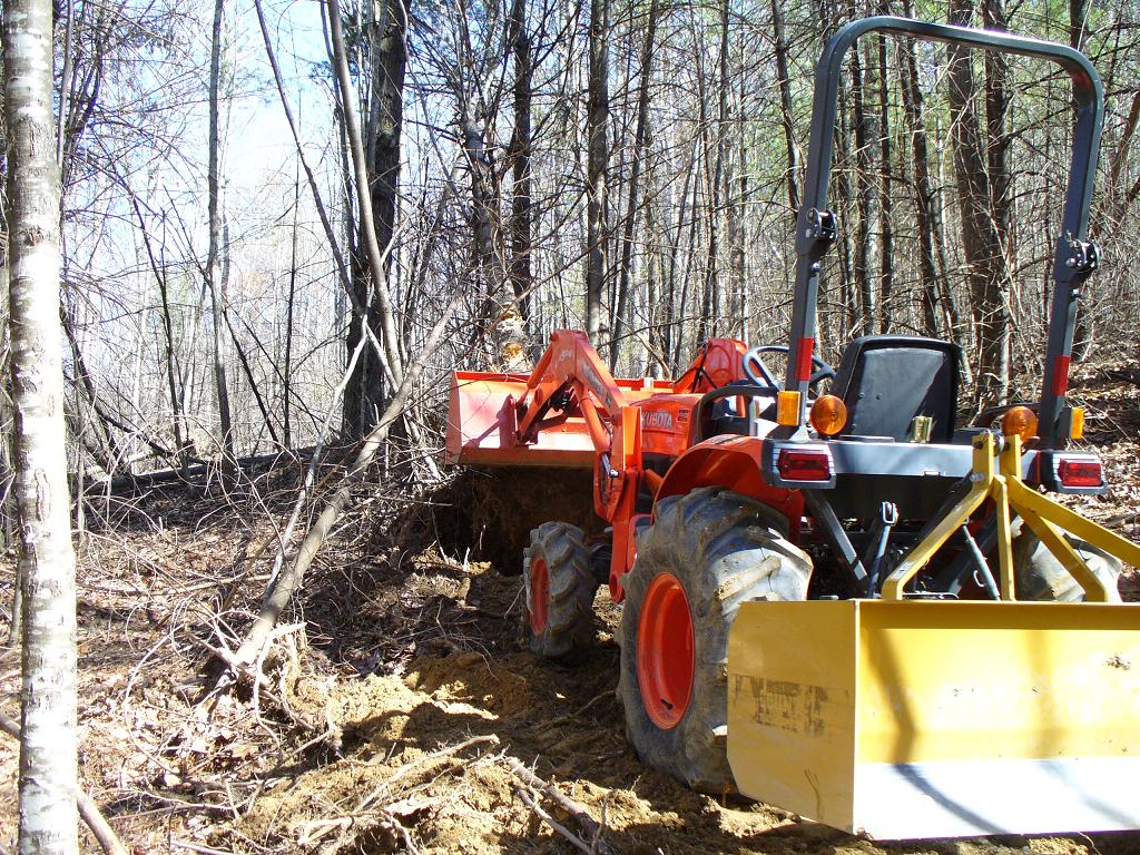

Continuing the cut. I push/dig the trees out of the way as I come to them and continue working forward until I can push them off the side:
attachment.php
Moving fill dirt to outer edge:

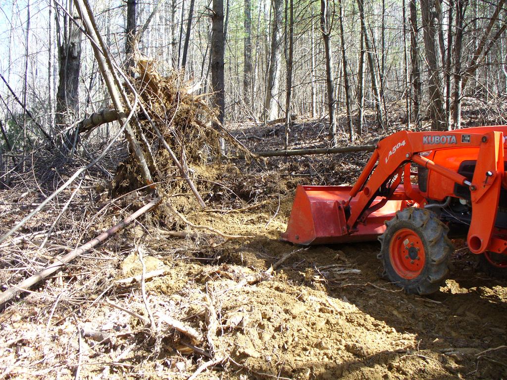

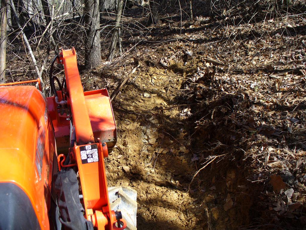

Came up to this pine right in the middle of my road, about 8" in diameter. A little digging and prying under the root ball and it gave up:

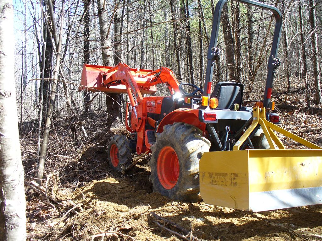

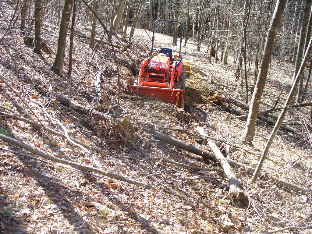

Pushing some remaining trees out the top. When you have too many trees you do end up with a bit of a tangle, but with some pushing and a little chainsaw work all the trees are out of the way:

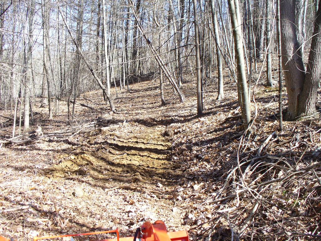

View looking down from the existing trail at the top:
attachment.php

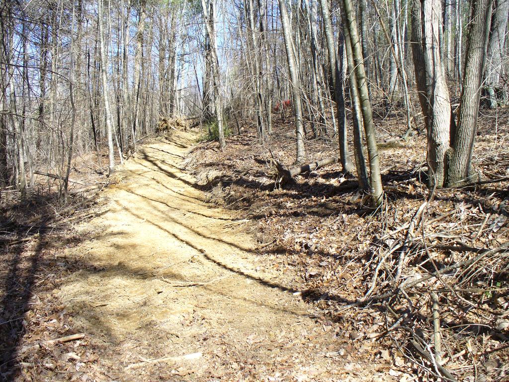

New road, top section:
attachment.php

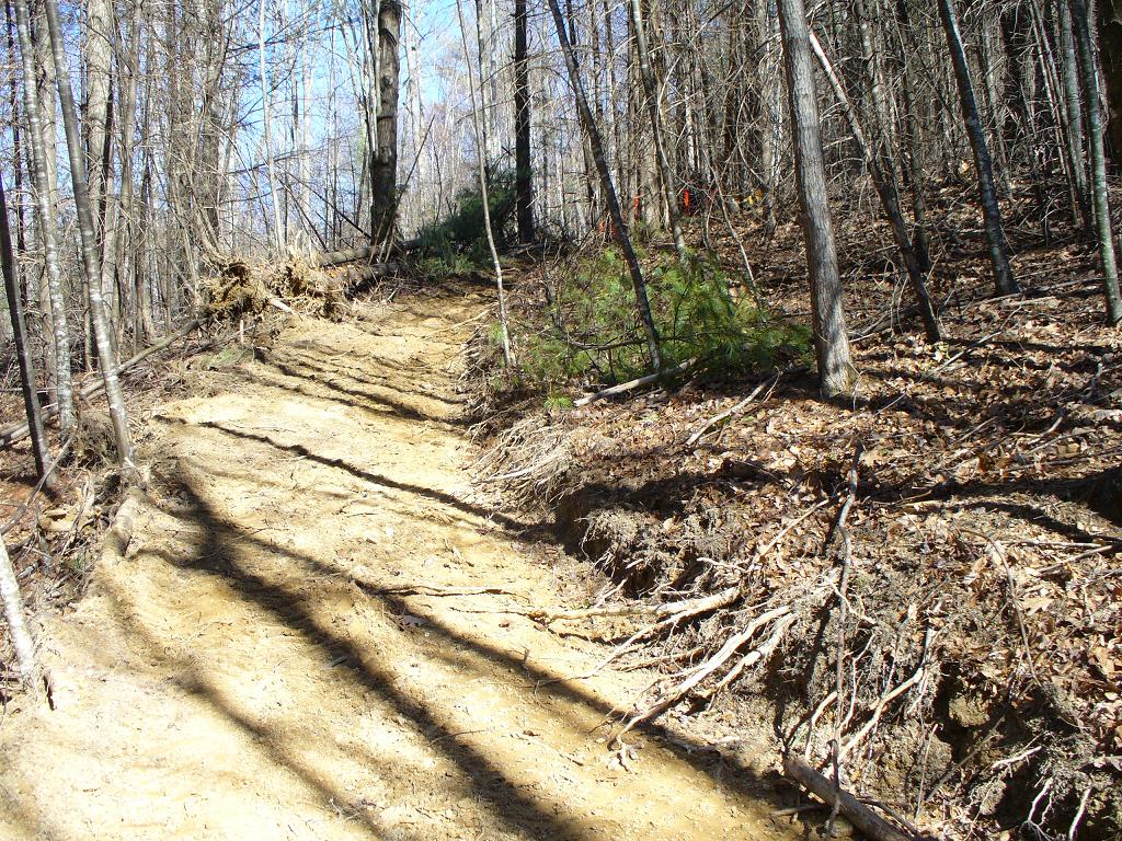

From the bottom:
attachment.php
Overall it took me about 2hrs to complete, however I do have a little finish work to do. I'll probably wait for it to settle for a while before doing any more on it. I've got numerous other trails and roads to build so I'll try to update this thread as I get more done. :thumbsup:
