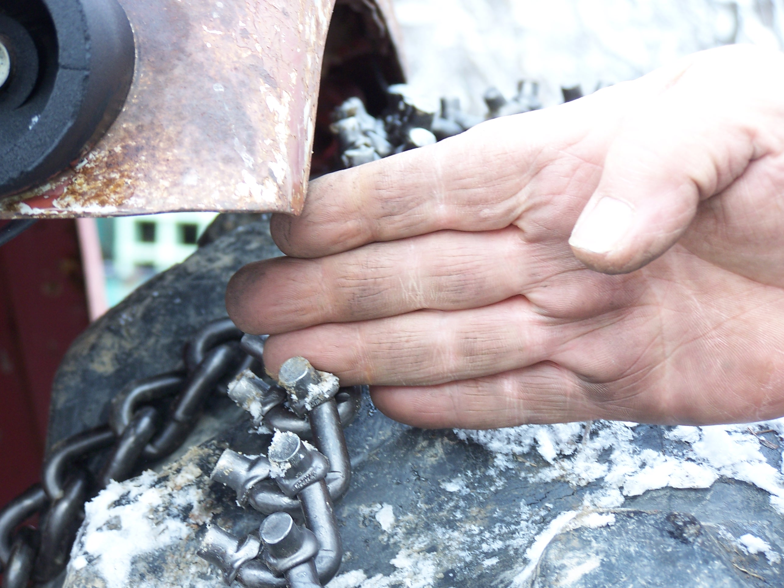

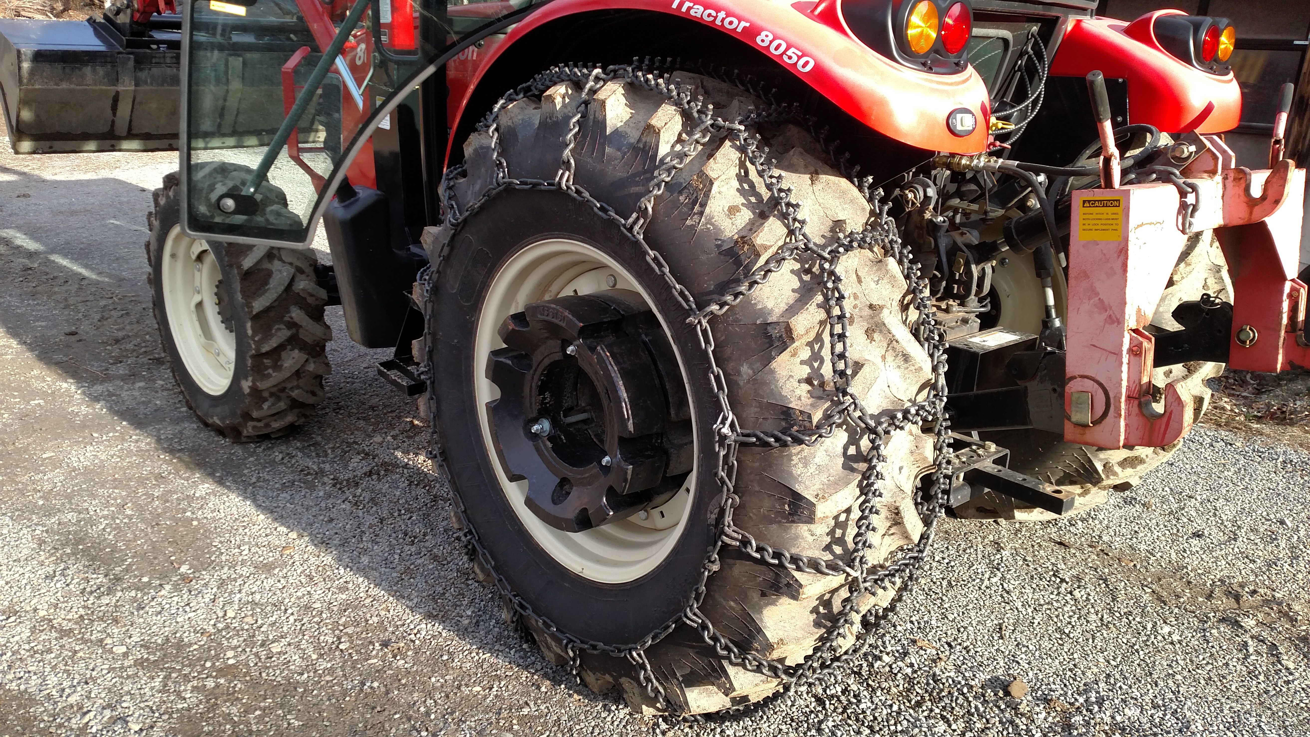

I have not found that to be the case,
mine and the ones on the farm see quite a bit of road use and we see none to very minimal damage,
the barn feeding tractor (Farmall 656) runs them all winter and goes thru the barn on concrete daily with no discernable damage.
They don't need to be spun if not spun they don't do damage.
The traction and ride behavior is so far past any 2 or 4 link cross chain type it is amazing,
the traction and ride over the dou pattern chains is 10 fold.
Yes, tire chains of just about any type will only mar a good concrete surface so long as the wheels do not slip.
Asphalt is a much different story. Studded or v-bar chains can damage asphalt even if the wheels do not slip.
