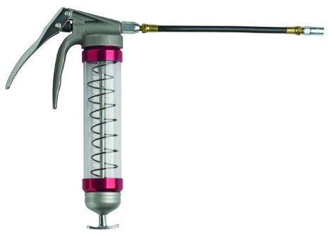

Results of trying to grease the front axle pivot on my Kioti:
Previously I had replaced the new grease fitting with another new fitting to no avail.
I lifted the front end of the tractor off the ground to no avail.
I then added my new LockNLube coupling onto the Lincoln pistol type grease gun . Using both hands I was able to get 3 full pumps of grease through the fitting- the first time in 83 hours this location has been lubed.
Woo hoo, happy day.

Are you saying the grease gun's end won't attach to the U-joint's zerk, and therefore won't allow grease into the joint? If so here is a possible solution: Amazon.com: Lincoln Lubrication 5883 Slotted Right Angle 90 Degree Coupler: Automotive
If that won't work for your application, post a pic of the zerk in the joint so we can see the problem.:thumbsup:

I think I got a bad one. Two were ordered, one from Amazon and one from the actual company. The price was the same for both.
Anyway, one of them works great. The other one slips off of the Zerk almost every time. The locking lever has to be held up (open) to get enough bite to hold the fitting on the Zerk. Even then, the pressure will "blow" it off the Zerk.

I am not sure if this will work or not, but try this on the bad one.. Pull back all the way on the outer shell, and then grasp the jaws with your fingers and screw it in (clockwise as viewed from the end). See if that helps any.. I am not sure how they are built, but it doesn't cost anything to try.

Well, I finally broke down and ordered one after reading all the glowing reviews from the beginning. I also decided to order a new grease gun to pair it with. I have 2 cheaper pistol grip guns and wanted a good quality 2 handed gun since the Lock n Lube will stay on the zert.
I did the same thing and it does work as well as others say. Also got 2 handed lincoln grease gun. By far worth the expensive price tag. It is a bit longer and hard to get into tight places. I have only used mine a few times but almost sure it will become one of those must have tools.

I had the same problem as yours and fixed it by doing what k0ua describes. The LnL has not slipped off since. Let us know how it works out for you.
