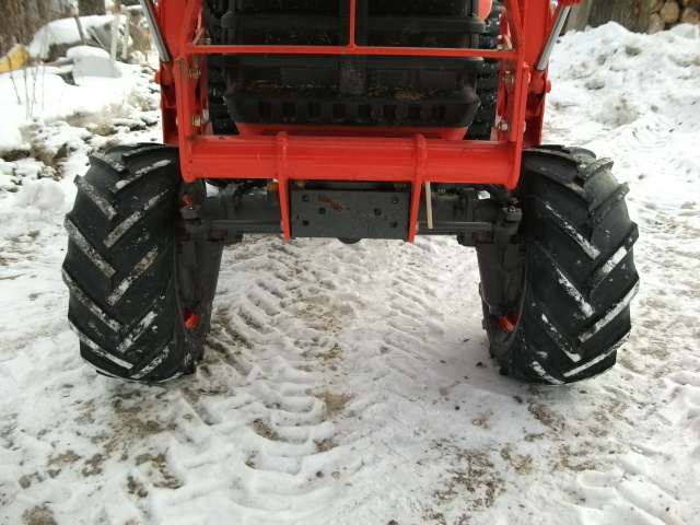

Here is a discussion from another forum. I solved this for myself using some 12" rims and R1 trencher tires I found that matched up to the static loaded radius of the R4's they replaced. The offset was a perfect match, got lucky, even a blind squirrel finds a nut once in a while.;) I had the R4's reversed for just a little while as seen on the last pic. I move rocks too.

You may not have suspension, but still as dww68 stated the front suspension pivots. So getting stability out of the front by increasing track width is far less effective than it is on the rear.
