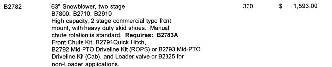

Here is the info you are looking for. Make sure read what else you have to add to have ever thing that goes with it.
Awesome, thank you. This had exactly what I was looking for which is this....

Another consideration, I'm not familiar with that front mount kit, but is the "manual chute rotation" accessible from the seat? It's hard enough to keep from becoming an instant snowman when blowing snow if the wind is wrong. Really need to be able to rotate the chute from the seat.
I'm assuming that you don't have hydraulic remotes, but an electric chute motor might be an option. It's absolutely essential that you can rotate the chute as needed.
From what I understand manual is standard but I agree with you, I will be upgrading!

Correction , I think . . . I was thinking you'd be mounting the snowblower on the loader. Wrong. You're talking about a separate mount and then you could use the loader valve to rotate the chute. That would work.
Still lots of trouble . . . But good luck with it.
