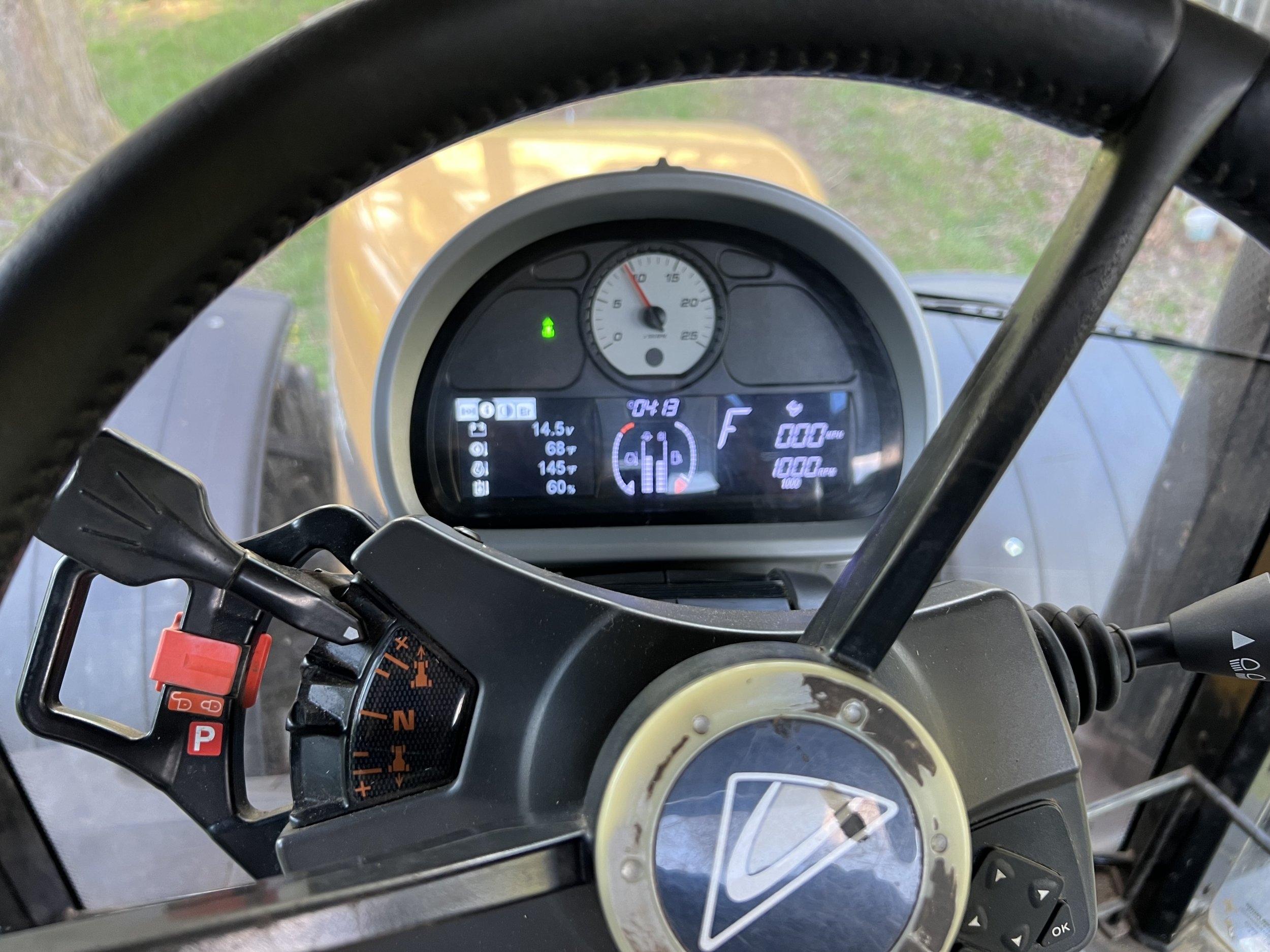

Made 14.5 at 1000 RPM
Made 13.8 at 780 RPM
Made 13.4 at idle
Made 12.5 with key off
