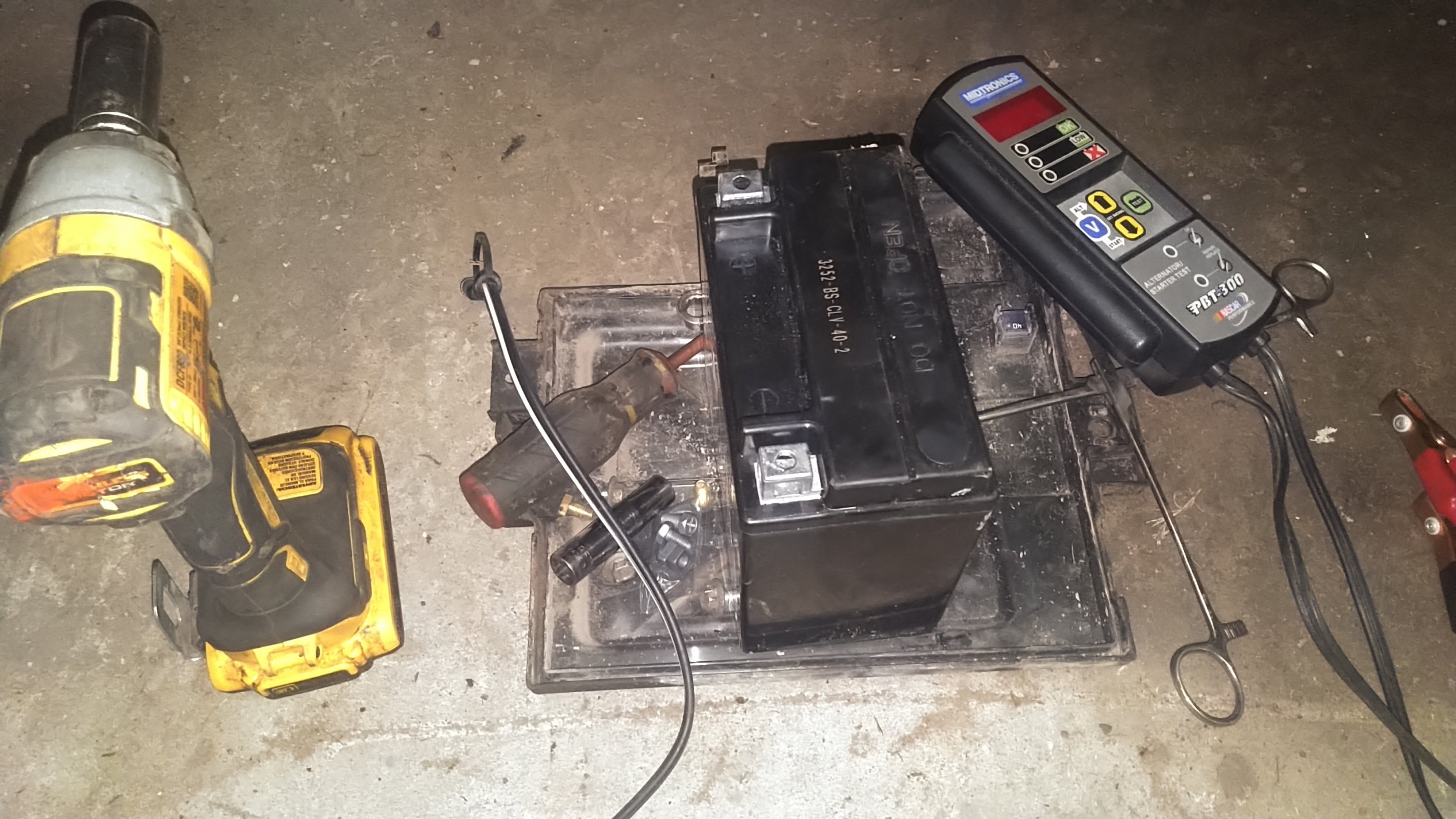

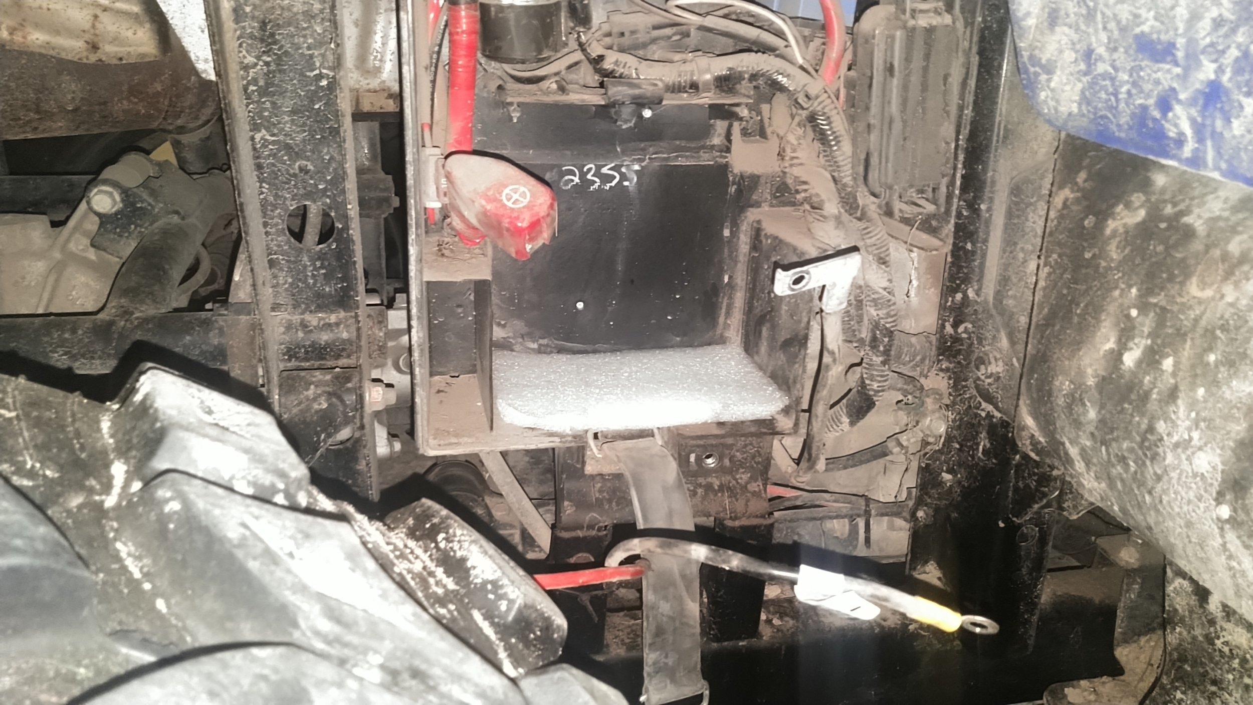

One thing I do know is putting an old piece of foam or rubber in the bottom of battery tray seems to help prolong the battery life, for vibration dampening, that and using smart trickle chargers. Got over 8 yrs of reliable use with a yuasa power sports battery all my equipment, boats, and vehicles have some sort of extra dampening on them. I also test every new battery I buy with a conductance tester before I install.

I agree with jjeff, I cut a piece of conveyor belt so it fits into each battery tray.
The rubber under the battery is a great idea.
Using the modern smart chargers--I use 3A and 5A Genius brand charger and getting 10-12 -13 years is typical. But I do fear batteries made the last couple years because I think they are made cheaper.
My dad taught me to use a small piece of plywood. I do this if the bottom of the battery compartment is metal. Many farm tractor battery compartments are plastic now which seems like it might be an improvement at absorbing vibrations.
