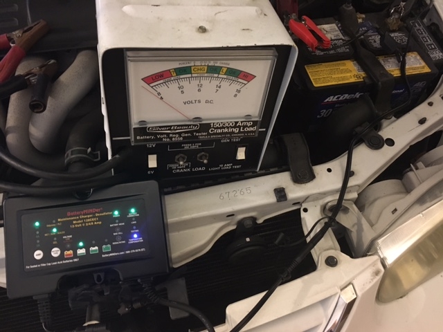

The batteries are at 11.1V now. I tried to start it yesterday and they’d barely crank. I’m about ready to chuck the damn things through the front window of the store…..
   / Returning batteries for warranty claim #129
I’m sure an overnight charge will bring them back to life, but will it last?
If my tractor is showing 13.4+ on voltmeter and I have no trouble light on as stated, why would it be alternator?
If charging overnight does the trick but the charging system of the tractor cannot maintain the charge, it is the problem.
If the batteries cannot HOLD a charge, they should be replaced. Tell the people at NAPA to charge it back up and leave it sitting for a day, then test. As you don't leave your tractor running all night, just so you can start it in the morning.

Haydude, at this point it sounds like you aren’t sure if it’s the batteries or the tractor. Do you have a good set from another tractor you can try?
   / Returning batteries for warranty claim #132
Substituting known good battery is a low tech way if you have one available.
Only once was I going to pull my hair out and I was sure it was the battery so bought new and only slight better so I swapped from the pickup and the whole time my problem was not the battery but the starter...
A 12 volt charging system should have a voltage of 13.8-14.2 volts with the engine running at 1/3 throttle. You have a charging system issue.
