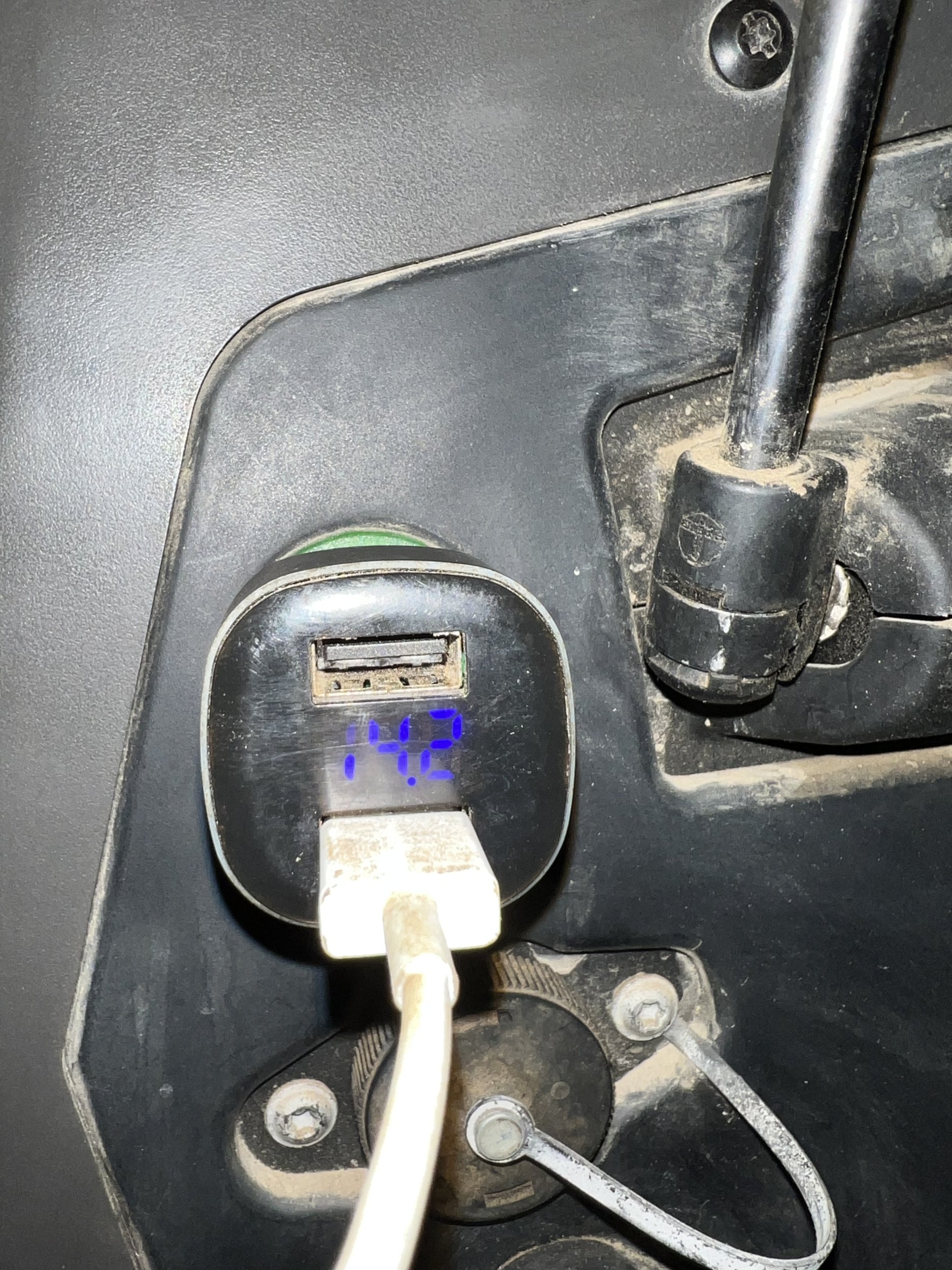

Quick update from the scene of the crime
I installed 2 new Deka 900 CCAs and it fired up in 2 seconds.
Making 14.2 at idle right now
