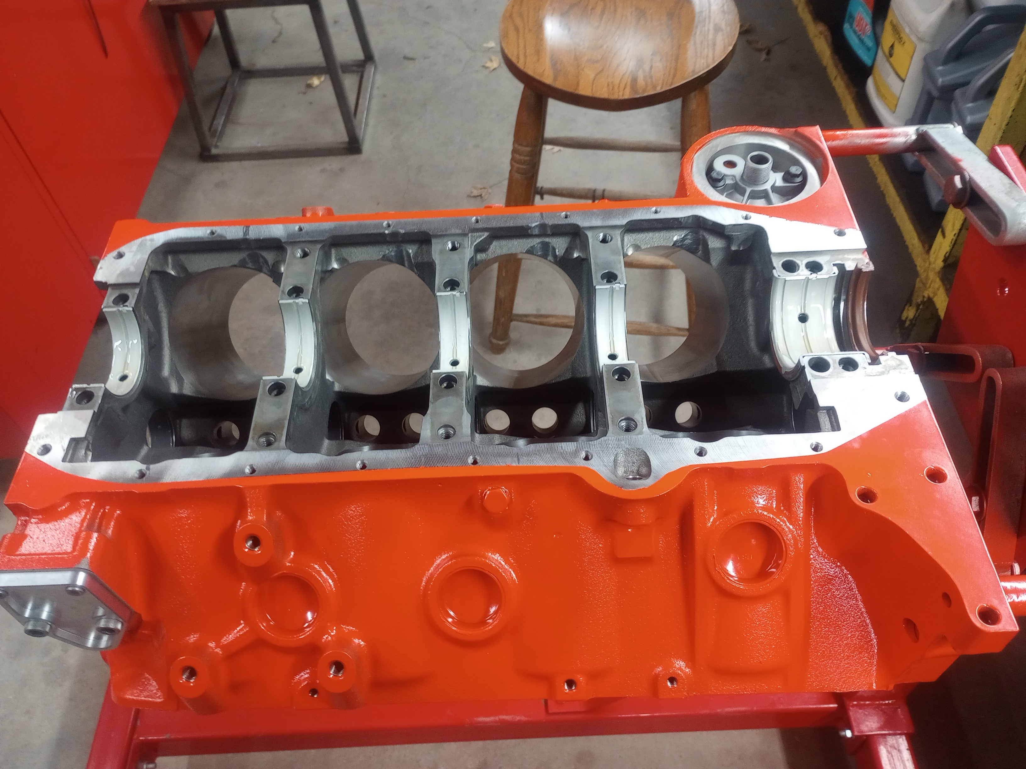

Pulled all the paper off the block today, it looks pretty good, really orange.
Spent about an hour chasing out all the threaded holes in the block, and there are a lot of them. Blew them all out with the air nozzle, the head bolt holes on the Dart block are blind instead of open into the water jacket like the stock block.

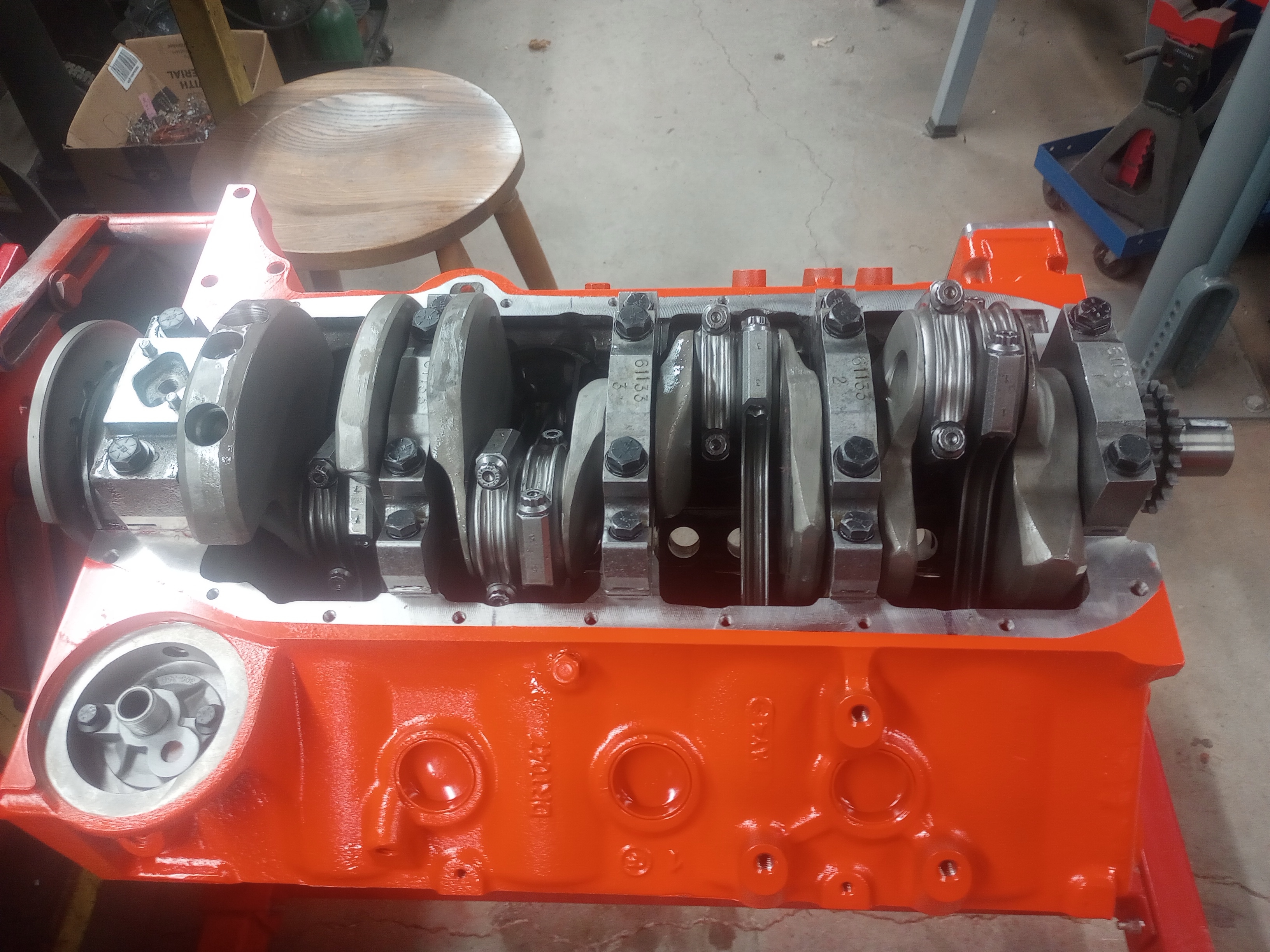

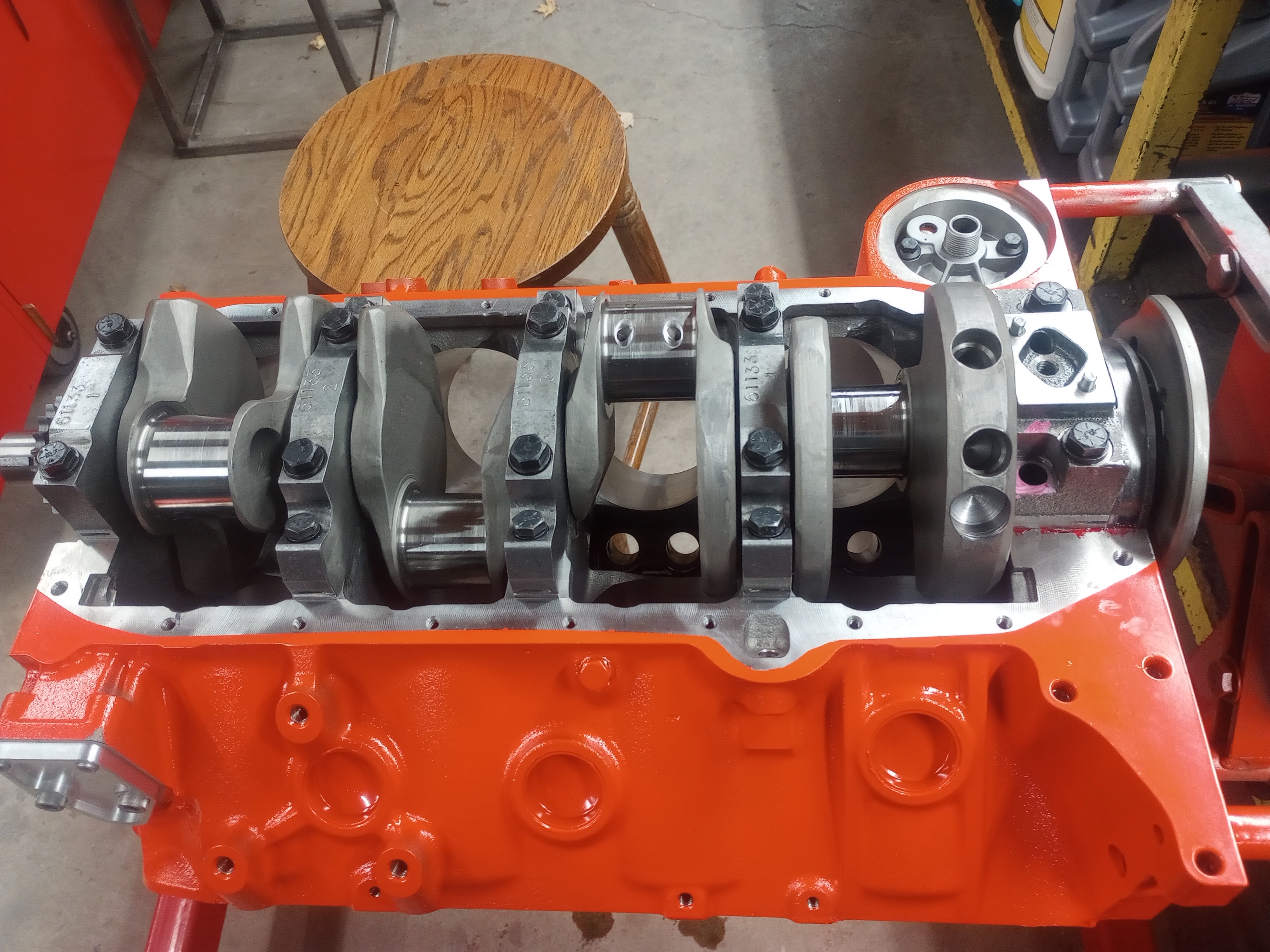

Unpacked the new main bearings and made a small modification to the rear main shells to get more oil the the thrust surfaces, a mod I've seen a few SBC builders recommend. Installed the rear seal half in the block and the rest of the upper bearing shells. Got the crank, wiped and blew it off, lubed the bearings and journals and dropped it in place. Installed the lower shells in the caps, lubed them and dropped them into place. Seated them in the block, installed the cap bolts, snugged them up, forced the crank forward and aft to set the rear cap and thrust bearing properly. Dial indicator show .005" end play, which is in spec. Torqued the 7/16" main bolts to 65 ft.lbs. and the splayed 3/8" bolts to 35 ft.lbs., as per the block specs. The crank even spins nice and freely, which is good!

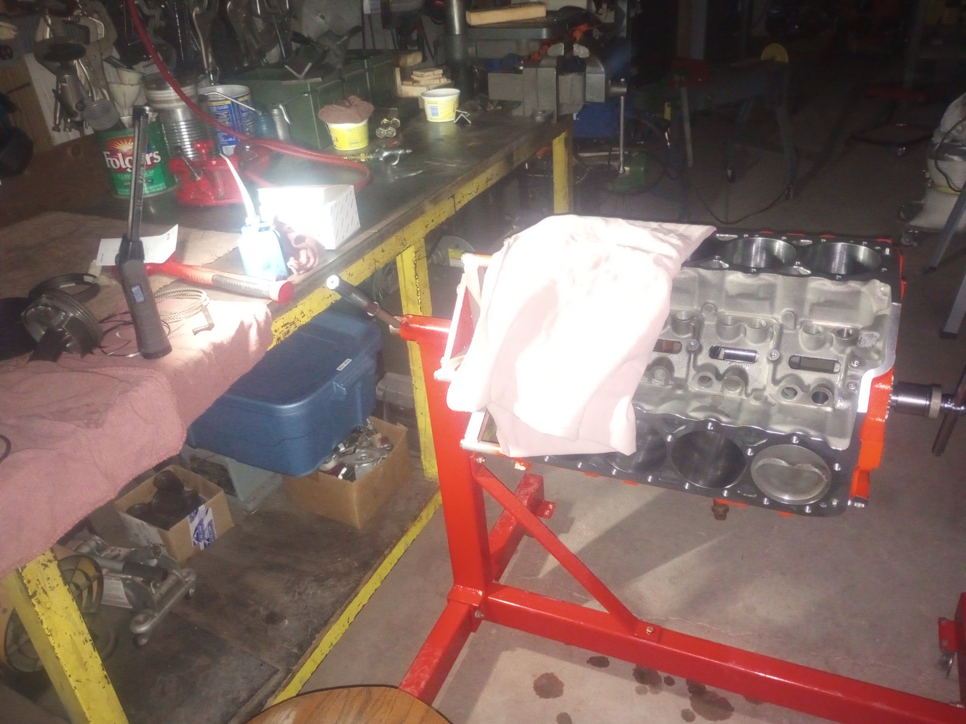

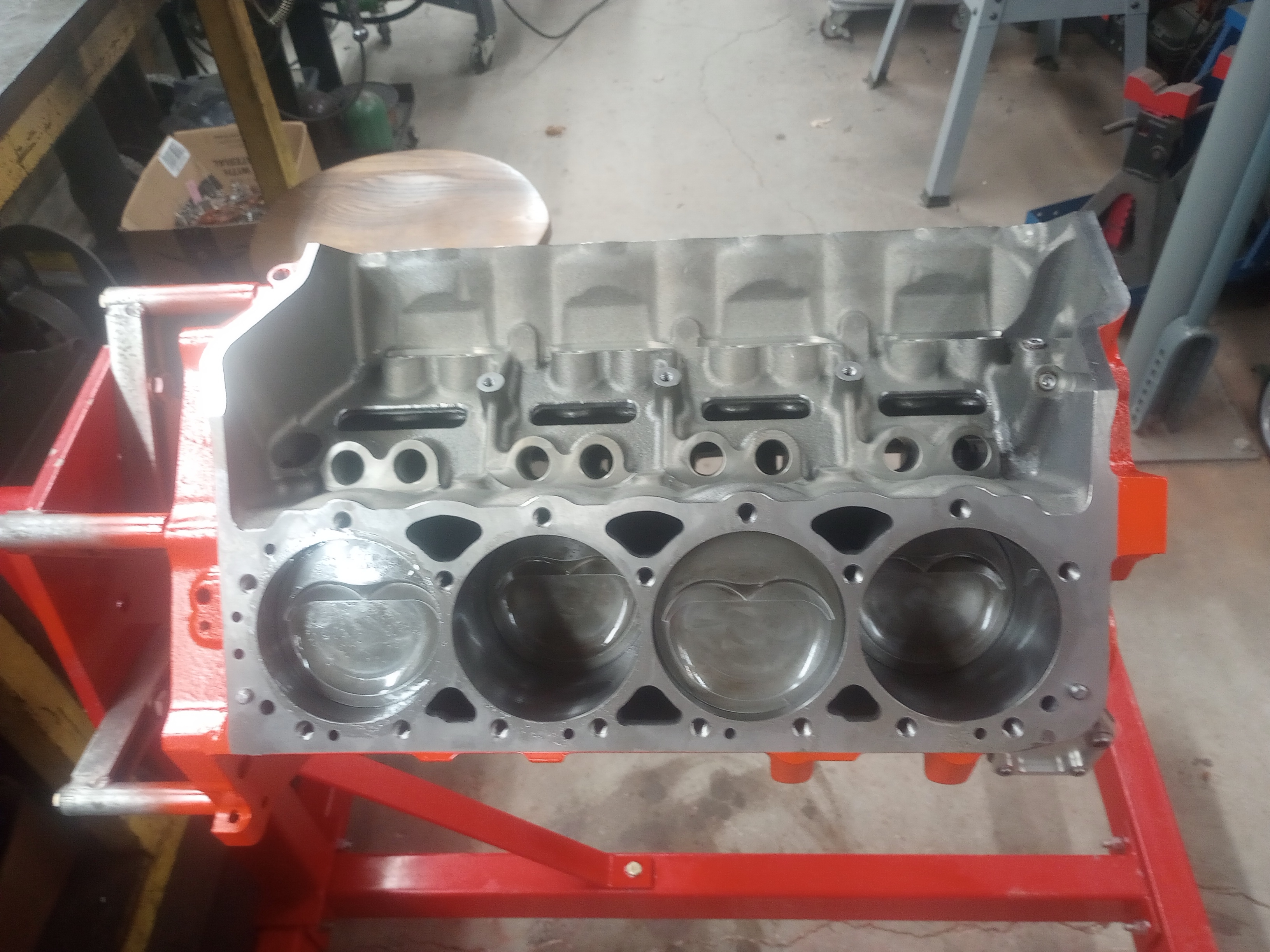

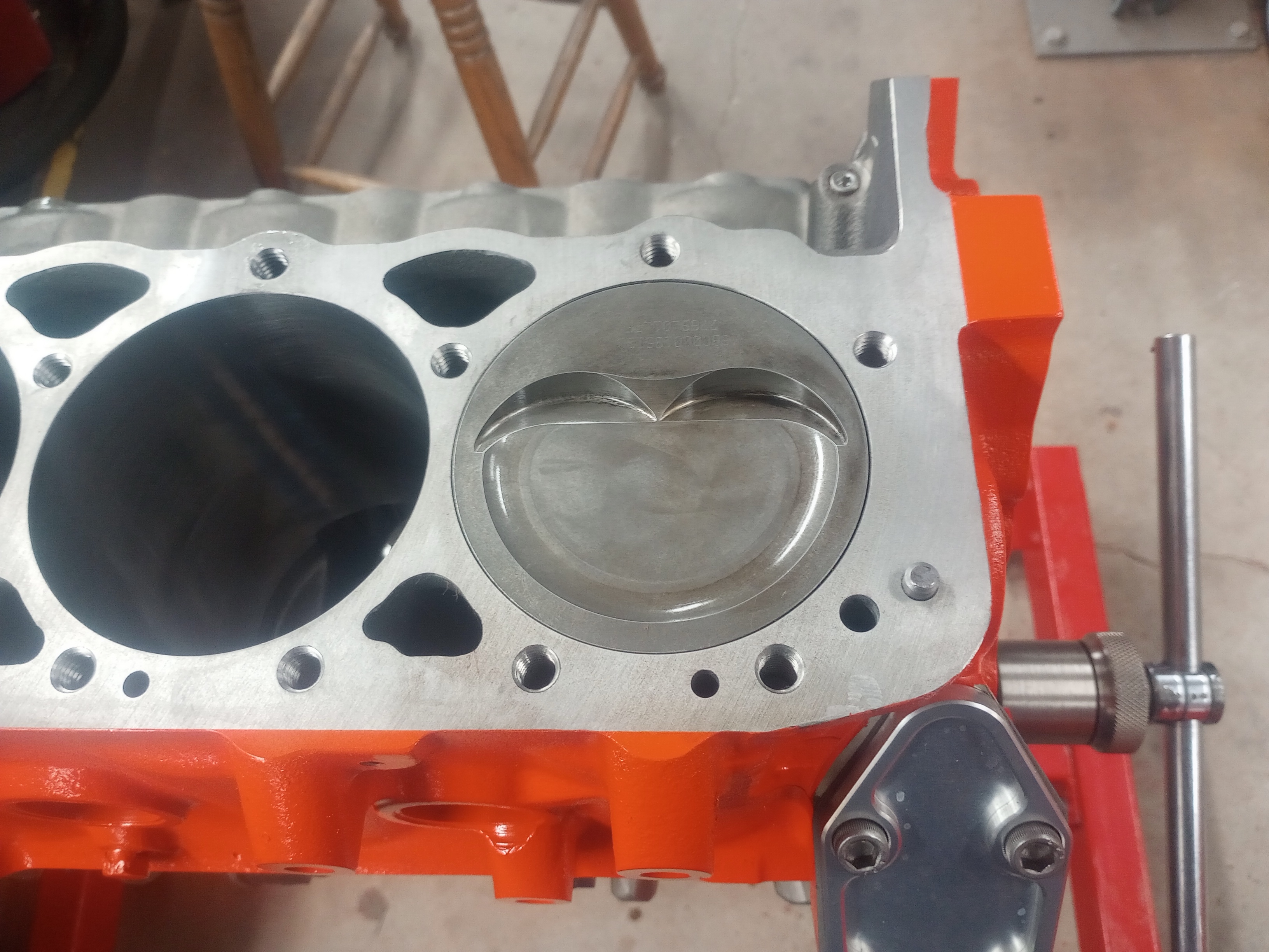

Got started installing rods and pistons today. Got everything assembled on the bench so I could get this done in an efficient fashion. The oil rings are really fiddly to get assembled and in position, In addition to the two rings and expander, there is a spacer ring that sets at the bottom of the groove to support the other rings where the groove extends into to piston pin bore. Getting all four pieces positioned just right is an exercise in patience, but I finally got them and the other two rings in place and installed into the tapered ring compressor. Installed rod bearings, lubed the bearings and crank and applied moly lube on the rod bolts. It slid into the block easily and seated onto the crank journal. Rolled the block over, attached the rod cap and snugger the bolts. I'll go over all the bolts once I get all the pistons installed rather than doing them one at a time.
I was fiddling with the oil rings on the next piston, when the lights went out. Power went off. Went outside and checked to make sure the fuse on the transformer for my house hadn't blown for some reason, but it was okay. Also checked the one on the pole at the end of the road that feeds the houses on the road, but it looked fine also. About that time I heard a couple of sirens leaving the fire department, so maybe there was an accident and someone hit a utility pole.
Rather that dig out the generator from the back of the shop, I decided to just wait and come back down after the power was restored, besides, I had a couple errands I could run and be back in a couple of hours.
Got back after 4:00PM and power was still of, so I checked the utility company's web side and it said power was expected to be restored around 4:30PM. Figured I'd wait on it, and it finally came back on about 5:15PM, and I was having dinner with a friend at 6:00PM, so that was it for the day.
Maybe better luck tomorrow.

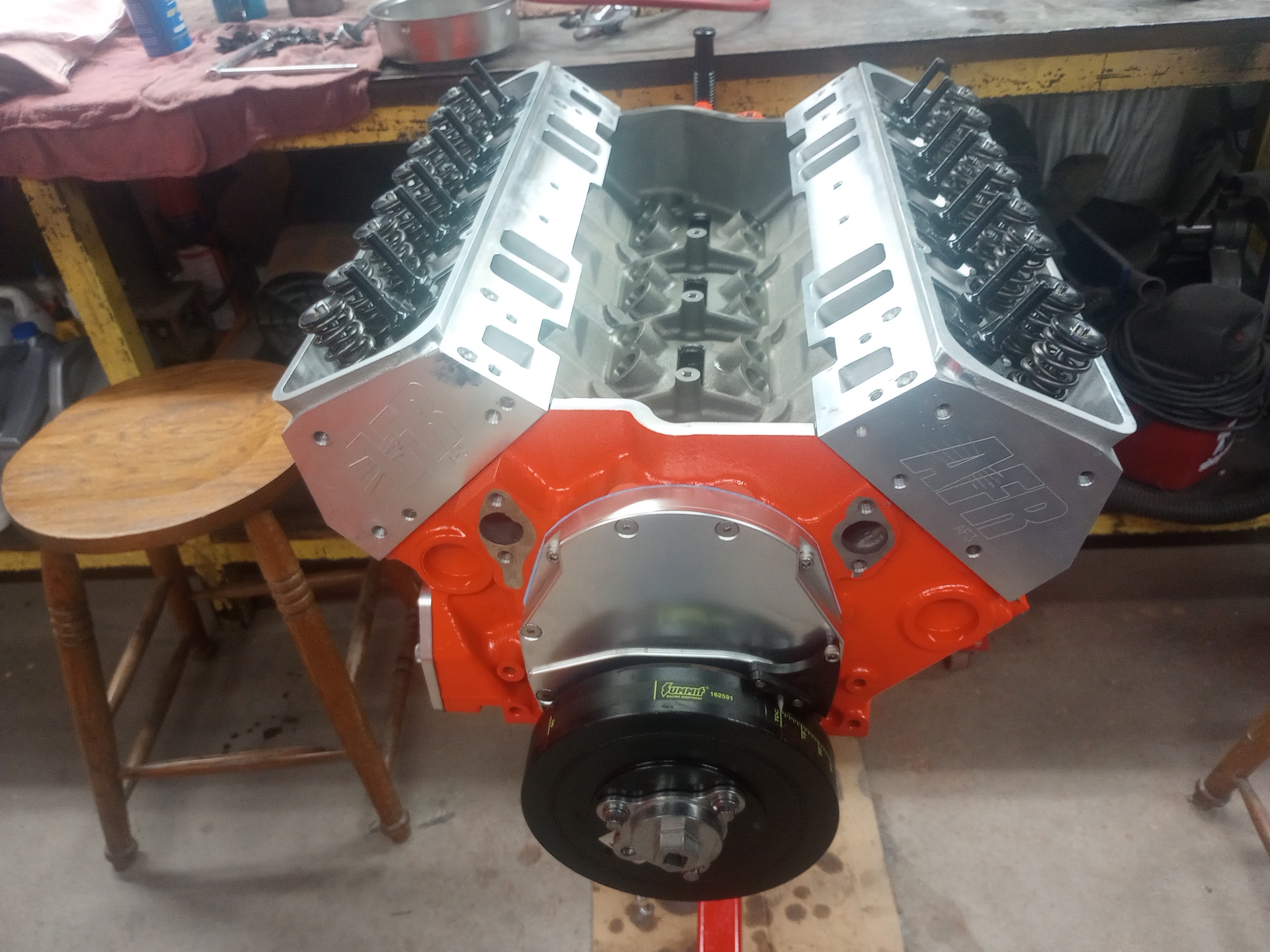

Got to work on the engine for a while this afternoon. I had gotten the rest of the pistons installed yesterday, and after running some errands this afternoon, I installed the cam, chain, sprocket, and timing cover. It's a two piece and when I installed the cover, the top three bolts that are 1/4" flat heads, were too long, and bottomed out in their holes. So, another trip to the hardware store for some shorter ones. Got those in and set up the degree wheel and checked to make sure top dead center is still correct on the damper and adjustable pointer. It was within 1/2°, so I put the damper on with an adapter that allows using a 1/2" drive ratchet to turn it over. I set the head gaskets on the block and set the heads in place, then installed the head studs. I got the ARP lube on the ones on the right side and got the nuts snugged down. Tomorrow, I'll do the left side and get them all torqued down. I get a little done every day.
