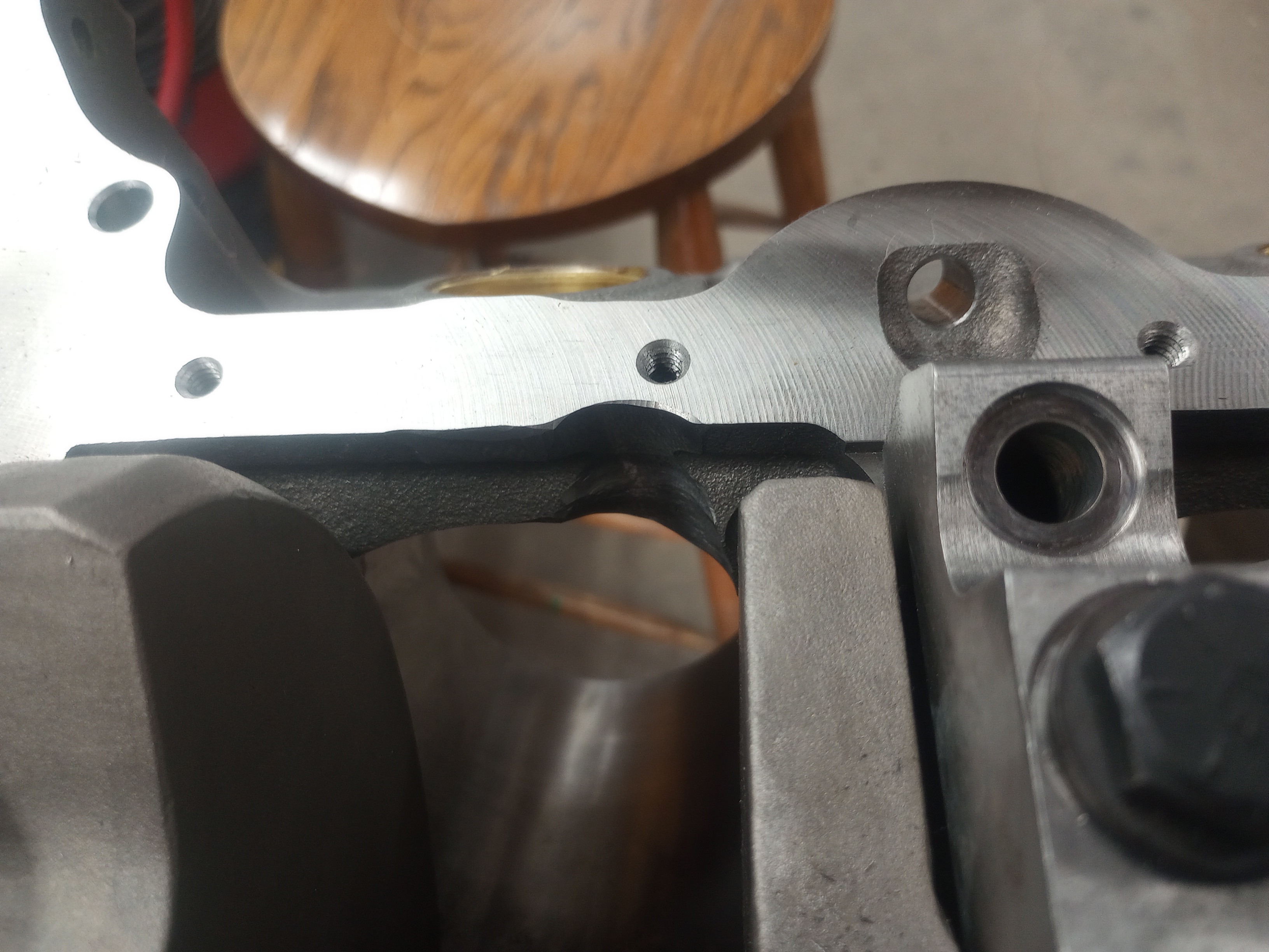

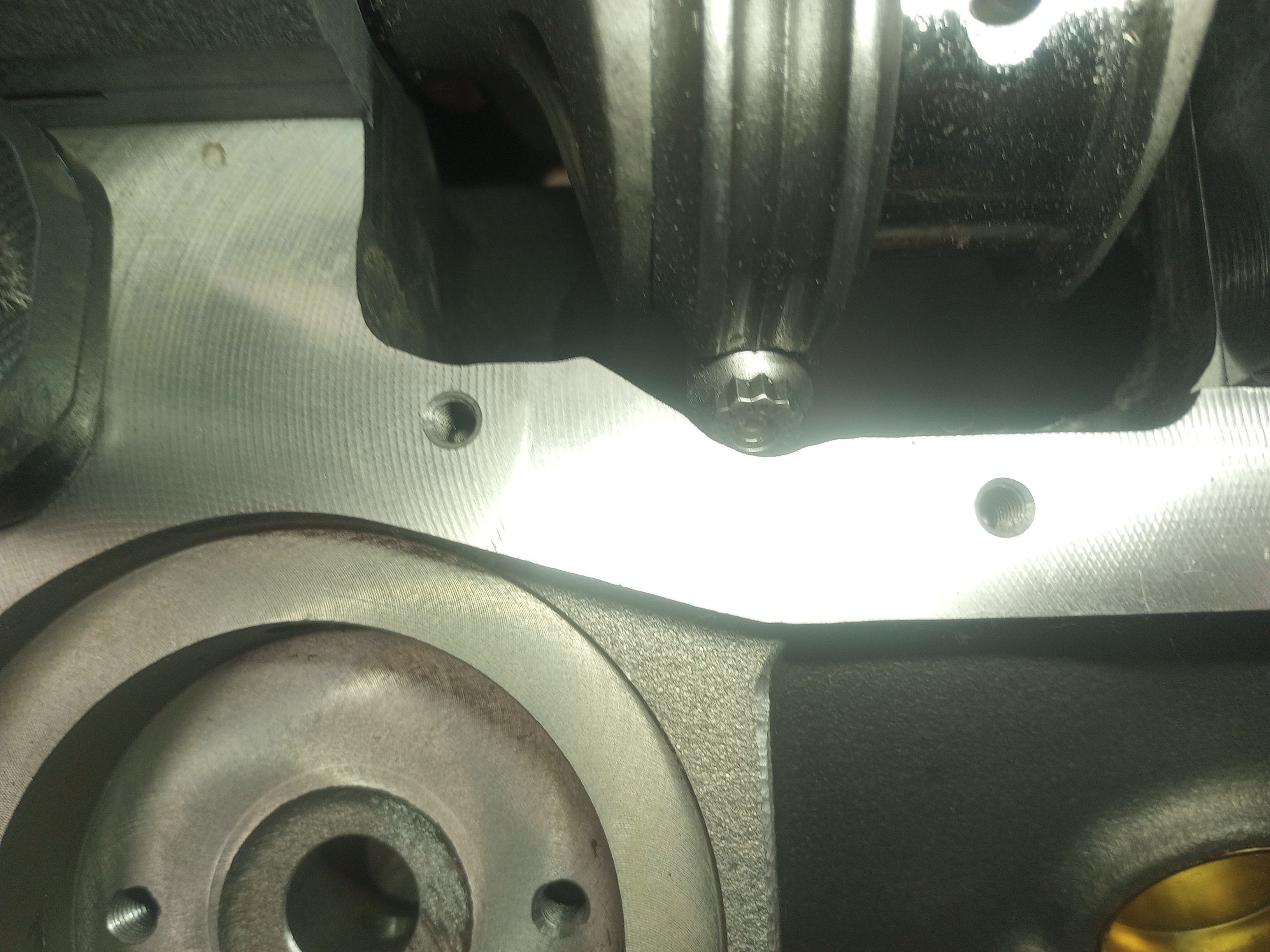

Then it was on to clearancing the block for the rods. I had thought the block would accommodate a 4" stroke, but upon investigation, it is only good for a 3.75" stroke without modifications.

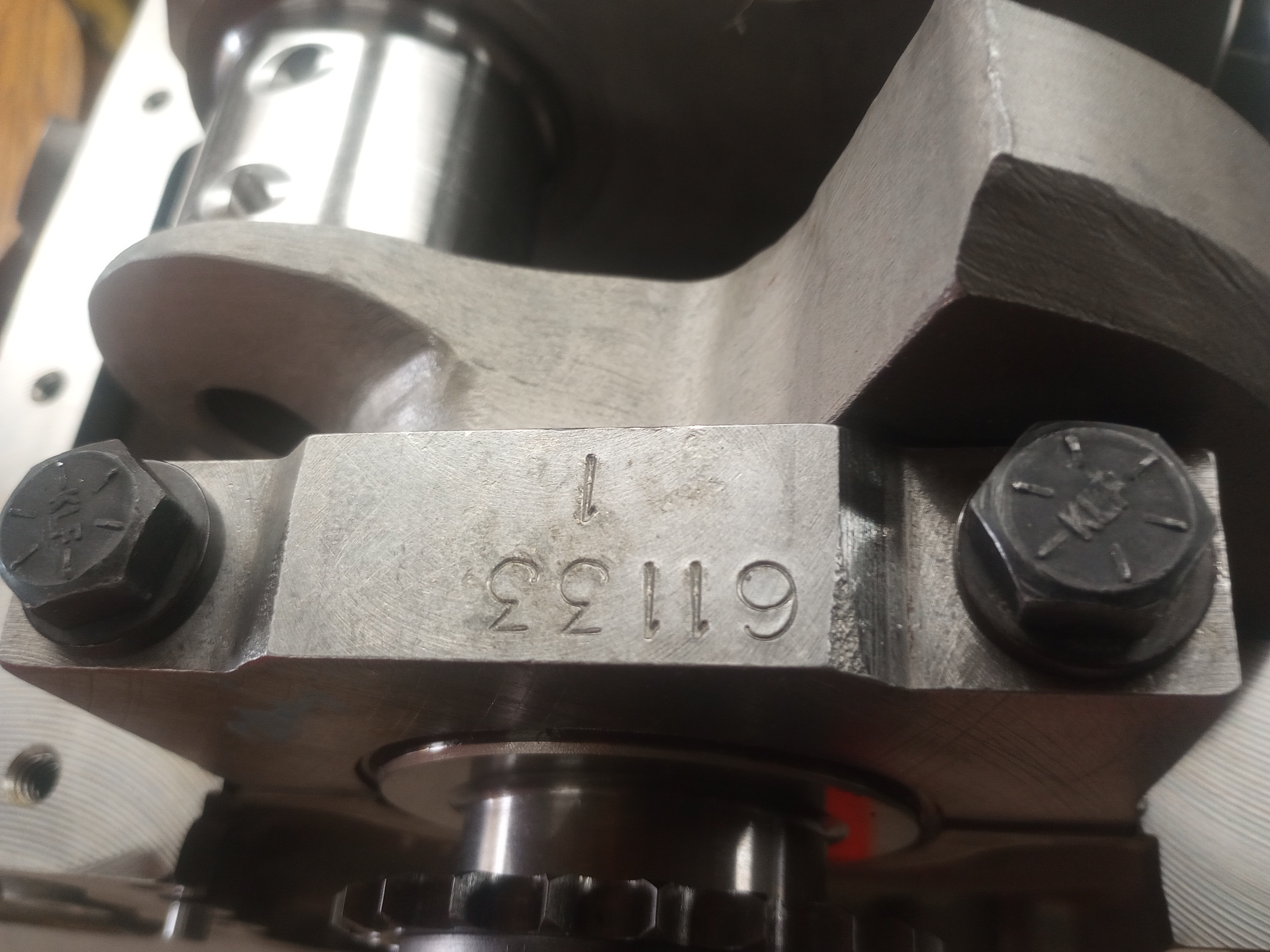

I installed the old main bearings in the block rather than use the new ones, and dropped the crank in. I set the bearing caps in place and when I tried to seat them in the block, They wouldn't seat without binding the crank. Hmmmmm? Since the caps didn't have arrows on them pointing to the front of the block, I installed the caps with the stamped numbers readable from the front. Wrong! Turned them around and they seated in place like they should, and the crank spun freely. That just seems nonintuitive and bassackwards to me.

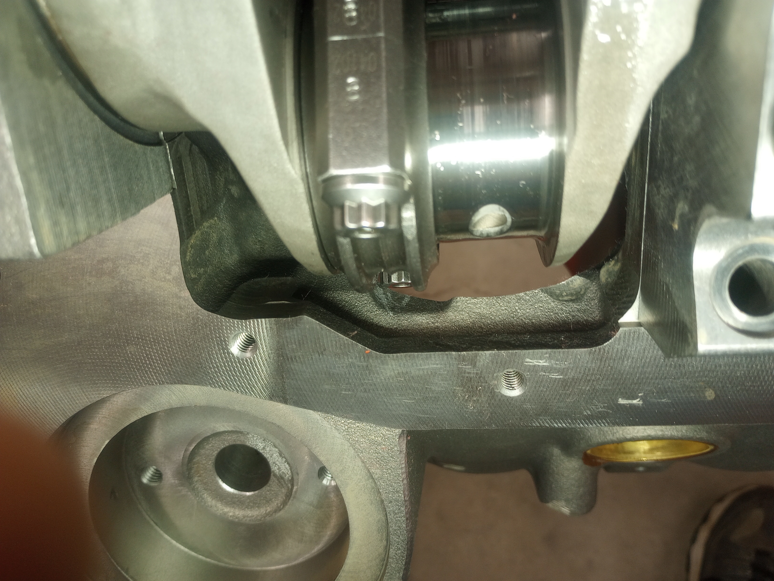

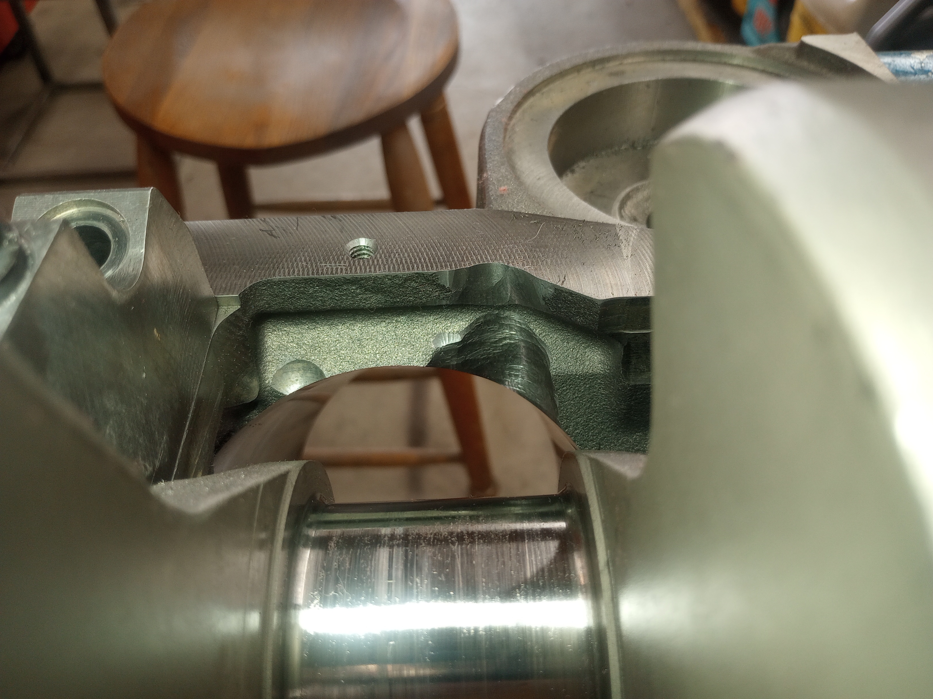

I installed the #8 rod/piston assembly with more old bearings and located where I had to start relieving the block. I got out the old Black and Decker air die grinder and put in a carbide burr and got started. I started with #8, as I knew it would need some work, and got started. I probably had to take out 3/16" at the bottom of the cylinder bore and about the same at the pan rails . The carbide burr does a really good job on the cast iron, so it doesn't take too long. I got #7 done also, so only six more to go. I was surprised at all the cast iron grindings on the floor under the block when I got done, going to be a lot more.

   / Restarting My '70 Nova Project
#714
Well, I spent about 4 hours carefully grinding on my new block to get the rods to clear the pan rail. The carbide burr I had worked really well, was easy to remove material where I wanted and left a fairly smooth surface. When I was done, I swept up the material on the floor amd it wold probably filled a one cup measure, and that didn't include what was stuck on my clothes. The air die grinder throws the filings everywhere, but it works great.

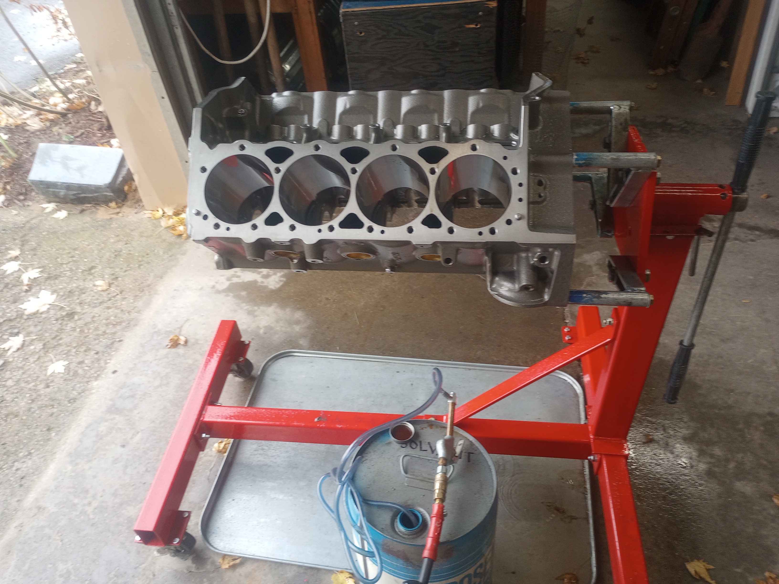

There is no way to get the block in the parts washer, so I dug out a compressed air siphon sprayer and used a better part of a gallon washing it down and then blowing it off and blowing out all the oil passages and bolt holes. I finished it off with a couple of cans of brake cleaner that left it squeaky clean and dry.

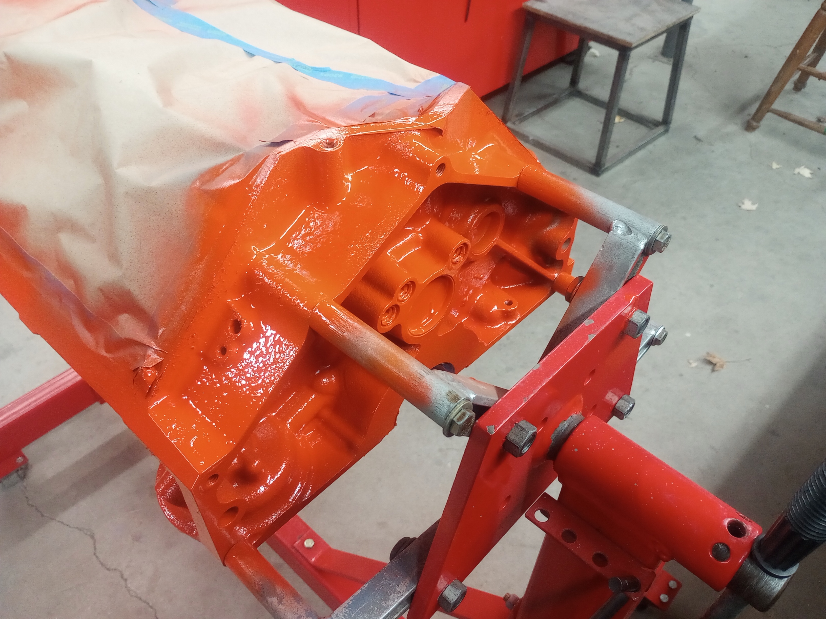

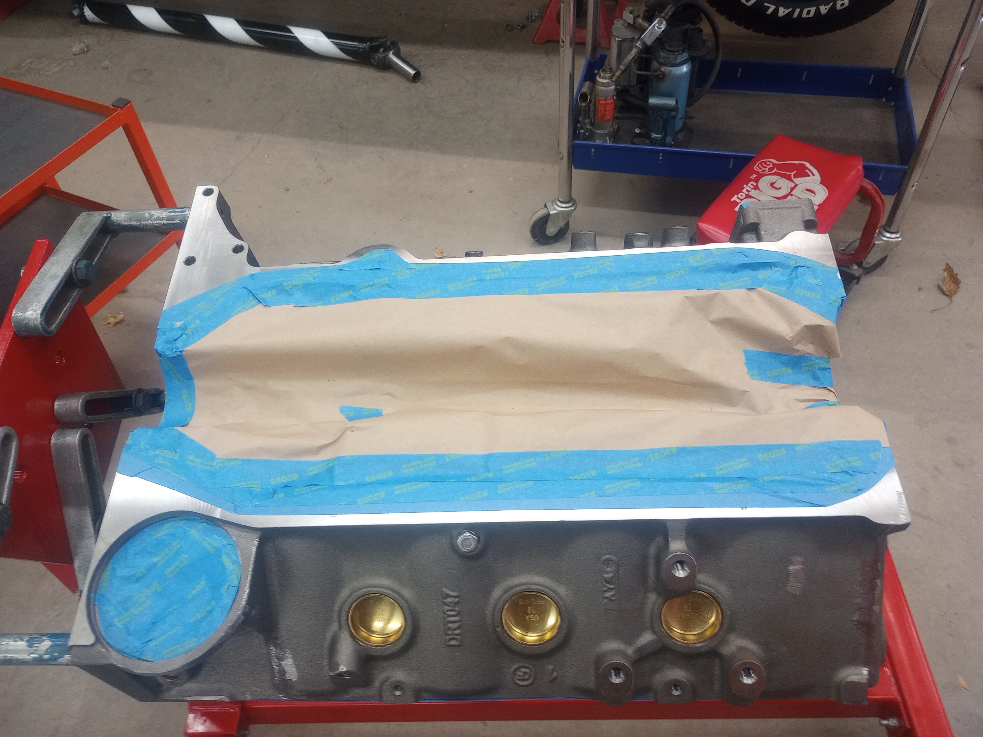

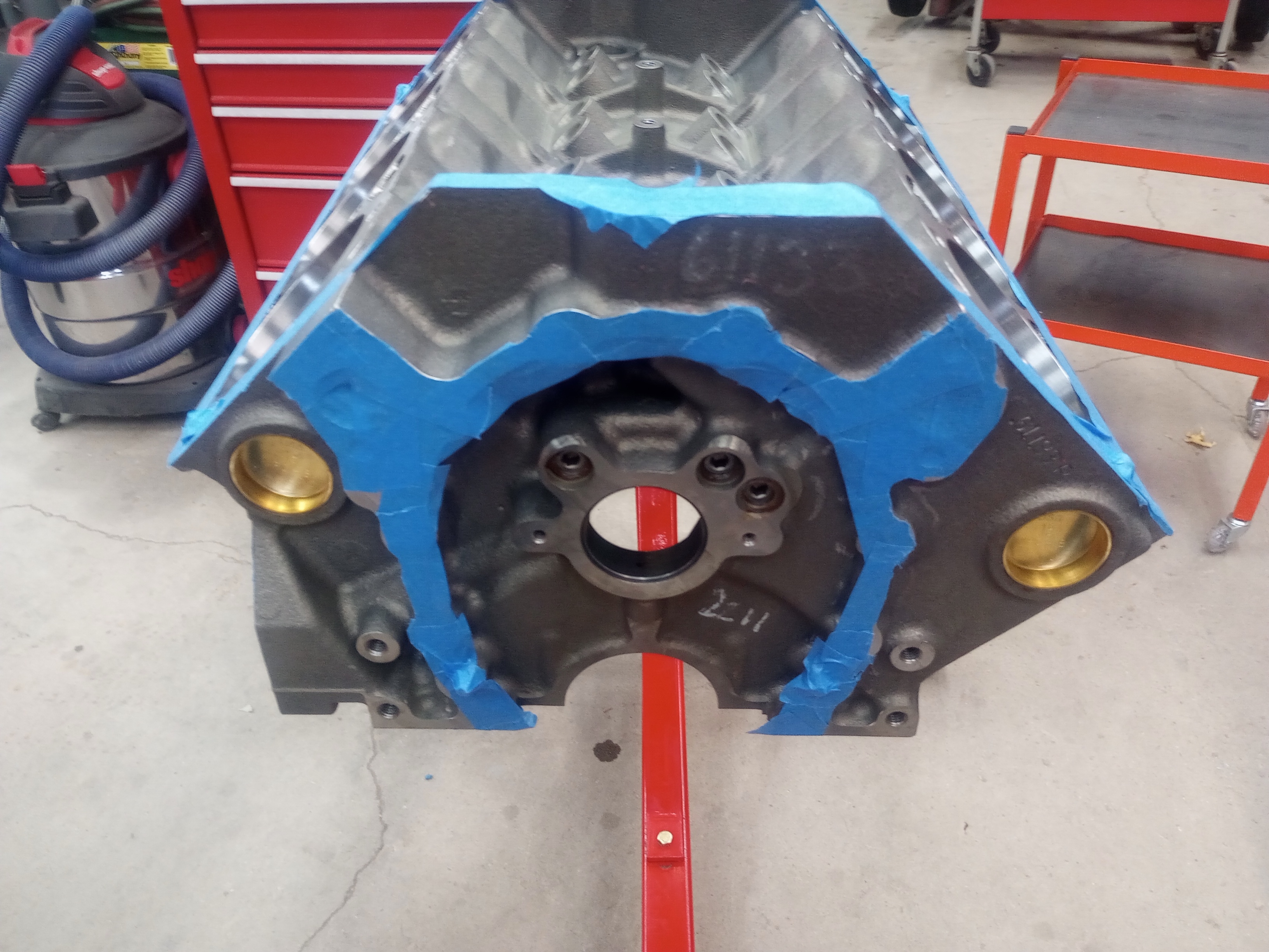

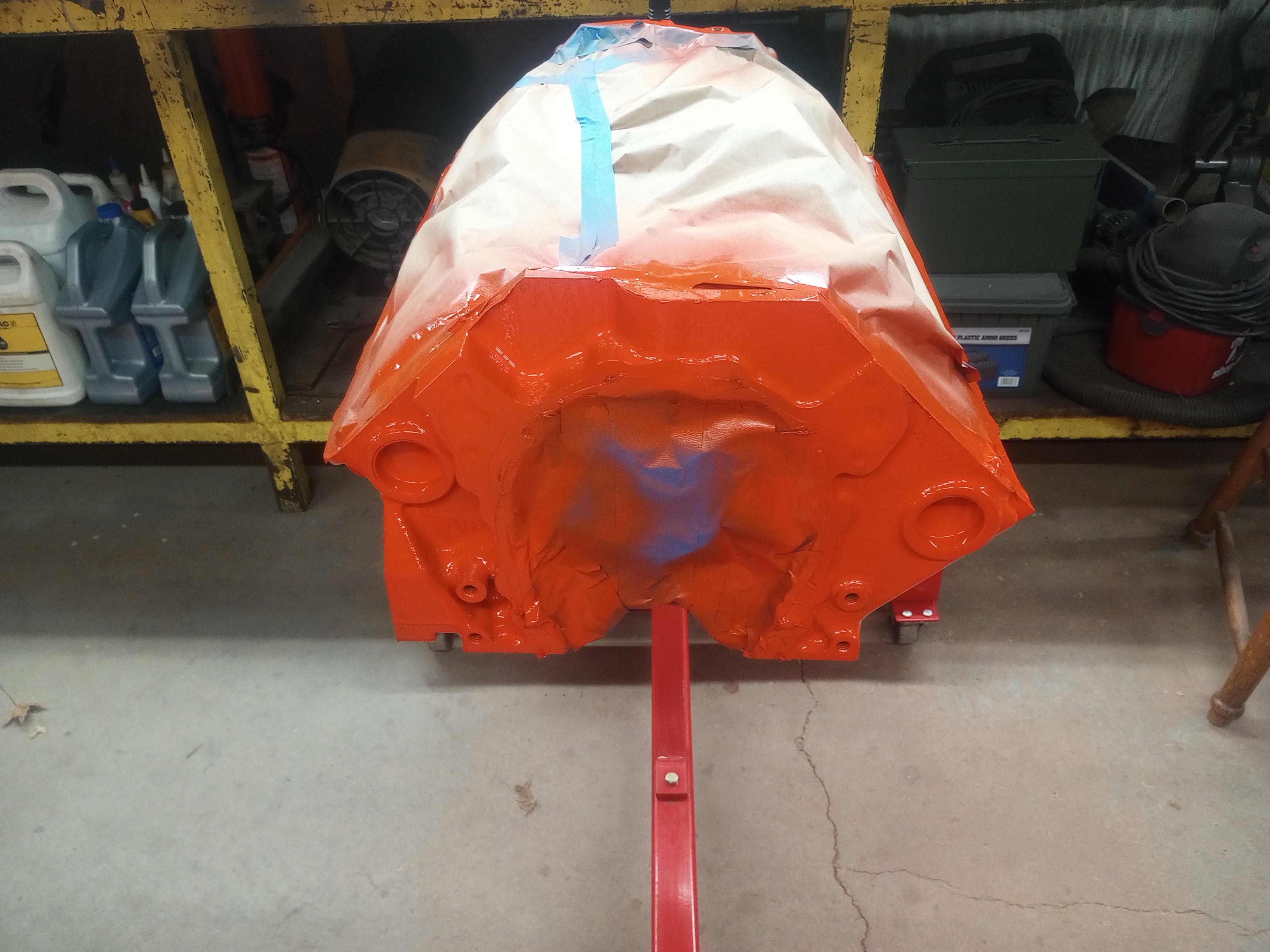

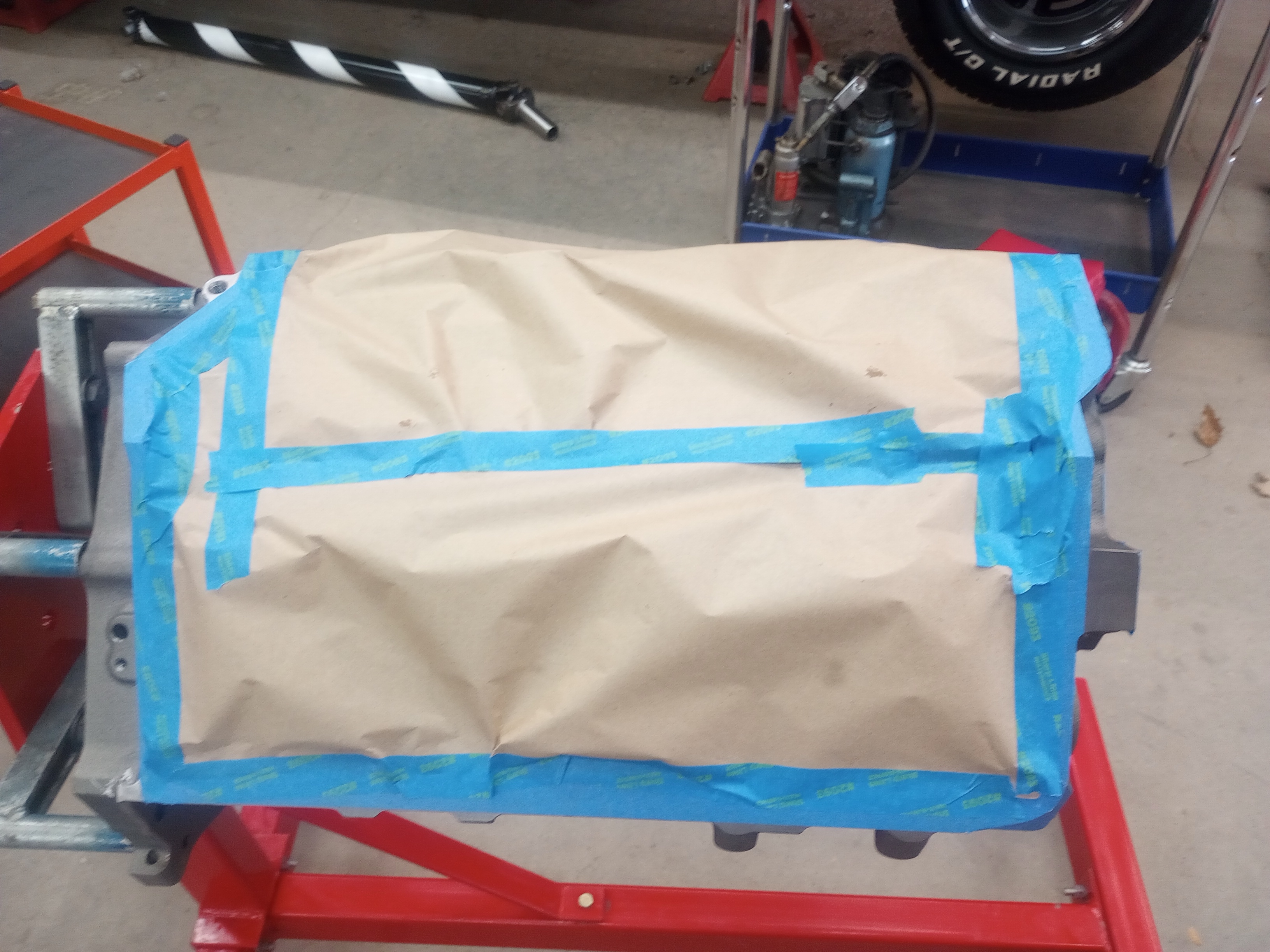

Next came the job of masking it off so I could paint it. That took a couple of hours because of all the irregular surfaces, but I got it all done in time to give it a coat of self etching primer before I had to leave to pick up a friend for dinner. I only had about a third of a can of Chevy orange paint, so on the way home I stopped at O'Reilly's and picked up another can. Stopped at the shop and gave it a couple of good coats, so it'll good and dry to work in tomorrow.

Pulled all the paper off the block today, it looks pretty good, really orange.

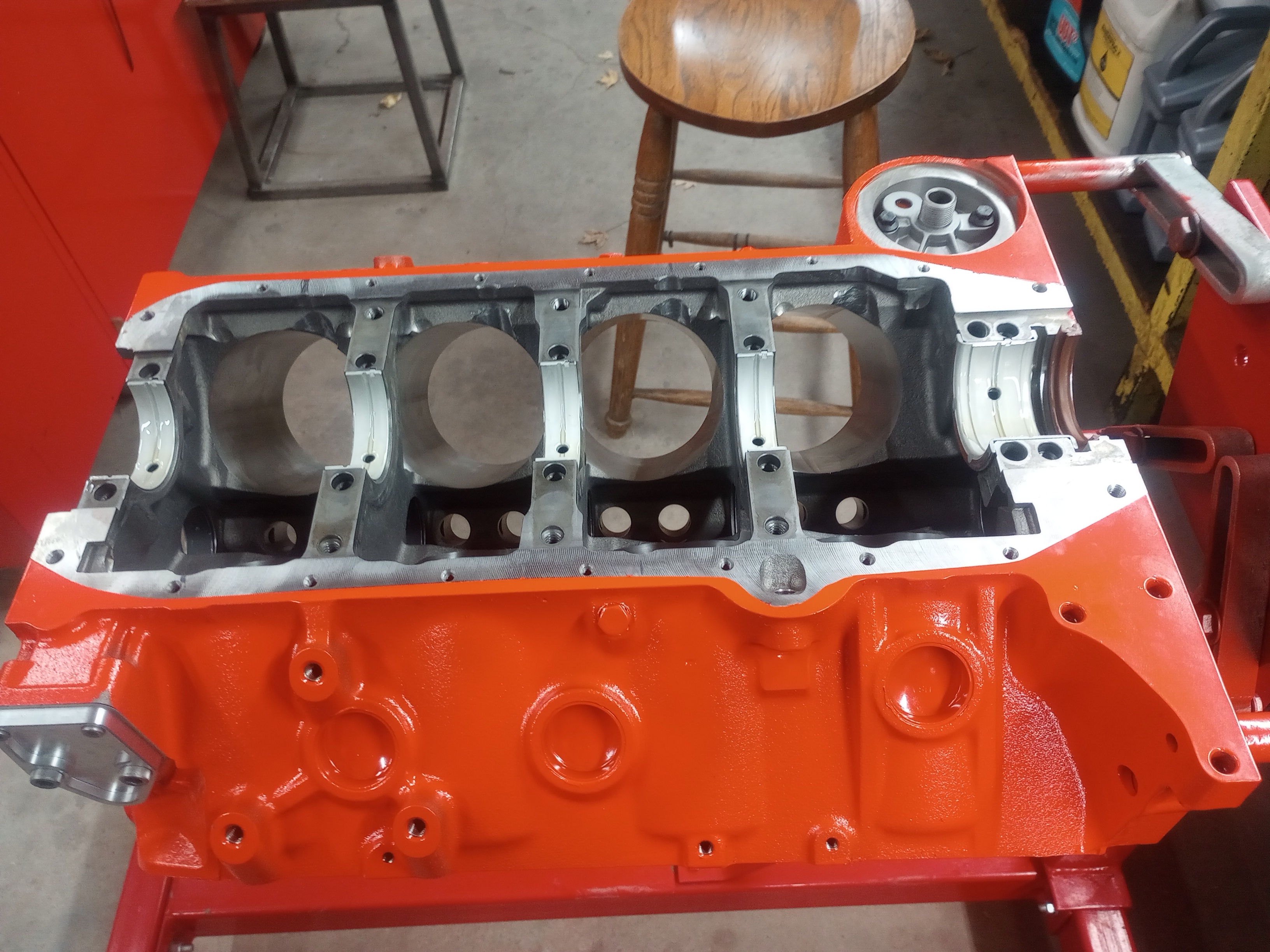

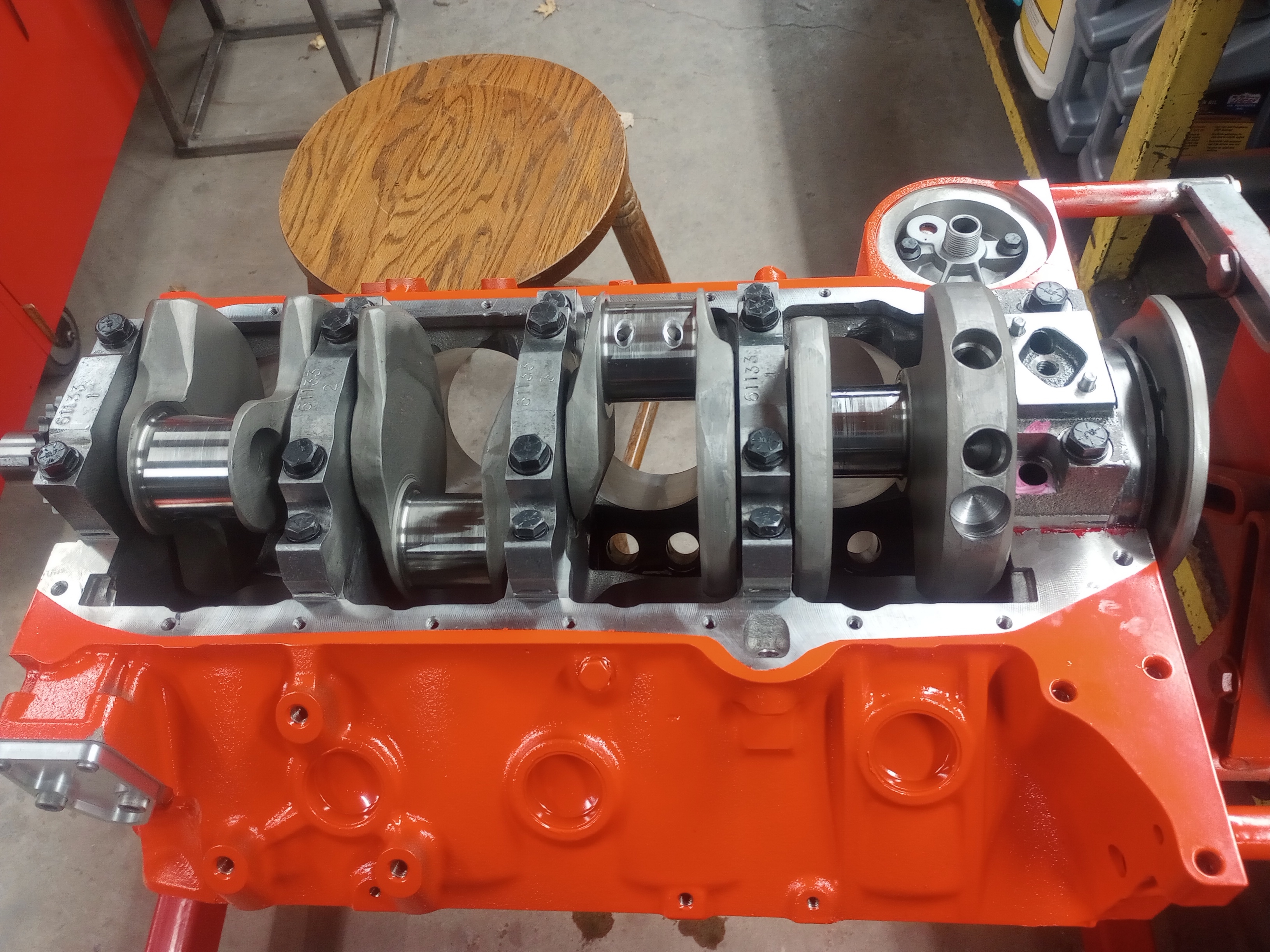

Unpacked the new main bearings and made a small modification to the rear main shells to get more oil the the thrust surfaces, a mod I've seen a few SBC builders recommend. Installed the rear seal half in the block and the rest of the upper bearing shells. Got the crank, wiped and blew it off, lubed the bearings and journals and dropped it in place. Installed the lower shells in the caps, lubed them and dropped them into place. Seated them in the block, installed the cap bolts, snugged them up, forced the crank forward and aft to set the rear cap and thrust bearing properly. Dial indicator show .005" end play, which is in spec. Torqued the 7/16" main bolts to 65 ft.lbs. and the splayed 3/8" bolts to 35 ft.lbs., as per the block specs. The crank even spins nice and freely, which is good!
