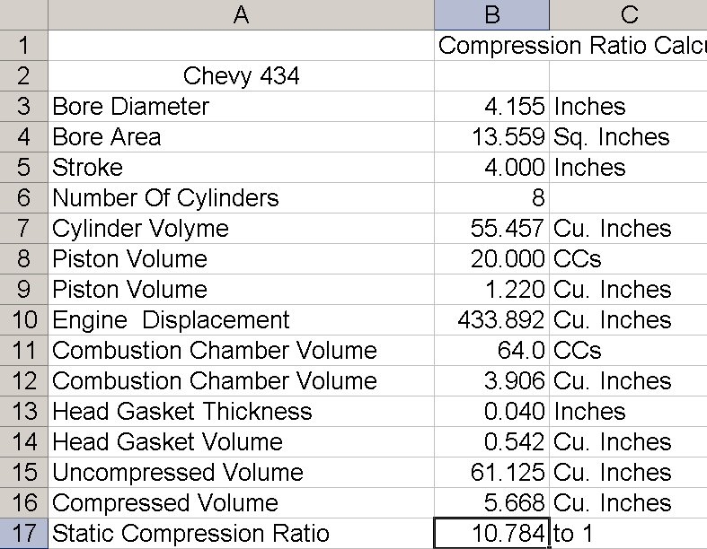

Nice job! What kind of compression #.
   / Restarting My '70 Nova Project
#733
The calculated compression ration is ~10.8:1. Dynamic compression ratio, taking into account the valve closing timing is more like 9.5:1.

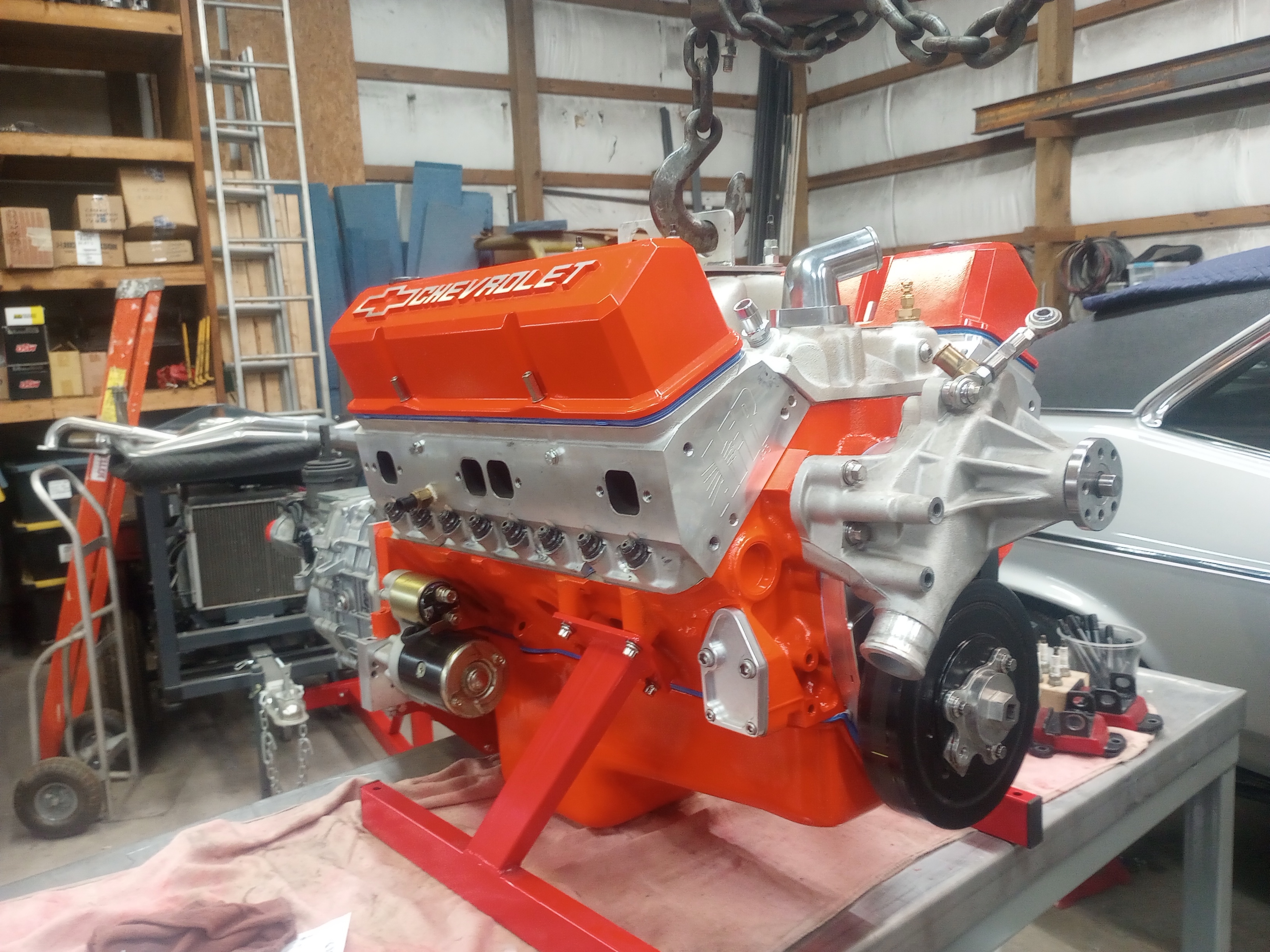

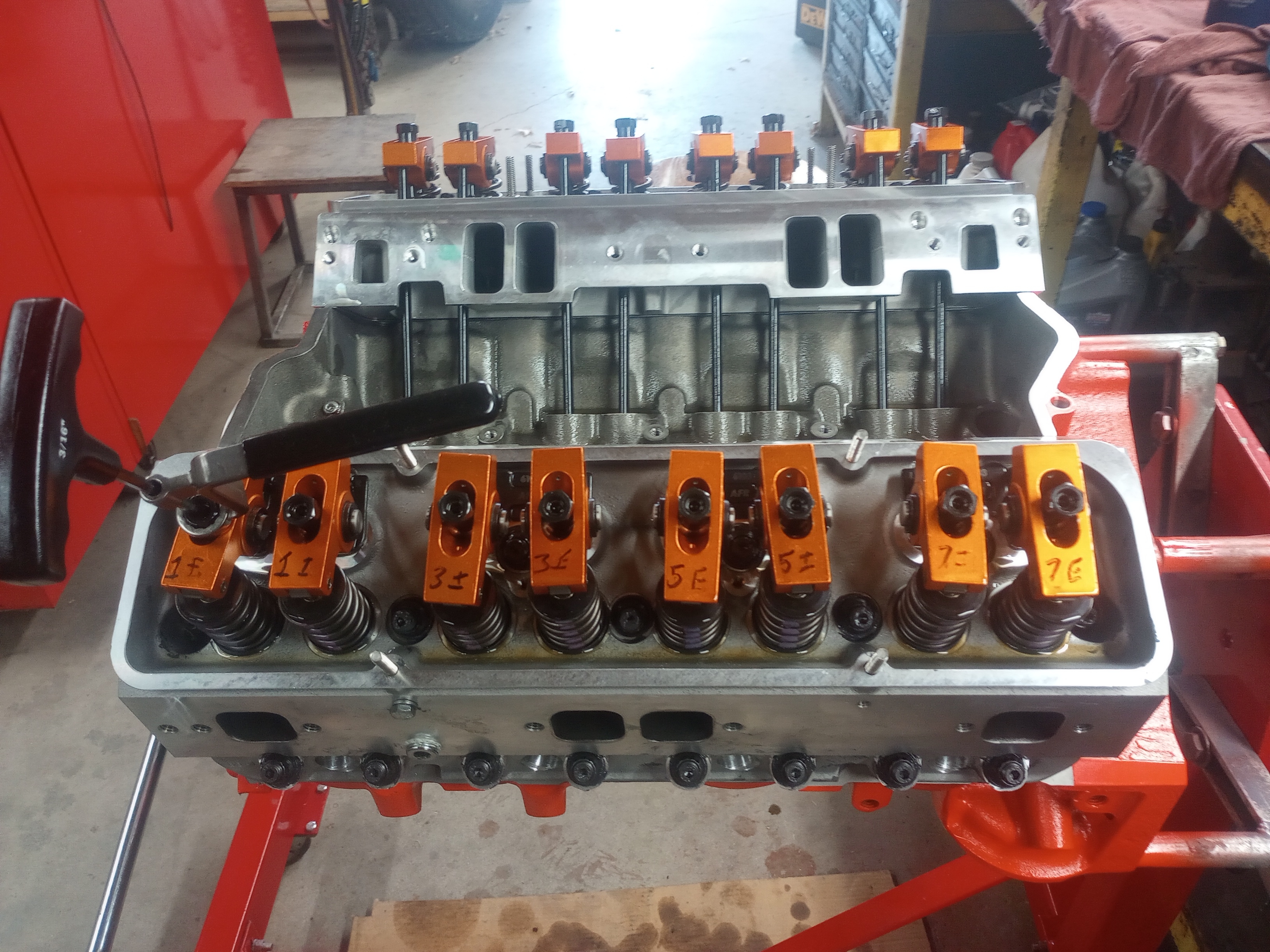

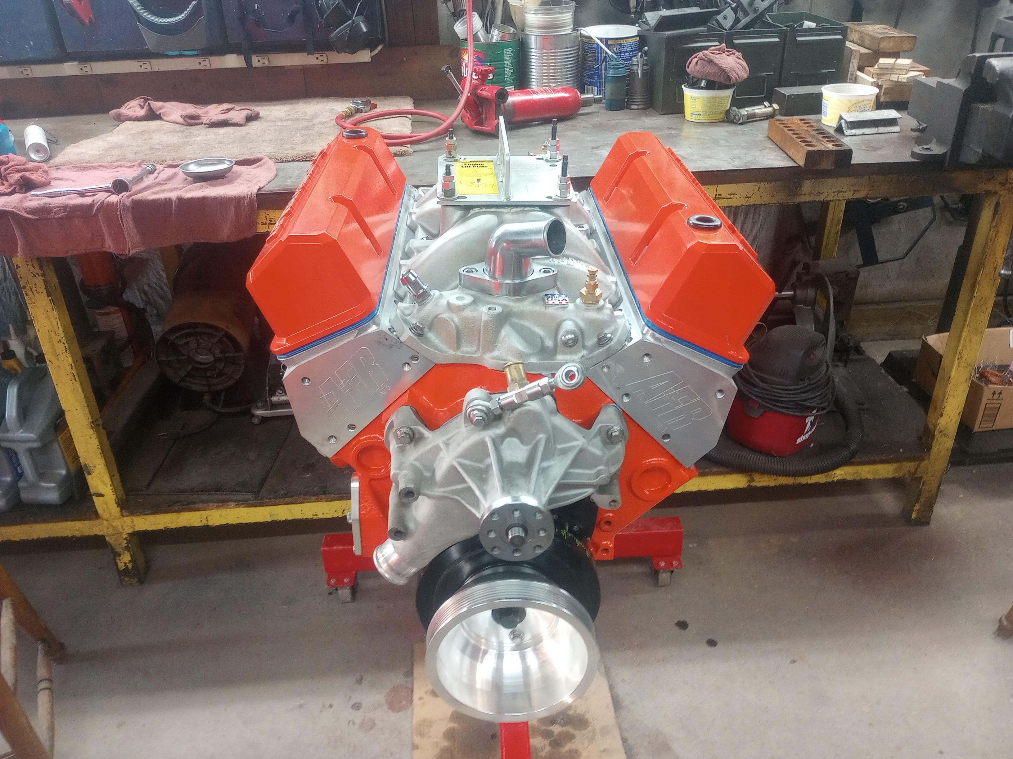

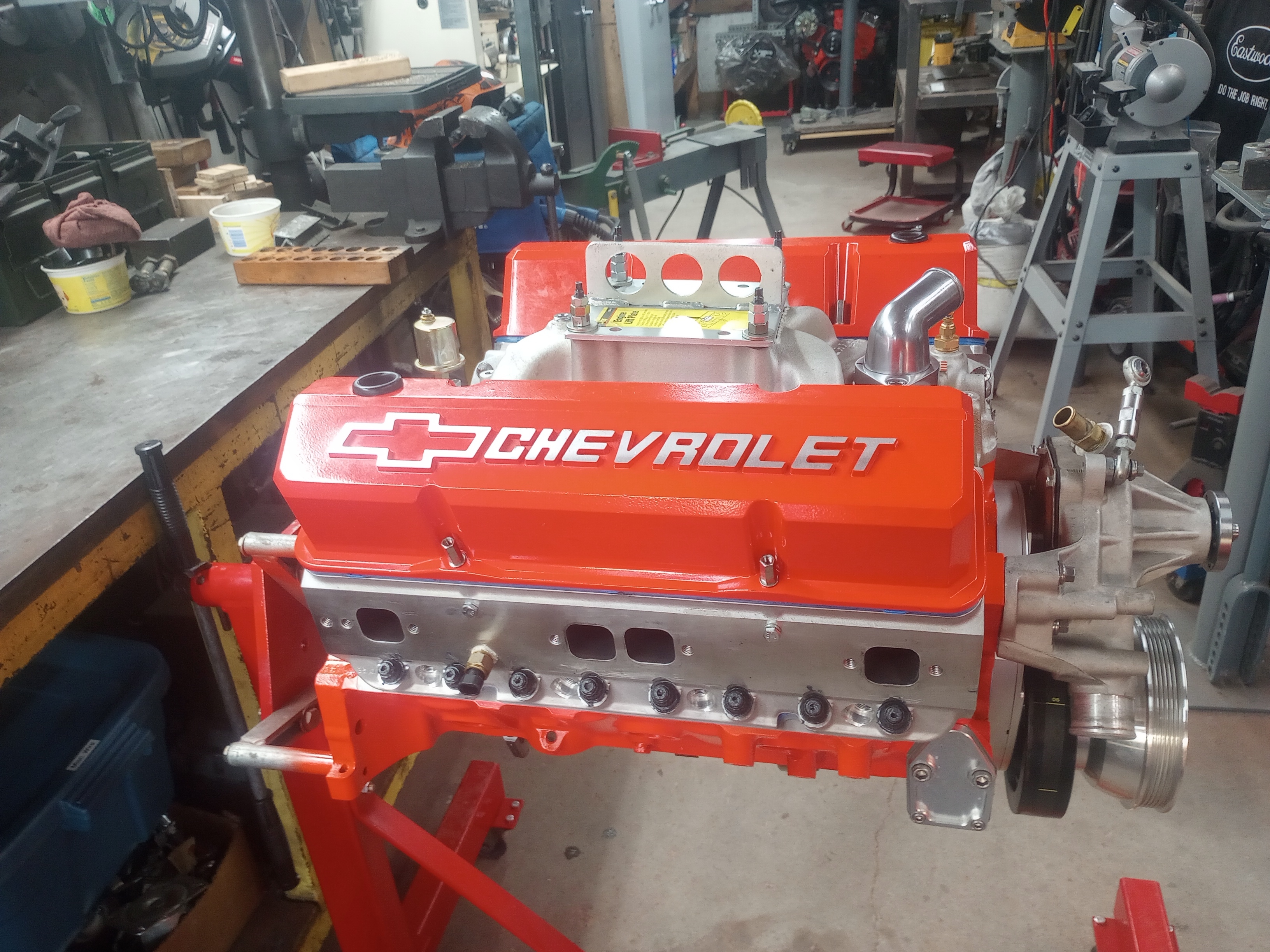

Made a lot of progress today. I got both heads torqued down in three steps, 35, 50 and 70 ft.lbs. Then, after I lubed them up really well, I dropped all the lifters in their bores.I didn't degree the cam since I had done that when I had originally assembled the engine, and as all the parts are the same, I saw no reason for it. Then the push rods went in and then the rocker arms and adjuster nuts. I rotated the engine over five or six rotations and stopped at TDC to start setting the valves. That went smoothly, as it only takes two complete revolutions to set all them, and then two more to recheck them. After that, I screwed the oil pressure sending unit in place at the back of the block.
I cleaned up the valve covers and installed the 1/4" X 1 1/4"
SS studs in the heads that make installing and removing the covers a lot easier, as it holds the gaskets in position. Tightened them down and then pulled out the intake manifold and gaskets.
I bought a tube of gasket maker in a pressurized can, I had never used it before, but I've seen a lot of YT mechanics like the guys on Road Kill like it and use it, so I thought I'd give it a try.
I spread a little around the water ports on the heads, laid the intake gaskets in place and then ran a nice 1/4" tall bead on the China walls, the front and rear block rails where they used to use a cork gasket that would either leak of squeeze out and cause leaks. I did that the last time a put the manifold on, and it didn't leak, so I'm doing that from now on. Dropped the manifold on, started all the bolts, then tightened them all down in sequence, from the middle working outward. Done. It's starting to look like an engine again.

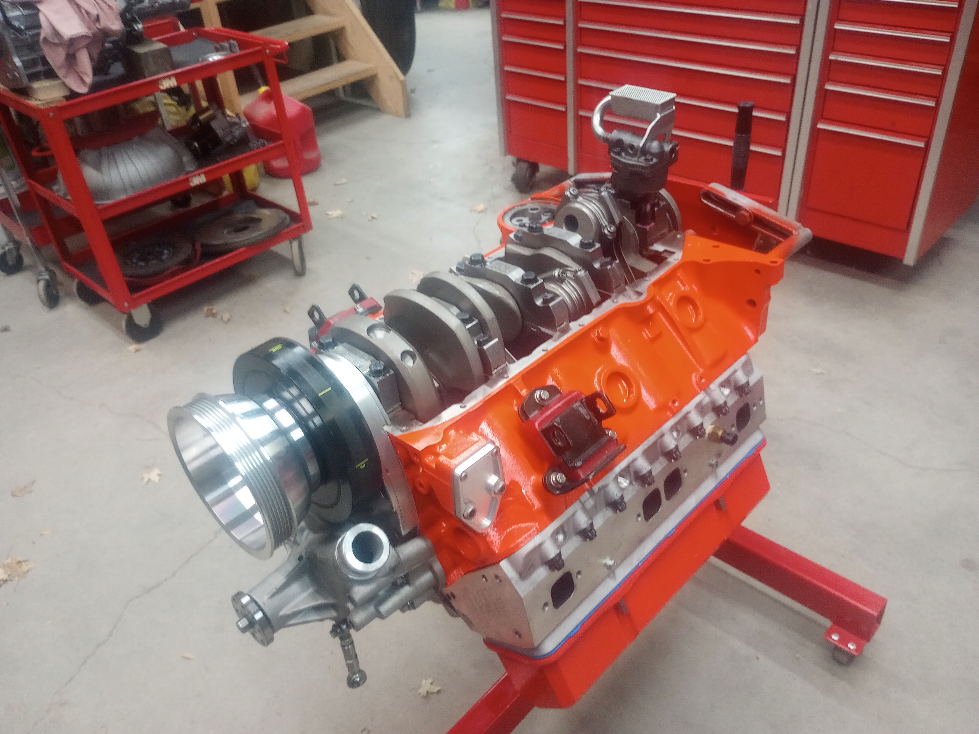

I bolted the motor mounts on, the installed the ball stud for the clutch Z-bar and a small bracket that the clutch return spring attaches to. Lastly, I bolted the water pump in place, removed the turning fixture from the crank dampener and bolted the crank pulley on.
Gee, the parts bench is almost empty, finally.
Tomorrow, I have to paint the new oil pan that I had to get so I can use my old oil pump. I had bought the one that Dart said would fit a block with the two piece rear seal and right side dip stick, but it wasn't deep enough to use with my Melling oil pump and pickup. It's black, but I'll blast it and paint it Chevy orange to match the block. While it's drying, I'll roll the engine upside down and clean up the bottom end and install the oil pump and drive shaft. Don't want to forget that, as you can't install it from the top because of the retainer collar that mates with the oil pump shaft. I'll probably wait until Saturday to put the pan on so it's completely dry. It takes longer when the temps are cooler like it's been here lately. After the pan's on, I'll dump in the oil and prime the oil system, making sure everything's getting oil.
Maybe Monday or Tuesday I'll get it stuffed back in the car.

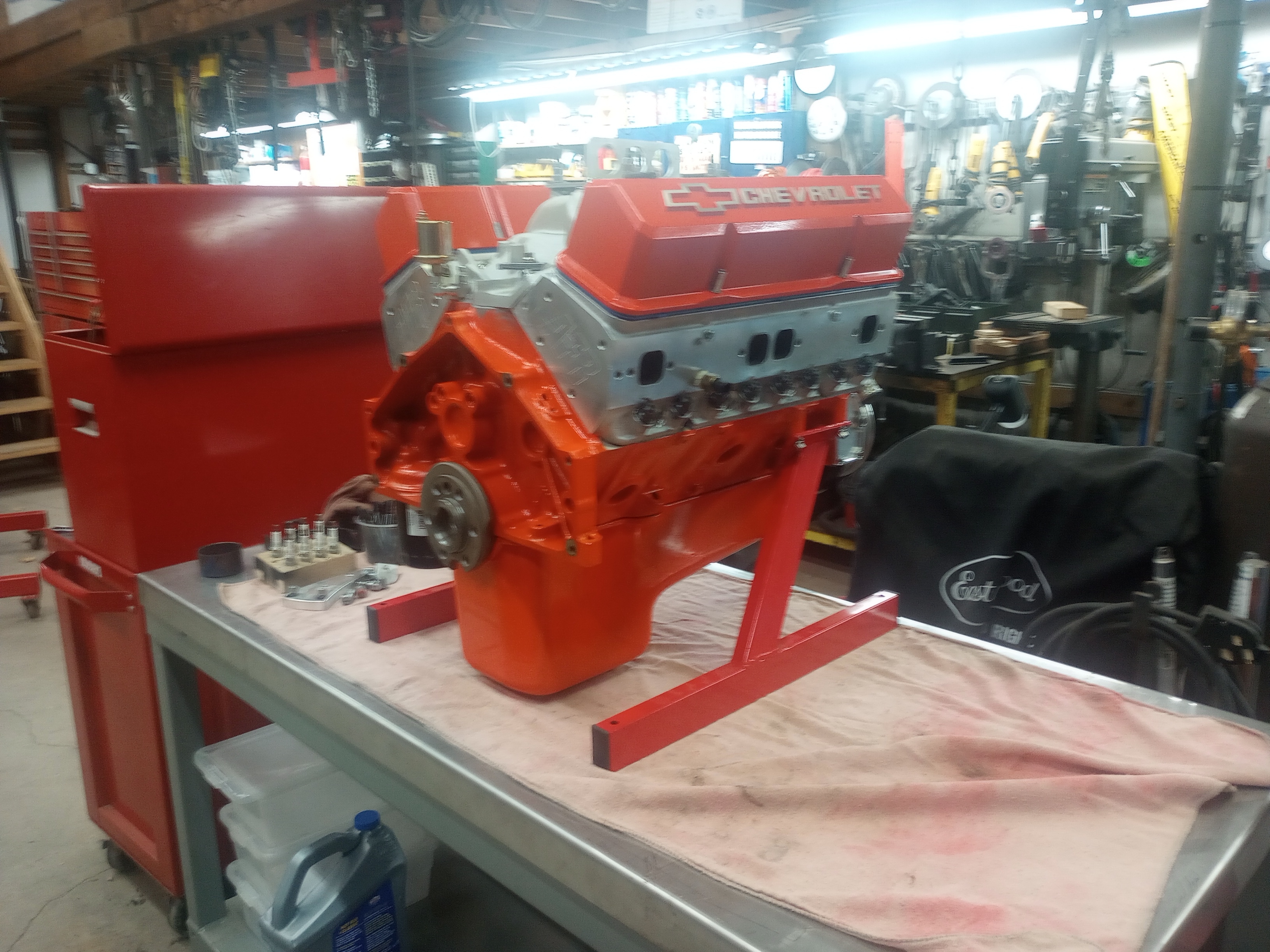

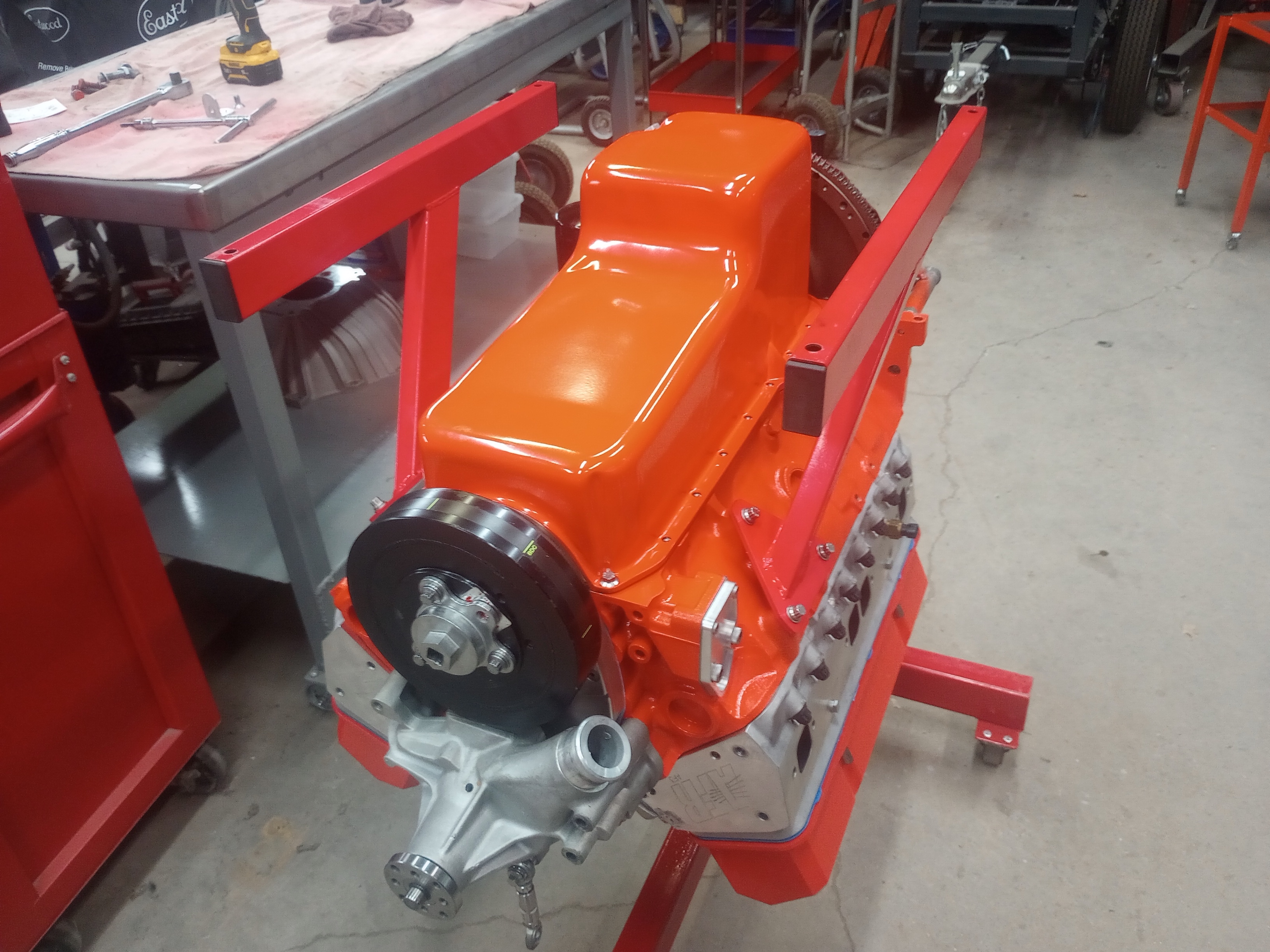

The oil pan paint job came out great, surprising, considering that I painted it in front of the shop to keep the overspray out, and the wind was blowing like crazy. Mounted the oil pump and laid the pan gasket on the block, and discovered it isn't made for a stroker crank like the previous gasket was. Soooo, I got back on Summit and after some searching by application and not finding what I needed, I took a wild guess at the part number and found what I needed. The previous gasket on the Chevy block was a Felpro 1880, so I tried looking up a Felpro 1881, and bingo, SBC engine, right side dipstick, two piece rear seal, thick timing cover seal and notched for a stroker crank. So I ordered it and it'll be here on Tuesday.
Meanwhile, I bolted the oil pan on the block, installed an oil filter, rolled it over, bolted on the short engine stands, picked it up with the cherry picker and set it up on the work bench. The previous time I dialed in the bellhousing, I had just set it on the floor, and it was a pain to work on down that low. Now with it up on the bench, it's really easy to work on.

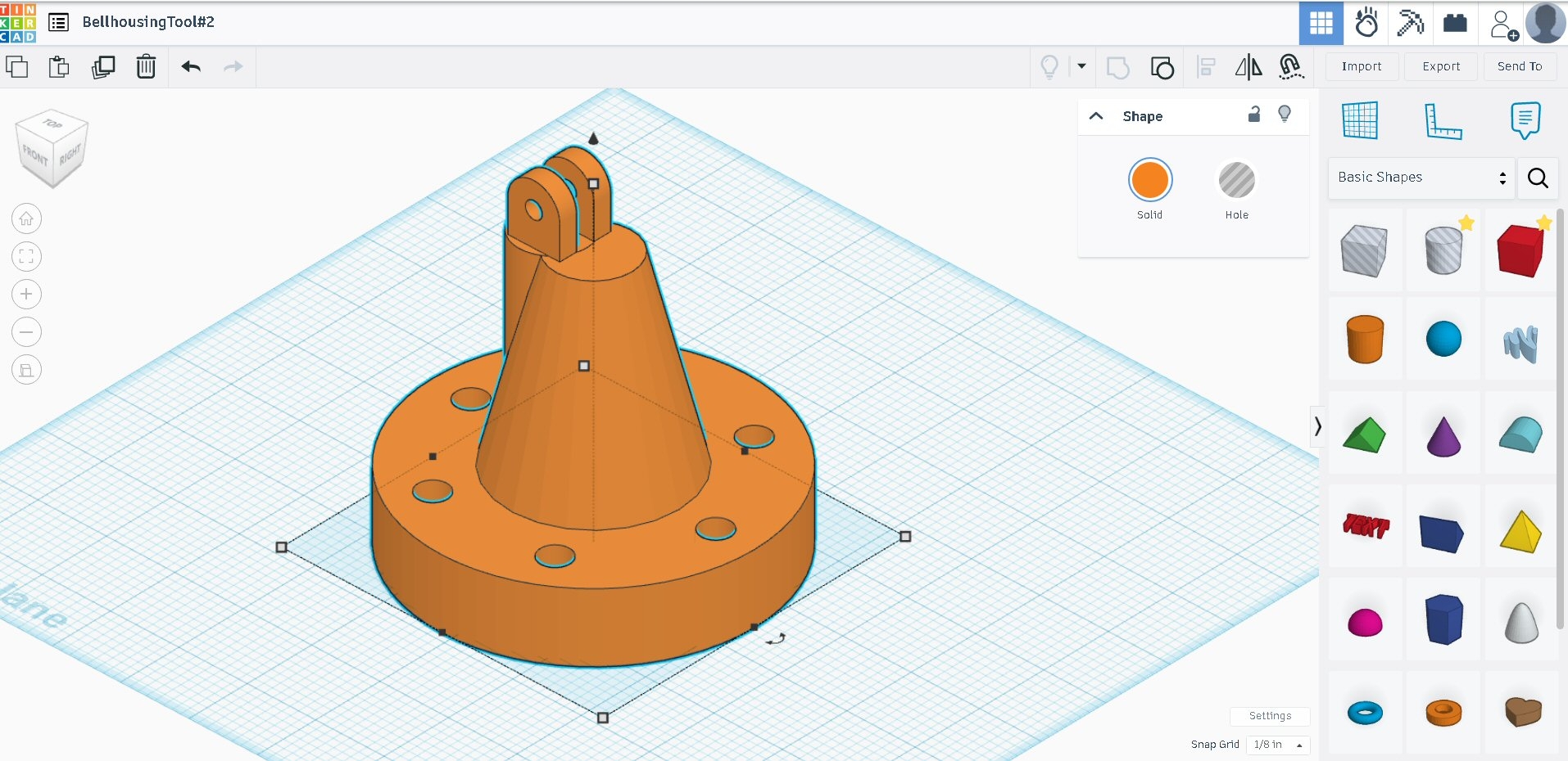

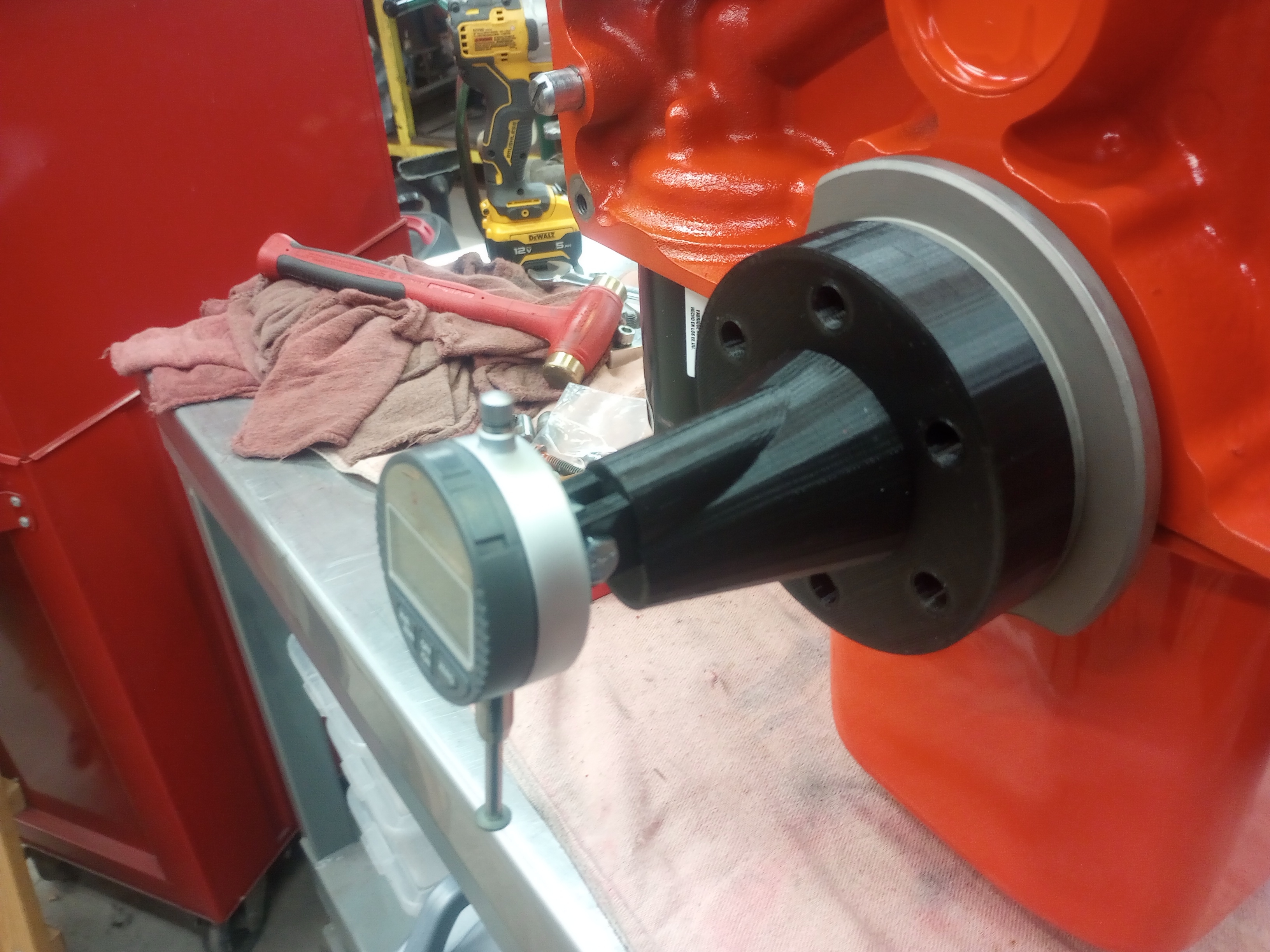

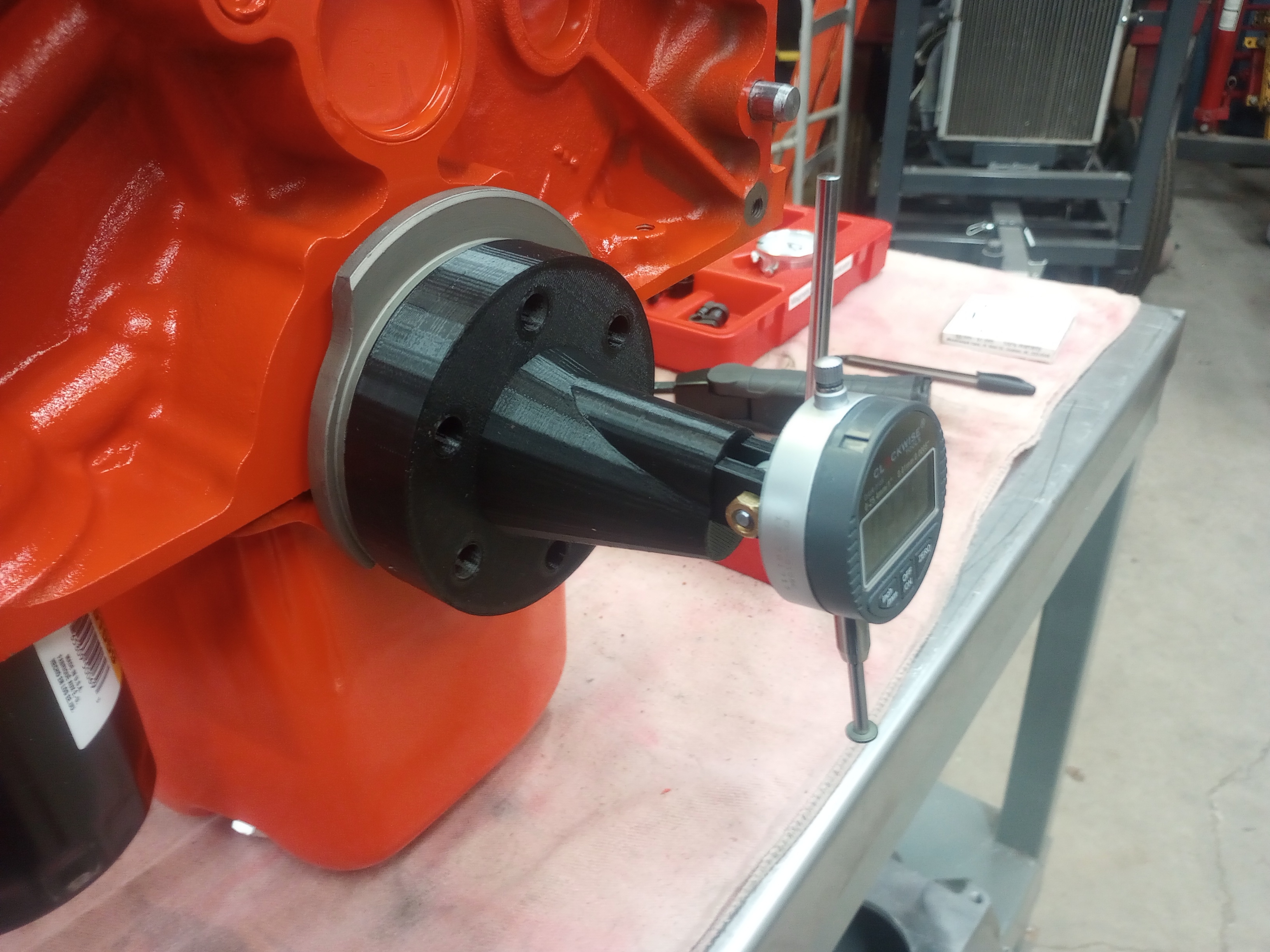

I installed the dowel pins that locate the bellhousing to the block, and it went on pretty easy, doesn't seem like it's spreading or pinching the housing, so maybe it'll actually dial in pretty close. I got out the dial indicator and attachments and couldn't figure out how the heck I had set it up before, as getting it attached to the crank flange and then sticking back 5" to the trans bore was a pain before, as I remember. After fiddling with it for a while, I took some measurements and decided to 3D print a fixture to hold the micrometer to the crank and position it in the bore. I drew one up in Tinkercad and it's being printed right now down in the basement. I think it'll work just fine. I'll bet I've made over a dozen different tools and doodads over the last few years that were to aid in a shop project. A handy thing to have.
I'll bolt the fixture to the crank and the dial indicator to the two ears at the top, and then I can rotate the crank and read the runout. Hopefully it'll be within spec, under 0.010 total runout.

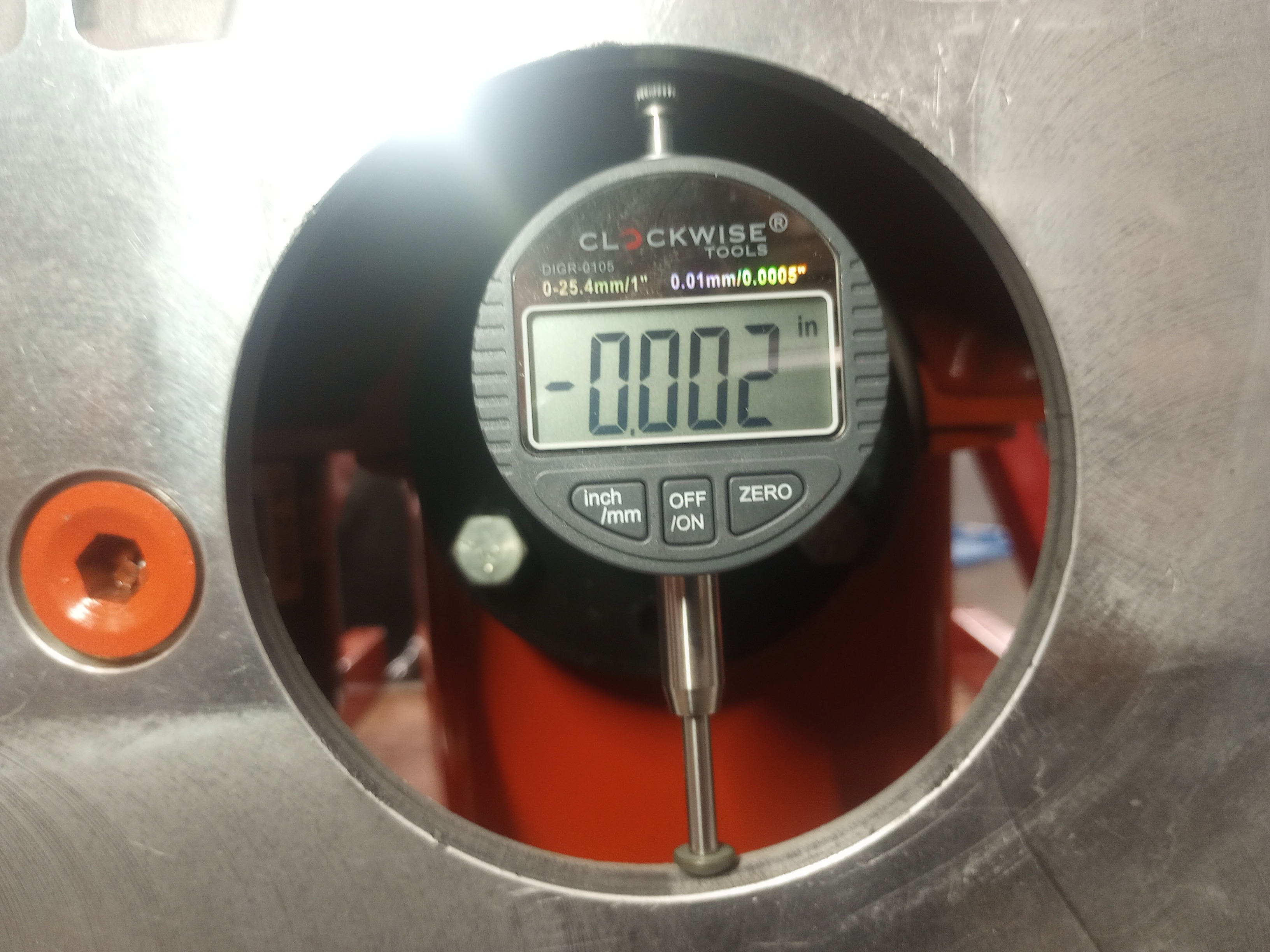

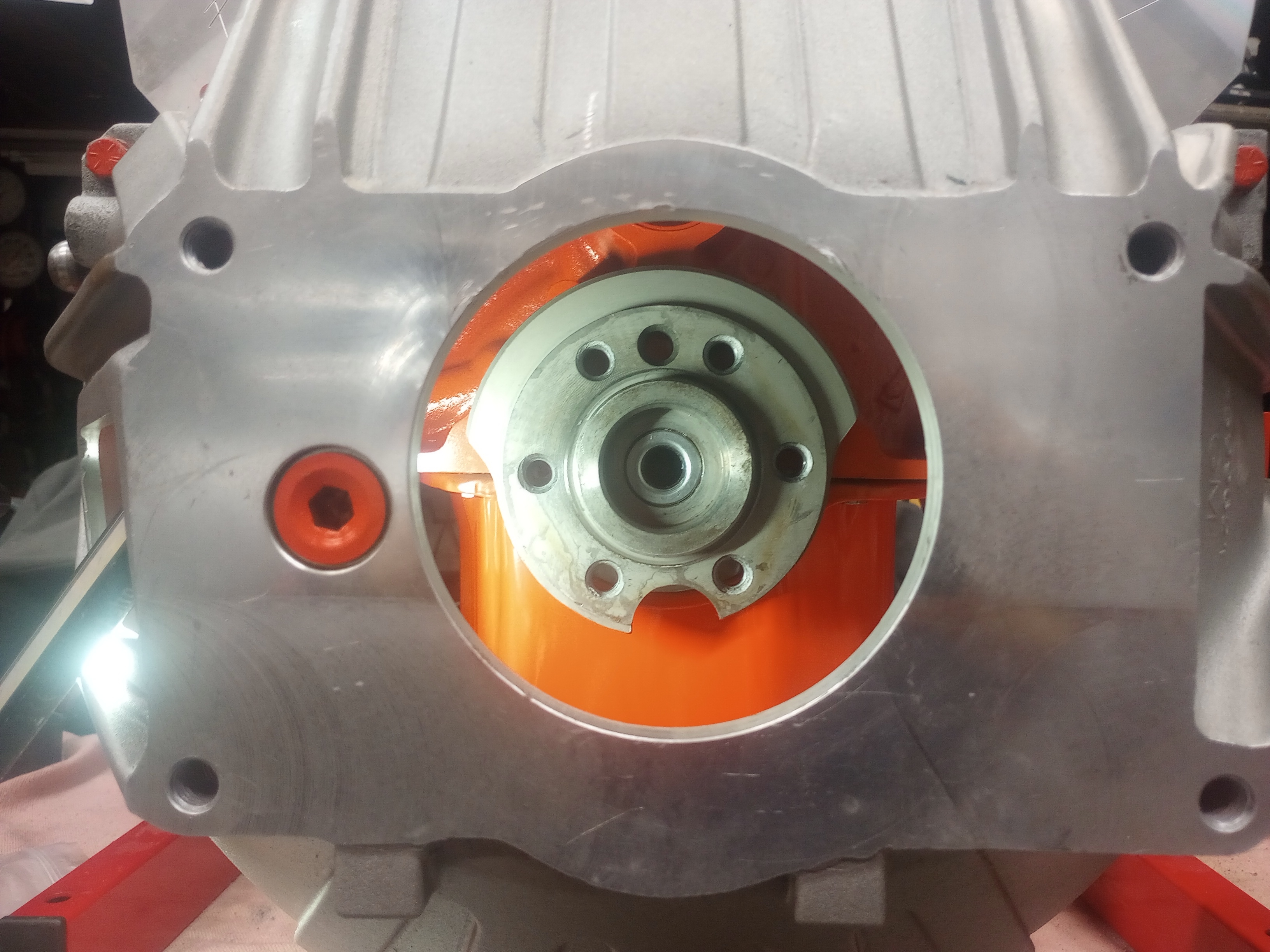

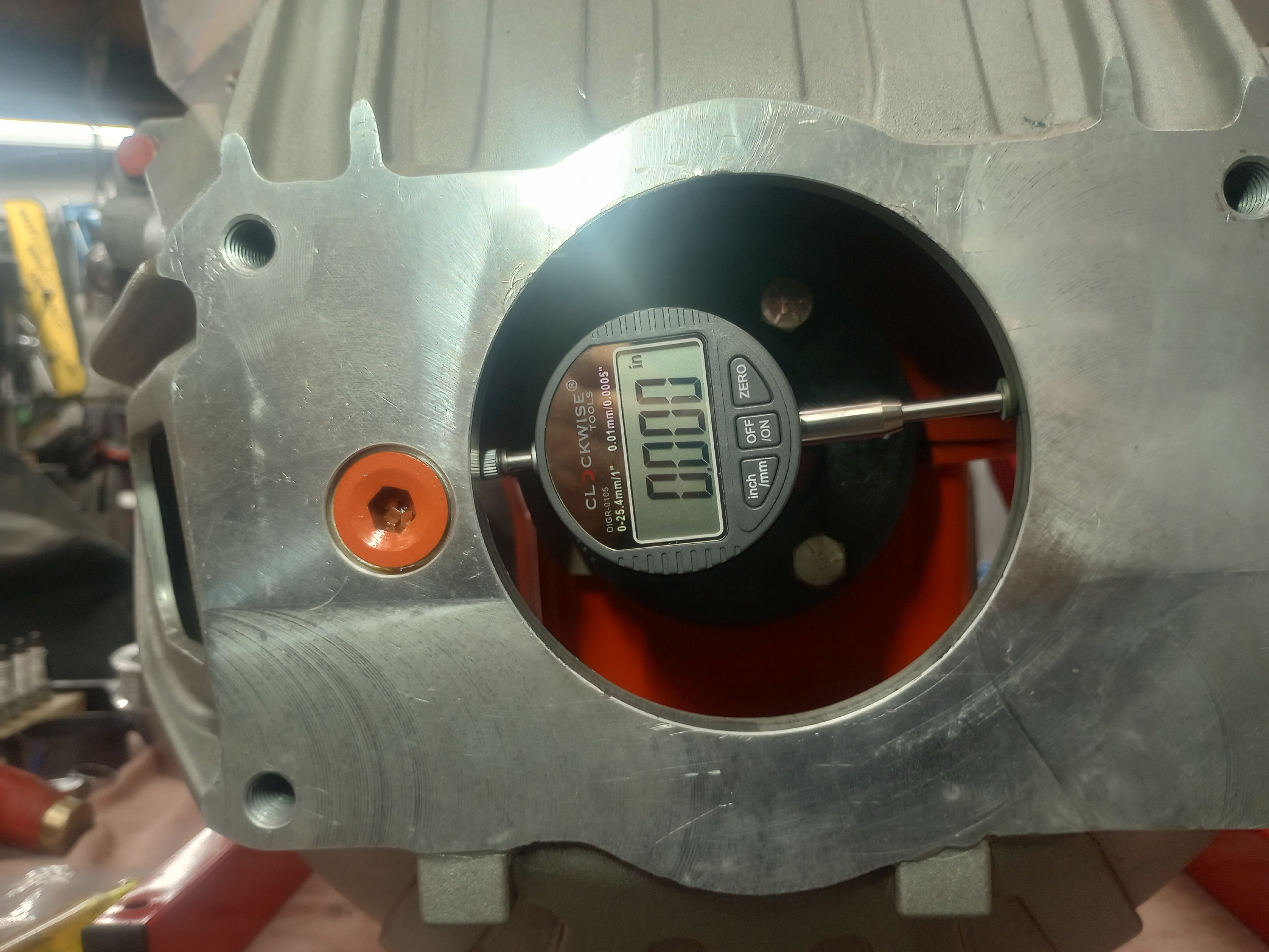

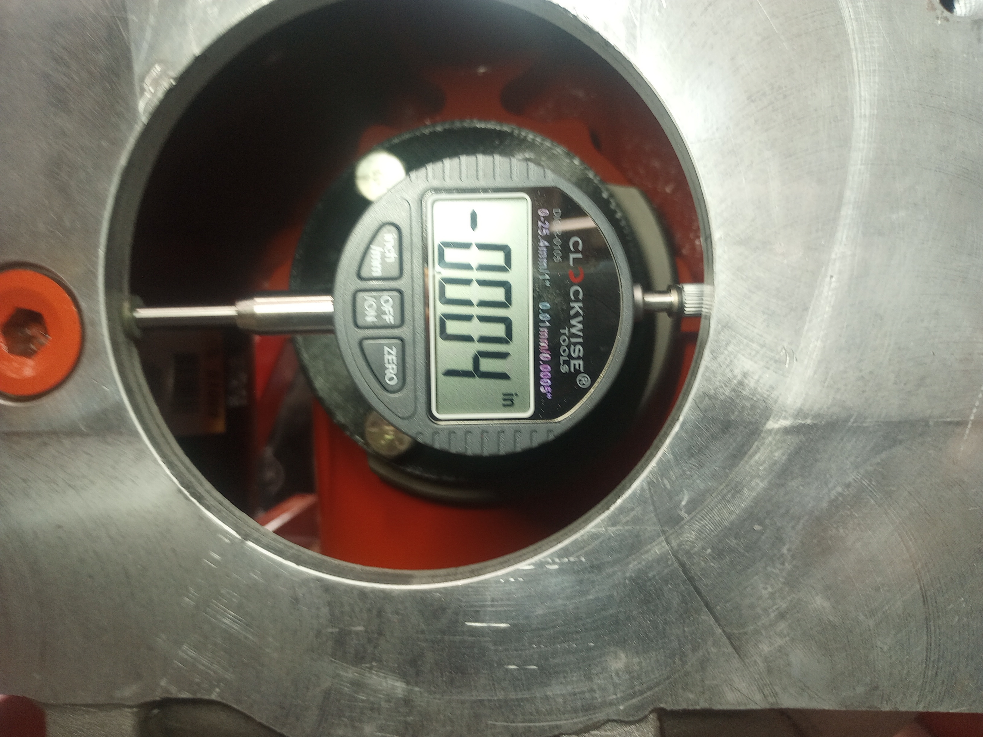

Didn't have much time to spend in the shop today, but I did get the bellhousing dialed in. Surprisingly, I ended up using the same offset dowel on the left side that I used on the other block, so it mush be the bellhousing that is machined out of true.
With the stock dowels, it was off by as much as 0.036", with the 0.020" offset dowel on the left side, TIR was 0.006" as shown in the pictures.
My 3D printed fixture worked perfectly, and I didn't even have to bolt it to the crank, as it was a pretty tight fit without them.
I ended up printing it 1 1/2 times, as the first time I misjudged the amount of filament on the spool and it ran out half way through. Then, the control screen was locked up so I couldn't continue the print after loading fresh filament. Had to start it all over.

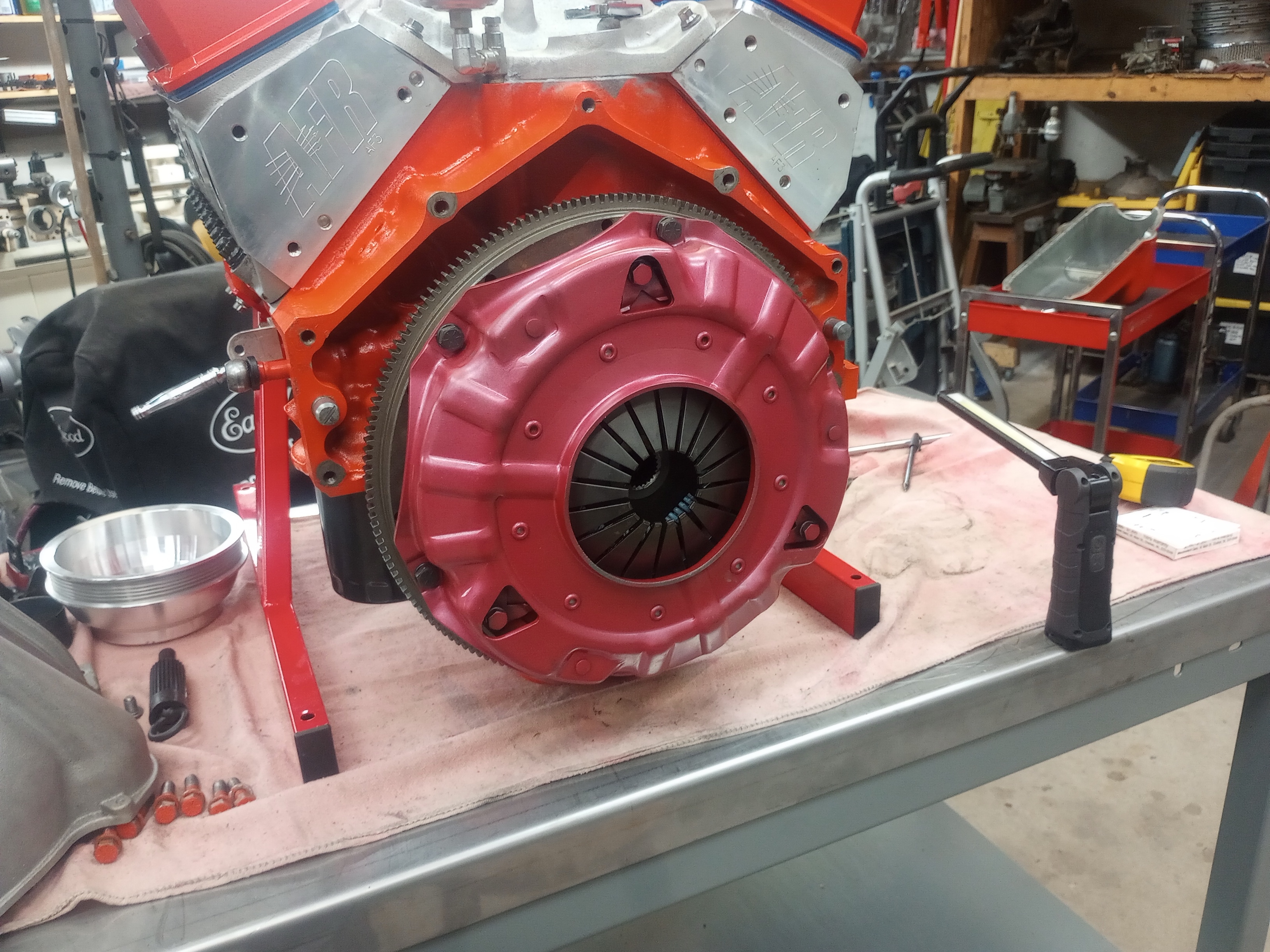

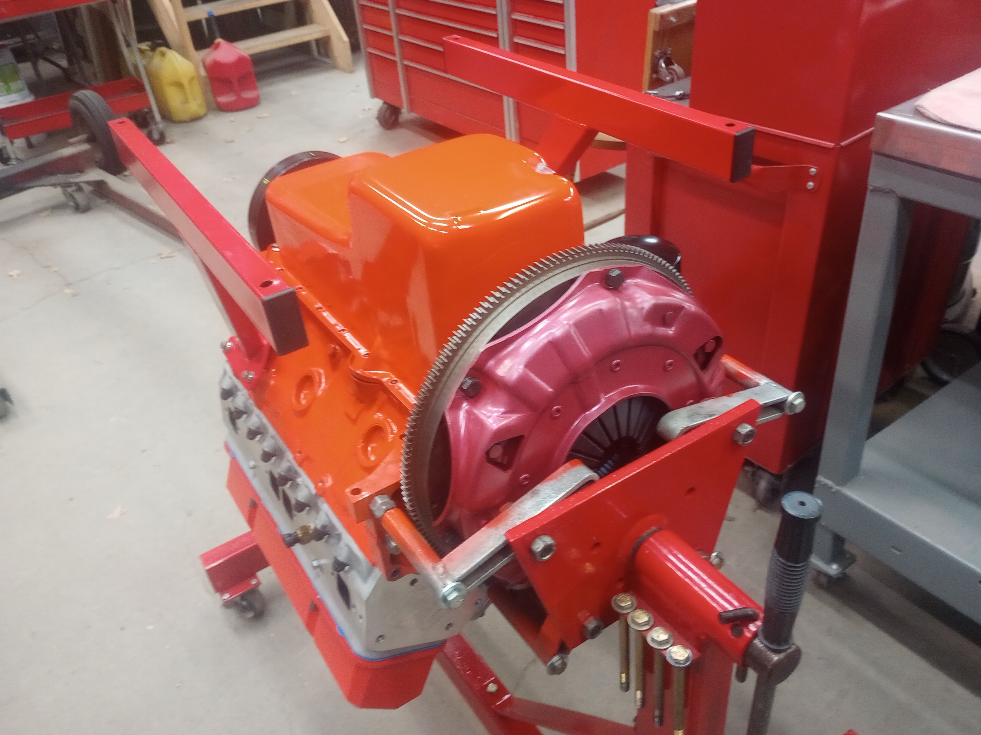

I got the oil pan installed today. The new gasket came Tuesday, but my daughter and youngest sister are in town for some family business, so I haven't had much time to work in the shop. I kind of got ahead of myself when I installed the flywheel and clutch, as I forgot that I hadn't installed the pan gasket yet. I didn't want to pull it off again, so I was able to add a couple of 1/2" nuts and longer bolts to the engine stand attachments and still clear the clutch. he gasket and pan went on pretty easily, although it's a really tight fit between the pan and the timing cover. But by using a couple of longer 5/16" socket head bolts in the two front bolts, I was able to get it pulled down far enough to get the next bolts back started and pulled part way down, get the original pan bolts started and tightened down. I rolled it back upright and picked it off the engine stand and set it back on the bench. I bolted up the bellhousing, and the flywheel cover and tried to bolt the starter on. But the bolts wouldn't tighten up all the way, apparently the holes aren't threaded as deeply in the Dart block as they are in the Chevy block. I added a couple of washers to them, and that let them tighten up all the way.
I put a sling around the transmission, picked it up and got it slid into the clutch. I learned that if it doesn't want to slide in all the way, I can use a pry bar to lever the clutch release arm back enough to release the clutch disk to let it center up and the input shaft to slide in all the way.
