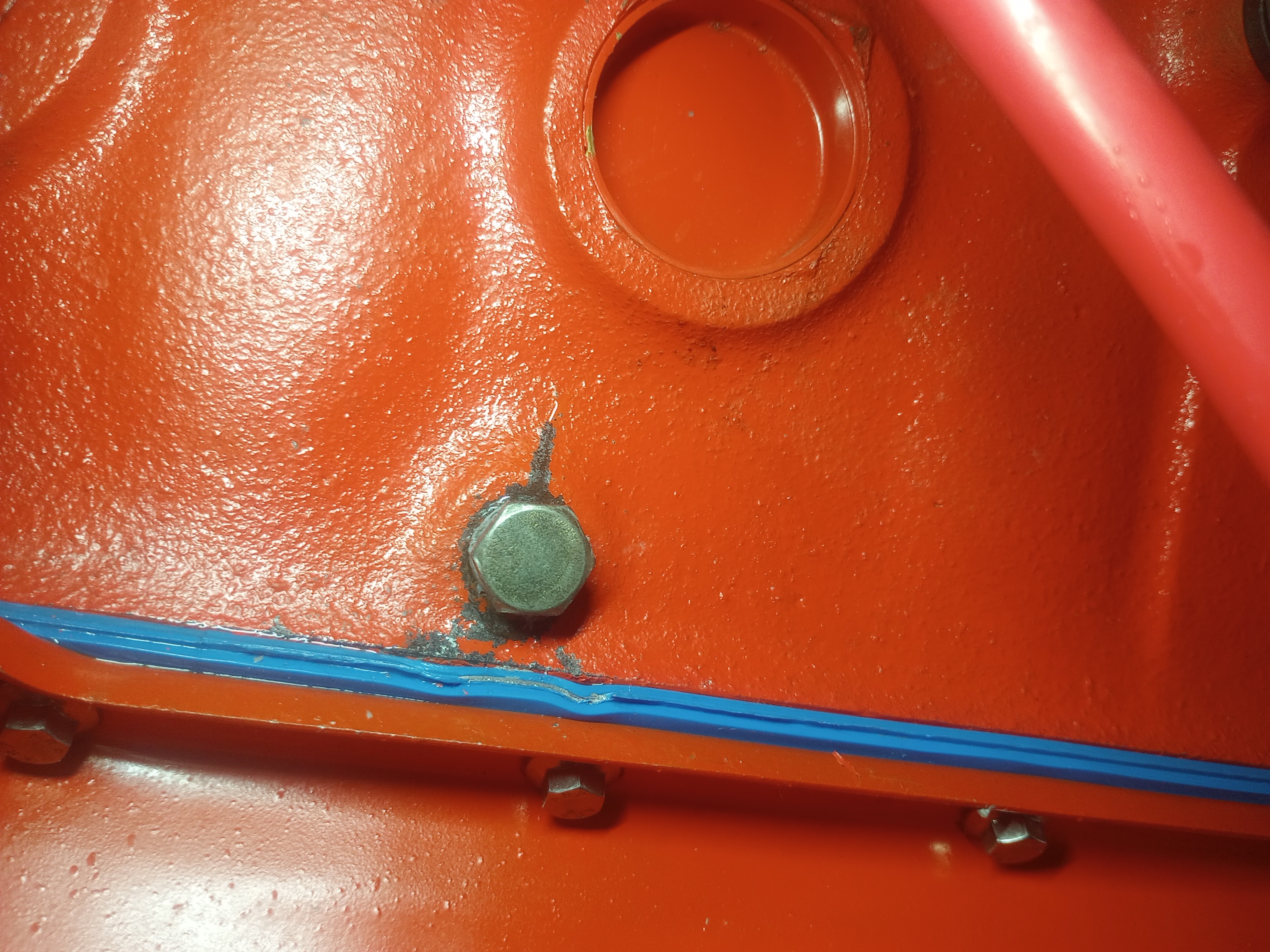

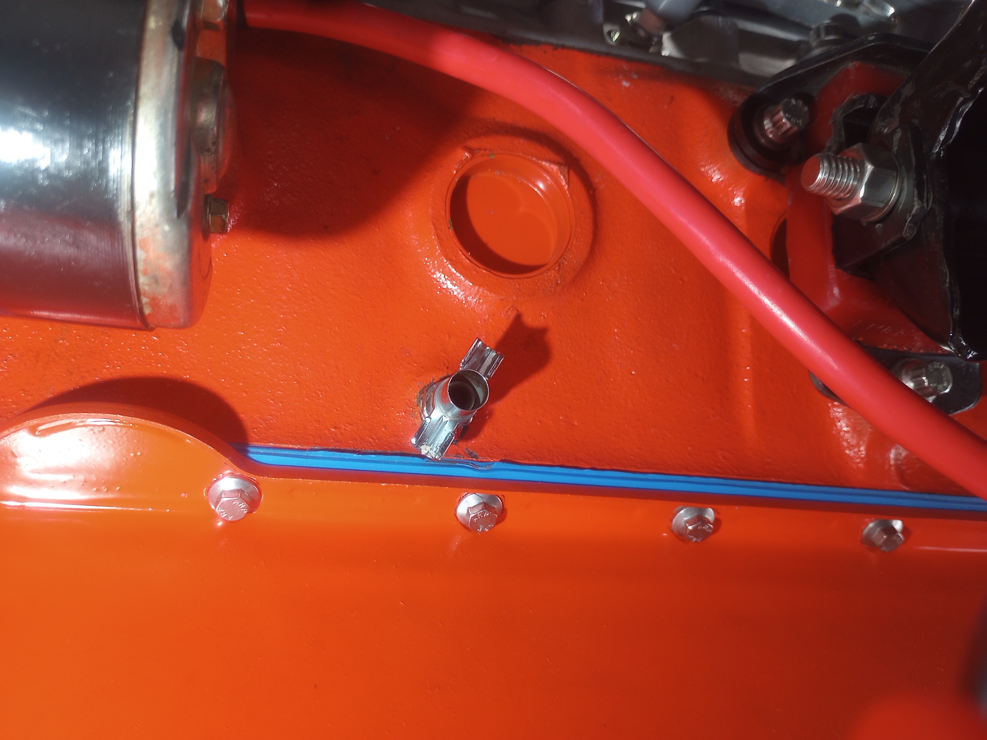

I still had an intermittent water leak, and I finally traced it to the block drain on the right side. It appeared to be leaking around the drain valve, so even though it wasn't loose, I snugged it up a turn or so, and that seemed to stop it. So, yesterday I took it for another drive, and when I came back, it was leaking even more. Today, I removed the drain valve and installed a regular pipe plug. I put sealant on it and snugged it up pretty tight, and the leak got even worse. After a closer inspection the leak it coming from a crack in the side of the block, starting just below the freeze plug and extending down into the block drain boss.
That is not what I wanted to see. Foul language ensued.
The original plugs were run in really tight when I bought the block and stripped it down. I installed the drain cocks when I put it back together, but didn't make them as tight as the plugs had been, so I know they didn't cause it to crack. Whether the crack was already there and propagated as the block heated and cooled, I don't know, but there was no leak there until recently or I would have noticed it.

View attachment 1353505View attachment 1353507
Was the block magnefluxed for cracks before assembly? Just curious.
Yes, it was. That was part of the prep on the block at the machine shop. But that was 12 years ago.

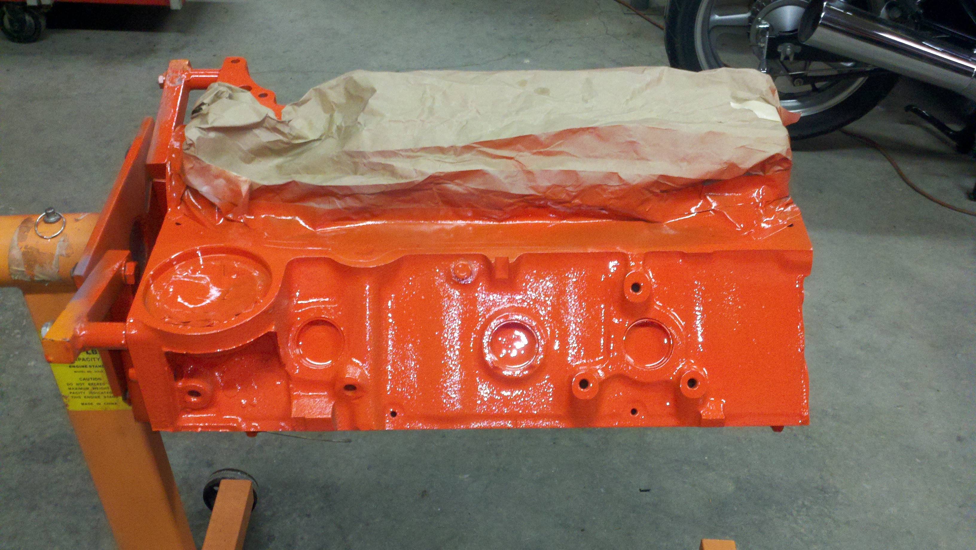

Great, nice to hear things are progressing. Are you going to paint the block when it is all back together, or leave it bare ? I always think it definitely looks better, but do you have any concern about it trapping heat ?
I'm going to paint it before I assemble the engine. That's what I did to the other block, and it'll be easier that after it's all together.
Here are some pictures of the old block after masking and painting. I'll do the same to the new block.
