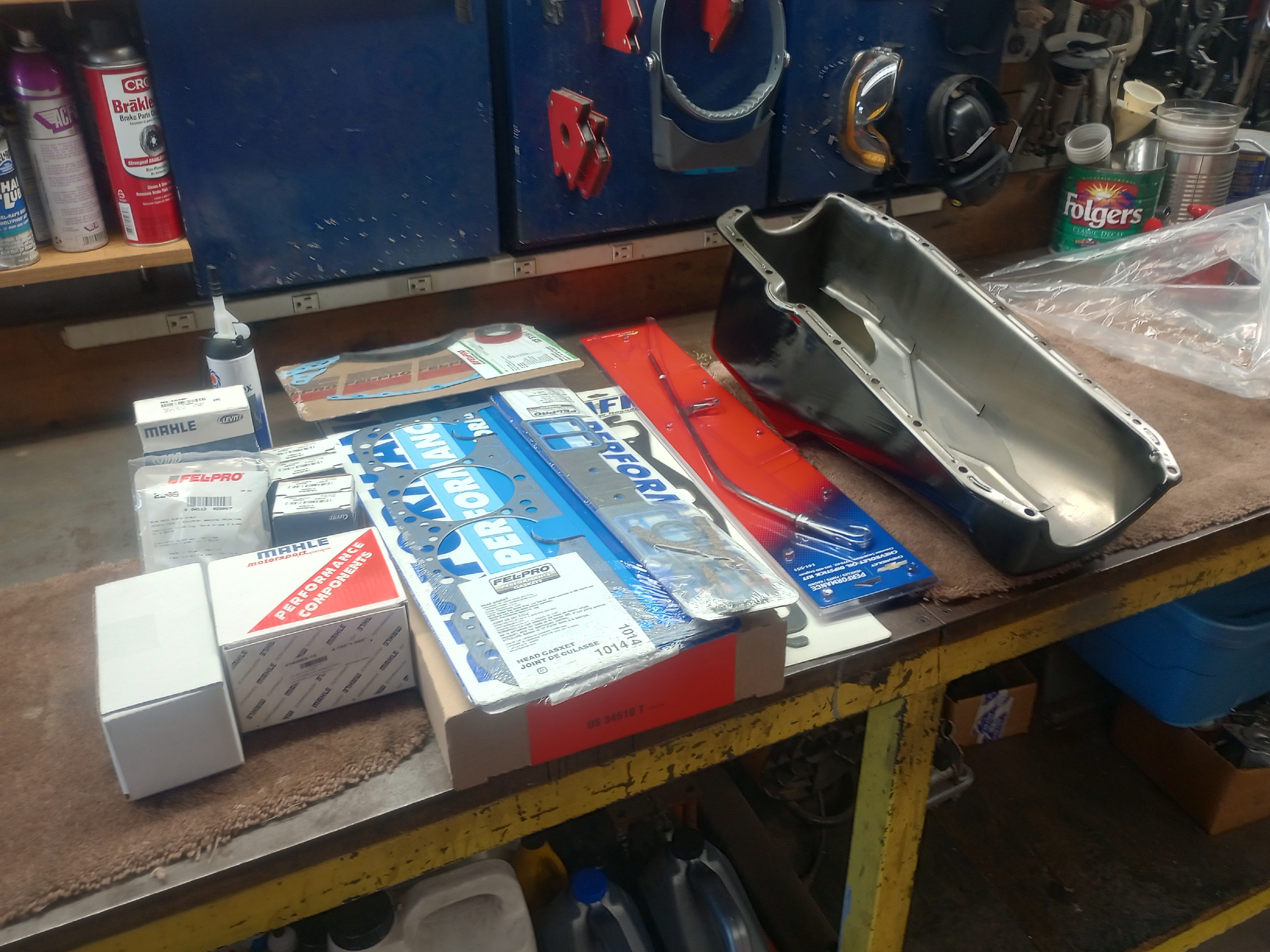

#706
UPS brought a big box from Summit Racing today, right on schedule. Got it all unpacked and it all looks good.
I checked out the new oil pan, as I had some concern about it being too deep where it sits over the crossmember, but the depth is almost exactly the same. Tomorrow, I'm going either scuff it up or blast the paint off it so I can paint it orange. I thought about getting it powder coated, but they shop said they are 2 to 2 1/2 weeks out on that, so paint it is. I need to check into a small oven to do powder coating of small items.

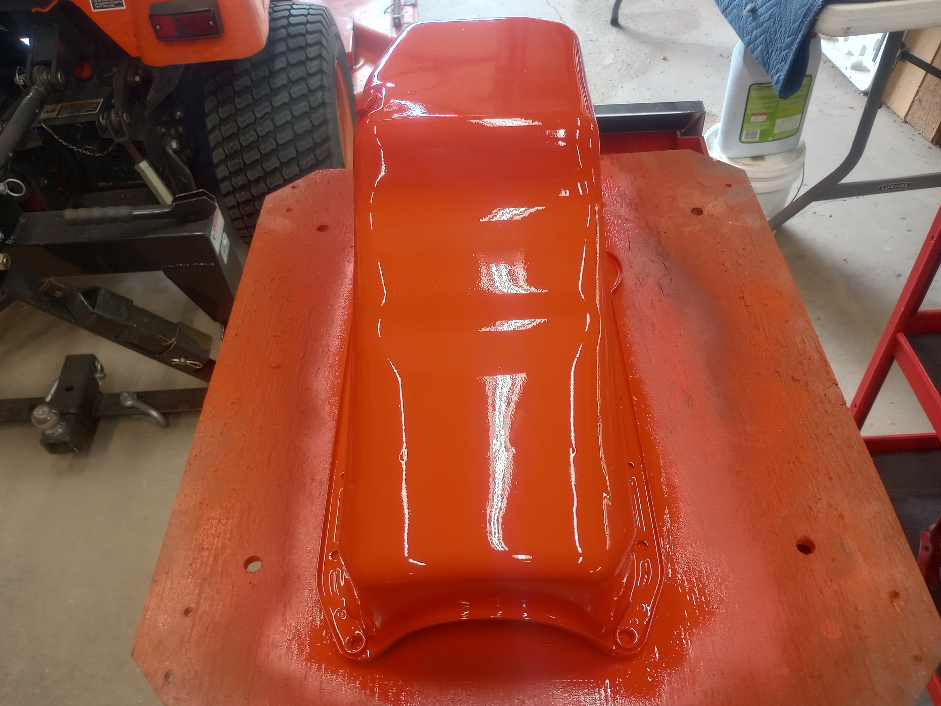

#709
Decided to paint the oil pan today, started sanding on it to scuff it up for paint, and it seemed pretty thin, so I put in the blast cabinet and took all the paint off.
It's good I decided to blast it, as the paint literally blew off, wasn't bonded to the metal at all.
I gave it a coat of self-etching primer, and then three coats of Chevy orange engine paint. Looks pretty good.
The machine shop tech called about 4:30PM and said the block was ready to pick up, so I'll go in and pick it up on Monday.
So, maybe in a couple of weeks, I'll have it all back together and running again.

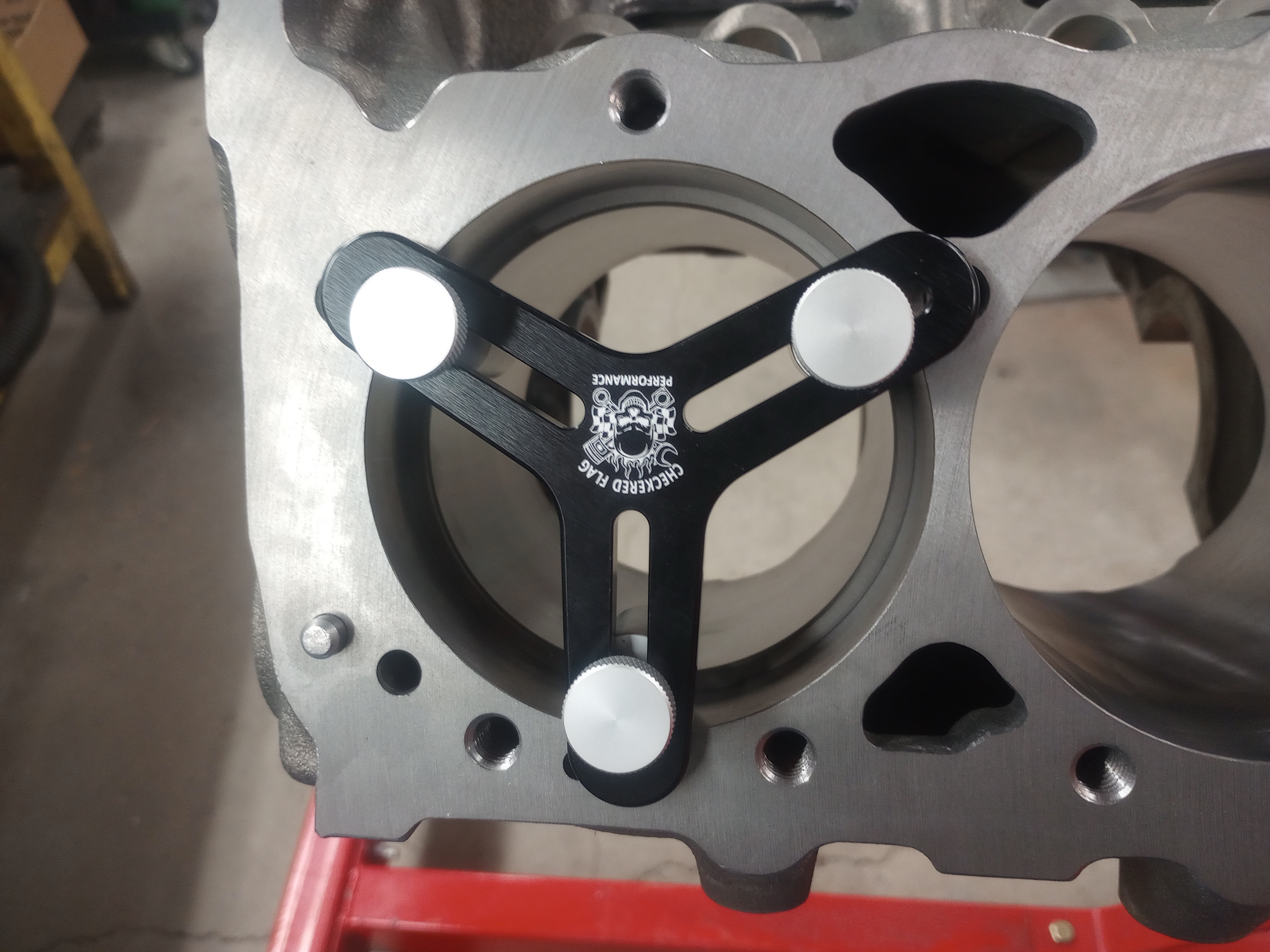

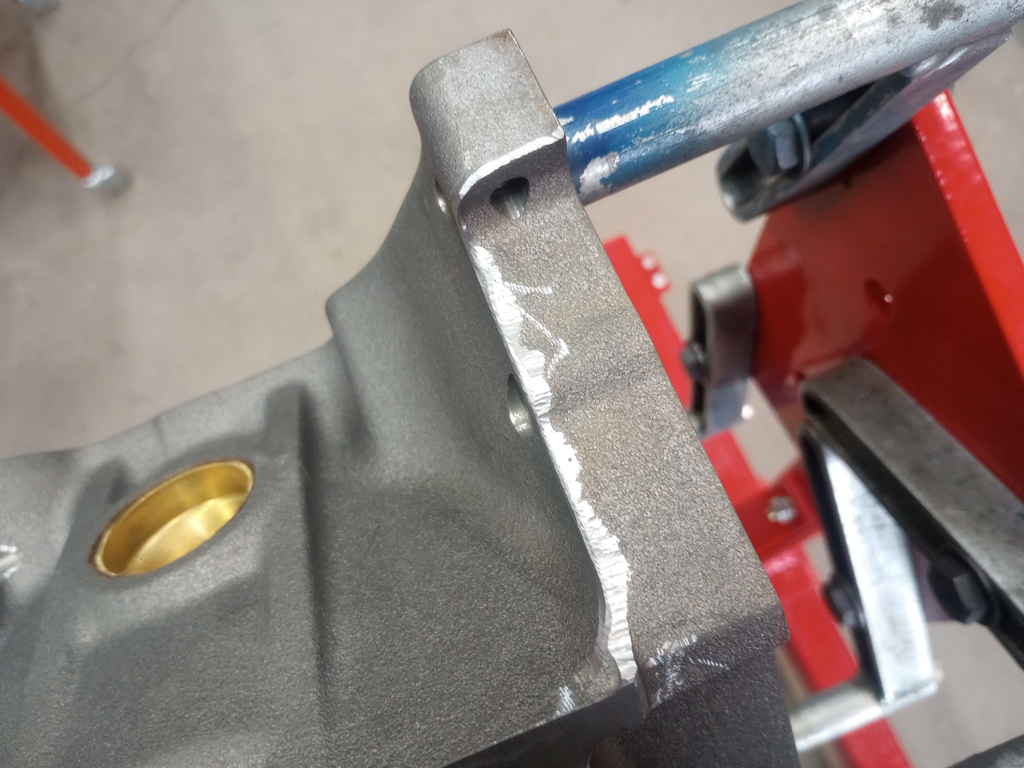

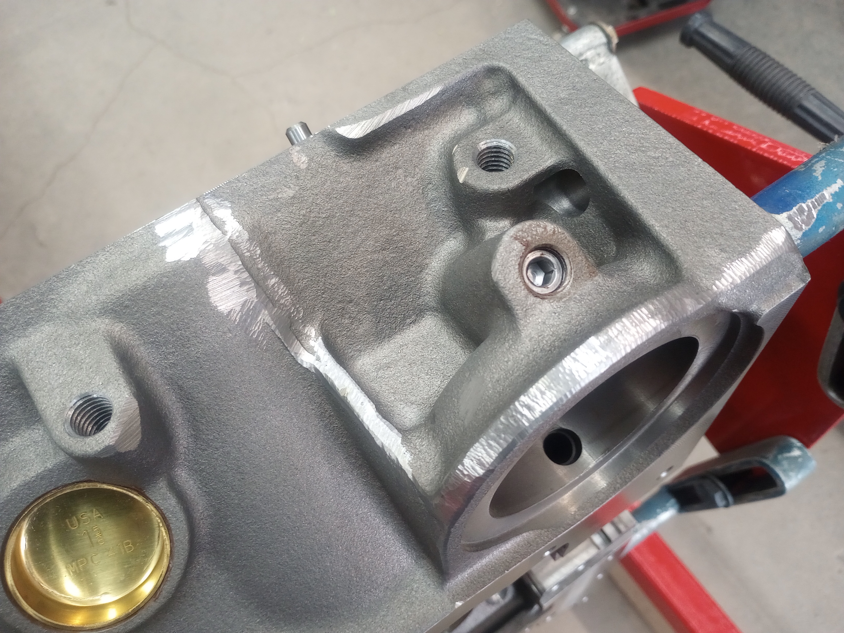

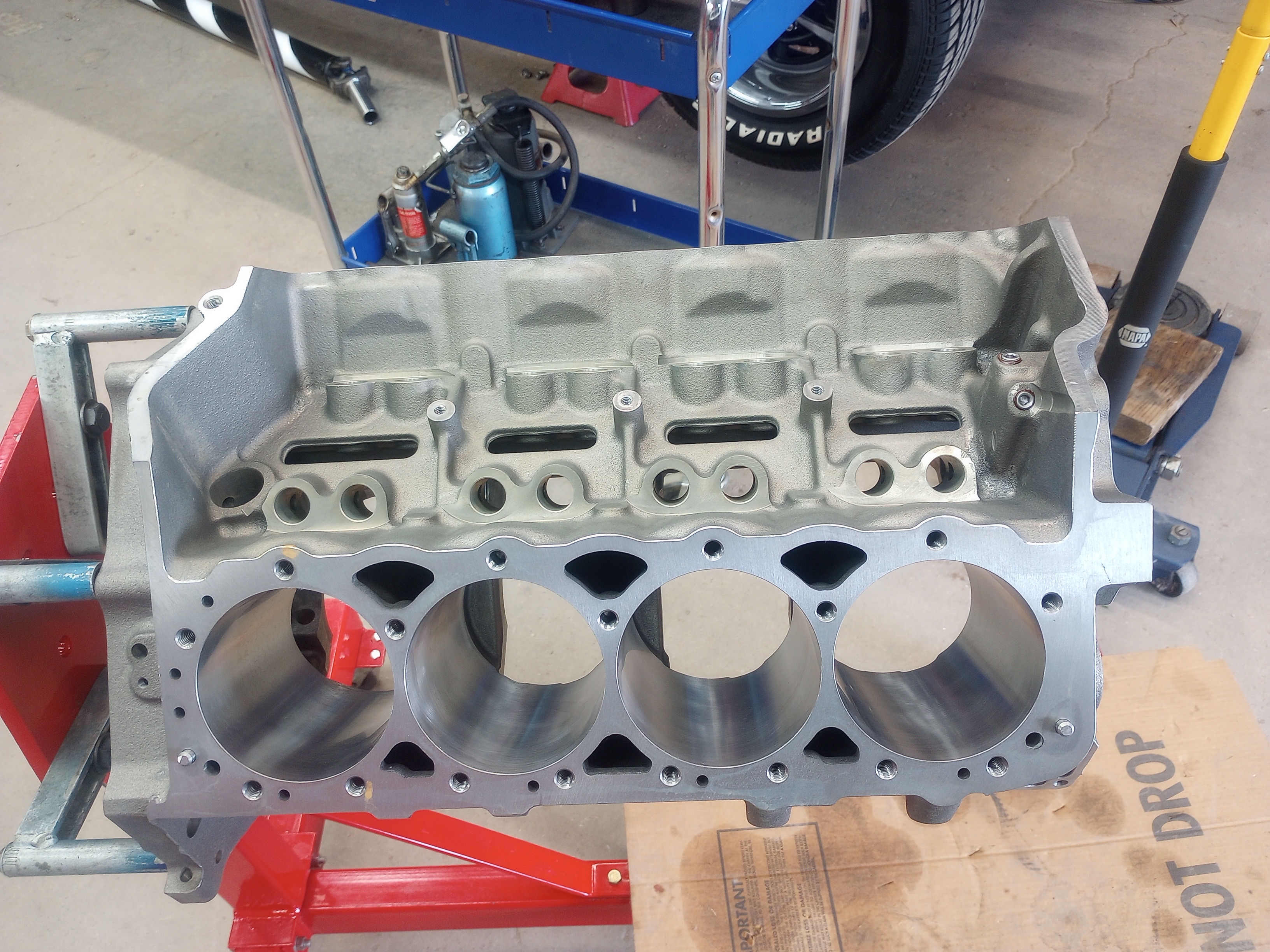

#710

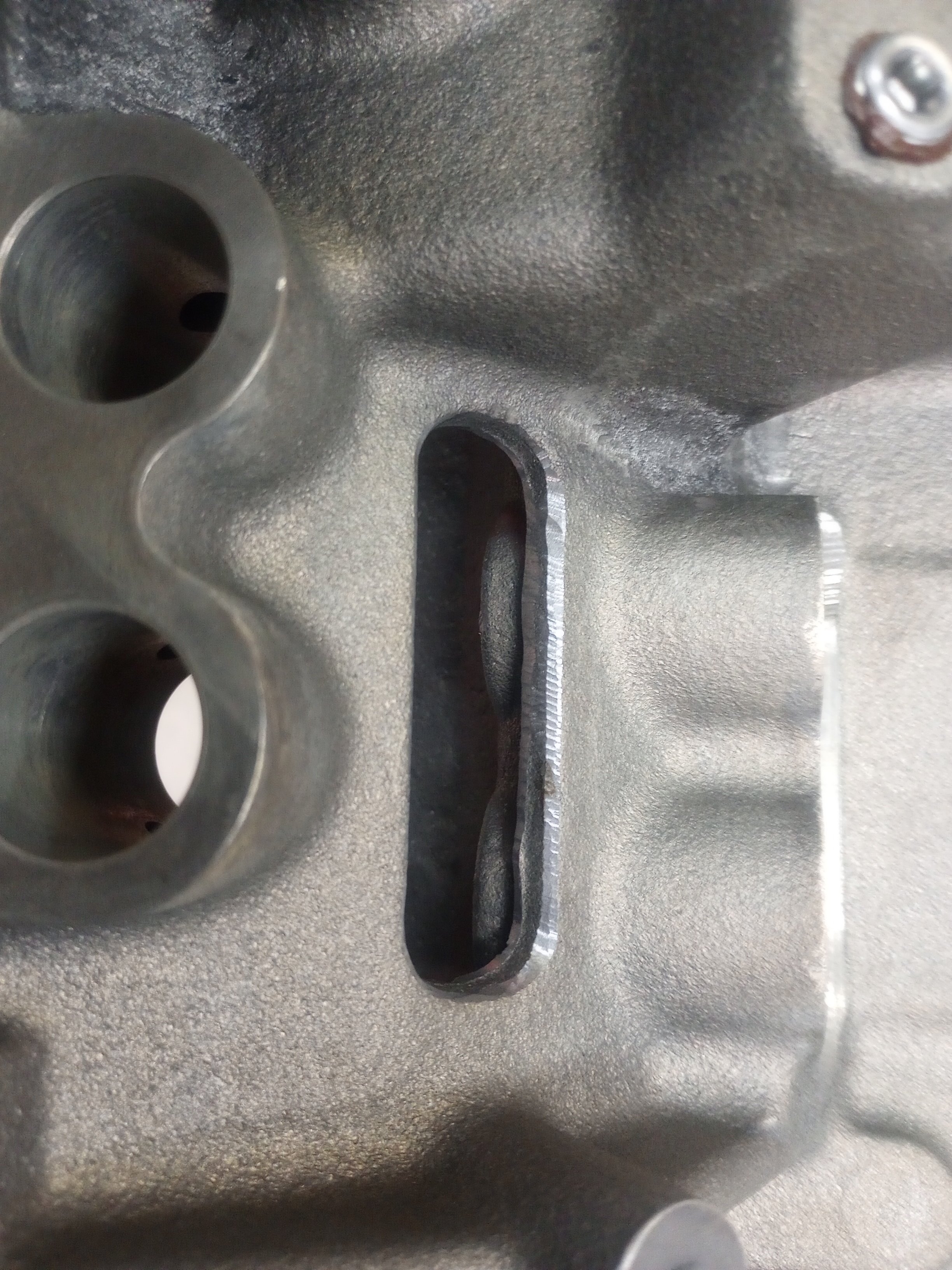

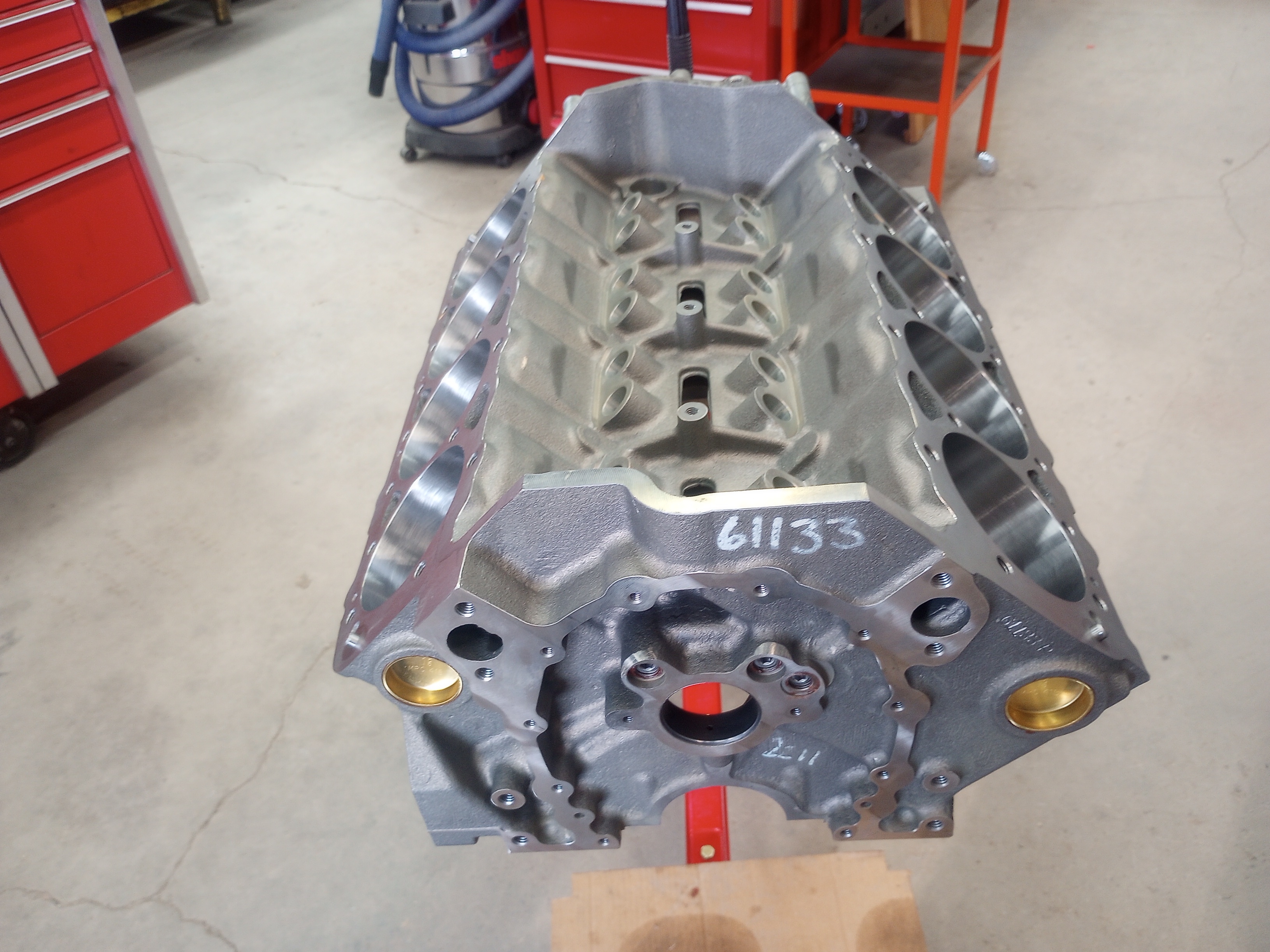

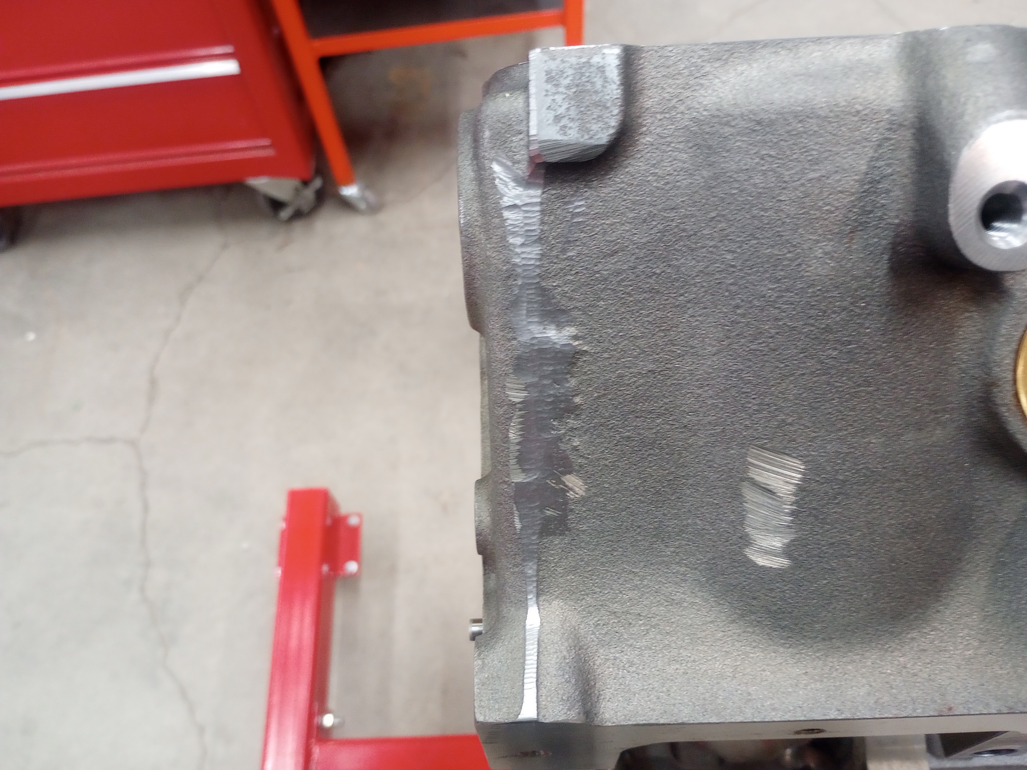

I picked up the block today, brought it back and hung it on the engine stand. Spent about two hours deburring sharp edges, deck water passages, main bearing bores and casting flash. One thing this block does differently than a stock block is to direct all the oil in the lifter valley to drain back over the camshaft, instead of through holes at the front and rear of the valley into the timing cover and over the rear crankshaft counterweight. I also countersunk every bolt hole and any oil passages I could get to. I blew it off with compressed air, but before final assembly I'm going to power wash it or maybe take it back to the shop and have them tank it again, just to be sure it's good and clean.

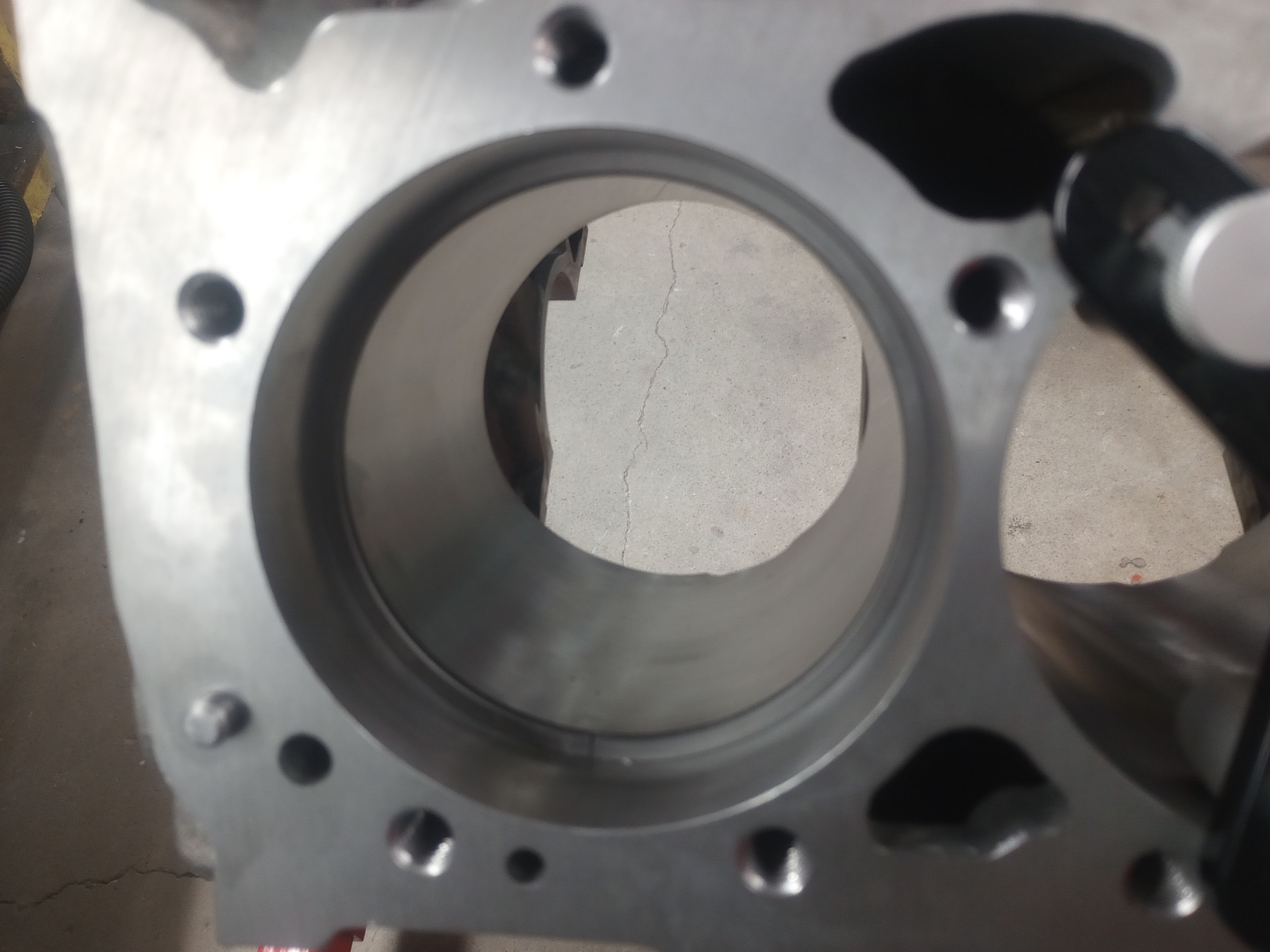

Then I'll mask off the block and get it painted Chevy orange. I started the fiddly process of gapping the rings, it's a slow process, but has to be done right or it can cause problems later. After that's done, I need to assemble the crank and piston/rod assemblies without rings, to check rod clearance in the block, bottoms of the cylinder bores and oil pan due to the 4 inch stroker crankshaft. I think, can't find it in the specs, that the block is clearanced for a 4 inch stroke, but I'll make sure.
