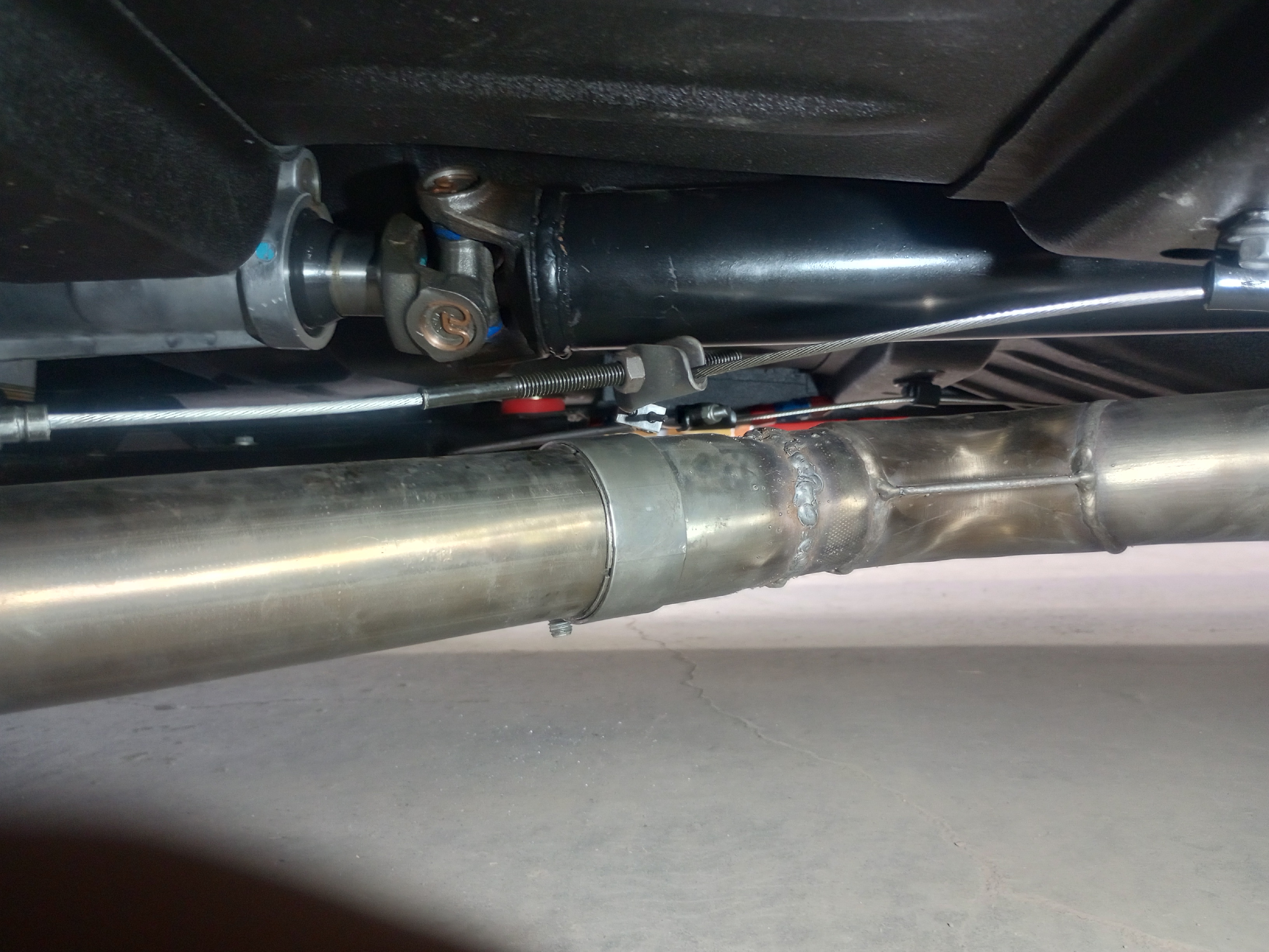

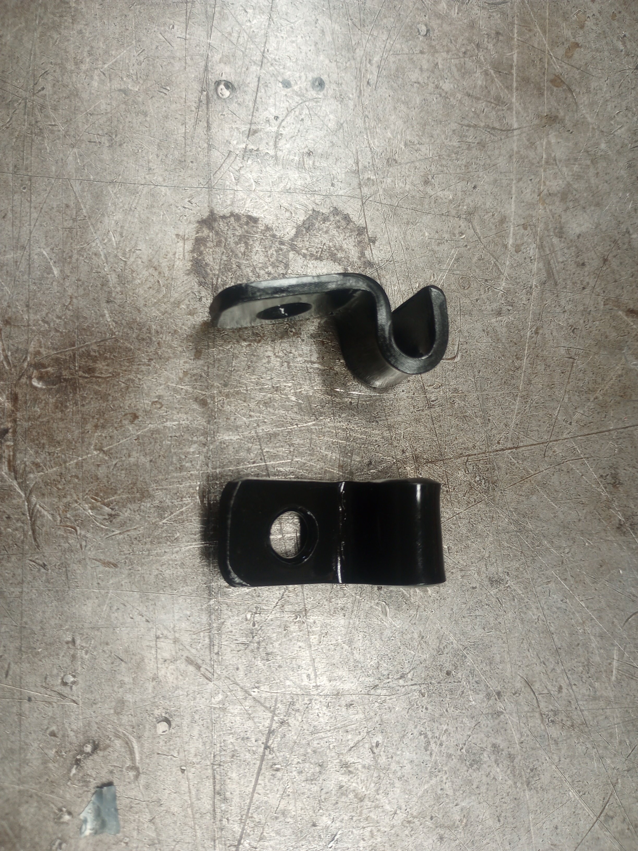

There has been a rattle from the parking brake cable lying on top of the exhaust pipe, so after trying a couple of fixes that weren't going to work, I came up with one that will work. I made a couple of P shaped clips out of 1/8" X 3/4" flat stock, and bolted them to one of the reinforcement crossmembers under the body. The first pair were too tall, so I made another pair that worked out a lot better. Now, the cable is held up above the exhaust pipe 1/2"-3/4" and won't rattle against it nor rub the driveshaft. Don't look at the horrible welding job on the X-pipe, I didn't have any stainless TIG rod, so I had to MIG weld it, and it was a disaster. But it doesn't leak.
Today, I jacked it up and repositioned the tailpipes, as the clamps on the pipes and mufflers had let them rotate a little out of proper position. I used my 3/8" Dewalt impact to get the clamps as tight as they would go. Hopefully they'll stay in position now.

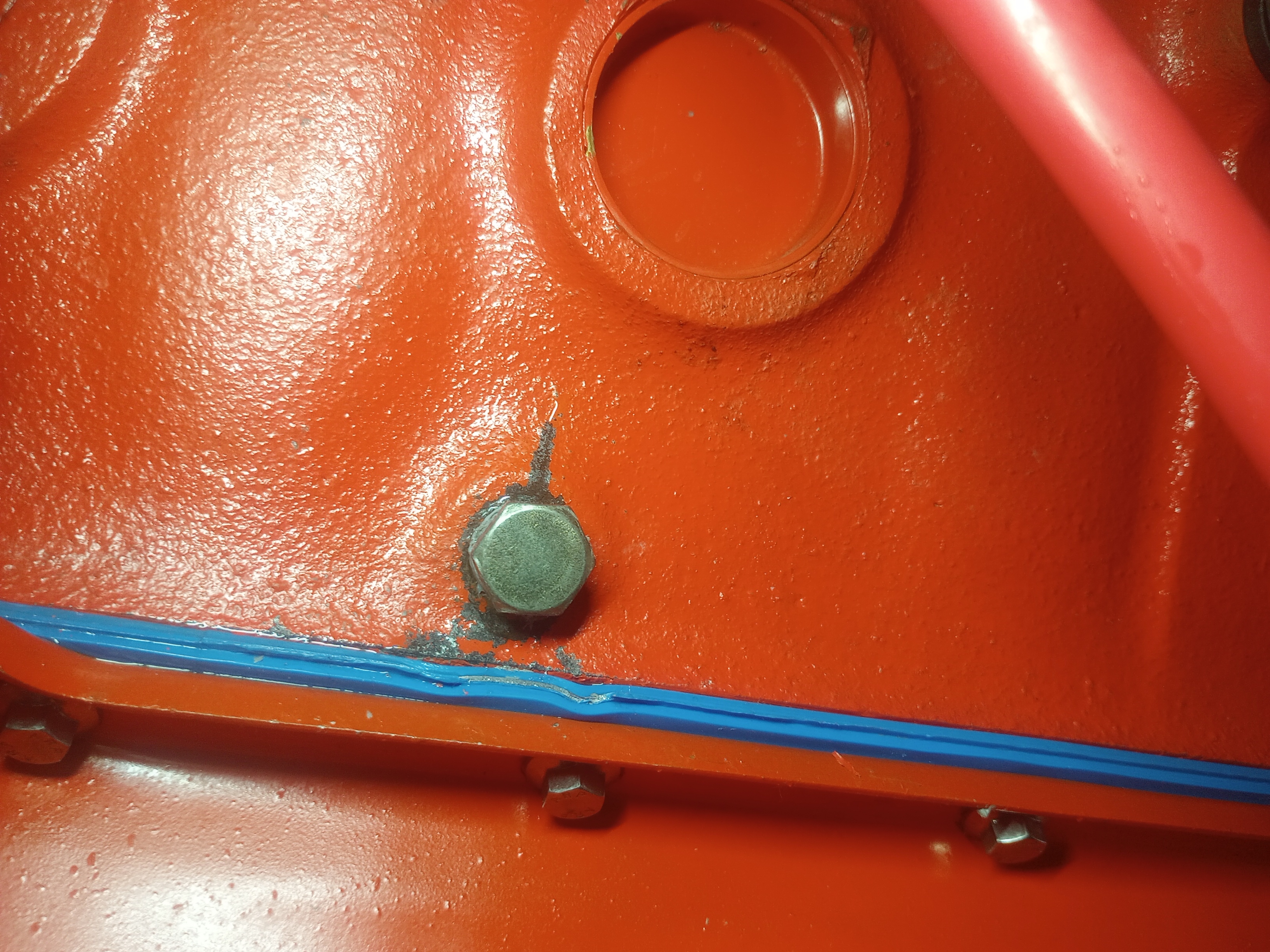

I still had an intermittent water leak, and I finally traced it to the block drain on the right side. It appeared to be leaking around the drain valve, so even though it wasn't loose, I snugged it up a turn or so, and that seemed to stop it. So, yesterday I took it for another drive, and when I came back, it was leaking even more. Today, I removed the drain valve and installed a regular pipe plug. I put sealant on it and snugged it up pretty tight, and the leak got even worse. After a closer inspection the leak it coming from a crack in the side of the block, starting just below the freeze plug and extending down into the block drain boss.
That is not what I wanted to see. Foul language ensued.
The original plugs were run in really tight when I bought the block and stripped it down. I installed the drain cocks when I put it back together, but didn't make them as tight as the plugs had been, so I know they didn't cause it to crack. Whether the crack was already there and propagated as the block heated and cooled, I don't know, but there was no leak there until recently or I would have noticed it.
I have welded some engine blocks in the past, but trying to weld a threaded hole that will be stressed by installing a pipe plug is not a good bet to succeed, in my opinion.
So now I have to either find another Chevy block, which are getting to be pretty rare, and taking a chance on another used block, or replacing it with an aftermarket block, which would definitely be a better choice. Either way, If the used block is standard bore, it will have to be bored to .030" oversize to fit my pistons, and one that is already oversize, it's unlikely it will be the precise sized bores for proper piston clearance. Do I want to put that much into a used block?
A new Dart 400 block will also need to be bored, but at least it will be bored to the correct dimensions. The other possibility would be to buy new pistons to fit the 4.125" bores of the 400 block. I'm going to check to see how the machine work cost will compare to the cost of new pistons.

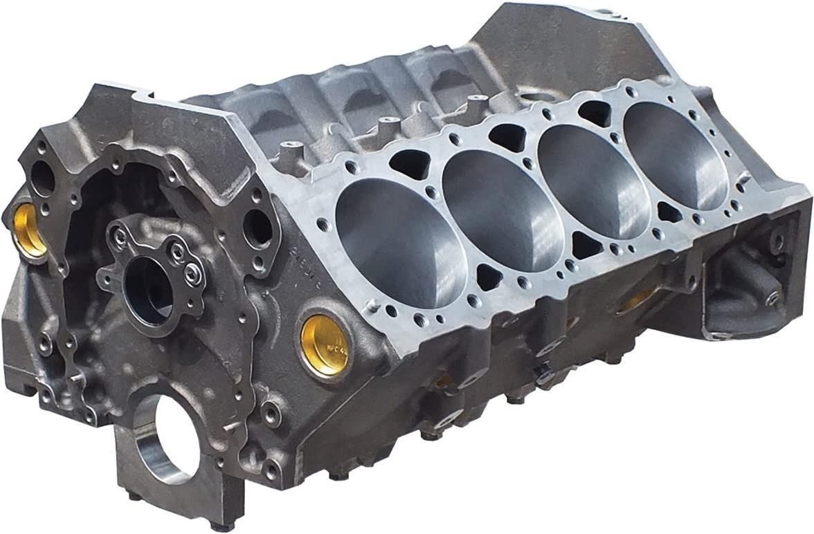

Talked to the machine shop tech today, and I'm going to go ahead and get a Dart SHP block for the replacement. He thought the same as I did that using another Chevy block could lead to the same or another problem down the road, as all those are at least 30 years old, and who knows what kind of abuse they have been subjected to.
Since the new block will have to be bored, they all come with undersized bores, it will also need cam bearings and freeze plugs too. It will also need to be line bored and decked to make sure everything is true, and also have the lifter bores honed to size. If I buy it from him, he'll knock a little off the price since he'll be doing all the machine work too. He also suggested having the new ARP heads checked for flatness, since I had a leak after I initially installed them. I'm not going to take anything for granted this time around.
So, later this week I'll go in and pay for the block and he'll get it coming, probably next week some time. Until then, I'll get the engine out, again, get it all disassembled, cleaned up and inspected. I may have the shop order a ring set, bearings, seals and gaskets, not sure right now.
