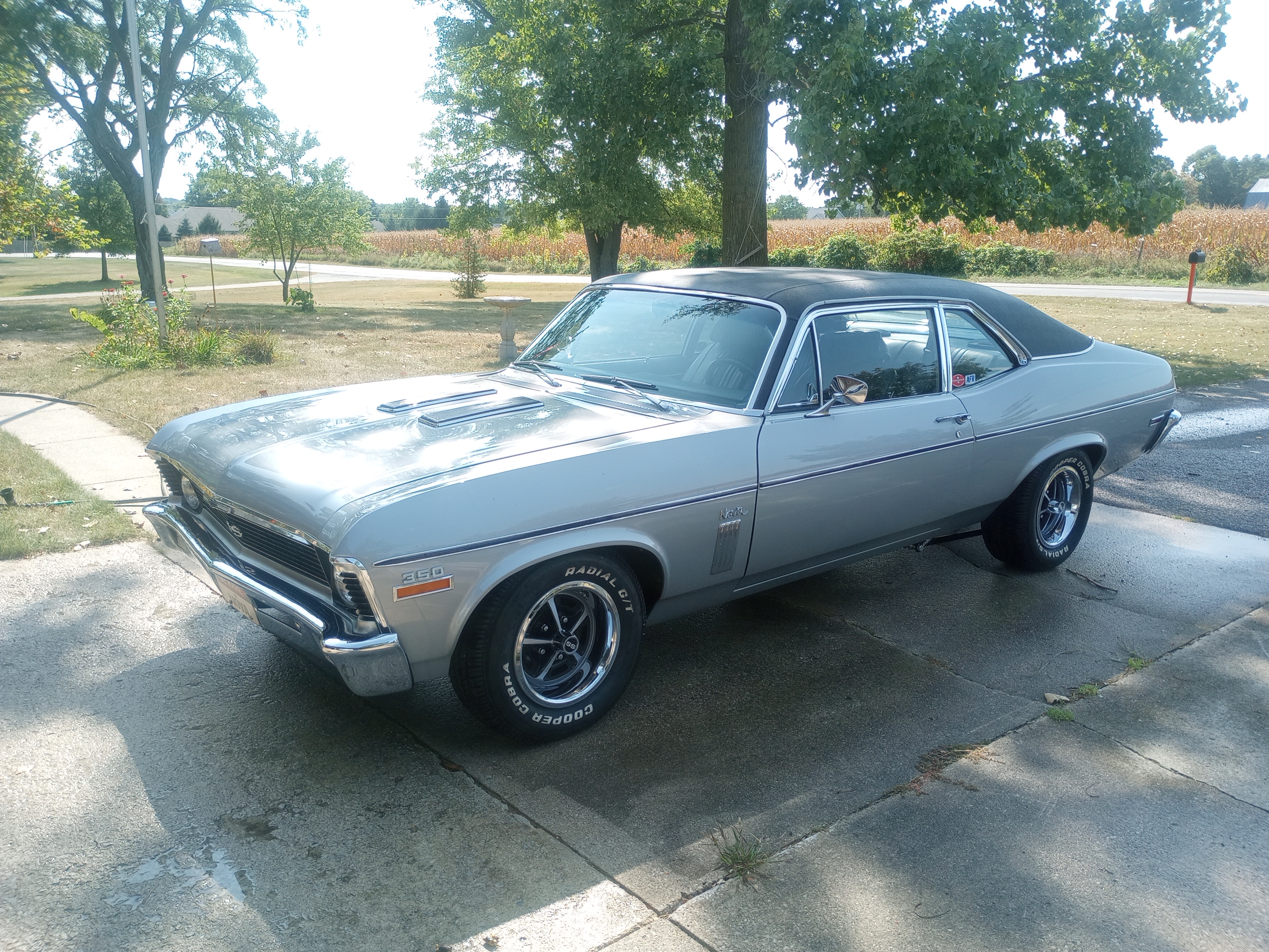

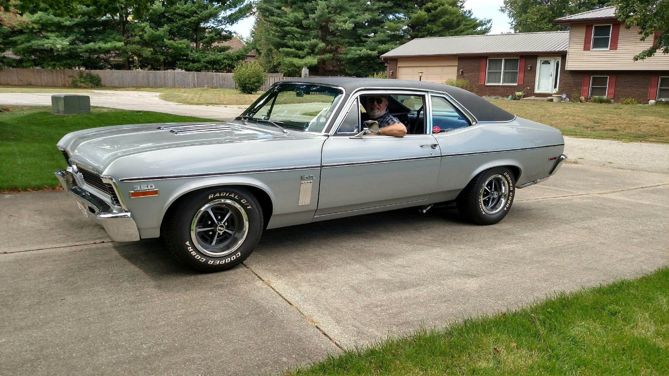

So this week I've put about 90 miles on the Nova, with no problems. The oil leak is gone, and the coolant leak is gone too, finally.
I took Brian for a ride on Thursday, and Ed, my old boss from the 80's came over on Friday and went for a ride.
The engine is running really well, I've been adjusting the Air/Fuel ratios in the EFI to get it leaned out enough that it doesn't soot the plugs up so badly. I had talked to MSD's tech support about it when I first got it running and it was sloppy rich despite what the AFR targets showed for idle, cruise and WOT, and he said it would take 50 miles or so of road mileage to get the system to learn where the ratios should be. I may pull the plugs, clean them and run it for another 50 miles or so and check them again.
When Brian was with me, I had turned onto a county road and leaned into the throttle in first gear, and it broke the tires loose instantly. Plenty of power under the hood.
This afternoon I went to anther friend's place, picked him up and went for a 20 mile or so cruise and he really enjoyed it, as he's also an old muscle car guy. Over the years he had a Road Runner, Corvette, Chevelle and Charger at one time or another.
When I dropped him off, he even took a picture as I was leaving his place.
Tomorrow morning, I'm going to take it to town for my Sunday morning breakfast as long as it's not raining.
Been a long time coming.

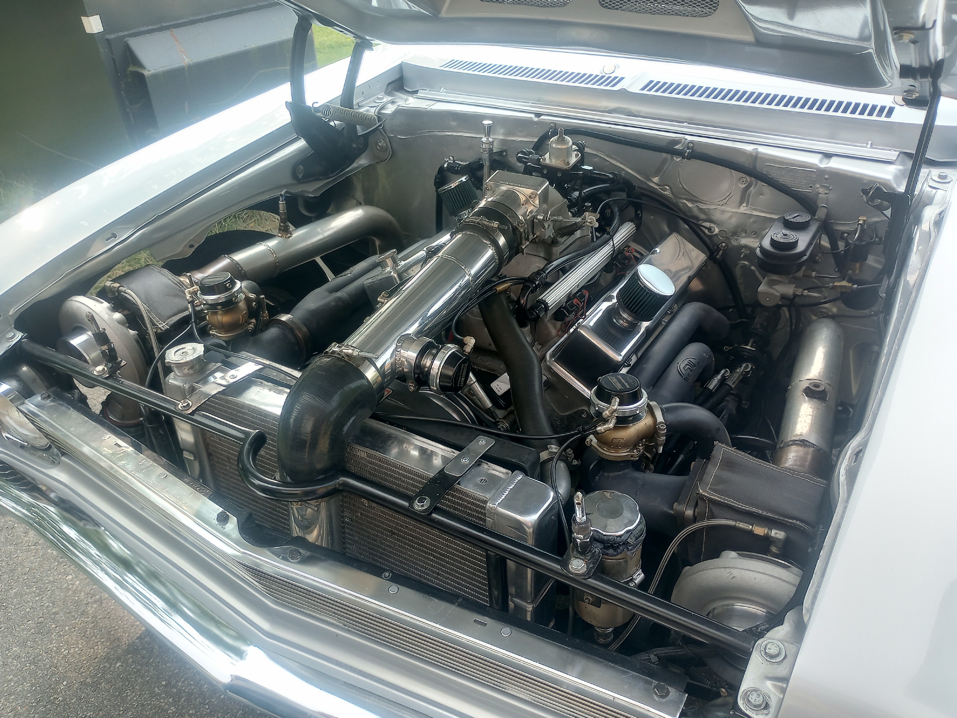

While I was in the shop this afternoon, a fellow Nova owner stopped by with his '68. It is basically a race car, 400 SBC with twin turbos and Holley EFI, running on E85. He says it runs in the 8s. Sounds really nasty, the exhaust just dumps out behind the front tires.
It had caught fire a couple of years ago, damage wasn't too bad, and he got it rebuilt this spring.

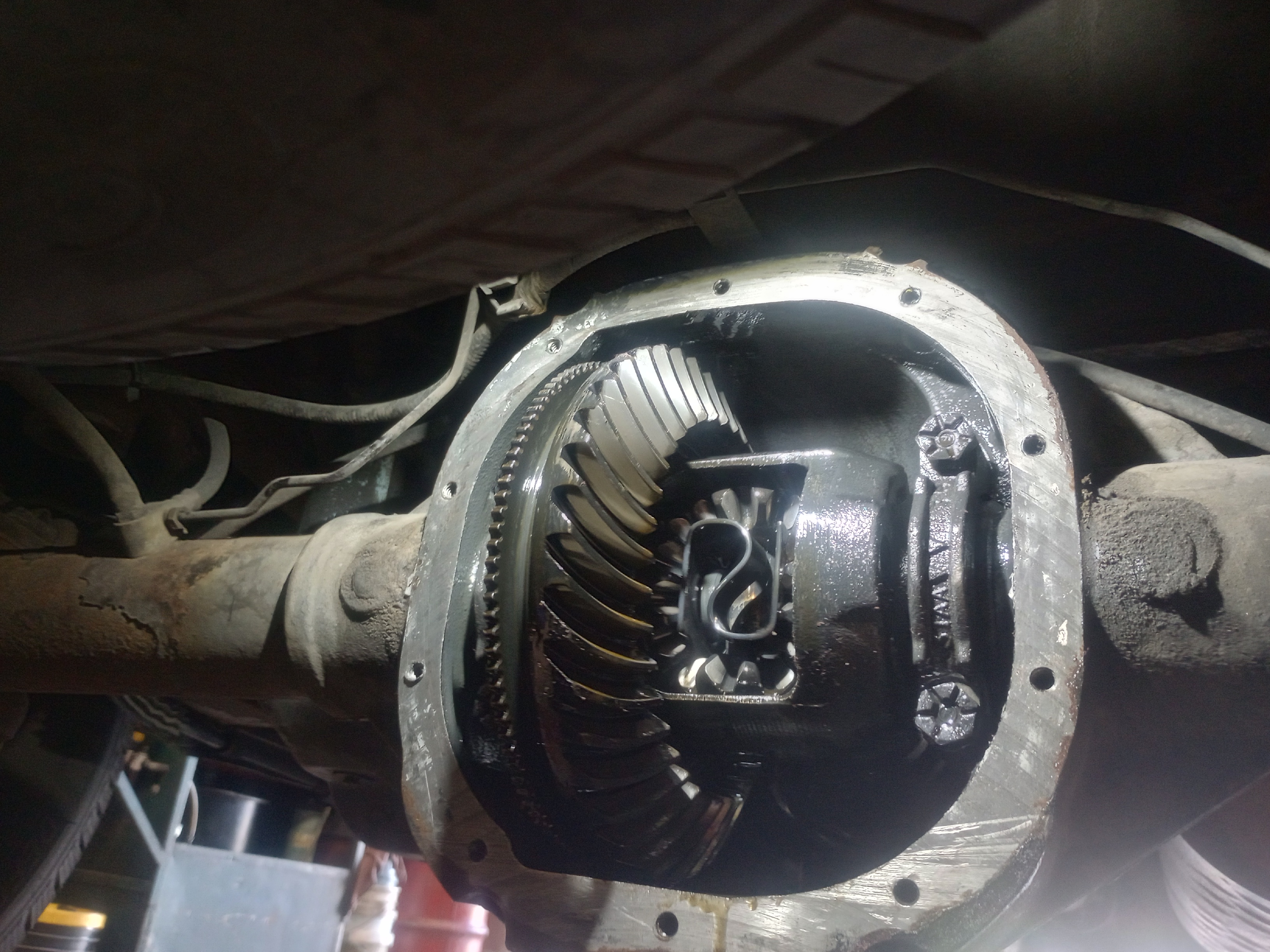

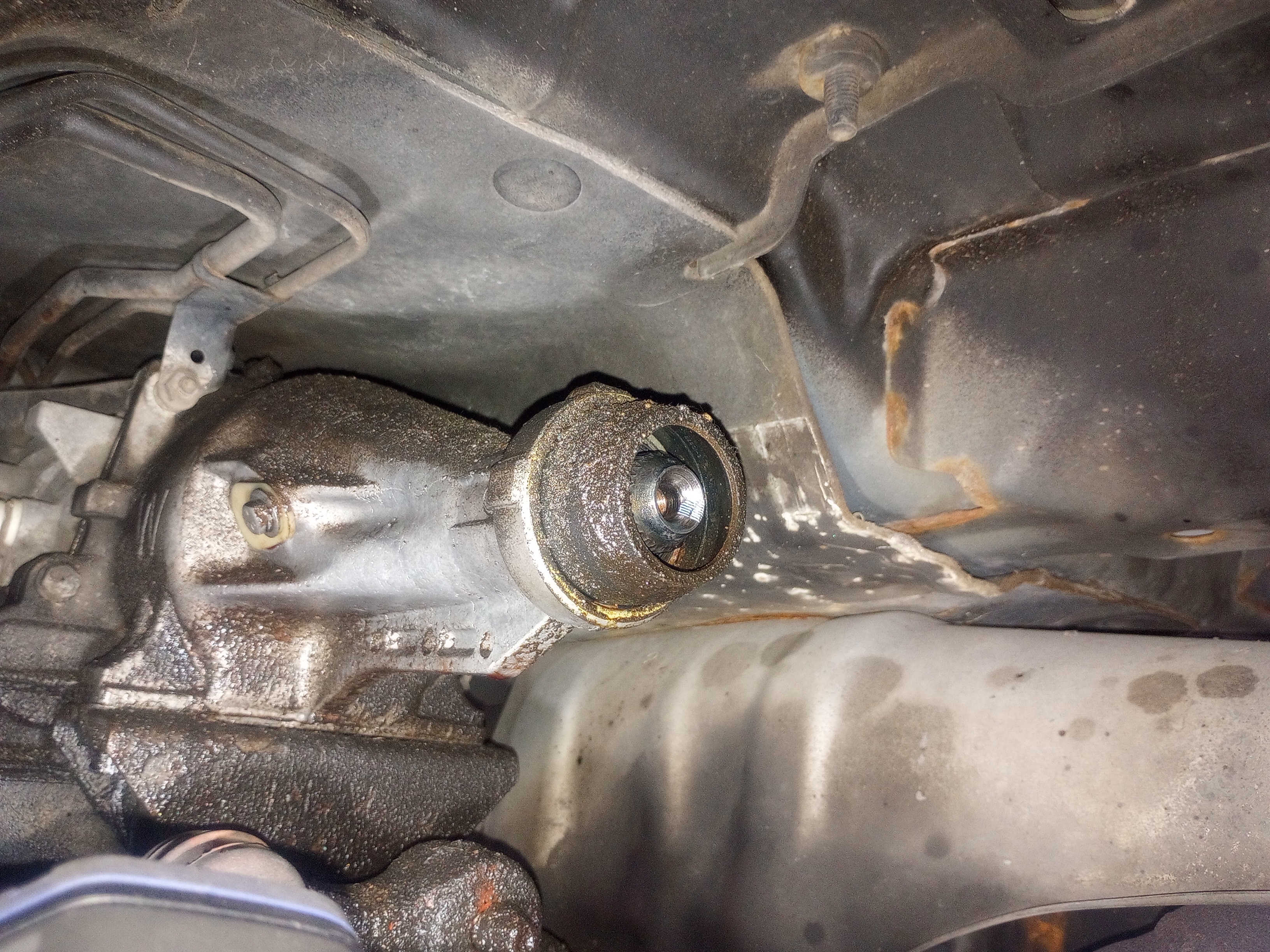

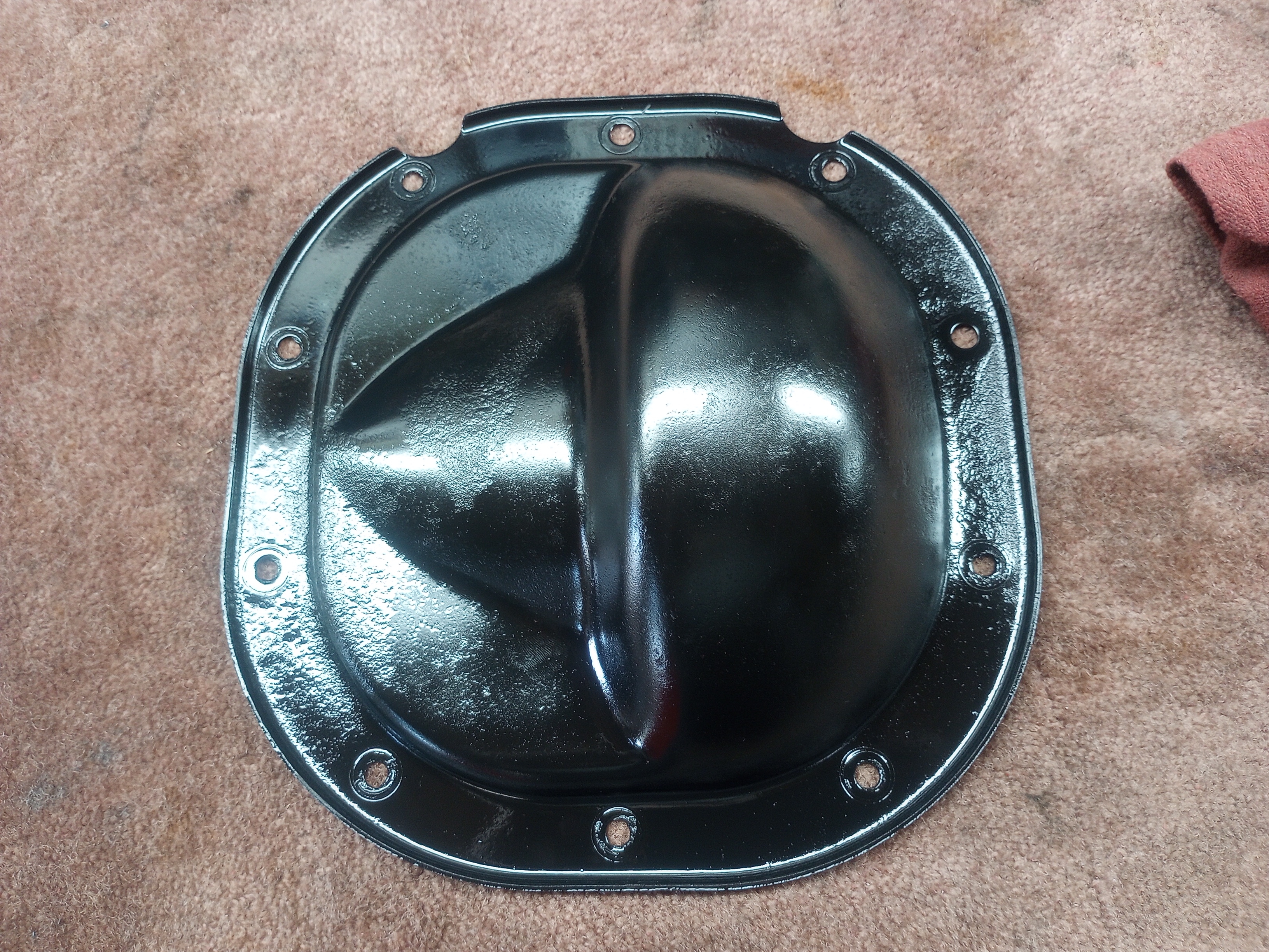

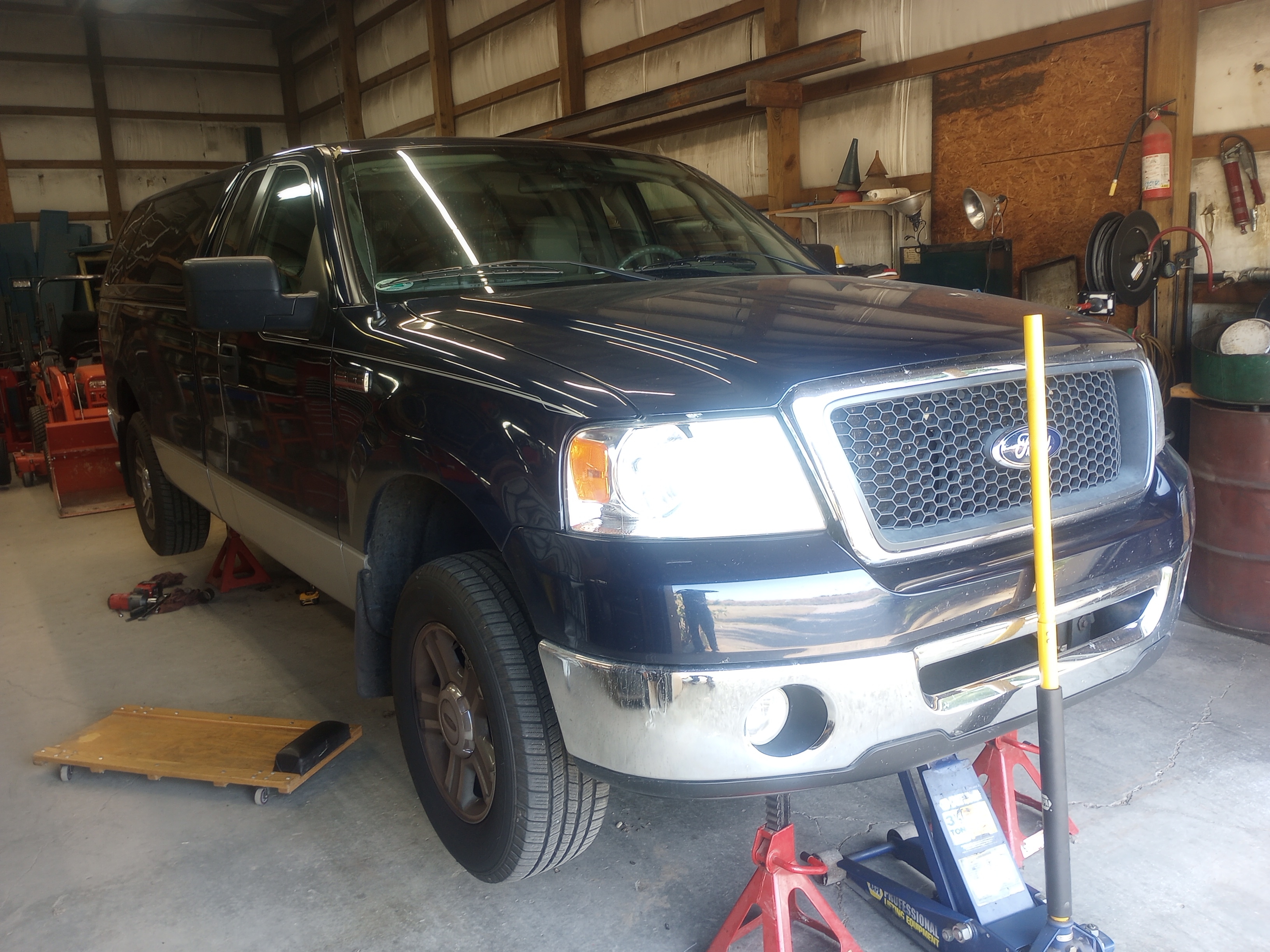

I had to do some maintenance on my F150 last week, the pinion seal and rear transmission seal have been leaking for a while, so I bought the seals, a cover gasket and gear lube for the differential. I got it up on four jackstands pulled the driveshaft off the rear, pulled the pinion flange and after a little struggle got the old seal out. Used a short piece of 2.5" exhaust pipe and a hammer to drive the new seal into place, then put the pinion flange back on. I had a little surprise when I pulled the flange and seal, as about 2/3rds of the lube ran out into the small pan I had under it. It finally stopped when it was about 1/4" from overflowing. I Pulled to cover off and drained the last bit of lube and cleaned out the inside of the housing. That's when I realized NAPA had given me the wrong gasket, and the lube wasn't for the limited slip rear, so I cleaned up and drove the Nova to the store and got the correct stuff.
Next afternoon, I pulled the drive shaft out of the trans and changed that seal, which was a little more of a challenge, as it's surrounded by the crossmember, exhaust pipe and heat shields. I finally got it out and found an old Speedi-Sleeve install tool that fit the new seal to get it driven back into the housing. That done, I slid the driveshaft back in, bolted up the mid-ship bearing and bolted it back on the pinion flange. When I was cleaning up the rear cover, I decided to blast all the rust off and paint it, as it looked really bad. After it dried, I applied a little gasket maker to the gasket and bolted it back on. The gear lube came in flexible pouches, so you just snip off the spout and squirt (most) of it into the fill hole. It takes a little finesse to get it in without squirting it on the diff, the floor or you. Ah, but that's what Oil-Dri is for. I used a couple of cans of brake cleaner and cleaned up the diff housing and the rear of the trans, to soothe my OCD.
I guess with 267,000 miles on them, that's not too bad for the seals to last.
