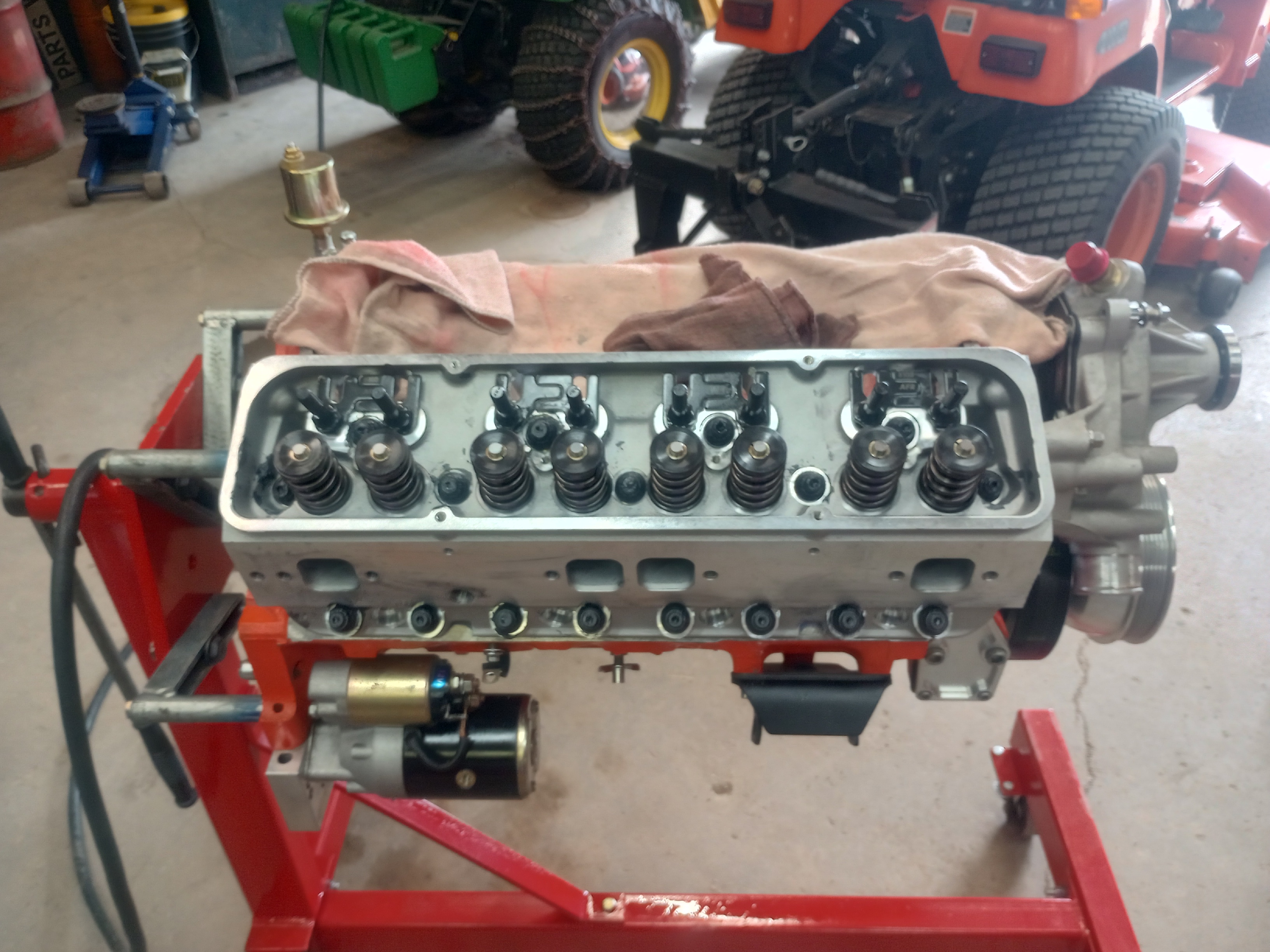

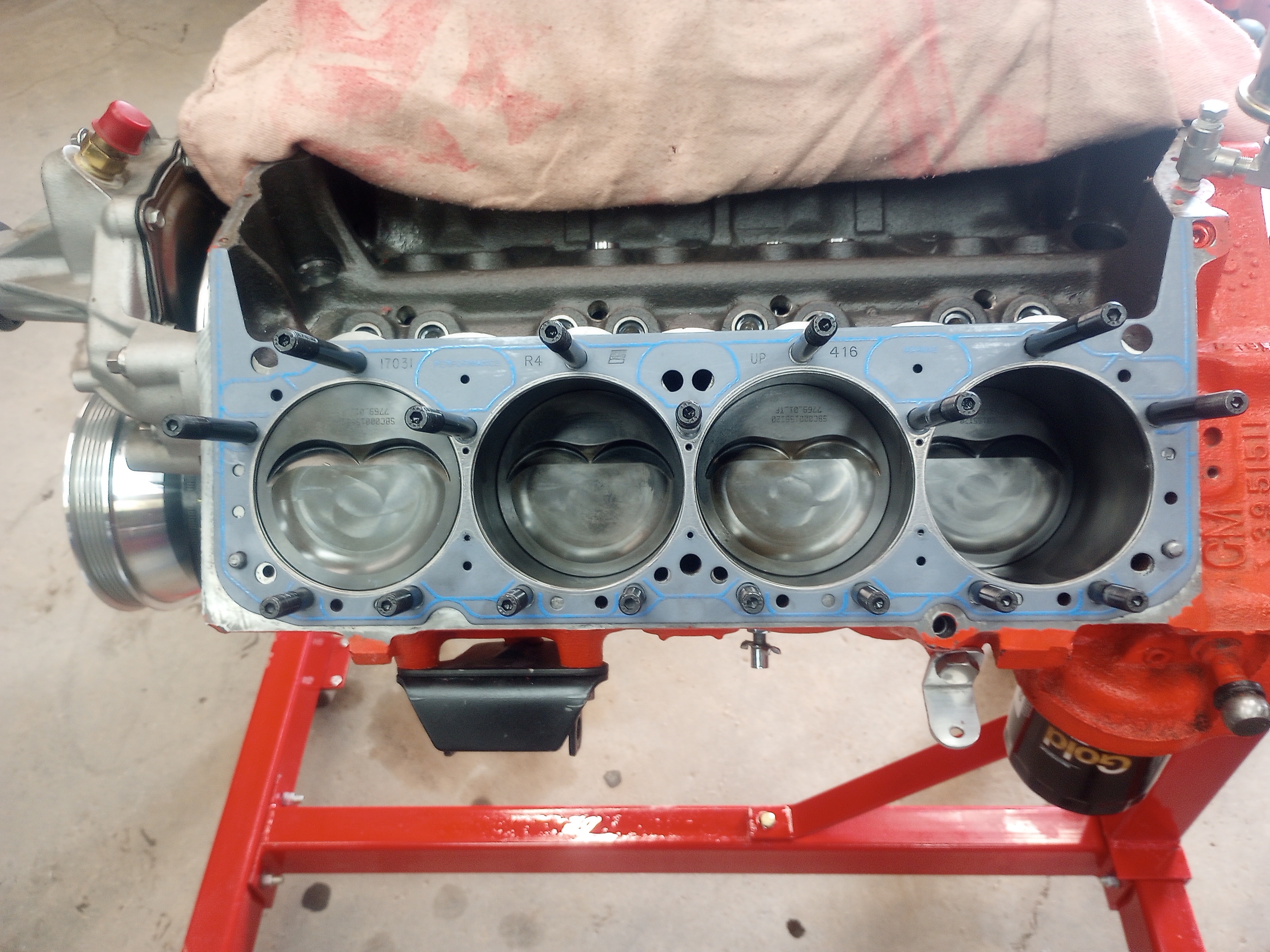

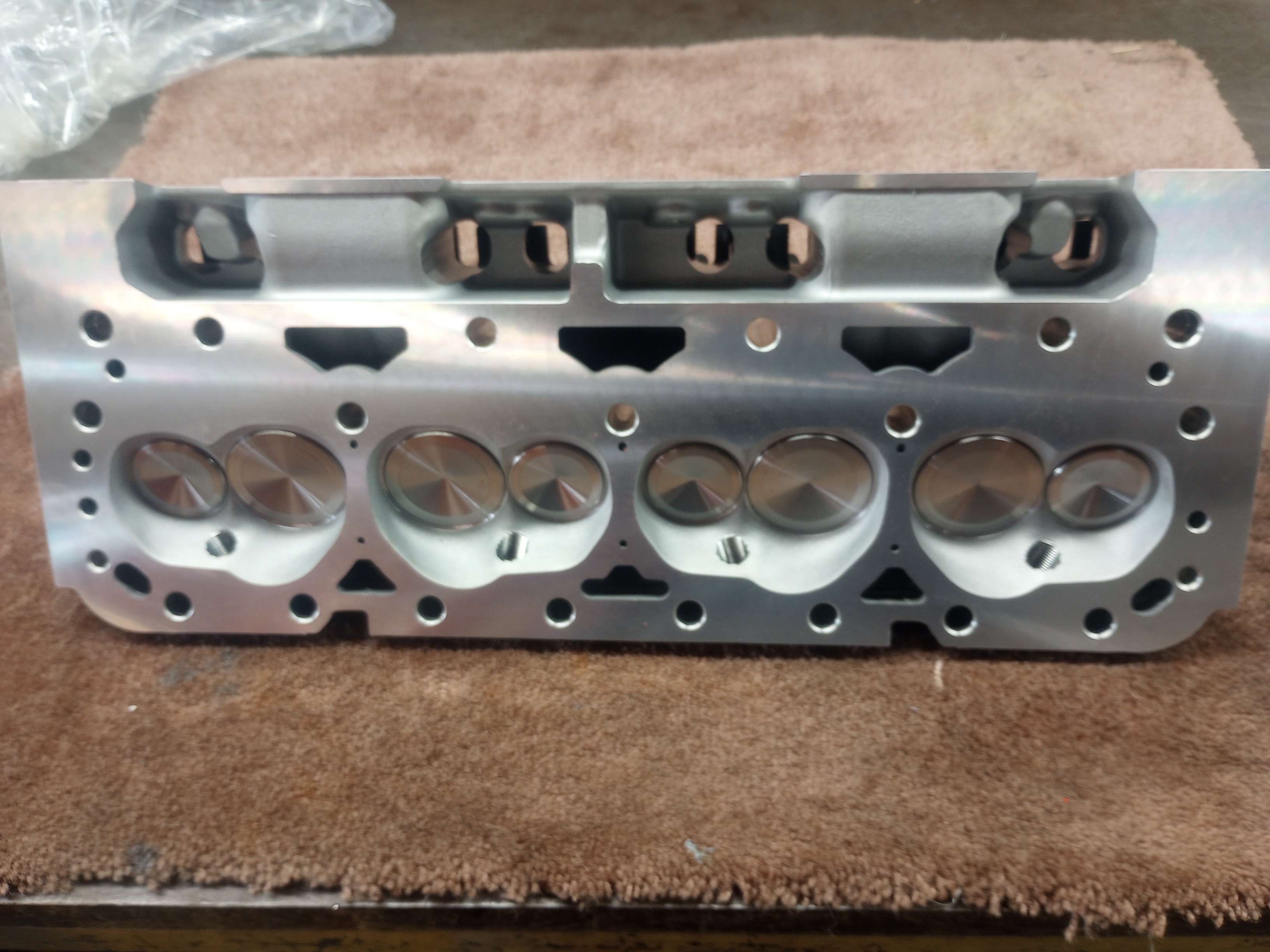

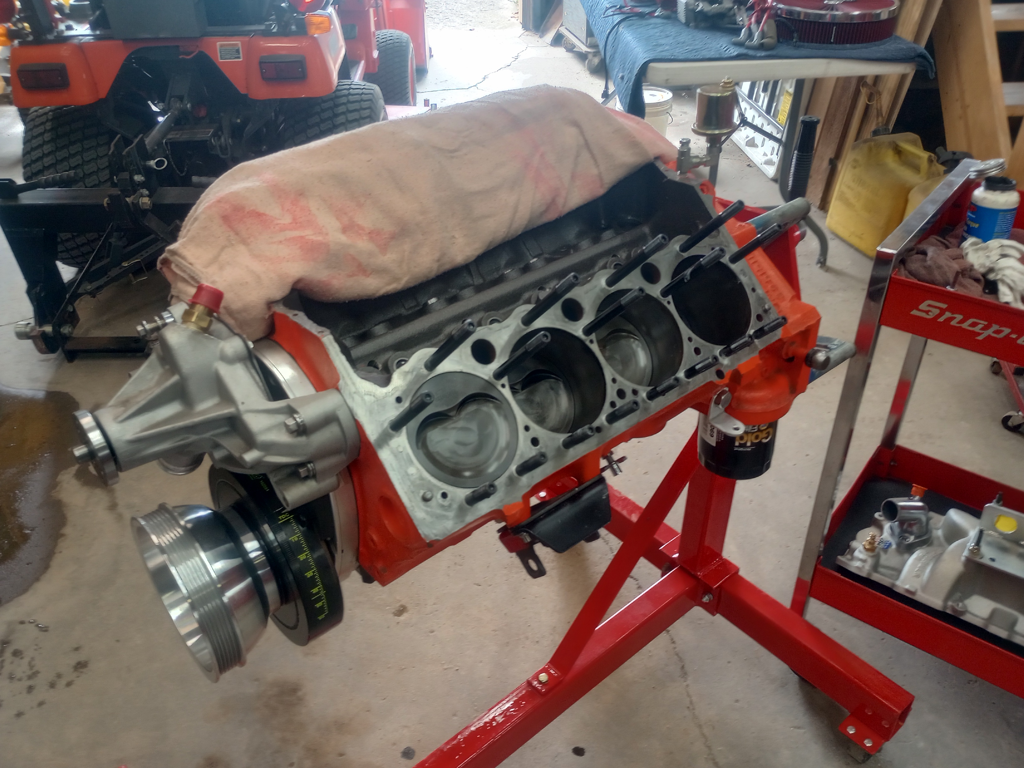

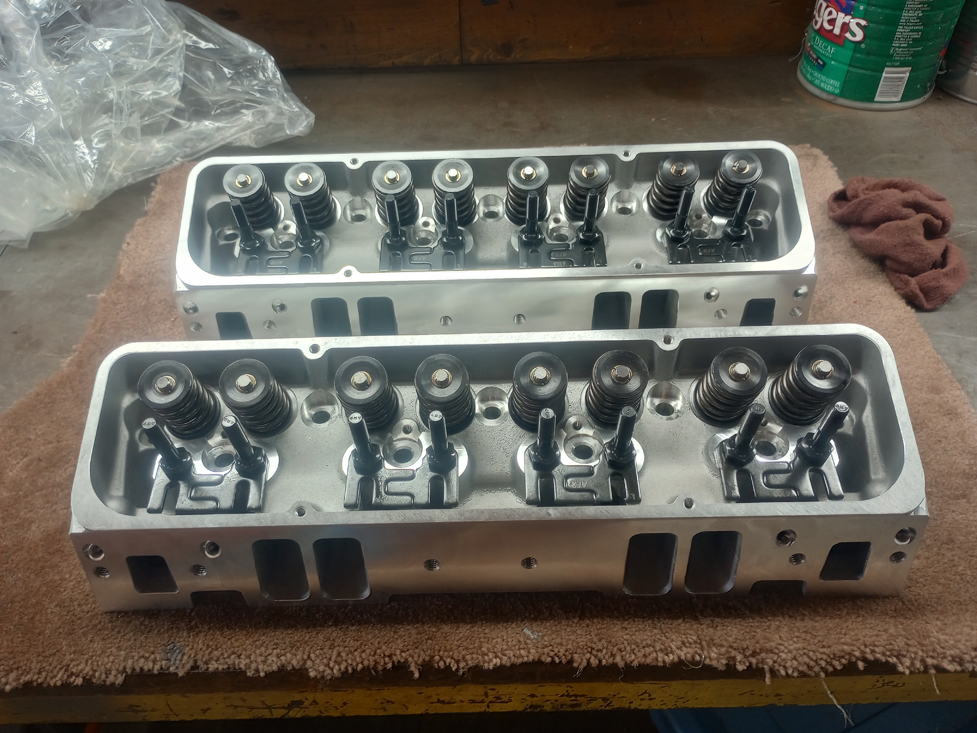

UPS dropped the heads and gaskets off today, so I got started putting it back together. The AFR heads are really nice pieces of equipment, and although they are an as-cast head, the unmachined cast surfaces are pretty smooth. The water passage that was the problem on the Procomp heads is properly located, but I forgot to get a picture of them.
I applied sealant to the head studs and installed them in the block. This is messy, as some of the sealant always ends up on the block deck, and it's a pain to get it all wiped off. Sliding the head gasket down over the studs is a fiddly process, but you can't really put it on first because of the thread sealant mess. The heads slid part way down, as is usual when using studs, but some gentle work with a dead blow hammer got them seated all the way down.
The stud's threads and nuts have to have a coating of ARP lube, which is a bigger mess than the sealant, just as bad as never seize, but black.
After snugging them up, I torqued the nuts to 30 ft lbs, 50 ft lbs and final torque of 70 ft lbs.
I still have to align the pushrod guide plates and torque the rocker studs, but at least the heads are back on.
One other thing different on these heads that the plugs are set in the head at an angle, leaning them away from the header pipes, which will help keep from burning plug boots.

View attachment 941792View attachment 941797View attachment 941802View attachment 941806View attachment 941812View attachment 941816

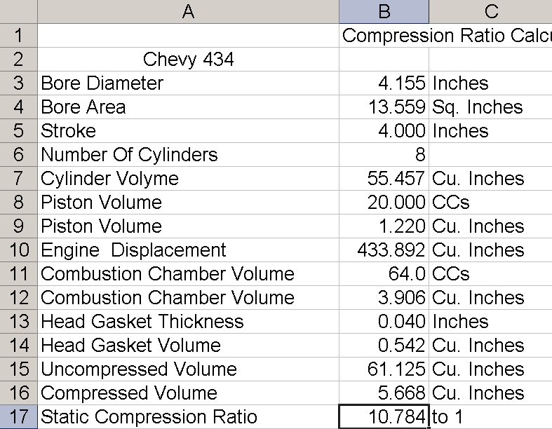

Curious if you cc'd the piston dish(es) and combustion chamber(s)?
That w/ crushed head gasket what will the static compression be?

Yes, when I assembled the engine I calculated the static compression ration, taking all those things into account.
Attached is the spreadsheet I used to calculate it.
The static CR is 10.784:1, dynamic CR is 8.08:1.
I also degreed the cam when I installed it. I set it straight up, neither advanced or retarded.
The cam is a Comp Cams Nostalgia 30-30H, a hydraulic grind equivalent of the old 30-30 cams used in 327 350HP engines, and also maybe in the Z-28 302 engine. It's actually a pretty mild cam with only .483" intake and .477" exhaust lift, with 239° and 246° durations at .050" lift and 112° lobe separation.

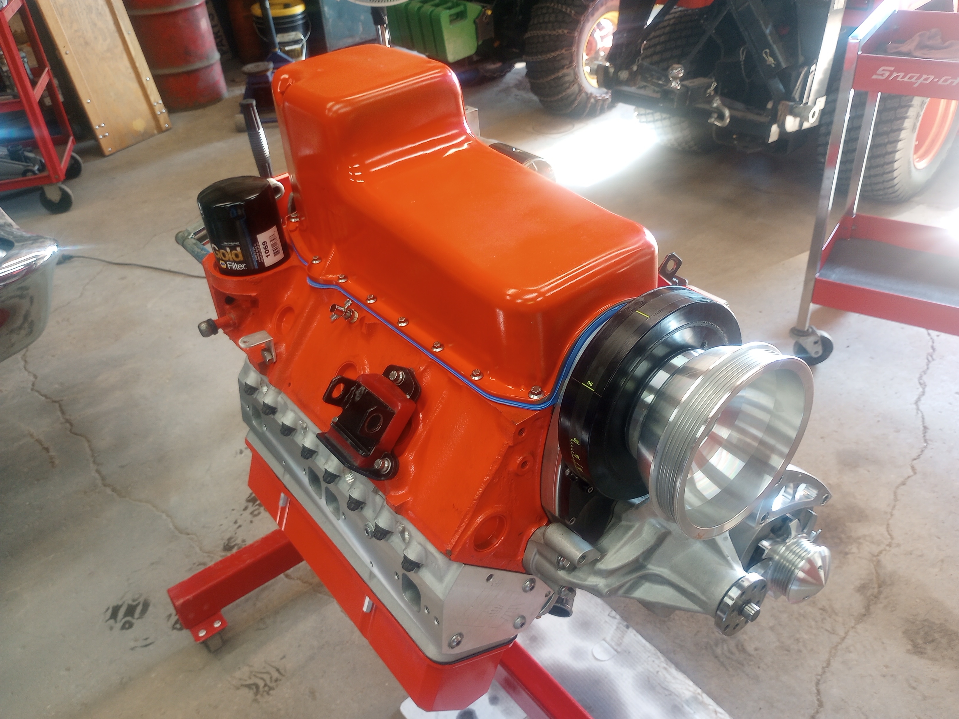

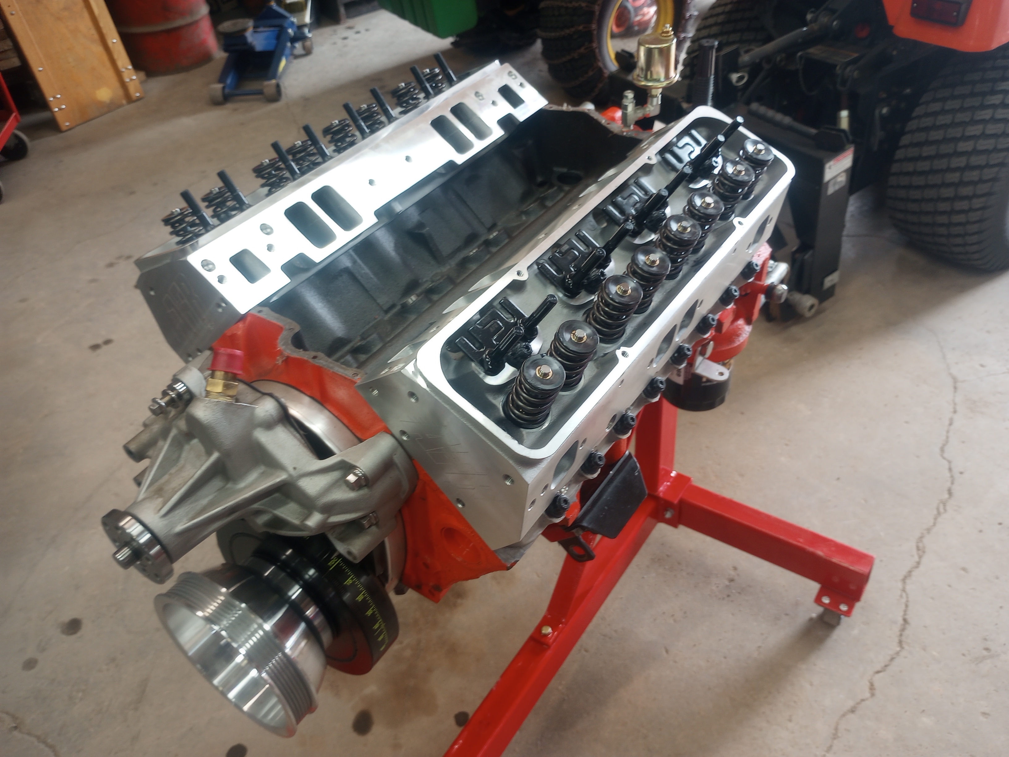

I got the pushrod guide plates aligned and torqued down this afternoon. Then I installed all the pushrods and tocker arms and set the lash/preload on the valves.
I installed the intake manifold and gaskets and for the first time, I used a bead of RTV on the China Walls or ends of block, instead of using the cork of rubber gaskets. A 1/4" tall bead laid out seems to have worked well, with some being squeezed out, so it should seal just fine.
I installed the 1/4" studs I use in the heads for the valve covers, as it makes installing the gaskets and covers a lot easier, and installed the valve coders.
The I rolled the engine over and wiped the pan rail down and put a dab of sealant in the corners where the rear main and timing cover seal, laid the pan gasket on it and set the pan in position. The Fel-Pro 1880 gasket is a blue silicone gasket with a steel core and inserts to prevent over torquing the gasket, and it works really well.
Lastly, I filled it with oil and used the oil pump priming shaft and drill to prime the oil system.
Tomorrow, I'll get the flywheel, clutch, bellhousing and transmission installed and it will ready to get back into the car. Again.

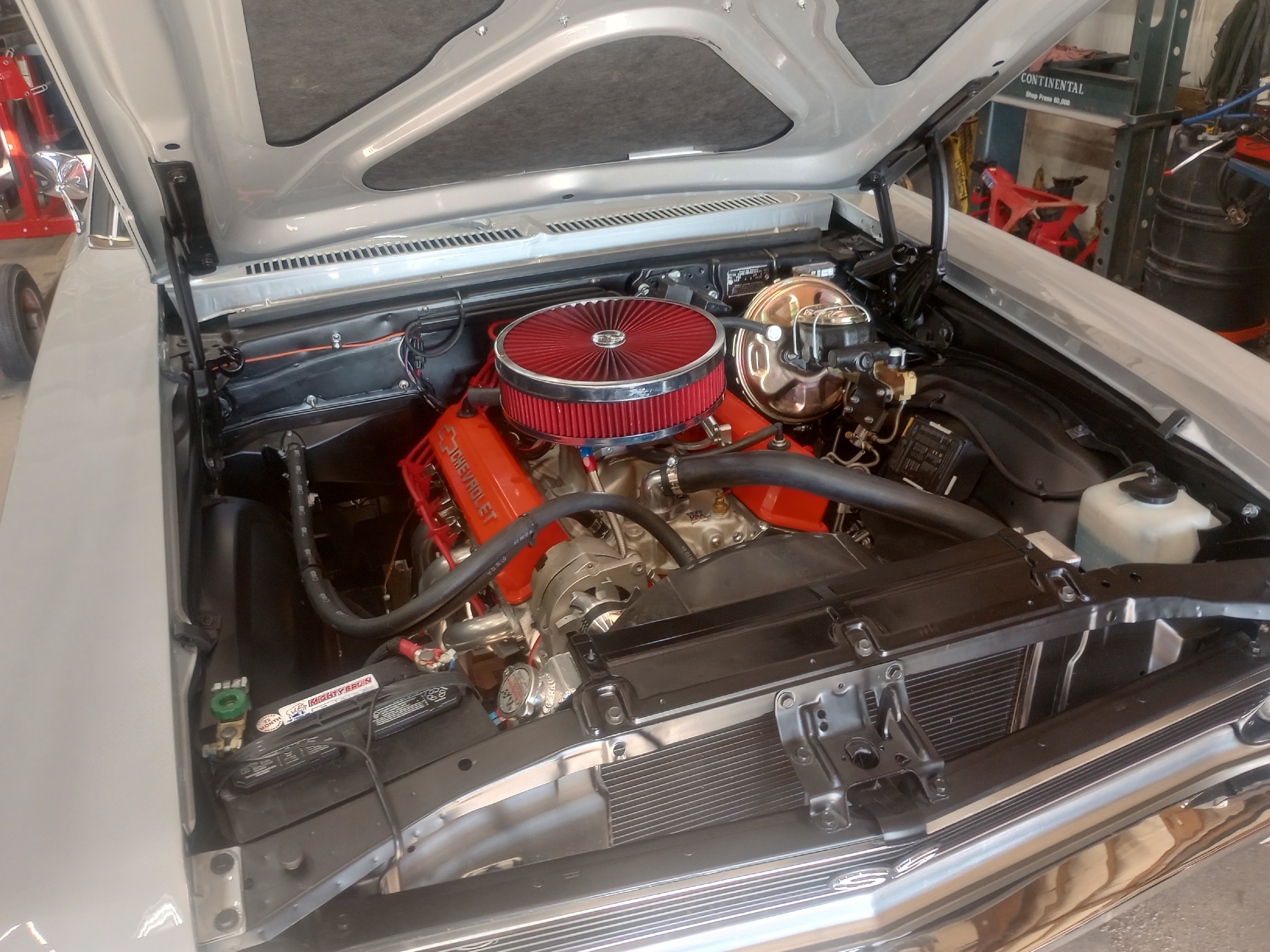

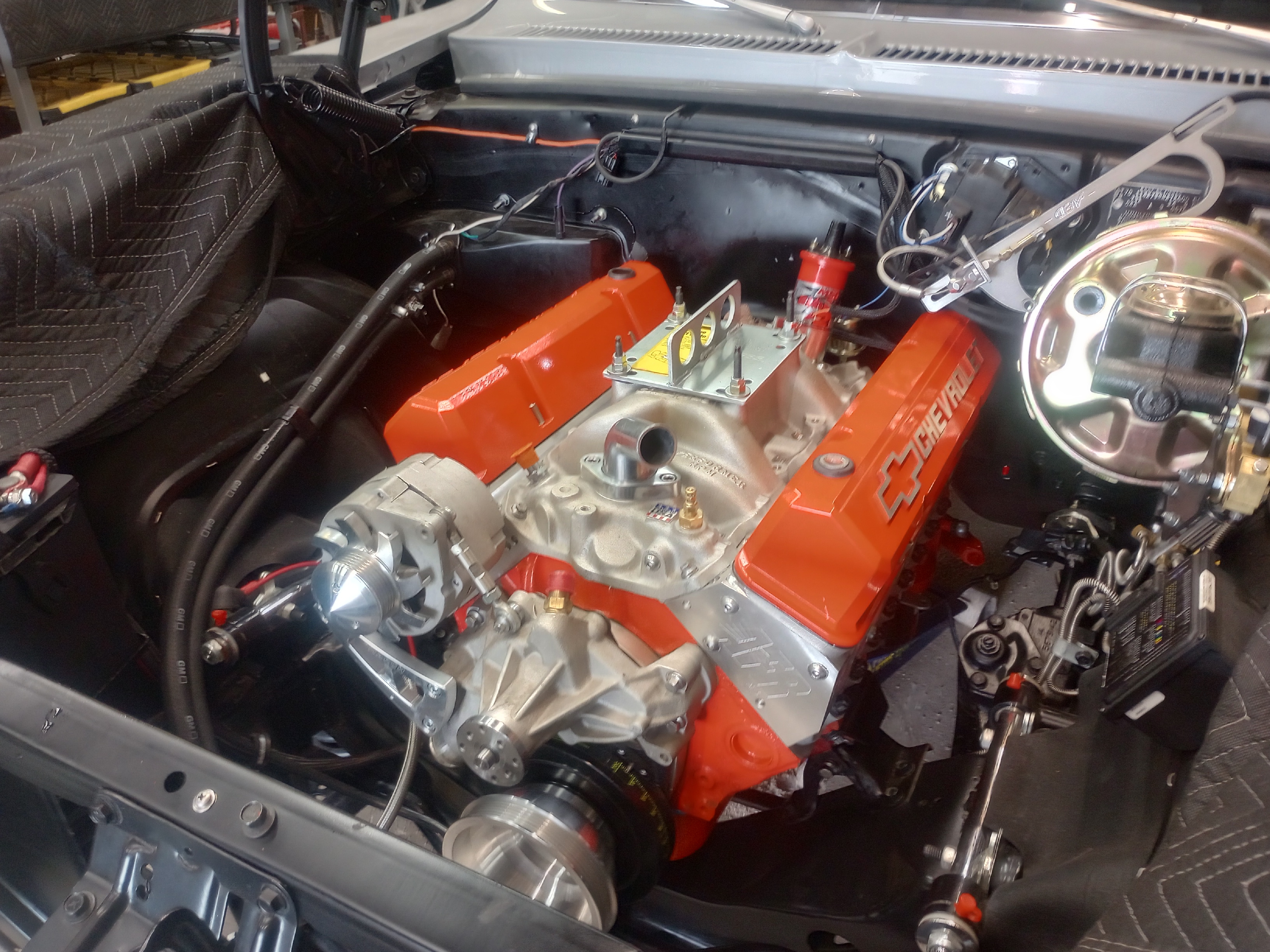

Well, it's back in the car, again.
Put the flywheel, clutch, bellhousing and transmission on this afternoon. Got it rigged up on the cherry picker with a ratchet strap to get the angle right when I lowered it back into the car. It went in without a hitch, and got the trans mount in and bolted up and the motor mount bolts in and tightened up.
I also put the distributor in and hooked up the coil and oil pressure wires, after spending a while searching for the nut for the oil pressure sender that I managed to drop into the black hole that resides somewhere at the back of the engine. I ended up getting a new one and using it. The old one will undoubtedly get regurgitated as soon as I start the engine, and will be staring up at me when I move the car.
That was it for today, it was really hot and humid and I don't function well when sweating profusely.
It's supposed to be a lot cooler and less humid tomorrow, so hopefully I can get it wrapped up and ready for the road.

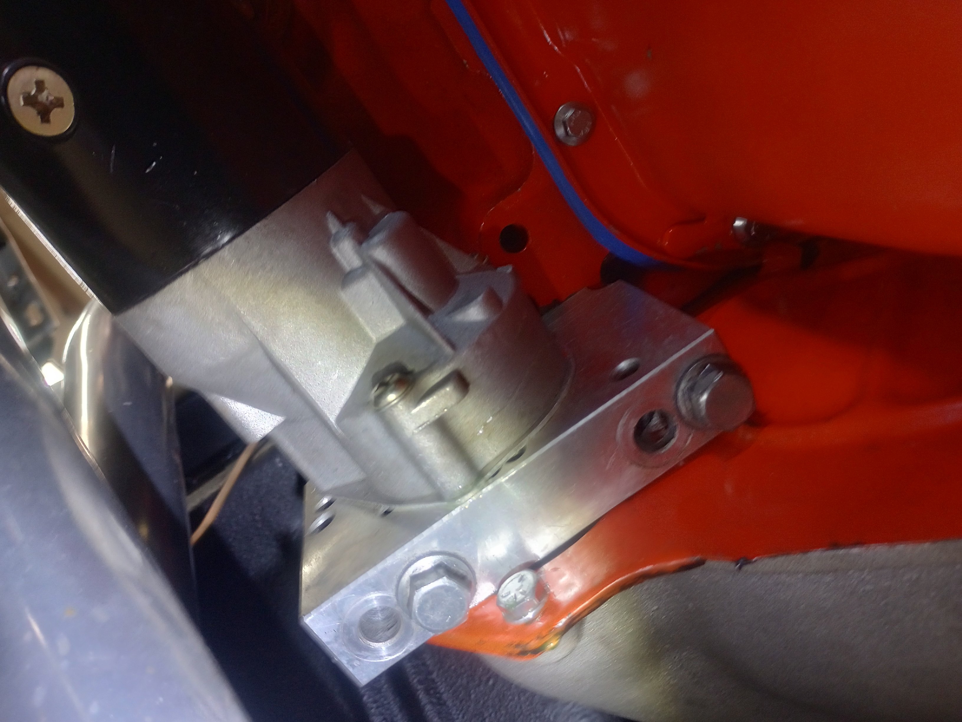

So, Saturday I worked all afternoon getting everything reassembled and reconnected on the car. Filled the cooling system, everything looked good. When I started it, the loud scraping noise let me know I didn't get the flywheel cover positioned correctly and it was rubbing the crank flange.
Well, horse hockey! I was beat, so I decided to fix that on Sunday.
Of course, to get one of the four bolts that hold the cover in place, you have to remove the oil filter. Messy job, but got it done. Started it up, no more noise, so I let it run for 10 minutes or so and shut it down. That's when I noticed coolant still dripping from the starter area. I used some of my most vile language to describe my displeasure with the leak still being there. Went back up to the house and sulked for a while.
Went back down on Monday, started it back up and let it warm up to operating temp, and the leak nearly stopped.
