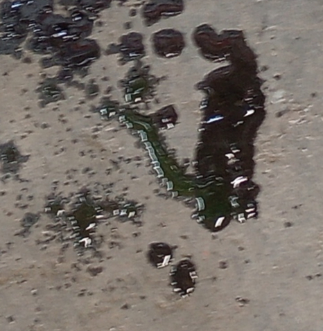

Are you sure it’s oil? I zoomed in on your picture and it looks awfully black. It’s probably just the picture.
   / Restarting My '70 Nova Project #623
oil over concrete makes it look black ... on the one splash you can tell its actually brand new oil
#625

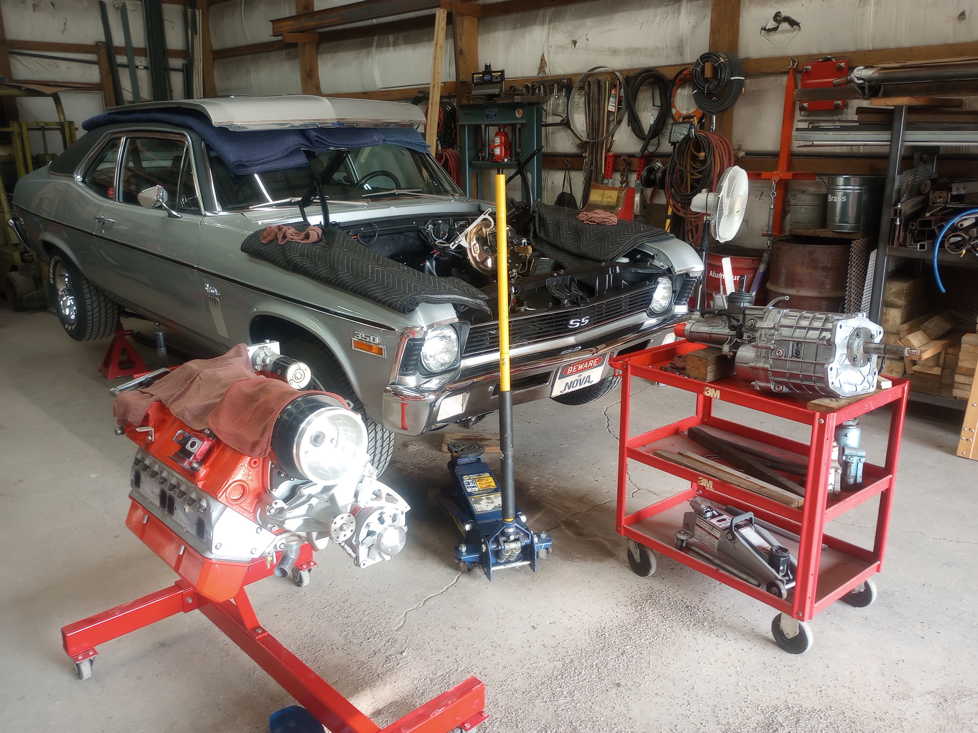

Yeah, it was definitely oil under the center of the engine. Water was dripping off the starter on the right side.

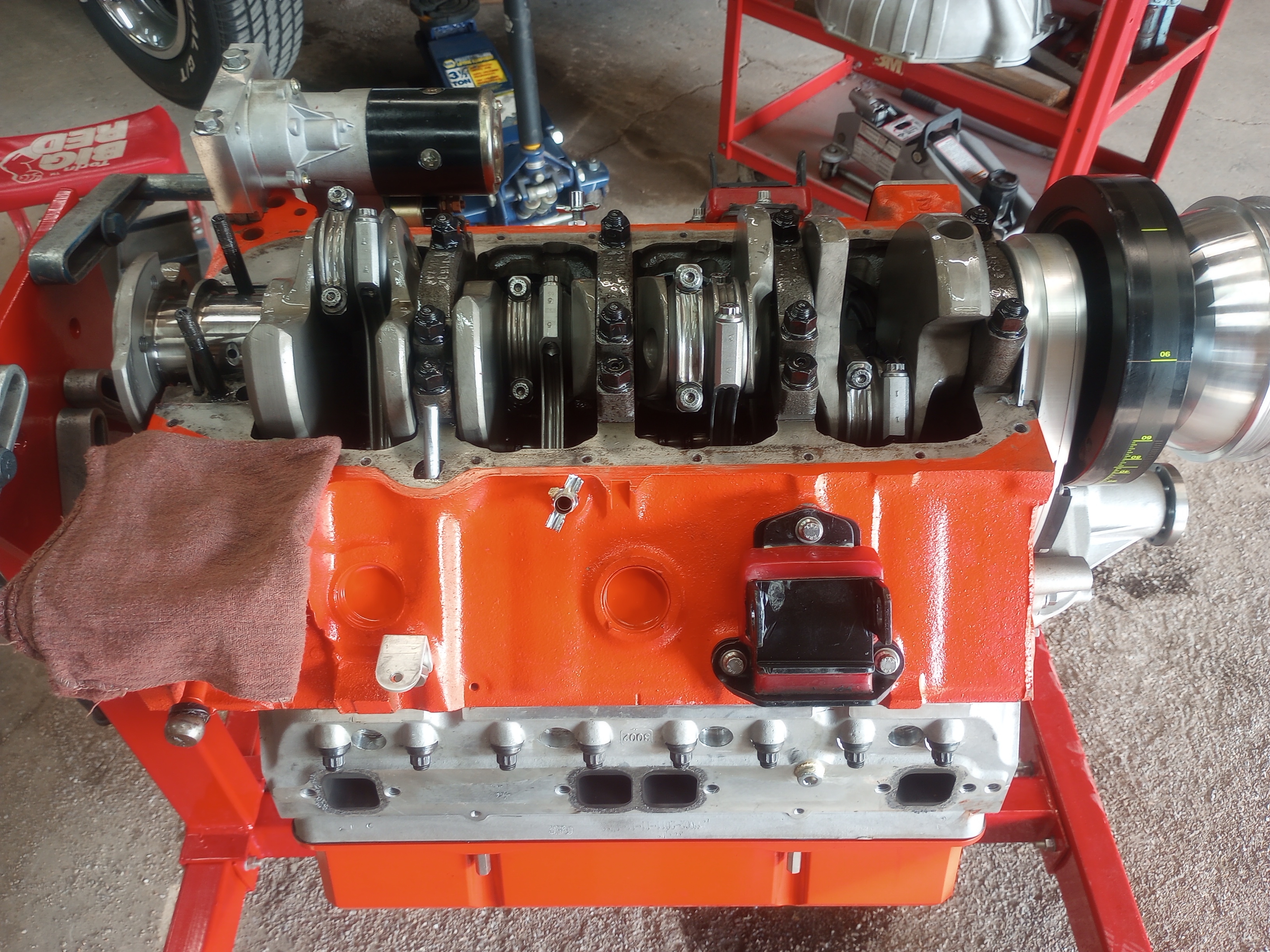

#626

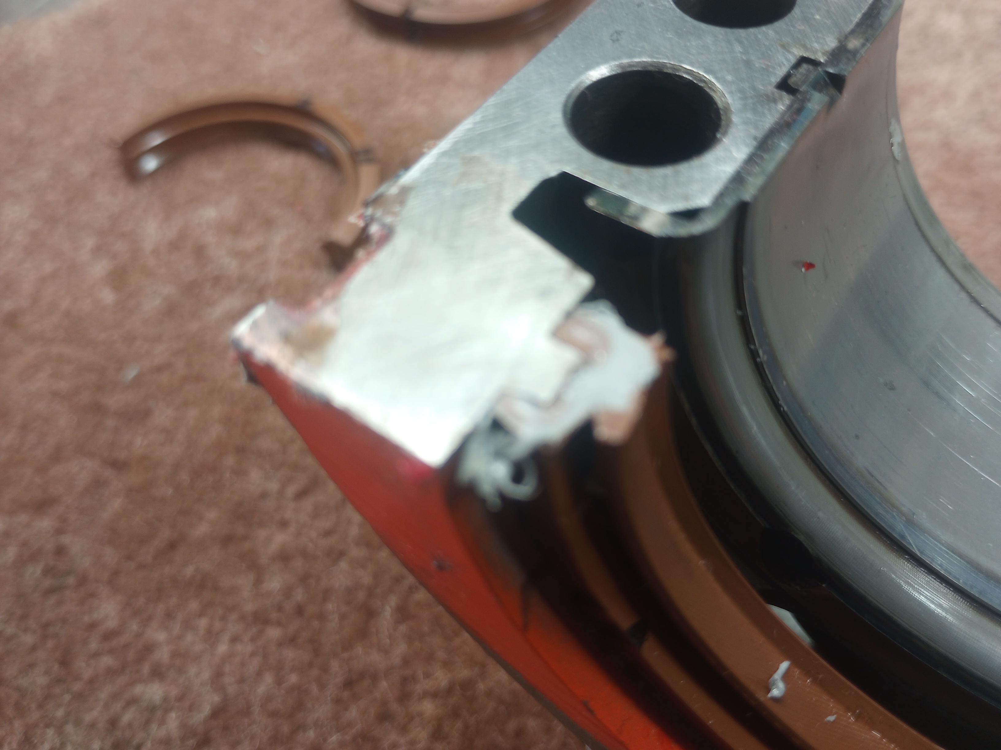

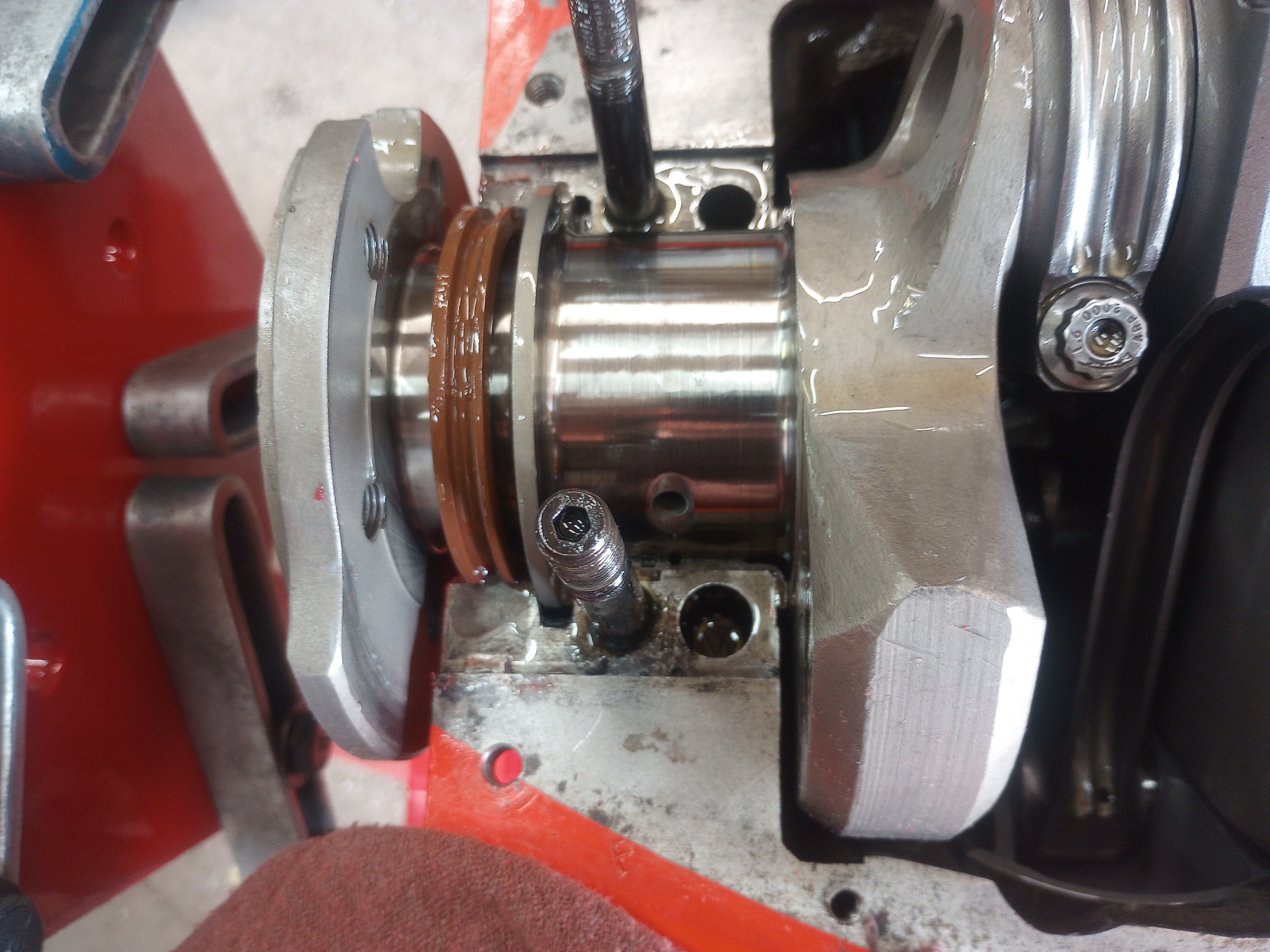

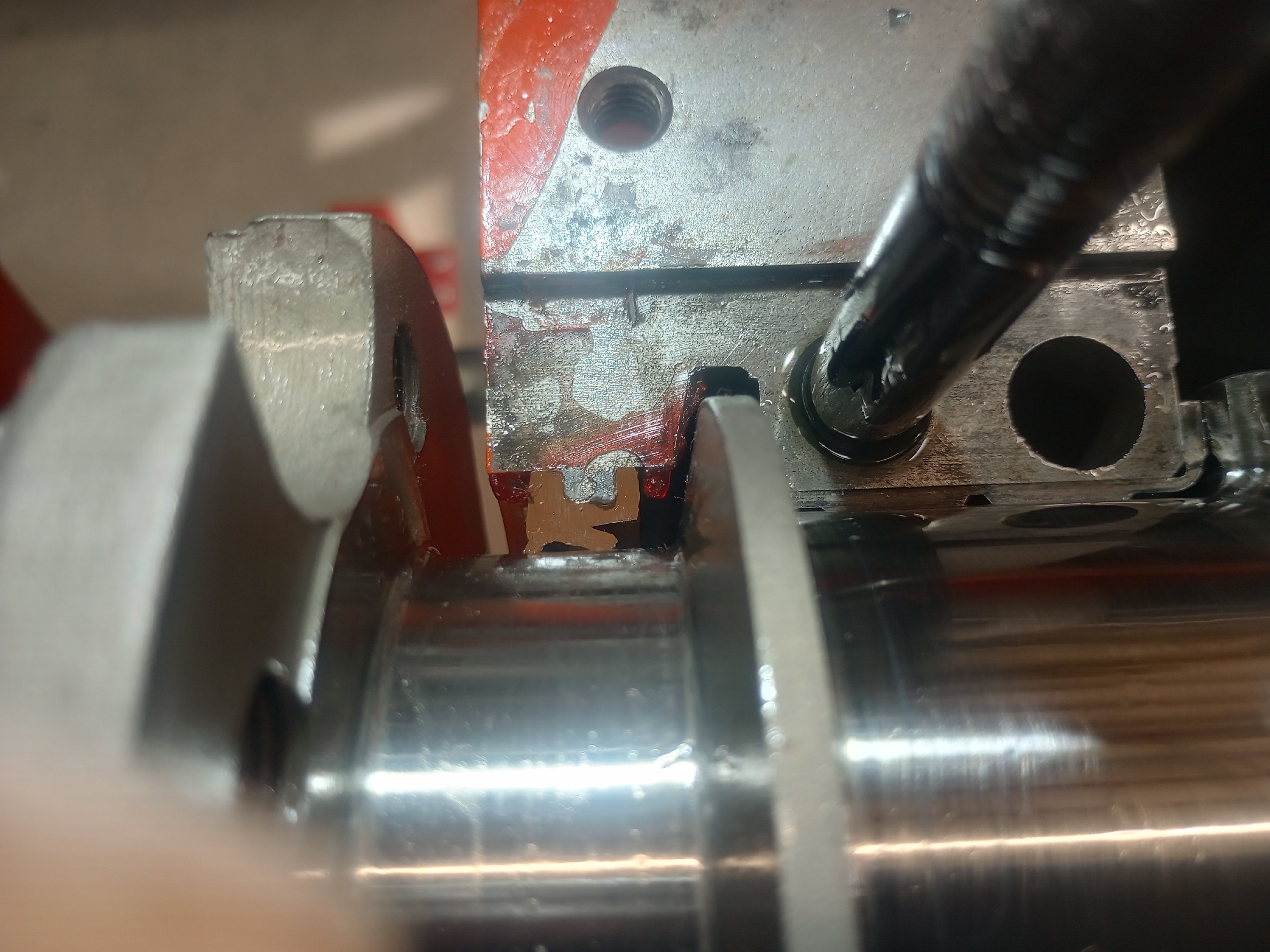

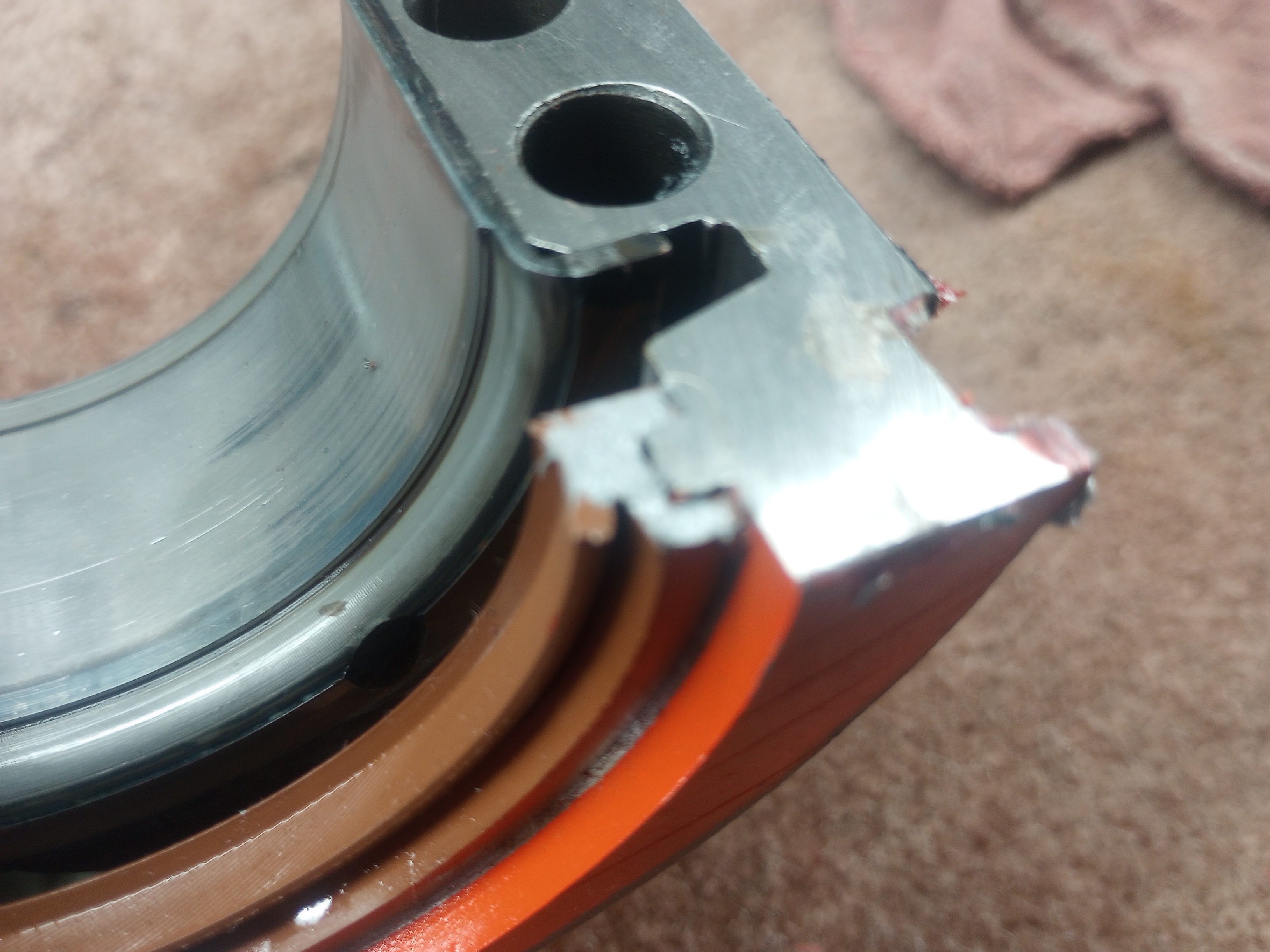

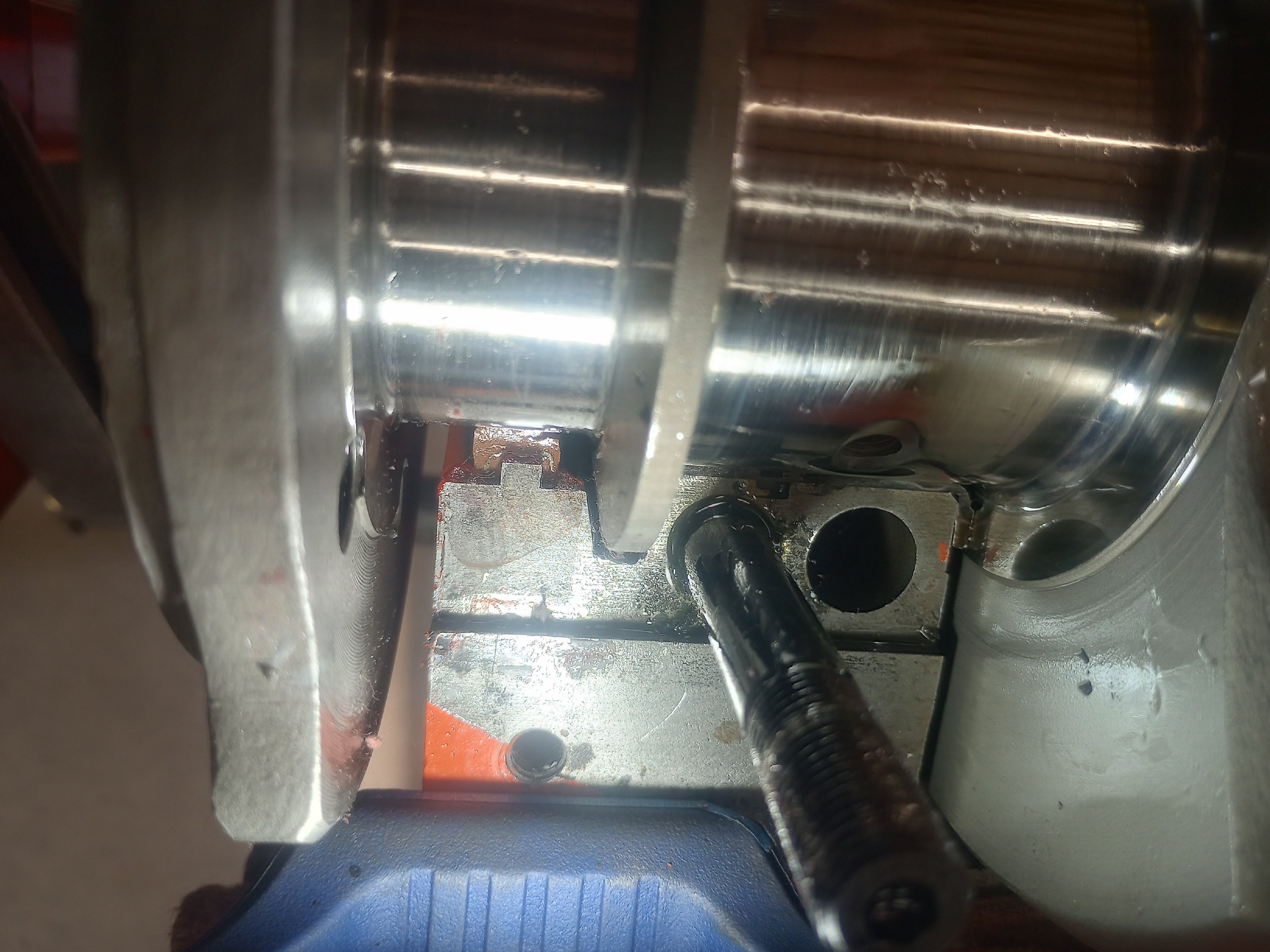

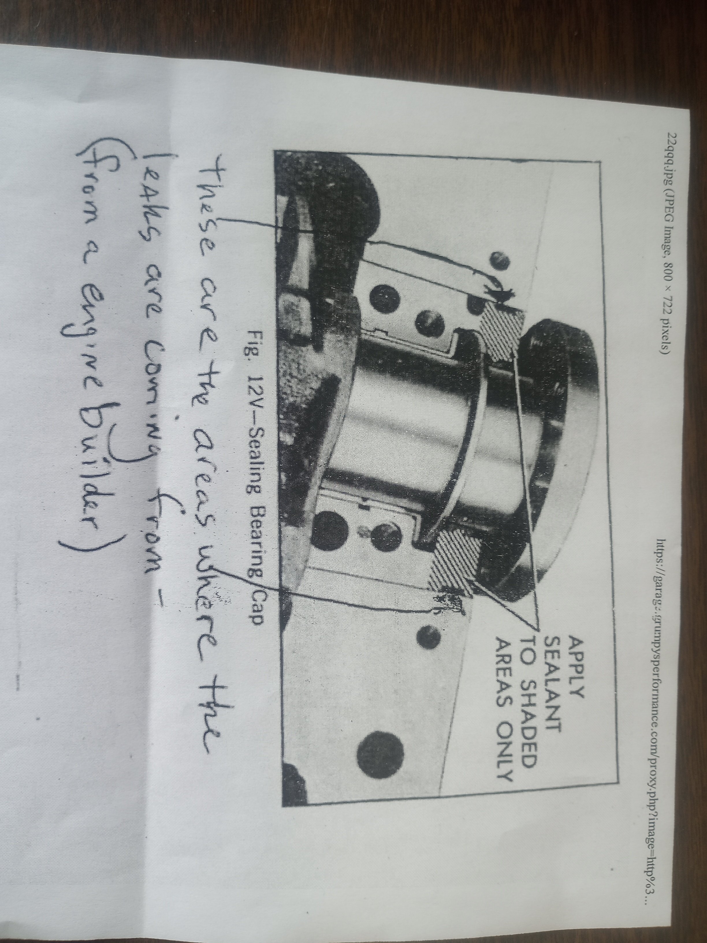

Okay, so I have it out, on the engine stand and the pan removed. Pulled the oil pan, oil pump and rear main cap. The sealant I applied at the rear of the cap was definitely sealing that area, and was adhering very well. The bottom half of the seal stayed on the crank as one end was clocked into the bore of the block about half an inch, but came out easily. Used a pocket screw driver to push out the upper half and took them to the bench to examine them. They looked okay, but there was no gray sealant on the ends of the upper seal, but there was on the lower half, which is where I applied it when I assembled it. So, as I surmised, the seal's O.D. was too small, and when assembled, the ends weren't in contact, leaving a gap for oil to leak out of. Makes perfect sense now.
Just to prove it to myself and you guys, The pictures show the seal halves installed in the cap and block with one end flush with the mating surface, and the other ends up about 1/16" recessed in the cap or block. There's the problem, clear as can be.

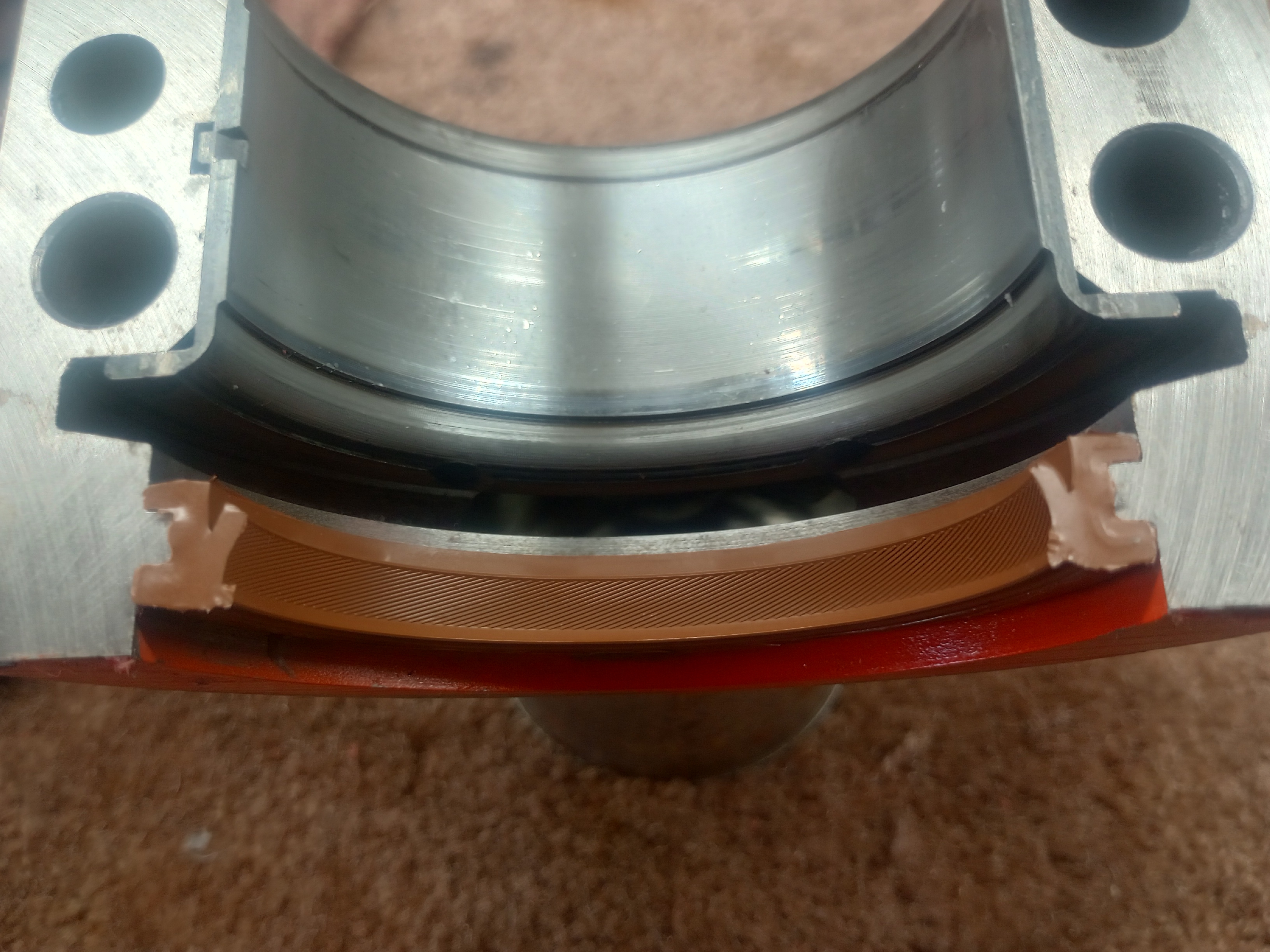

Got the new seal and gaskets today, and as the picture shows, the new seal will have overlap and won't have a gap at the ends. I thoroughly cleaned the seal bore, coated the journal with some oil and rolled the top half into place, then applied the anaerobic sealer to the block mating surface as recommended, put the other half of the seal in place, installed the bearing cap,seated it, set the end play, and torqued the studs to 70 ft lbs. So, that should end that problem for good.
