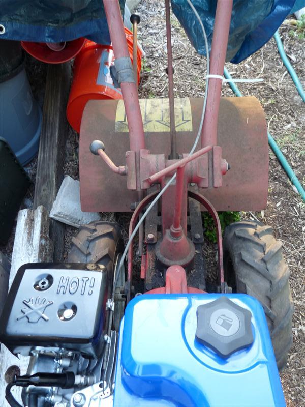

OK, here are a few pictures. The first is with the exhaust cover removed to show the two straps. (You need to remove the air cleaner to get to the 2 screws in the front of the exhaust cover.) The 2 straps should go as low as possible on the side of the cover.
The second picture shows the finished cover re-installed and the cable end stuck into the trottle arm.
The third picture shows the excess cable draped over to the opposite handle bar and tie-wrapped to take up the extra slack.
I should also mention that you do need to pay attention to where the arm is set in relation to where the throttle lever on the handle is set before tightening the cable straps. Keep in mind that it will opperate exactly the opposite of the original. Idle is going to be where Fast used to be and vise-versa.
Later I realized there was an easier way to do this without removing air cleaner or the exhaust cover. All you need do is just remove the two nuts that attach the entire exhaust to the engine. Simple fix!

Any chance you could post a couple pics of the whole tiller with the new engine to see how it looks? How does it look and handle to you?
/ Replcement Engine for Troy-Built Horse #65
I could but it's not much to look at, it's just the raw engine sticking out like the old one. It's an old workhorse covered with oil and dirt. The blue engine doesn't match the red tiller but I wasn't about to spend the extra 200 bucks to get red Honda just so it would look good. I'm a pragmatist, my only concern is how it works, I could not care less what it looks like.
The biggest difference is that new engine is probably 20 pounds lighter than the old one so in tough soil you would need to add some weight, otherwise it handles fine. The second biggest difference is that the old engine was a major pain in the *** to start, to the point where my arm would be sore. So far this one starts first pull every time without fail.
