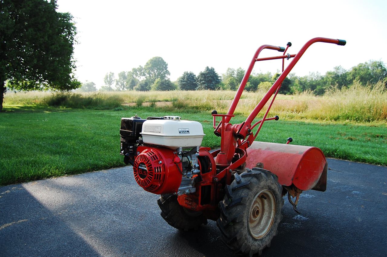

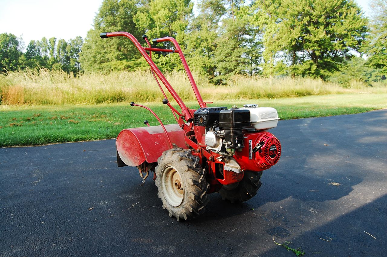

here are a couple of photos . in the first photo you can see the disconnected low oil cut off wire with the orange electric tape .
MrTooth,
Just curious.... is that unit an older one such as mine.... c. 1978? (orig. 7 horse Kohler)
Tnx..RUT
/ Replcement Engine for Troy-Built Horse #24
MrTooth,
Tnx..RUT
i believe it's from the mid 1980's but i am not sure . the original motor was a hh-60 tecumseh if that helps date the tiller . i believe it's considered a 4 speed with forward , reverse , high , and low . hope this helps.
