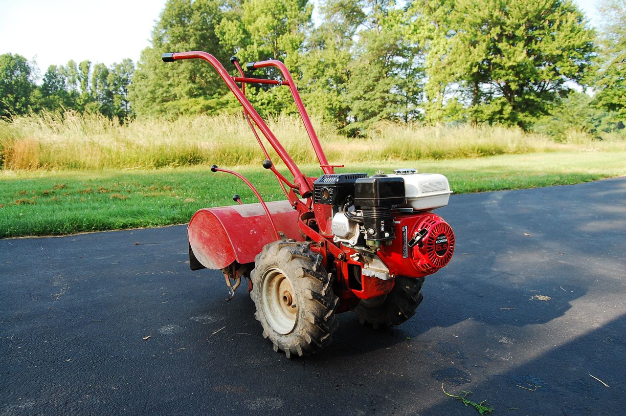

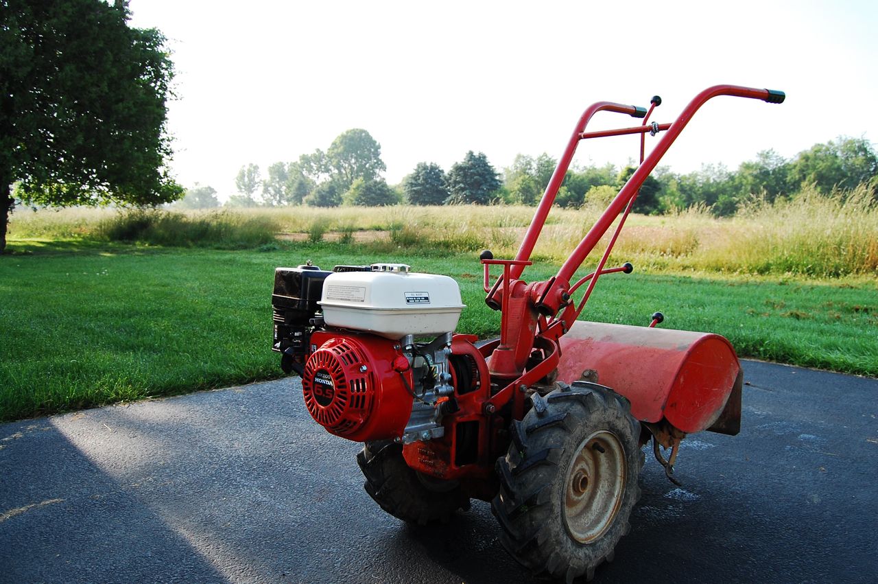

/ Replcement Engine for Troy-Built Horse #16
i just recently put a honda motor on my troy bilt horse . i bought it from small engine warehouse . It's a gx200 6.5 horse i did have to disconnect the low oil shut off , but that was as easy as unplugging the wire .
it made the tiller quite a bit liter and easier to handle . i spent about $300.00 but it's like a brand new tiller .

i went with the pull start . i looked at the chinese knock off motors and at some of the smaller briggs motors , but felt the honda was the best value ( plus i heard the motor run on my buddies pressure washer ) . i will say i was disappointed that the motor is made in Taiwan . i actually called Honda about it just to confirm i didn't get ripped off . they told me that most of the smaller motors are now assembled in Tawain .
also the Honda motors have a 3 year warranty . i believe it produces 9 ft lbs . of torque . i am very happy with it so far .

here are a couple of photos . in the first photo you can see the disconnected low oil cut off wire with the orange electric tape .
