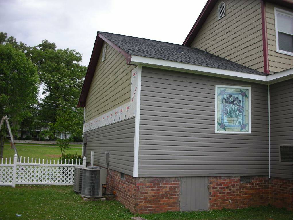

Hello everyone. I've been following several threads here for quite a while now. I've really enjoyed Obed and PClausen's threads dealing with home building. I've noticed the community here has been great to offer useful suggestions and years of knowledge. I do not have near as interesting of a project as those guys, but I still need the community's help. I have searched through several contractors and finally found a well known and trusted one. The guy has been in business over 40 years and is the most preferred by several general contractors and other tradesmen in the area. What a process that was! He will be starting tomorrow replacing 24 windows and installing Mitten vinyl siding over the entire house, new gutters, and shutters. There will also be various other additions such as new lights, railing, and landscape lighting. Here is a little background and project scope. We bought the 2500 square feet house over a year ago in foreclosure knowing this was going to be something we would deal with. My wife and I went into this home knowing we wanted to upgrade and add our own touch. Currently we have old wood windows and Masonite siding. We enclosed all but three of the sun room windows on the back of the house as it was poorly constructed and in serious need of repair. We also had to rebuild the chimney and replace the roof and several sheets of decking. I had a local roofing company replace the tired old 3 tab shingles with GAF HD shingles 3 months ago. I plan on posting several current pictures as well as documenting the process over the next week or more. I'll be asking for everyone's opinion on what is going on and any potential problems anyone may see. In short, pictures, pictures, pictures! With that said, to the pictures we go!
Here is the home before enclosing the sun room and replacing the roof.
With new roof installed.
With sun room enclosed and chimney rebuilt. The three middle windows will be have new construction windows installed.
A new chimney topper will be installed as well.
A few various close up shots.
For the record, I wasn't the lazy bum who put a vent in the crawlspace vent.
Now to the absolute UGLY!
If I did not have to clean it up, I'd throw a framing hammer through this thing. This window will be enclosed. It is part of my next project to remodel the master bath.
All advice is highly appreciated! I will post photos of tomorrow's progress and check in frequently to answer any questions and gain knowledge! Thanks in advance!

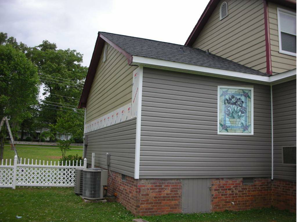

I couldn't resist after how lovingly you spoke of that window! :) DSCN3110_zps9e0caf7a.jpg
/ Replacement windows and siding begin
I couldn't resist after how lovingly you spoke of that window! :)View attachment 315995
Haha! I'm so glad that thing is gone. When you look at listings and see a stain glass window you expect something other than that! One of the workers said he would take it if I didn't want it. To say I was glad to see it go is a huge understatement!
