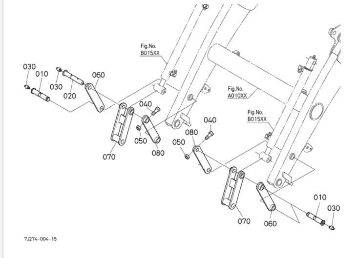

My 2000 hr L4740 has seen some pretty heavy use and the bucket has a fair amount of slop
6 replacement links will cost me about $600
Has anyone out there repaired them?
060, 070, and 080 in the drawing
/ Repair vs replace bucket links #2
pins that connect those parts must be worn too? # 10 & 20
/ Repair vs replace bucket links #4
If you have your own machine shop and work after hours your time is "free". If you have to hire a machine shop to repair then $600 is probably cheaper and faster to buy replacements from K.

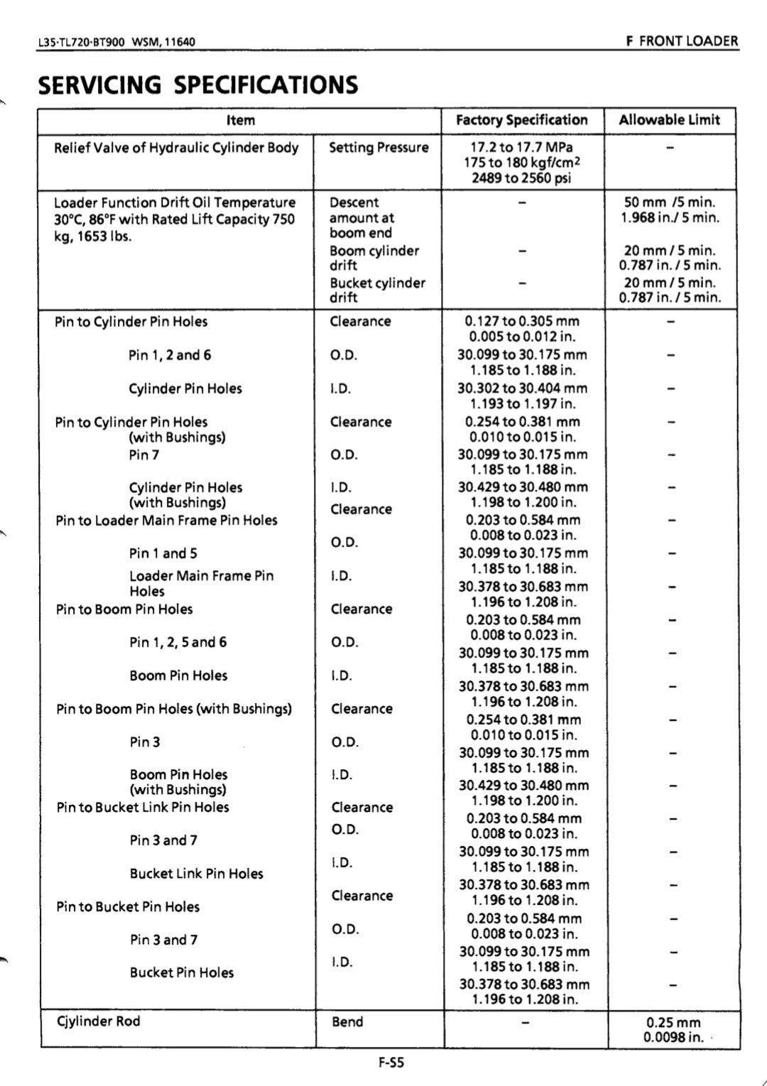

I've got the same issue. I replaced the 6 lowest pins on the FEL with no improvement. I bought the 6 link pieces and swapped them in a few weeks ago with no improvement, either. With everything apart it is easier to see that there is significant slop around the bucket curl rod eye, which has a $160 bushing that I have not replaced, yet. There is also significant slop at the barrel end eye that does not have a bushing.
My next step is to remove the rod eye and barrel pins and measure the dimensions to see if they line up with the specs from this (incorrect) table. The table is from an L35, but the dimensions are similar/identical to the LA854, and the LA854/L4740 WSMs do not have a similar table available.
From the preliminary measurements I've taken so far the LA854 appear to be within tolerance, a tolerance that seems to be quite loose... 🤷‍♂️

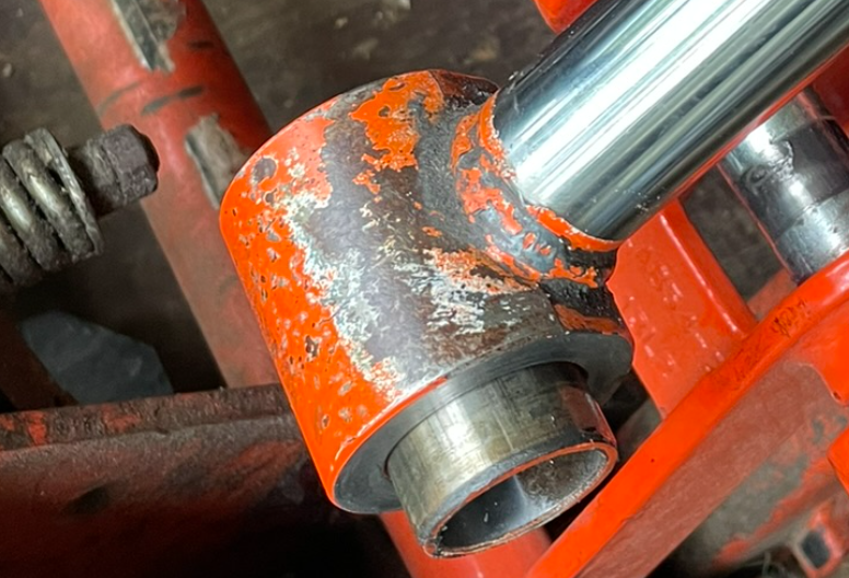

7J275-64510, NLA from Messicks but Coleman has 2-5 day lead time. Note that it says it is for an LA844, so no guarantee it will fit properly.
Yes, it should be fancy, alas it will likely just be a soft sleeve. I do plan to press one of mine out to confirm ID and OD, in case some handy person would be inclined to turn me one or two from a 660 rod/tube. Or, if we're really lucky one can be found at McMaster.
This also doesn't address the play at the bucket cylinder tube end, however.

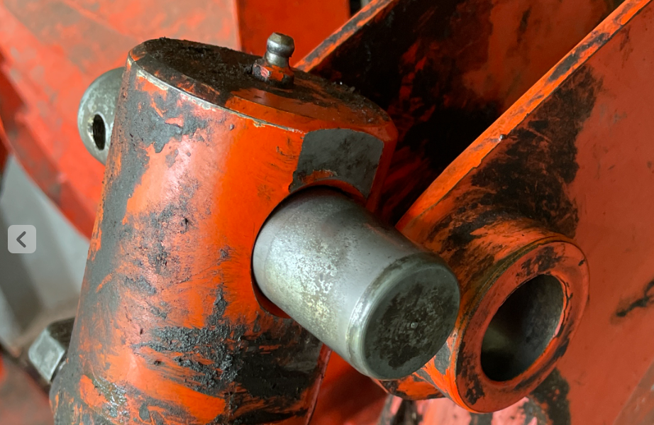

OK, confirmed some measurements:
OD of bushing is 1.500 +/-0.003"
OD of a new pin 7 for this link is 1.185"
ID of rod eye is 1.497"
I fumbled around with this set to get the bushing pushed out about 1/2" to measure it and the rod eye: Powerbuilt Ball and U Joint Service Set, 23 Piece. The bushing would jump about every 1/2 turn of the wrench, so it was in there good.
As of right now I'm looking at getting 13" of this and shipping it to my brother with a lathe. OD will need to be turned down and the ID will need to be increased to an appropriate dimension, likely 1.190 to 1.195". If all goes well, we should be able to generate 4 bushings at 2.20-2.25" each, with material left over.
In other news, as noted previously, the cylinder barrel pin also has some play, note the pin does not rotate in the weldments as it is bolted on the far side.
