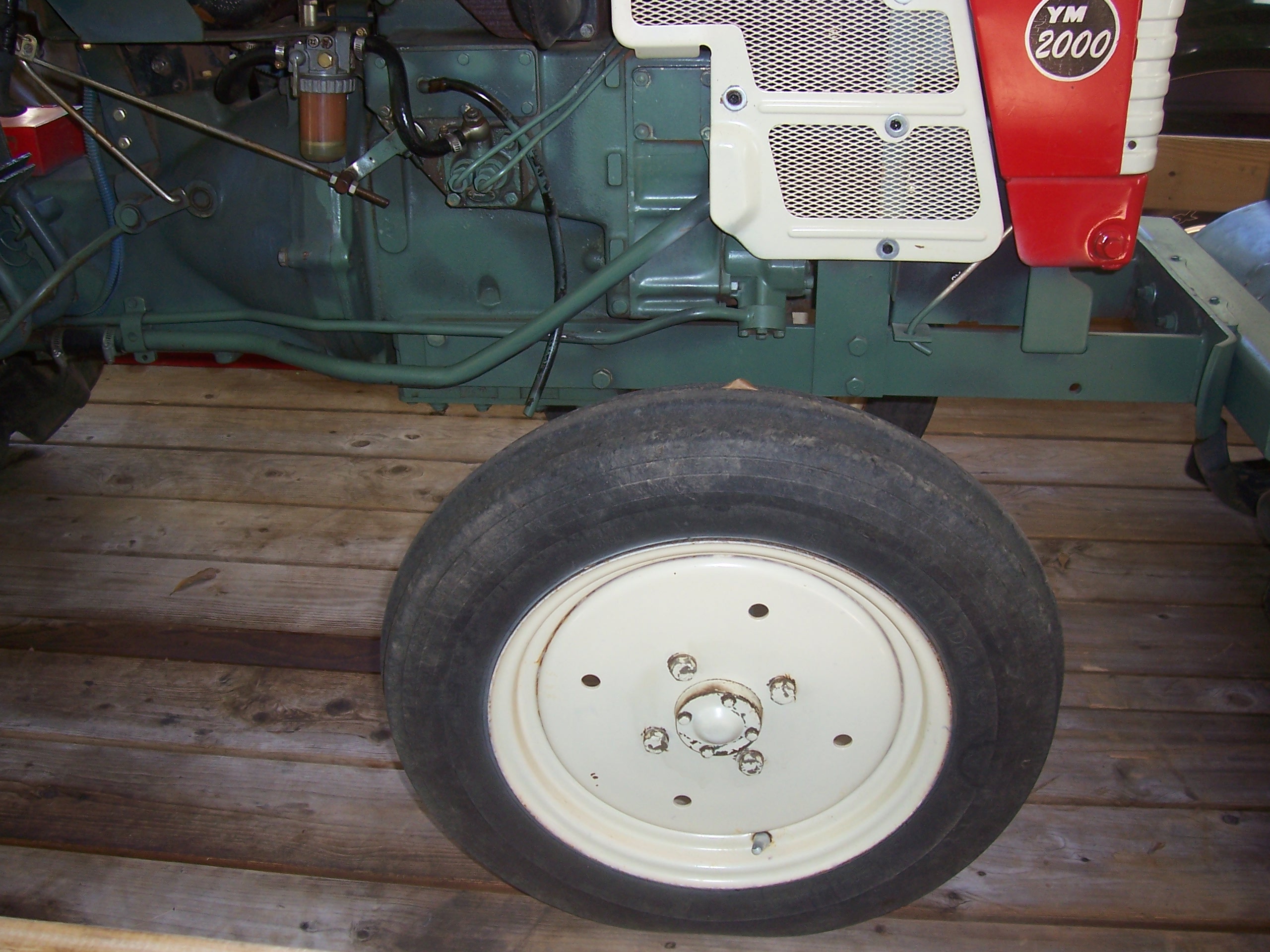

I got the Wheels finished, started trimming in the motor and insides of various parts. I'm Painting the Frame black, I want to be able to touch up with a black spray can if I get any bumps or bruises. Also to make look newer like the USA model yanmars.
/ Repaint YM2000 #32
Now this is a guy serious about a paint job. Looking good! :thumbsup:
/ Repaint YM2000 #33
What color ist he frame/motor going to be? I see that you painted the motor black and frame the yanmar green. Are you going to keep this arrangement or say with one generl color?:confused: Those rims look brand new, so do the tires. Great job! :thumbsup:

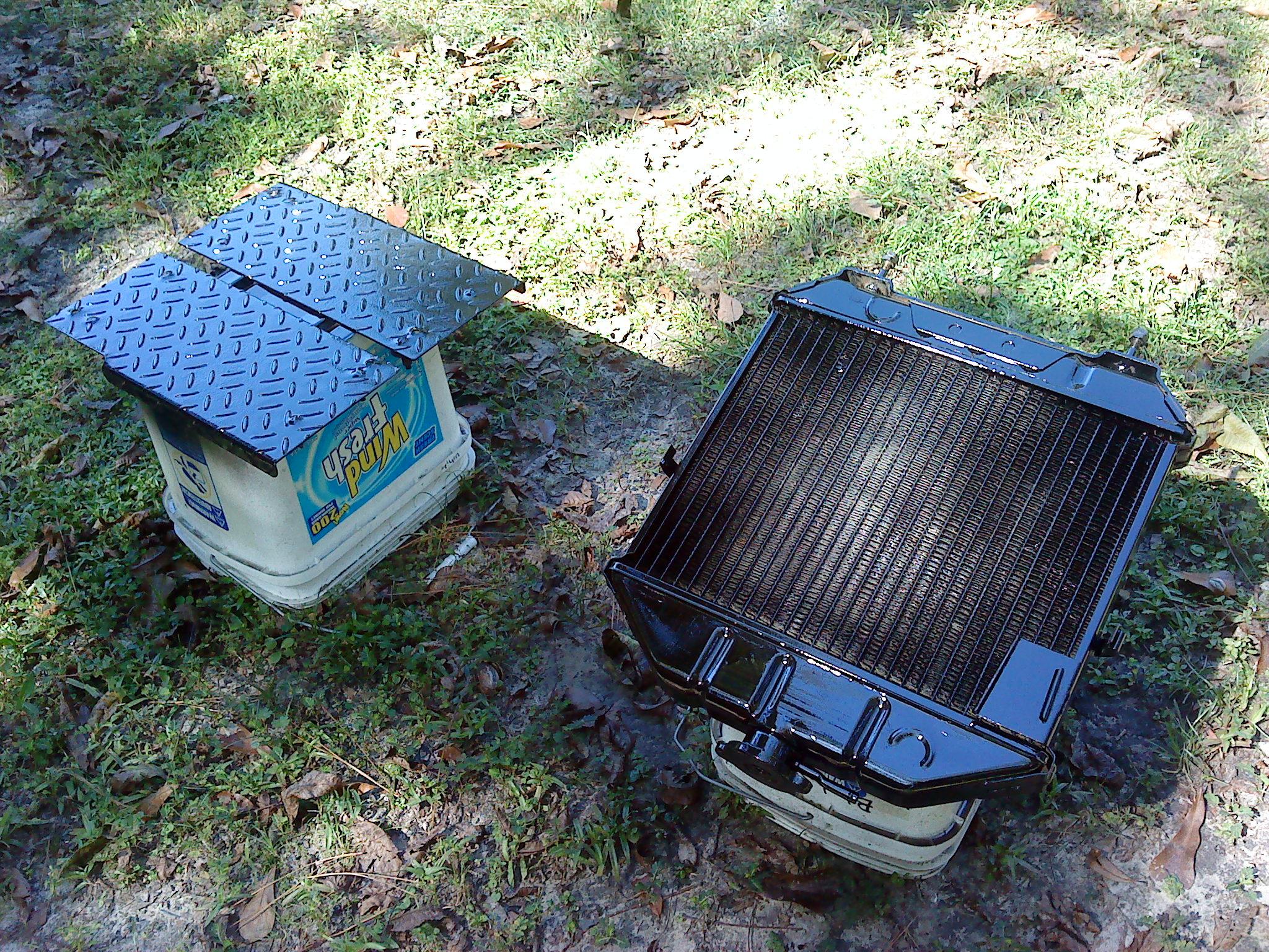

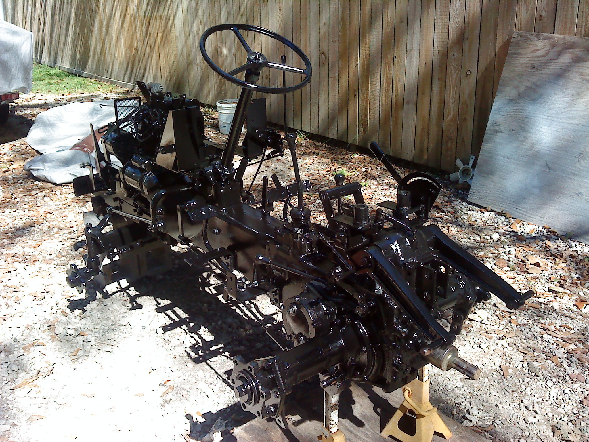

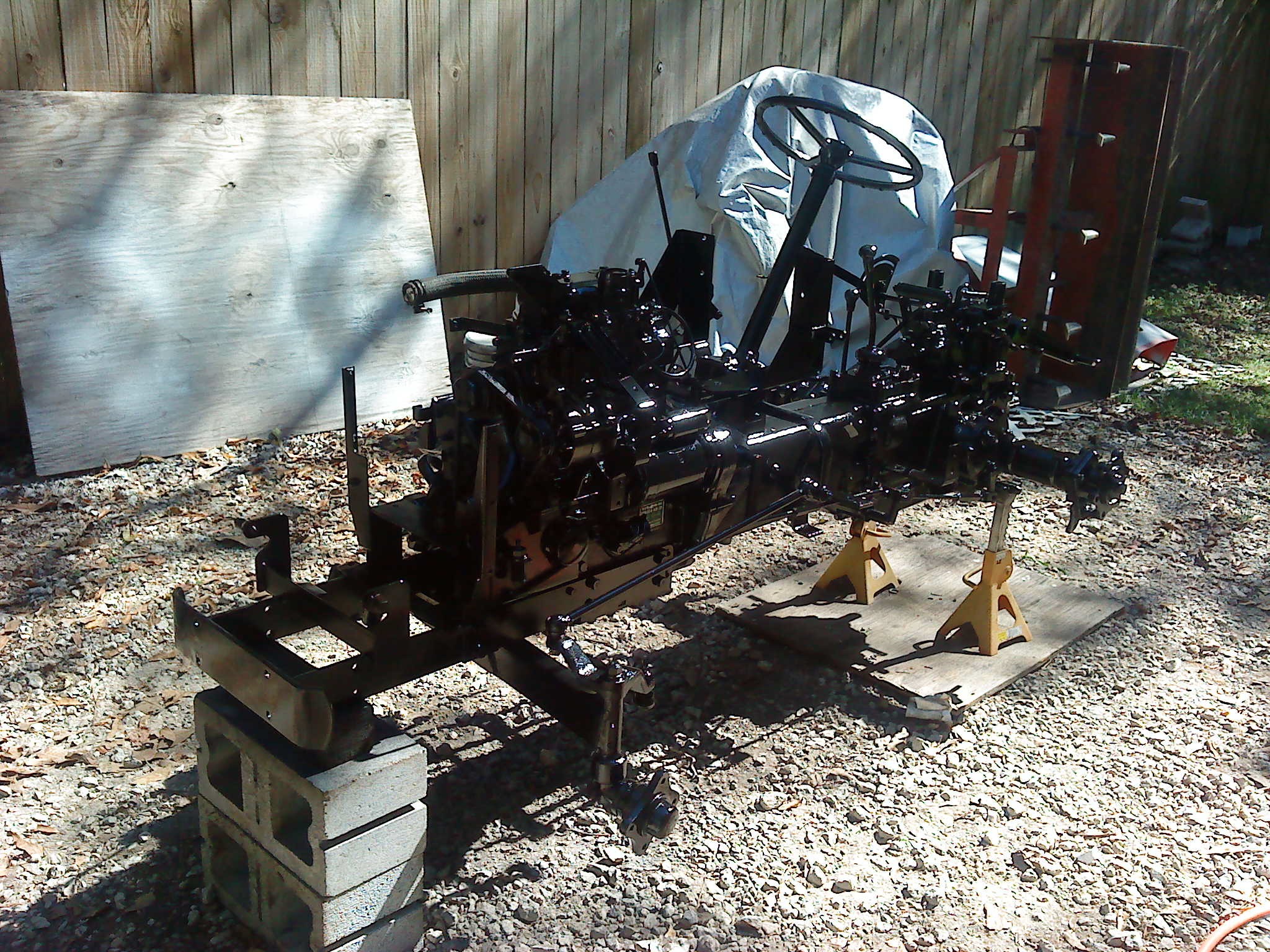

I got the Frame, Motor Painted today. Heres some Pics :cool:
/ Repaint YM2000 #37
Nice job! :thumbsup::thumbsup:
