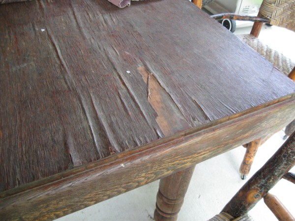

We have an old wood dinning table we leave on our front porch. The veneer has start to lift and buckle. My wife wants to remove it and has been told to rent a "steamer". Not sure what that is, but I'm wondering if one of the multi-task vibrating tools might do the job.
Any suggestions for the right tool or where to rent a steamer if it is the correct method?

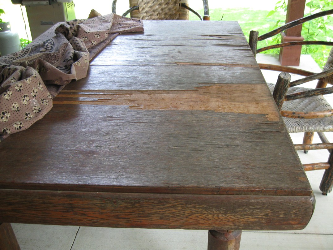

I should have added pictures :). Thanks for the quick replies. Towels and iron sounds doable. Don't have a belt sander, so maybe this is a buying opportunity!

Is that your "back porch" table. Is that what is it gonna be used for or is it actually gonna be used in a kitchen/dining room. I hate to see a fine old oak piece like that destroyed. Perhaps is there anyway to get some replacement oak veneer to repair replace the old?..........Is the purpose just to get a table top work surface?...........
For me........the towels/steam are the best bet to save a surface that is going to be "nice". Sanding and scraping the veneer off is just gonna leave LOTS of gouges and humps that will make the top look like junk. Wait for it to dry for several days before sanding/staining/finishing

I watched this process recently on an episode of American Restoration. They put damp towels on top and used a steam iron (laundry style) to heat and soften the adhesive and a putty knife to peel off the veneer.
He said it was just like taking off wallpaper....but a lot harder. :thumbsup:

Good advice for steam, definitely don't use sandpaper or a power scraper. You will probably disappointed in what you find underneath. Most veneered pieces used cheaper wood underneath, something not nice enough to stain and finish, hence the need to venner it with something finer. So it depends on your use.

+1 on the suggestions for soaking and scraping -- a belt sander in the hands of the inexperienced can do some awfull damage. The table top will probably be a clear hardwood like birch, ash or maple -- they usually started with wood we would consider great today and laminated the oak for appearances
The other thing to try is soaking it and then using a heat gun and scraper -- a lot of the glues were water based and heating them softens them as well. Iif all that doesnt work try a mixture of acetone and laquer thinner -- that will take off any remaining fininish making it easier for the moisture to get to the glue - JMHO

I would think that just replacing the veneer will leave you with the same problem in a few years.
How about milling a small oak edge and then tile the top. Just scrape off the loose veneer and seal the wood before setting the tile.
Possibly just use formica laminate, but not sure how it will weather the winters..
