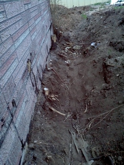

Any suggestions for digging out trees that are right up to buildings. I have one metal building on a slab and wood building on a block foundation. I dug out what I could using my little backhoe along the block foundation but I did not get to where I could get the stumps out.
I left the root exposed to the air hoping it would help prevent further growth but need to close it back up this summer.
Will post a picture in the next hour or so.

Why try to take it out? you risk damaging the foundation. Cut it clean and put a ring of Tordon on it around the outside of the clean cut. Leave it a few days to make sure the Tordon soaks in and then cover it up and let nature do its magic.

The stumps don't look very big so a Brushgrubber might work. Attach Brushgrubber to stumps then pull out using your backhoe and chain.

For the slab foundation, I was thinking a chain might be okay too.
The block foundation is probably less solid and, if you can see root penetration into the block joints, a chain would be risky.

I would just use stump killer and cover it all back up and let them rot out!---you are going to risk major damage to the building by digging/pulling around it!--- I never dig, I cut/chem/and cover! let it rot! thanks; sonny580

If all I had was a few trunks I would jump on to the Tordon approach. But with so many different root systems in the ground I have doubts. Prior to pruning and digging the entire side of that building was green with small junk elms.
I expect I need to wait for the shoots to appear then treat the shoots and a trunk where I can find live wood. From what I have been reading one may be able to apply a diluted solution to leaves. Might be the road to killing off the last of it.

The problem that for the most part there are not fresh cuts stumps to be had. People have been hacking at these with pruners and chain saws for a long time. The pellets sound like a more reasonable solution for this one. Searching for them online.

Take a look at the picture. What stumps are left are mostly debarked and you can't get to the back side of them. I do not see how I am supposed to cut them and apply tordon.
I think the only real solution is to poison them by spraying leaves when the show up.

Those look like baby stumps. I clean it out with a hand tool and use and shovel to pry it down and away from building to see how much of the roots has grown into the blocks. Chances are it hasnt and it can be removed via human power with a little prodding.

I hooked a few with the backhoe bucket. No joy.
