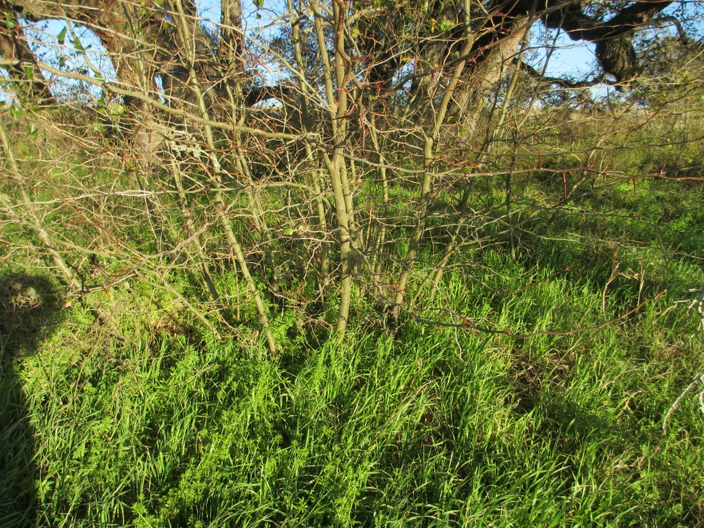

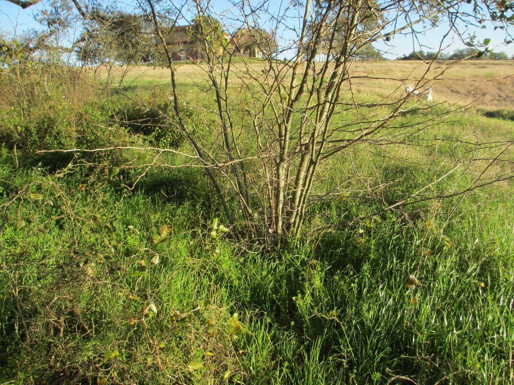

We have one slightly larger at the family farm where my recently deceased father in law (age 90) grew up and he told me it looked much the same to him as it did when he was a kid.
Would love to see a picture if you have a chance.
There are at least three of us from the same area posting in this thread. We should have a meetup. Wildflower season is *always* a great excuse to get together! I'd be happy to host.

Will get picture when we go to the farm, hopefully next week.
Will also measure the circumference of the tree in the hope someone here can estimate the age.
