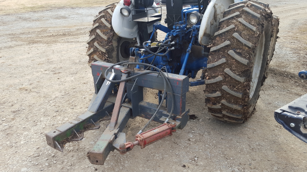

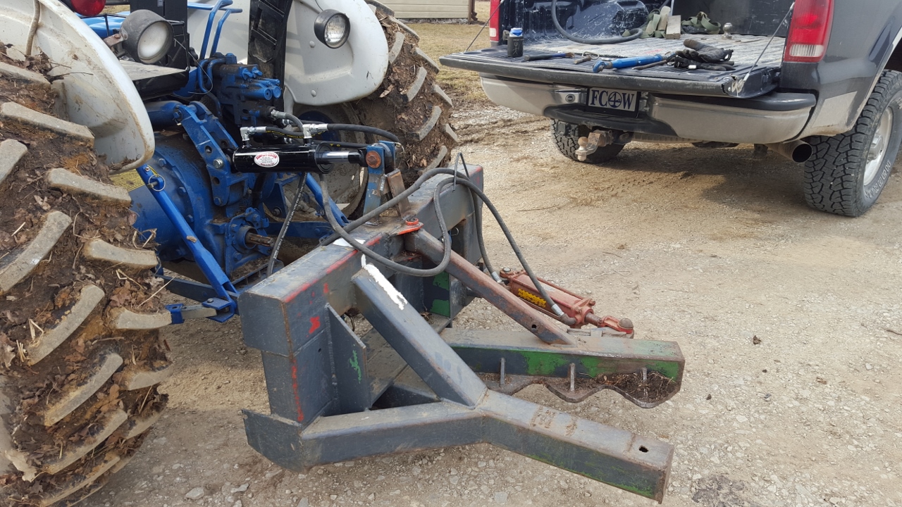

I really prefer a puller for this task. Not sure if you have hydraulics to run one though.
This puller can be used on my FEL or on the 3pt as shown. requires one hydraulic circuit to open/close the jaws.
