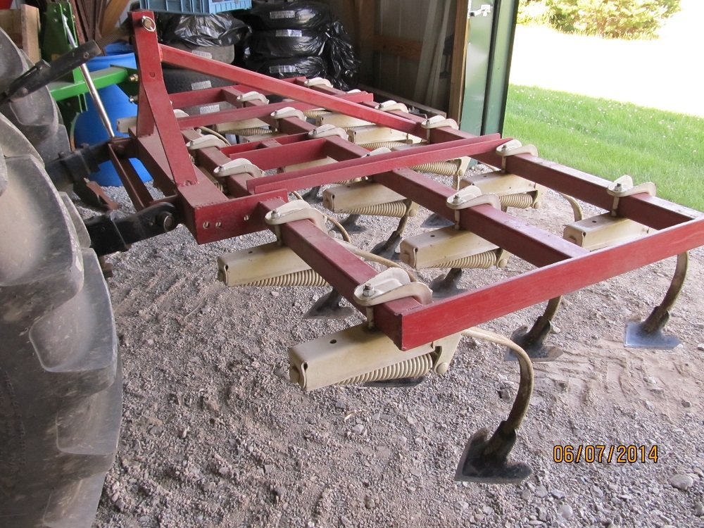

I've turned many farmyards into high-end lawns. Tillers and cultivators work the best assuming you have killed all the grass with glyphosate (Roundup) and have worked the ground. If not, forget it.

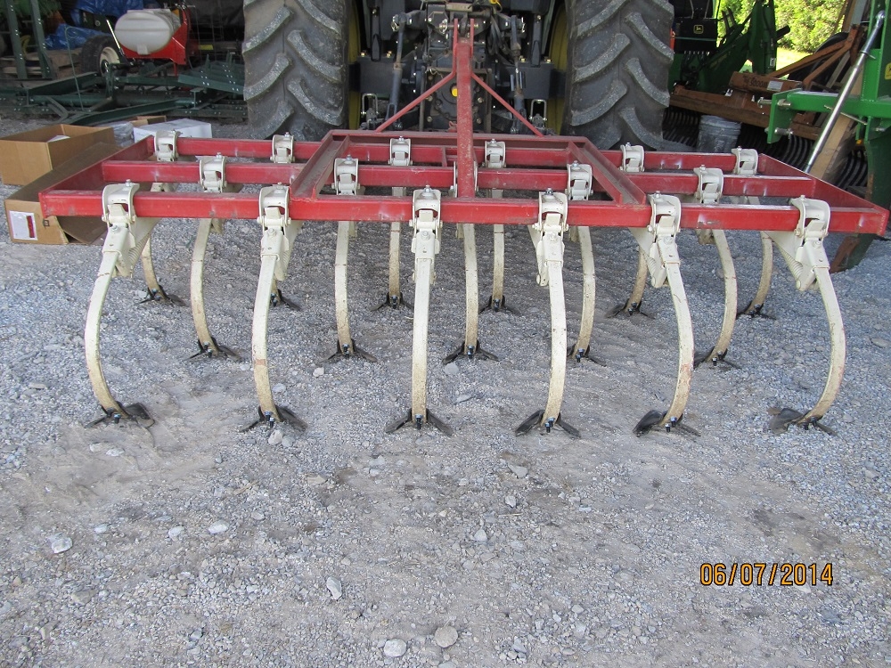

First I run my C shank cultivators through the dry ground and this picks up much of the longer pieces. Multiple passes work better. S tine cults are probably too light. The twine is tough and doesn't degrade so long pieces are easy to hook with heavier cultivators.
Then I run a rear rototiller through the dry and worked ground and this picks up most of what's left. Do it a couple times or more.

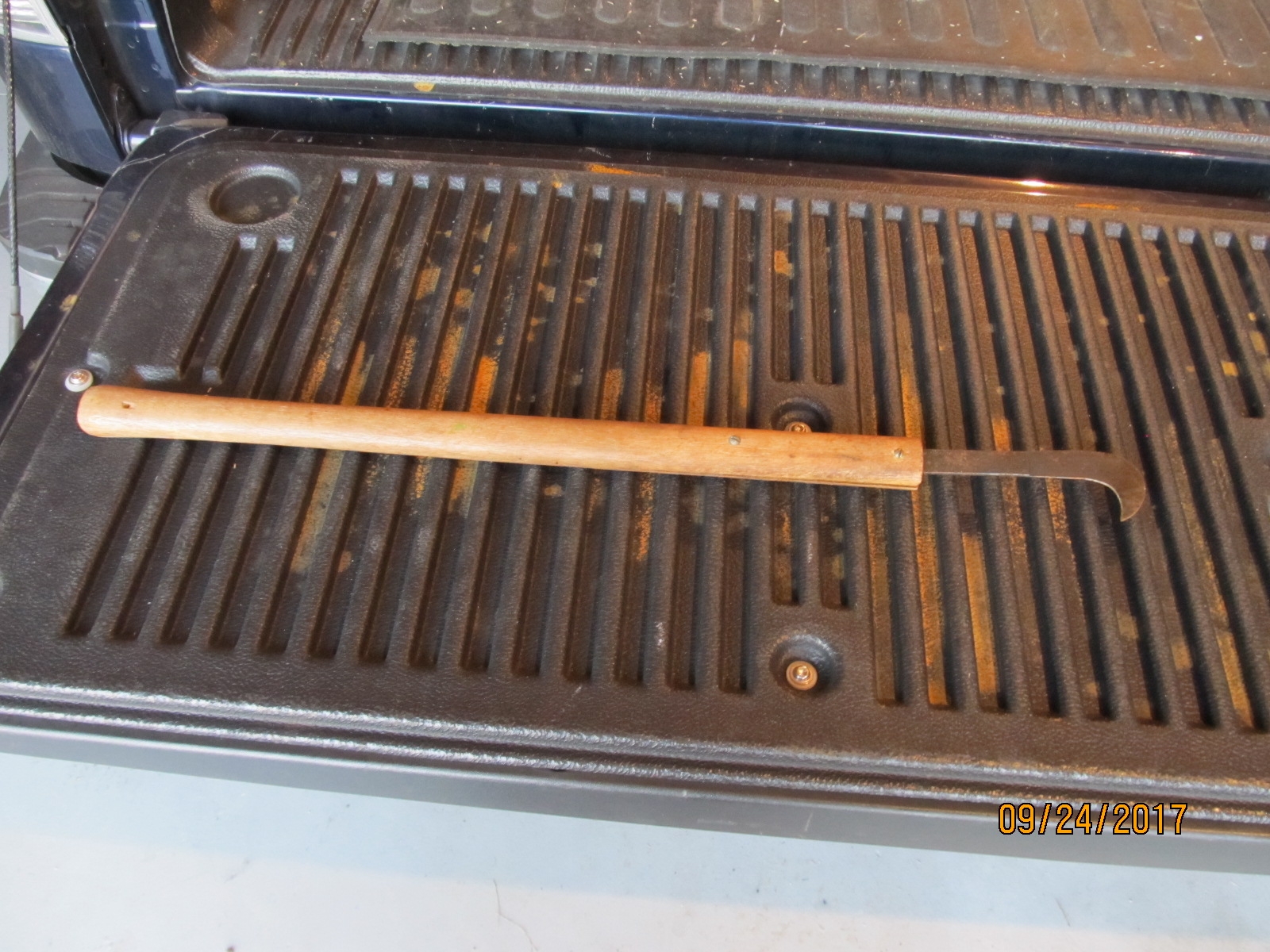

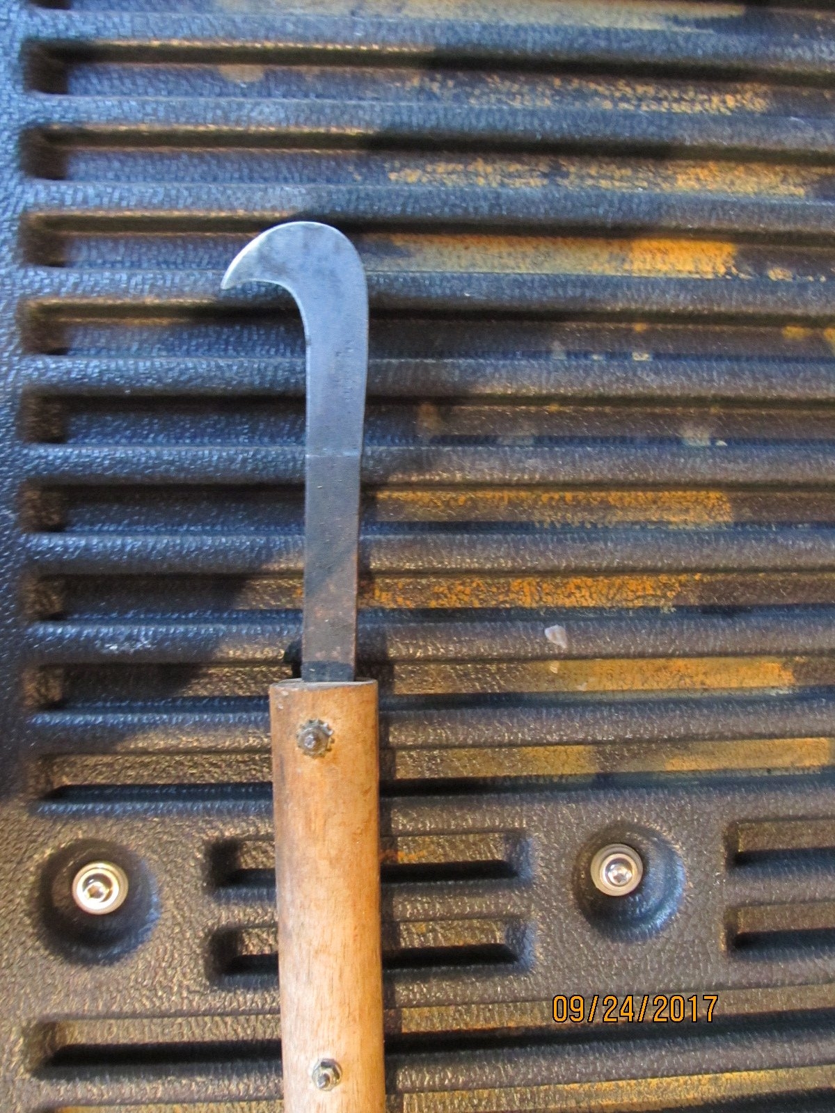

The tiller doesn't have much in the way of seals for the twine to ruin but I take it off frequently with this tool I made.
I got the shank from Smoky Mountain Knife Works and put it in a broken splitter handle at a slight backward angle. It gets twine off a tiller in seconds. I did a post on this tool once--- post 579 in this thread.

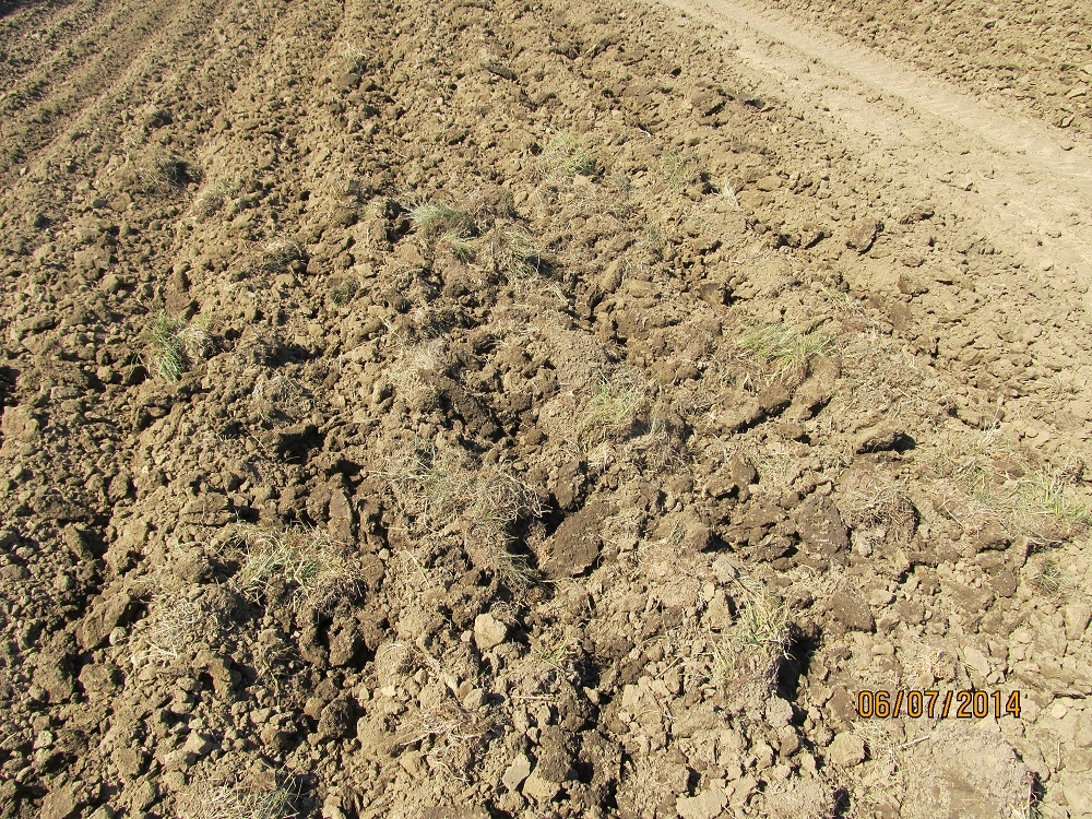

Here are my cultivators but I use 1 3/4" points and not shovels. The narrow spacing gets all the trash out. This is what the dirt needs to look like for best results. Sod is a waste of time.
Good luck. This is not difficult. I can get nearly every piece of twine and it's no big deal.
