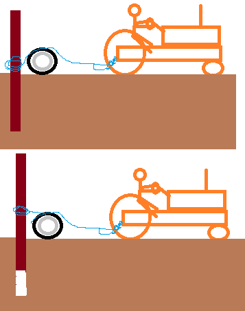

I have always pulled them and trees out like a cork, it also prevents any additional yard damage from doing it the many other ways. Pretty simple to, just a bit more enginuity than a lead foot and blunt force trauma.
Tie off one end of a stout rope to the hitch (Use the pin), then run the other end over an inflated spare tire and tie it off to the BASE of the post. Have a friend or loved one keep the tire upright AGAINST the post while you slowly apply tension. The tire will work as a lever, rolling as needed while the rope bites into the tread keeping it centered. She'll pop like a cork. Clean up is swift with little yard damage.
Ya also don't break the post using this manner as the force is in lifting or verticle with no side loading.

I wish I could see a picture to visualize that. Maybe somebody has posted something like that on youtube. Everything else is on there.
it is not the best diagram in world. but hopefully help ya visualize things.
also do a search for "tree pulling" or "stump pulling" you might try adding in "A frame" into the search. have seen actual photos vs diagrams in a few of those threads.

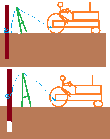

/ Removing fence posts #26
A frame instead of a tire. others show much better actual pictures and give better detals in other threads / posts here on the forum.
there be a notch in to of the A frame. that the chain sets into. so the chain does not fall out of place.
the set A frame up near the tree / post. put the horizontal in place for the A frame. and get it tight. hook chain to draw bar on tractor. run chain across A frame. then low on tree / post. and away they go.
to note it. it is advisable. not to try this on a full tree. but rather after the tree top has been cut off and only a say a few feet sticking up out of the ground. other wise you might have a tree on top of you. / killing you.
A frame is on my TODO list. for pulling some small trees at edge of lake. were hills are to steep to back tractor down near.

hhhmmsss i think the ladder would be destroyed in a heart beat.
A frame might be Two 4x4's for the legs, then say 2x4 between the 2 legs. and some sort of notch in the very top of the A. to hold the chain to keep it from slipping out of place.
a ladder as you noted would have 2 A frames (one on each side), that is not wanted, but a single A frame. so the entire A frame pivots were the legs contact the ground.
((in the diagram, i drew up. i should of just drew a single line were the A frame was, and labeled it "A frame" vs showing the A look in the diagram))
not an engineer. nor done the A frame deal myself yet. but simply and easy enough to do.
