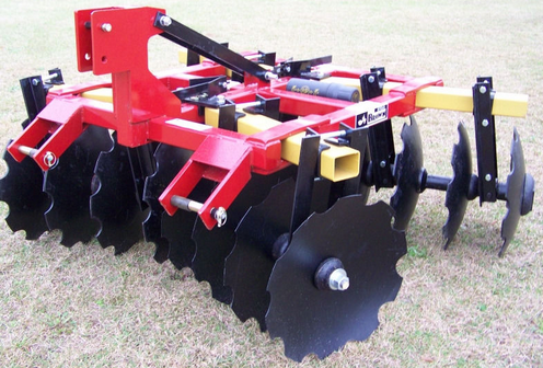

CK3510 with 4-WD can pull a Box Frame Tandem Disc Harrow with 20" diameter pans, as wide as rear tires width. This Disc Harrow will be all the CK3510 can manage. You will likely need at least four passes to level the furrows, assuming the field has been closely mowed before you begin and the soil is moist.
A Tandem Disc Harrow with 9" spacing between the pans on the front/cutting gang will cut/penetrate better than a Disc Harrow with 7" spacing between pans on the front gang.
(This assumes your land is located no higher than 3,000 feet above sea level.) ((Above 5,000 feet your tractor may lack the power to pull a Disc Harrow with 20" diameter pans.))
A Disc Harrow with 18" diameter pans will probably not cut sufficiently to fill the old furrows.

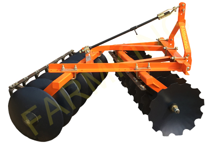

I have filled disk using nothing else. Did not straddle the ditch which was not an option as was using a pull disk but ran both sides a few times and it was taken care of. I did have about two feet of disk past my tires. I believe your tractor would be safe if it fell or slipped into a 12 inch deep ditch as long as it could lift your box blade or a disk clear. Do not run very fast so if it begins to slide in you can stop, back out and use the wheel lock for traction.
Twelve inch deep ditches are most likely too shallow for tiling if any real load will be crossing it.
You do have option of having dirt hauled in and just push it into the ditches. You may want to check on what that would cost.
