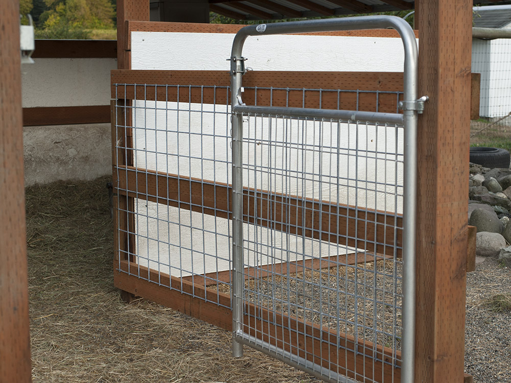

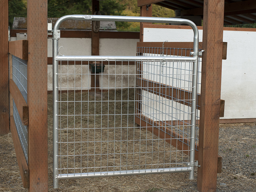

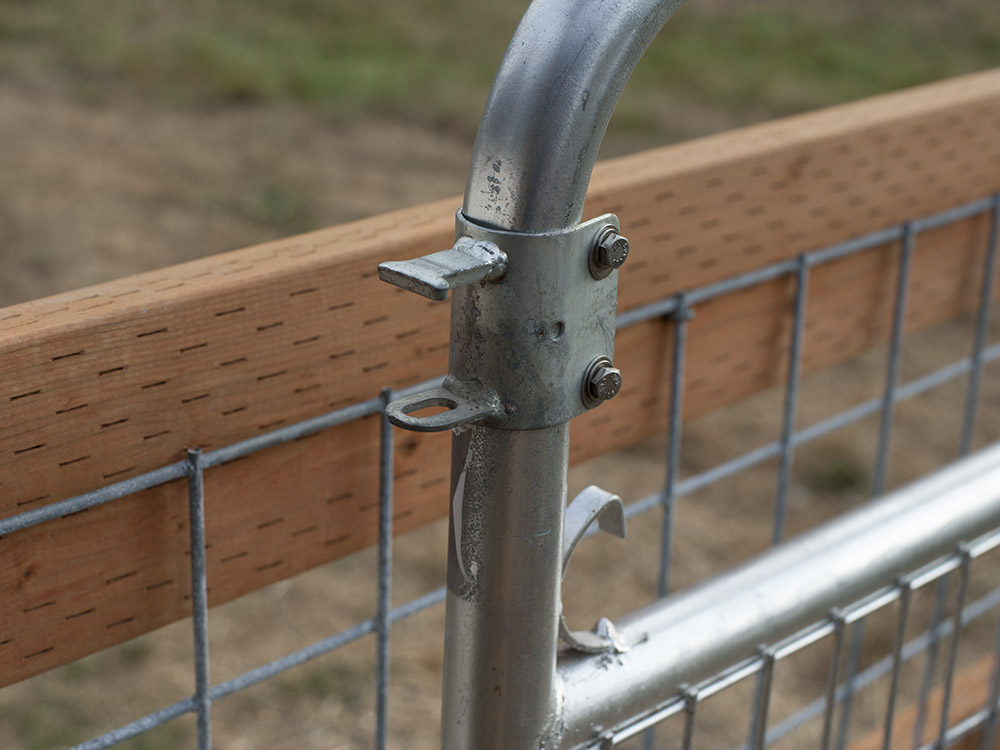

Here are some photos of the gate:
So, any suggestions? Not sure if the solenoid will be strong enough, but I can always find a stronger one from Allied or I can use an old stop-solenoid from a diesel Ford Lehman engine...those have quite a pull but also draw about 20 amps. I would like to keep the solenoid under 4 amps so I can use a 12V power brick I have laying around. Also, any suggestions regarding the remote would be appreciated too. Or any suggestions/comments about the design in general. Thanks!

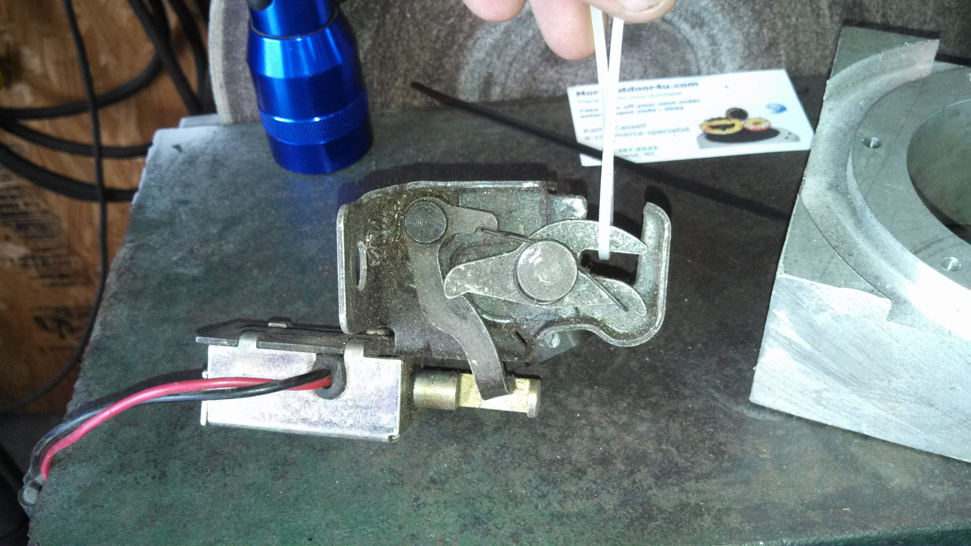

I know exactly what you need, the electric truck latch out of a wrecked car. No matter how much "spring" you put on the gate it won't bind and they draw less current than a solenoid would.
/ Remote control for gate release / auto closer
You meant "trunk" latch right? I like this and will investigate. There are a number of wrecking yards around here...I'm sure I can find something.

Yes, trunk latch. Dam cell phone up date auto correct is going crazy but it is the easy way to take and up load photos.
Like this.

On another note... I tried the bungees to see if they would close the gate... they would not. They can't pull the gate "over center"... Once I pushed the gate past the over center point, it would close.
So I am going to get a spring: http://www.gateshut.net/buy-your-gate-closer-here.html

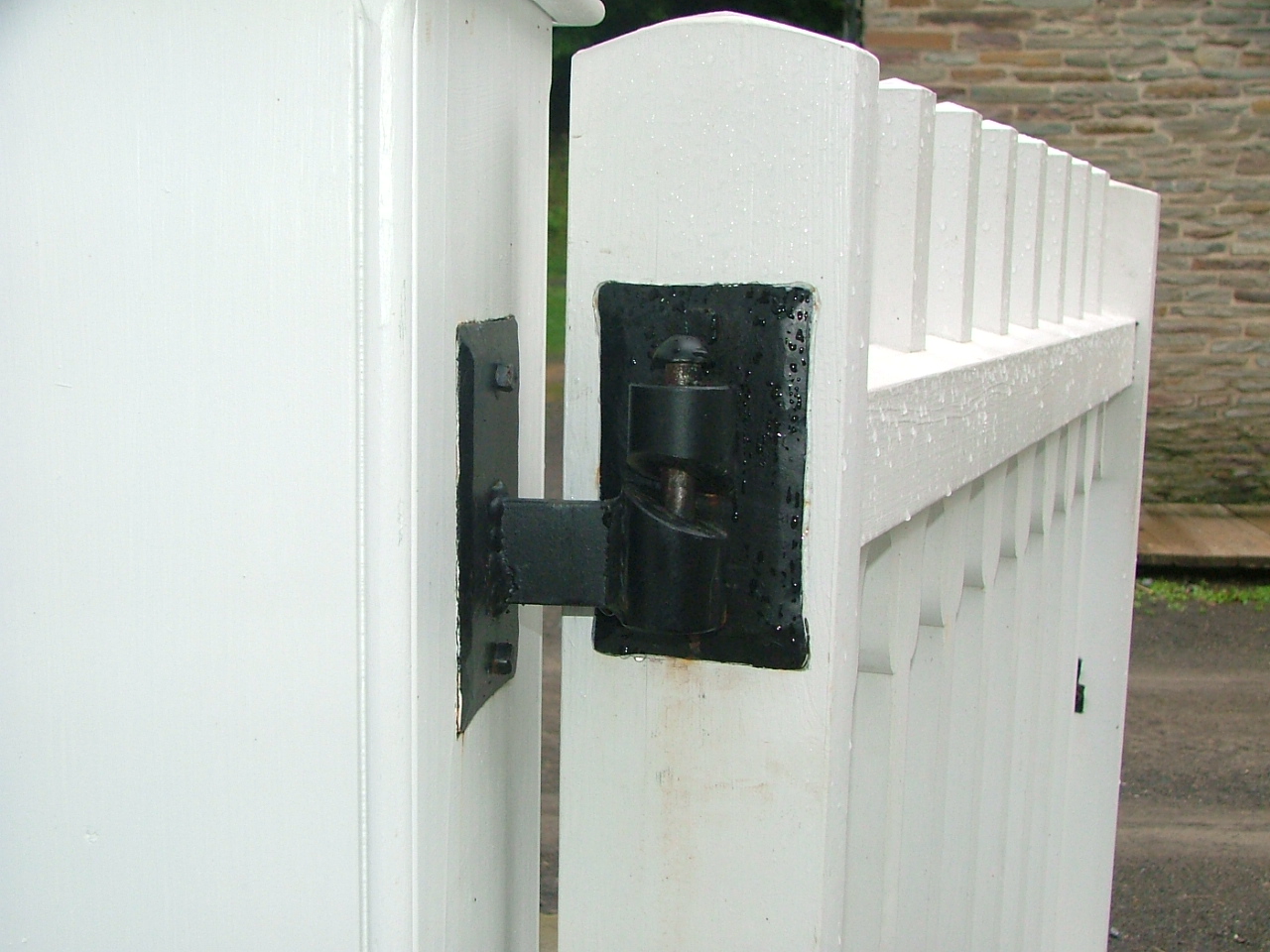

If it has to swing both ways there used to be pretty common self centering gate hinges that looked pretty much like the ones you have, except the strap part had an upside down V notch in them so when the gate opened either way, it rode up on the V, then gravity returned it to center to close. Of course both hinges have to be positioned with the L up, like your lower hinge. Maybe they don't make them any more because I couldn't to find a photo of them. They'd be easy to make from your hinges but would wear out faster than the old heavy duty ones I remember.
As far as the the trunk/door latch, it would be great if it is remote control, all you have to do is get the car key with it.
Here's a photo of a similar one but the whole hinge is cut at an angle instead of just a V notch.
