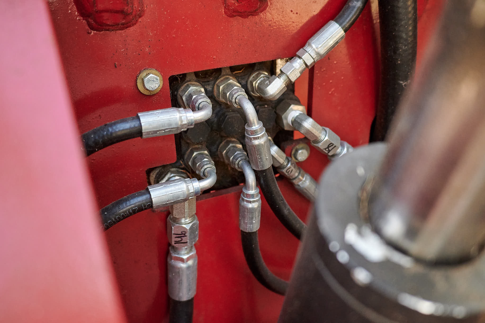

What I think I have is an open center lift/tilt valve with maybe 5-6 gpm flow using 1/4 hoses. Would this be the best place to integrate a solenoid or would you think I should use the control valve for the quick attach?

I think you should talk to someone else that's done it already.
If it were me, I'd put the diverter in the dump/curl circuit.
Normal operation left-right on the joystick dump/curls like normal.
Diverter button engaged, left-right opens and closes the grapple.
Leave the QA lever circuit alone.

I put valves in 3 of my PT's and a Kubota. Get a valve that exceeds the max flow, I think the smallest available is 13 GPMs which is more then enough.
I used the lower/raise circuit because as I lower the grapple onto the pile/log/etc I can, as I hydraulically lower the grapple, I can squeeze the electric trigger switch which then opens the grapple, I can release the switch and the grapple lowers again, all without moving the hyd control lever.
In the opposite, I pull the lever back to raise, but I have the trigger switch pulled which closes the grapple and when the object is grasped, I release the trigger and the valve then switches over to raise, all without me moving the lever again. As it raises and the brush settles in, I can momentarily squeeze the trigger again and the grapple will tighten (again without having to change the lever position).

That valve you show has two elect solenoids. I used this one pictured here, notice in the hyd schmatic on their site, the normal position of the valve (with no elect signal) just allows flow from you main cont valve straight through to the original cylinder. Then when you actuate the valve, it switches to the new circuit. Seems much simpler then the one you shown. Like a "T" intersection, you drive up and everyone takes a right, press the switch and the light changes then everyone takes a left until you release it. [that analogy accounts for 3 of the 6 ports, the other 3 ports are for the other side of the cylinder-what goes in one side comes out the other)
   / Aftermarket diverter vs. factory quick attach control valve? #10
I used this handle, because I also use a 4th valve (thumb button in 3rd picture) to control log grapple rotation. And I like a trigger switch for most of my attachments as it comes naturally and can find it without looking at control. If you go this route you will have to cut and thread the main control valve handle and I heated and bent for better ergonomics (which you may have to do no matter which one you use, unless you go the pool 8 ball and drill for a push switch). You may also have to buy a bushing to screw into the bottom of the handle to adjust to the size of yours. It will be like 5/8" round?
   / Aftermarket diverter vs. factory quick attach control valve? #11
I positioned the valve so I could reuse 2 of the original hoses and had the other 4 hoses made locally. Install the quick connects in the best position on the loader arms as you will use them the most. I don't think I have since disconnected the quick change attachment hoses. But you still have that option for a manual 4th valve.
