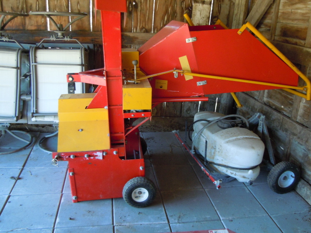

Here is my sprayer. It was originally quite cheap pull behind type. The carrier is all bolted together so to make it you need only hack saw and basic wrenches. I also reused the wheels from the pull behind. I can move it around even full. It is powered up from the tractor. I installed trailer socket on the back. One contact of the socket is always powered from the battery via 50A fuse and is used in example for fuel pump, one contact is powered via a marine switch installed on the tractor and is used to turn the sprayer on and off. I was thinking about a motion switch to turn the sprayer off when tractor stops but never got to it. When I get time I will add two more nozzles on folding arm extensions.
