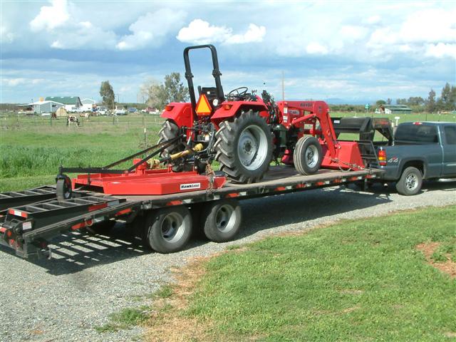

My tractor is a 2008 Mahindra 5525 (54 hp engine, 45 hp pto, 2WD, gear tranny 8F/2R, power steering) with the ML250 FEL (6-ft wide bucket, 2950 lb lift to 10.5 ft height, skid steer quick attach option on the FEL arms, chain hooks on the bucket) and 3 pairs of hydraulic remotes on the rear of the tractor. Cost: ~$19K new.
DSCF0051 (Small).JPGDSCF0110 (Small).JPGDSCF0066 (Small).JPGDSCF0067 (Small).JPG
The chain hooks, remotes and quick attach should be on your wish list. The mower is a 6-ft Hawkline rotary mower (aka brush hog, bush hog, shredder, slasher) that takes care of pasture mowing around my place.
