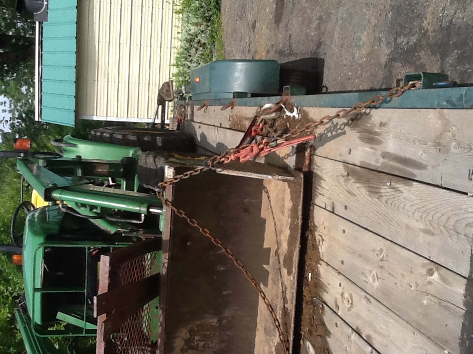

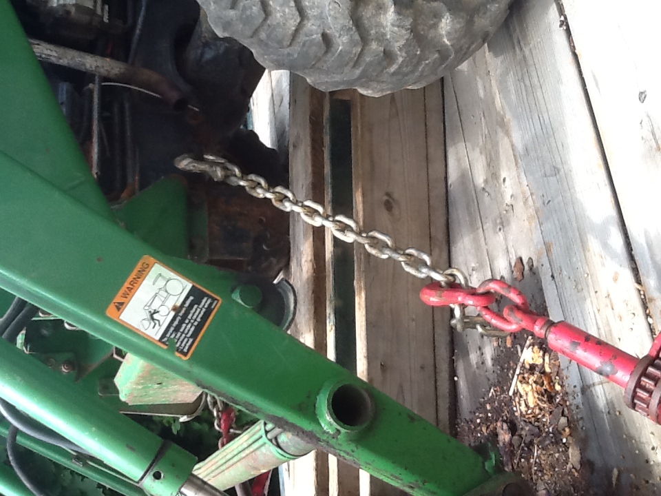

That is what I did, welded 4 D rings to the side rails of my trailer. I did this after loading my tractor on it and determined the best location front and rear for them. The D rings lay flat on the rail so unless something is hanging off the trailer, they wont interfere with it laying flat on the trailer boards. I actually slanted the D rings mounting rather than mounting them 90degrees to the rails so that when chained to the tractor the chains are pulling at the D ring in a straight line. The location happened to be half way between the standards on the trailer frame so it added 4 more tie down points.
/ Recommendation on short tie-down #18
Pictures of tie downs on trailer.
