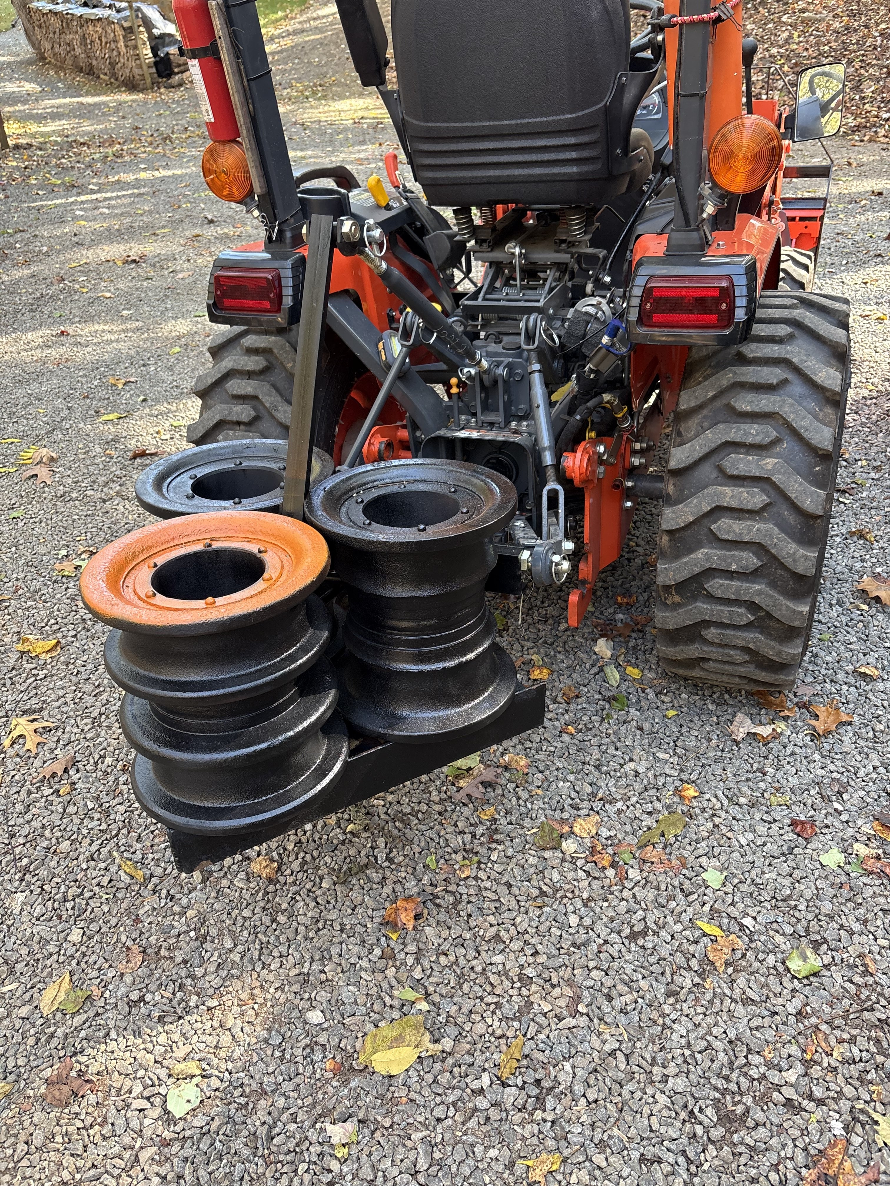

Nice pile of hand made weights. When I saw it I was thinking something like those rectangles from a weight machine.
Then... jumped a bit. Perhaps if one had a 2" round bar one could load it up with 20kg or 45lb cast iron free weight discs if one could find them cheap.
I'm not young for sports anymore 🤣
A 3/4" black iron pipe is basically 1" ... That's what I used, and it just happens to slide through my BH frame mounts, the biggest weight plates I use are 25 Lbs, with a 1" center ...
Of course you could go with a bigger pipe if you wanted to use the QH to hold it, but my main purpose for this is with a rear blade, that when being used, all that weight is on the ground, I needed more TRACTION!
Yes, well, you were using your baby tractor to do a job it was never intended to do. Of course, you have always found a way to do lots with little.

During the winter snow removal, the front loader was overbalanced and the rear wheels were slipping. I welded a basket for the rear hitch and placed 20-millimeter plates cut from Larsen tongue into it. The work became more enjoyable.

The weight of each plate is about 10 kilograms (22 pounds). This weight makes it easy to unload the plates.

I find the trick to adding rear ballast is to use something that does more than just add weight. Usually, it's an implement. In winter, I leave the spreader attached. It weighs 2800# loaded with anti skid. It articulates, so I can always dump some if I need less weight.
In summer, I leave a 3pt mower or the backhoe attached.

They don't make wheel weights anymore??
/ Rear weighting device #38
I’m still new to the sport of tractoring, however, from what I read there is a difference between weight in/on your rear wheels and counterbalance weight hanging out behind a tractor… each has their place but neither replaces the other…
Then again… I could be wrong…😳

Wheel weights were not quite enough...... Dead Deere is 520 LBS, counter weight about 600 pounds....

For the OP's situation ... Either rear ballast weight or rear wheel weights would work for his lack of traction problem he was trying to solve ...
If a QH is used, the rear ballast is easier to take off or put on quickly as needed ...
I leave my steel wheel weights on all the time, they do not help with relieving the front axle of overloading the front axle by heavy loader work ...
This chart taken from the following video at about 7:20 into it, explains why the previous post worked with rear ballast, but not wheel weights (presumably liquid?) ...
