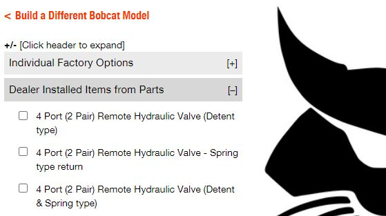

I'm waiting on delivery of a CT2025 and planning what implements I want and in what order. In looking at the brochure, Bobcat describe the rear remotes as "4 Port Remote Hydraulic Valve (Spring Return and Detent)". This option is coming on my tractor and I read it to mean both sets of remotes have a spring return and they have a detent to allow float. Those of you with these tractors, am I correct in my thinking or do the two remotes work differently?

Just bought a CT2025 HST. For the rear remote Bobcat offer the following options: both spring return, both detent, or one spring return + one detent. I had to insist to the dealer to choose mine (the later). He was not aware of the three possibilities. I found it while I was sneaking around on the Bobcat parts catalog web site.

That's correct. There are three options to get.
When I ordered mine I requested one of each as well. They told me that's the standard if someone ordered two sets of remotes without specifying.

I have a CT2025 but I used the Kioti kit to add 2 sets of remotes to the bobcat. Kit fit no problem. I ordered one spring return and one detent set.
